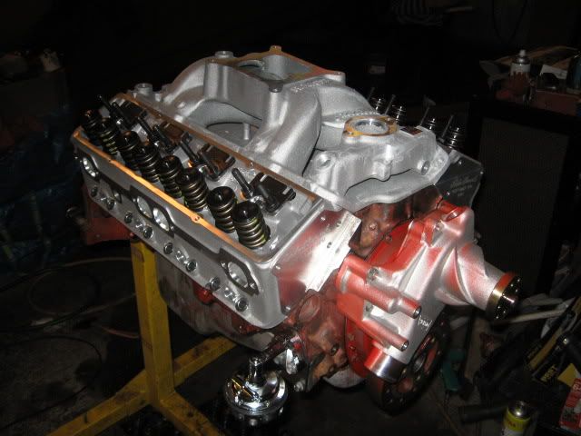

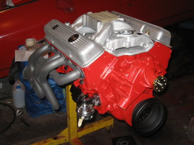

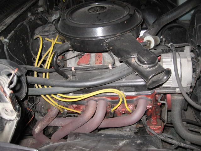

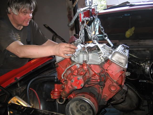

Modellpularn Posted September 26, 2011 Share Posted September 26, 2011 (edited) Not sure if I ever did a thread about this earlier. Hmmm, the absentminded professor strikes again..... I have a '72 El Camino, red with black stripes, SS hood, 350/350, old "Americans" with straight spokes. Anyway, I thought it was about time to do something with the engine. Since I was in California in February, and attended the NNL West, I also bought a bunch of stuff for the engine. It used to look like this for many years: A few years ago, I got a ticking lifter. So while that was taken care of, I did some minor overhaulin, and it looked like this up until now, or Easter: My son was visiting me for Easter, so I had him help out. He took the pic as the dirty engine comes out Ok, fastforward a couple of months. I bought aluminum heads, as part ot of the Edelbrock top end kit, and an aluminum water pump A few days later it looked like this: I want it to be more "stock" looking.... Edited September 26, 2011 by Modellpularn Quote Link to comment Share on other sites More sharing options...

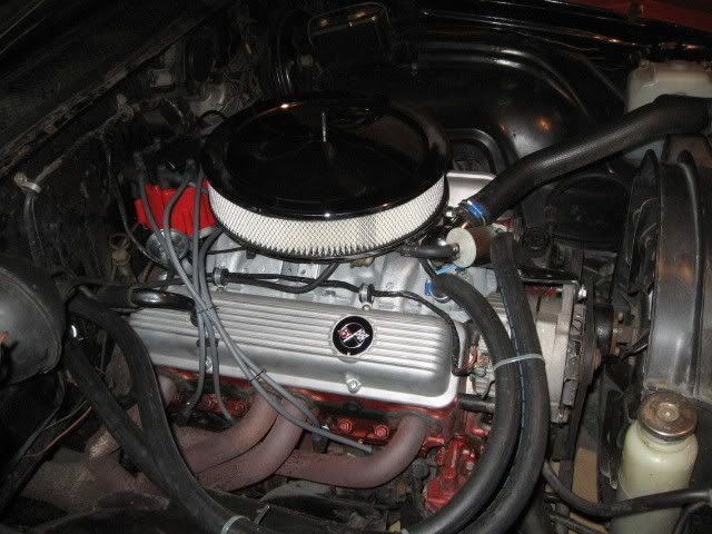

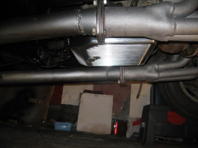

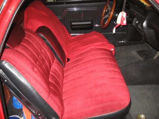

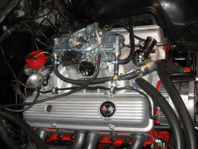

Modellpularn Posted September 26, 2011 Author Share Posted September 26, 2011 (edited) It's back into the car, with most of the hoses and other stuff attached in this pic. I have some minor adjustments to do before I'll try to fire it. Cross your fingers......... I have added a longer hose between the front float bowl, and the T connection. It looks better now. Maybe it was me, but it had a strange turn to it.... The tranny was leaking, so I bought a new pan from Summit. This was done three years ago. The seat is from a 74-75 Chevelle, and was able to get this combo done for me: maroon velour/black naugahyde. From a company on the East coast. Edited September 26, 2011 by Modellpularn Quote Link to comment Share on other sites More sharing options...
jeffs396 Posted September 26, 2011 Share Posted September 26, 2011 Looks great so far Hans!!! Quote Link to comment Share on other sites More sharing options...
Modellpularn Posted September 26, 2011 Author Share Posted September 26, 2011 Looks great so far Hans!!! Thanks Jeff! It feels good to get feedback from a fellow Chevy guy. Well, I was down to the garage, made a new ground wire, and tightened the power steering belt. I figured it was ready to fire. So I gave it a shot of fuel. But it backfired, and flames came from the carb. Hmmm, something's not right here....Maybe I got the distributor a half turn off? So I switched the wires around, putting #1 at #6. Now I got it to fire a little bit, but not all the way. Then my buddy came by, and we tried to figure out what was wrong. He left, and I tinkered some more. Finally I removed the distributor, and turned it back where it should be, plus one notch at the cam gear. I thought:"this has to be right" Plugged the wires back in their right places, and got inside. Turned the key, and it roared into life right away!! Quote Link to comment Share on other sites More sharing options...

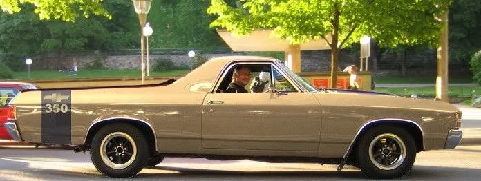

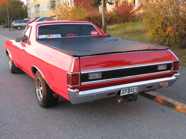

Modellpularn Posted January 14, 2012 Author Share Posted January 14, 2012 (edited) Nice work on the engine, Hans. Got any photos of the whole car? Later- I sure do, here it is: If you click the photobucket link, you can find more pics. Edited January 14, 2012 by Modellpularn Quote Link to comment Share on other sites More sharing options...

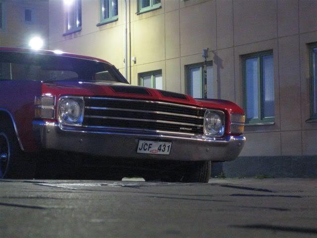

Modellpularn Posted March 12, 2012 Author Share Posted March 12, 2012 (edited) Here's a pic a friend took, and tricked...... And another one, in gold......! This one's not tricked, but it's a cool shot! Edited March 12, 2012 by Modellpularn Quote Link to comment Share on other sites More sharing options...
