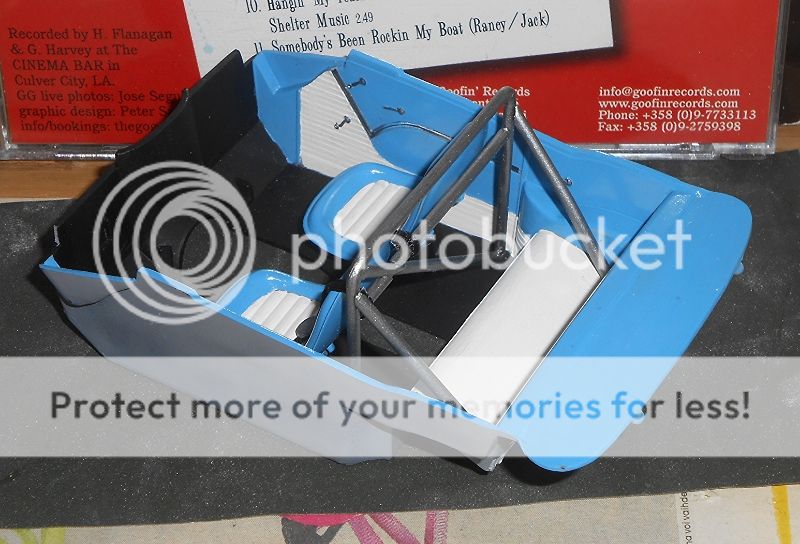

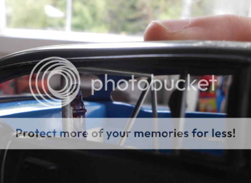

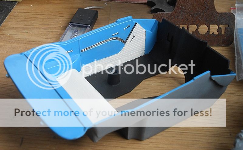

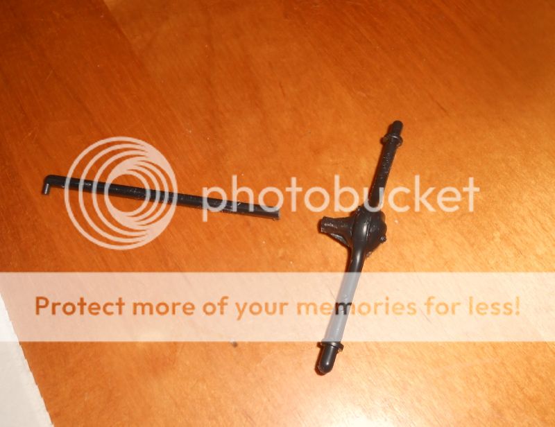

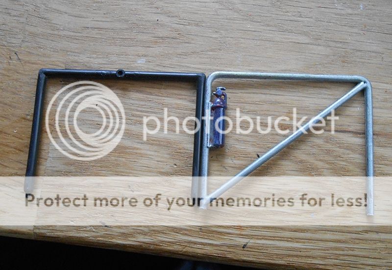

W-409 Posted June 18, 2014 Author Share Posted June 18, 2014 Thanks Stan and Dale ! Yep, removing the exhaus and mufflers was a "Must". I did the same in '57 Nomad Street Freak years ago and I remember I could do it back then, but the end result wasn't as smooth as I hoped. Now I wanted to do it better. Here's a little update for you all. I started working on the roll bar. The one that came with the kit wasn't very good. I thought it was a bit too thick and it was too low as well. Of course it would have been easy to make it a bit taller, but because its' thickness I decided to see if Monogram's '56 Chevy had a better one. And it did, even though it was a bit too tall but it was really easy to lower a little. I also removed the fire extinguisher from the roll bar. Later on it will be installed on the center console. Here is the original roll bar from '55 Chevy and '56 Chevy's lowered roll bar. I also put some Bare Metal Foil on the door panels. It wasn't easy and the chrome trim didn't turn out as good as I hoped, but it's not my worst effort, either. I also painted the window cranks and door handles. I've never managed to BMF those so I decided to paint them instead. They'll look a lot cleaner like that. I also glued the seats on, and they pretty much cover the door panel problems. Seats are painted with same colors than the rest of the interior. I also found a perfect set of rear tires and wheels for this project. They are very old 10,5" Racemasters with Five Spokes. I bought them last year from a long term Finnish model builder who was selling his treasures. He said he didn't remember where were they from, but he said he has had them for a very long time. So we both agreed that they must be very old, and they look like it too. I think those fit perfectly on this. Quote Link to comment Share on other sites More sharing options...

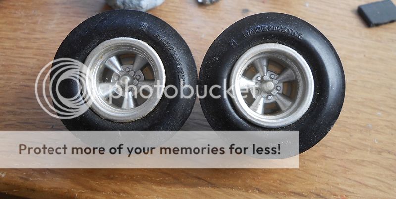

DynoMight Posted June 18, 2014 Share Posted June 18, 2014 wow, now just find some 5 slot front rims and you'll be good! Is this going to be a gasser-type build or just a whatever, like my Nomad haha Quote Link to comment Share on other sites More sharing options...
W-409 Posted June 19, 2014 Author Share Posted June 19, 2014 Thanks Glenn! I think I'm shooting for the whatever option. I have a couple of Gassers in progress, too and I thought I don't want to build this as a Gasser. With all of those rules Gas Coupes & Sedans had, this would take forever to get done. Slots would be good for the front. I'll see if I can find a set. Quote Link to comment Share on other sites More sharing options...

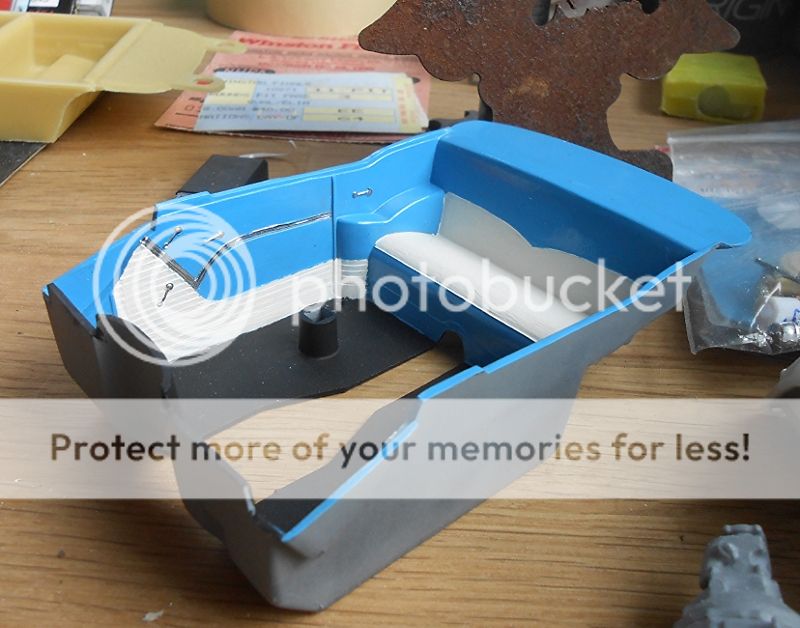

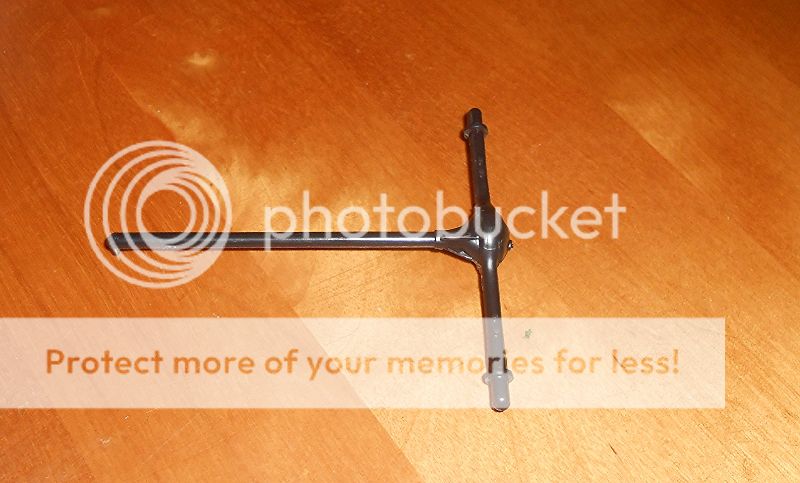

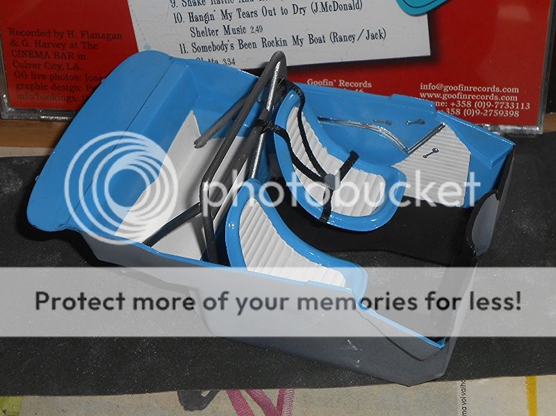

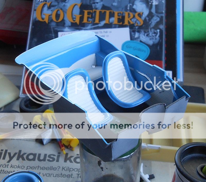

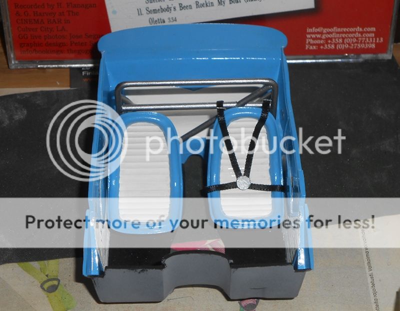

W-409 Posted June 19, 2014 Author Share Posted June 19, 2014 Another little update. I was working with the roll bar and seat belts today. It took many hours with all of the problems I had (Those dang Photo Etch parts that fly from my tweezers every time!). Anyway I started with the roll bar, which was quite simple. I had to add a cross bar so that the seat belts can be mounted. It had to be made from two parts of course. The real problem was the seat belts. The PE parts that make it possible to build wrap around style belts were a real pain, but other than that everything went well. Here are a couple of pics: Quote Link to comment Share on other sites More sharing options...
rustybill1960 Posted June 19, 2014 Share Posted June 19, 2014 A very clean interior And that chassis is ffantastic Niko! I really like the way You took out those mufflers! That is one thing about that chassis that I do not like at all Really like Your work here looking forward to more Thank You for sharing Later Russ Quote Link to comment Share on other sites More sharing options...
1 bad55 stan Posted June 20, 2014 Share Posted June 20, 2014 I agree with Russ,nice and clean! Quote Link to comment Share on other sites More sharing options...
am73grand Posted June 20, 2014 Share Posted June 20, 2014 This is awesome! Looking forward to seeing more!!! Quote Link to comment Share on other sites More sharing options...

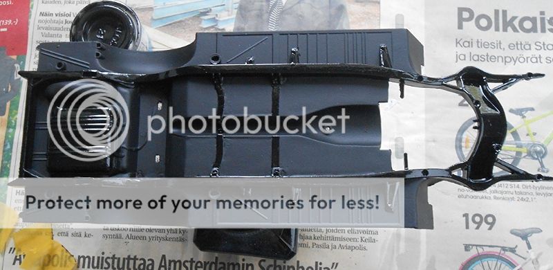

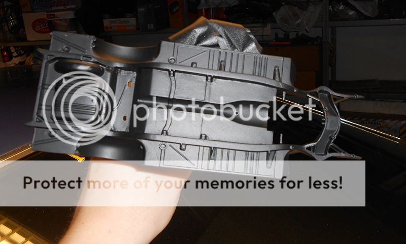

W-409 Posted June 22, 2014 Author Share Posted June 22, 2014 Thanks Russ, Stan and Ron! I highly appreciate your kind comments, they sure mean a lot to me. Here's a bit more. I got the chassis painted a couple of days ago. Anyway there were some cracks on the paint. I don't know why that happened, but luckily I was able to sand it smooth without sanding through the paint so I just repainted the chassis yesterday. Now it looks alright and I'm going to paint the frame with gloss black soon. I also started working with the engine. I removed old glues as much as I could and put some Bondo to smooth out some areas. It's still far away from being ready for Primer, but I'm hoping to do some more work with it today. Quote Link to comment Share on other sites More sharing options...
DynoMight Posted June 23, 2014 Share Posted June 23, 2014 Looks good! Quote Link to comment Share on other sites More sharing options...

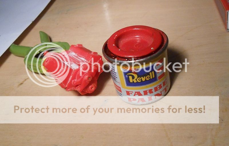

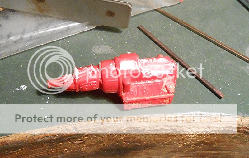

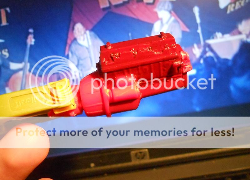

W-409 Posted July 2, 2014 Author Share Posted July 2, 2014 Thanks Guys, I appreciate the comments! It was a nice Qualifying day on Saturday. We were able to run five rounds, which is pretty good as there were lots of racers. My runs were very consistent and I did a new 60 FT record, too. A complete Race Report can be found Here. Anyway I haven't had time to work on this after the race. Only thing I did was painting the engine. It's painted with old Revell's #31 red, but it's a lot darker than the new bottles of the same red. I believe this is a Custom Mix by my dad when he was building in his childhood before getting back into modeling a few years ago. Someone might wonder the cylinder heads. Yep, they are a bit rough, but it will be all covered so that roughness won't matter on finished engine. The reason I'm updating now is that tomorrow I'm going again full throttle at Alastaro Raceway. It's time for the Nitro Nationals: European Championship Drag Race Event and there should be a good number of Stockers & Super Stockers too! I can't wait! Of course it's The Go Getters playing in the background. I'm living at my relatives' on these days between the races... My "Bench" here is not a Hi Tech model. Once this red is dry, I'll paint the transmission, starter, water pump etc and start assembling the powerplant together. But now I'll concentrate on hammering the throttle on 1/4 Mile... Loud Pipes & Lead Feet! https://www.youtube.com/watch?v=-xYH1G0rBQI Quote Link to comment Share on other sites More sharing options...
DynoMight Posted July 3, 2014 Share Posted July 3, 2014 Can't wait to see the results from your races! Congrats on the record, too! That red would look awesome on a 1970 Mustang... To bad they changed the formula so its a different shade.. Quote Link to comment Share on other sites More sharing options...
slusher Posted July 3, 2014 Share Posted July 3, 2014 It may be me but I think Testors has change several colors. Sometimes I think its me but been doing the Testors paint since I was a kid. Good luck at the track, I love drag racing... Quote Link to comment Share on other sites More sharing options...

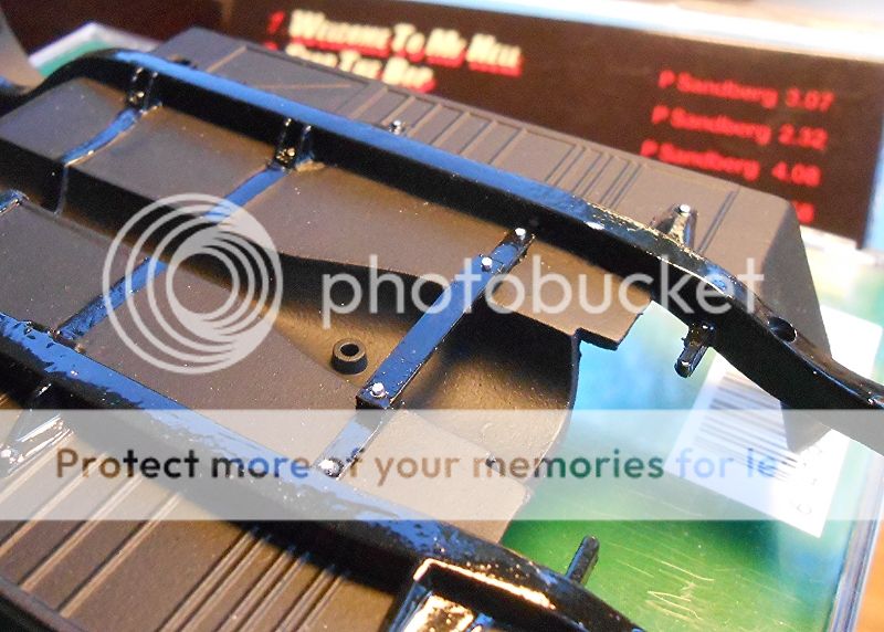

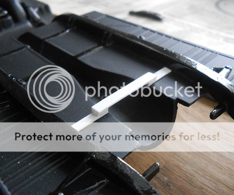

W-409 Posted July 9, 2014 Author Share Posted July 9, 2014 Thanks Guys! Yep I'm pretty sure that Testors has something that is pretty close than the one I had. Testors has lots of paints and they are great quality. The racing went well. I did a new 60FT record again and I ran a 12.2 ET which is a good number for that car. It wasn't a new record, but it was really close. On the first Elimination Round I red lighted by .052 so I lost to Arto Sulopuisto in his B/S Pontiac Firebird, but overall the weekend went so well that it didn't matter too much. Anyway just a little progress on the '55 as well. I did some sanding and smoothing to the transmission crossmember that I scratchbuilt earlier and it looked like no putty was really needed, so I painted it with Revell Gloss Black. When the paint was dry, I glued the crossmember on its place and added bolts on it. They were made from hex styrene tubing. Quote Link to comment Share on other sites More sharing options...
am73grand Posted July 9, 2014 Share Posted July 9, 2014 That cross member looks great the bolt heads really set it off!!! Quote Link to comment Share on other sites More sharing options...
Dragfreak Posted July 9, 2014 Share Posted July 9, 2014 (edited) That cross member looks great the bolt heads really set it off!!! I can't help but agree with Ron, the chassis looks very nice and the bolt heads are a nice touch. That sucks that you red lit, I've done that plenty of times. In fact, I went to the final round in an NHRA sanctioned wally race and wen .005 red, I have 5 Wally's but I'll never forget that race. You'll get it another day Edited July 9, 2014 by Dragfreak Quote Link to comment Share on other sites More sharing options...

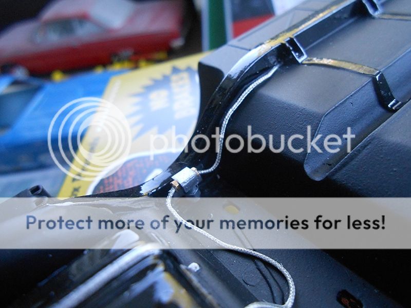

W-409 Posted July 11, 2014 Author Share Posted July 11, 2014 Just a minor update on this project. I scratchbuilt a Holley fuel pump from sheet styrene and styrene tubing. The mount is made of beer can aluminum. The pump is actually very simple, but on a finished model, I guess it is a neat little detail that can't be seen too well. The fuel line is made out of Pro Tech's Braided Line (The best there is!) and my plan was that it goes inside the frame. The connectors are made of hex styrene tubing. Here is a picture of the kit's rear axle. As you can see the driveshaft is molded as one piece with the rear axle. The driveshaft has no couplers (?) and it's a bit thick, too. Well, the only solution was to cut the driveshaft away, I'll use or make another one when I get the rear axle on place and I can mock up the engine. Quote Link to comment Share on other sites More sharing options...
MitchP Posted July 11, 2014 Share Posted July 11, 2014 Hi: Just got to this build and several things stand out: first you're doing one heck of a job, two, the streetburners I've build (or seen) that were focused on a pro sportsman build never had these many problems, and I have 3 Hemi top fuel engines I would have given you one for your build! Seriously, you're work is great. I never realized anyone made hex styrene rod and I spend overspend my budget on RB Motion and Detail Masters aluminum fittings, which I paint with Tamiya clear red and blue acrylic. Is the hex rod Evergreen brand and what diameters do they come in? Can't wait to see the finished work as you never gave up. One tip a friend gave me on roll bars/cages: use some solder inside the body to bend and conform to the approx. height you want the bar. Then, get some styrene rod and a candle (or other safe heat source) and slowly heat the rod to match the solder shape. Once you have the hoop done, you can add other bars as needed and if you want a pro-style cage, you can use the heating trick to avoid the sharp looking angles on the cage. BTW, your detailing is nice too. I think I saw a strap down for the fuel tank in one of the pics; a much missed detail that really adds a 1:1 touch. Good luck and cut some lights! Quote Link to comment Share on other sites More sharing options...
