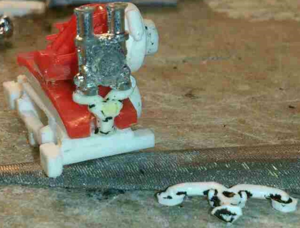

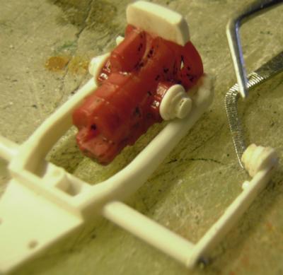

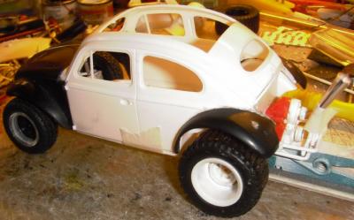

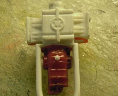

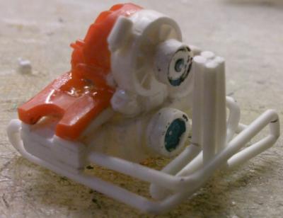

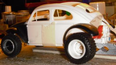

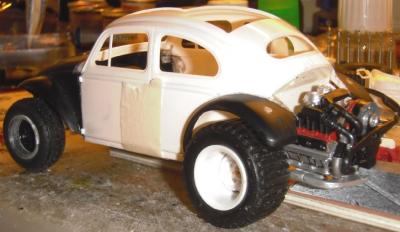

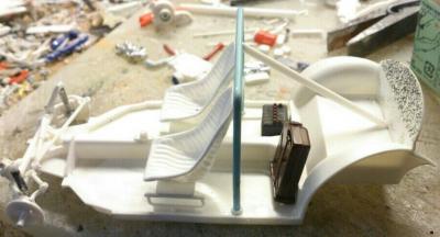

Unfortunately the Porsche-Engine that i got from my friend Marc doesn't look as good as I'd hoped forin the rear of my Baja Bug, so I'll stick to the VW-Engine this time.
Don't worry though, I have several other VW-Projects where the Porsche-Engine can come in handy..... ;)

You could go the other route and put a Corvair engine in it... :)
While visually interesting, the Corvair engine rotates opposite the VW, which means if you just "bolted it in" you would have 4 speeds in reverse and a super low one forward gear! reverse-rotation cams were available as opposed to flipping the transaxle which put load on the coast side of the gears, leading to early transaxle failures.
Besides, a turbo 2.4 litre beetle engine makes insane power!
Link to comment
They have adapters y'know ;)
Link to comment
I know. That's why I said "if you just bolted it in…." :P
The Corvair swap is one of those old "some assembly (and engineering…) required" conversions. The RIGHT way to run that engine is using a reverse-rotation camshaft and get it operating to work with the VW transaxle gearing. But in the modeling world, the Corvair is a more detailed, and easily modified, choice.
Link to comment

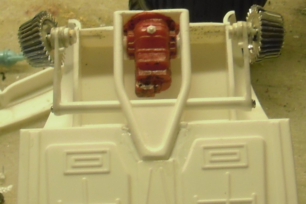

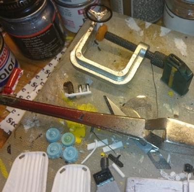

Great work so far. Those brake drums look cool, however, that's not something you would ever use on an off-road vehicle. ;)
That's true...at least by today's standard.... This is meant to be a 60's Baja, and as such I think those brake drums would be periodically correct? ;)
