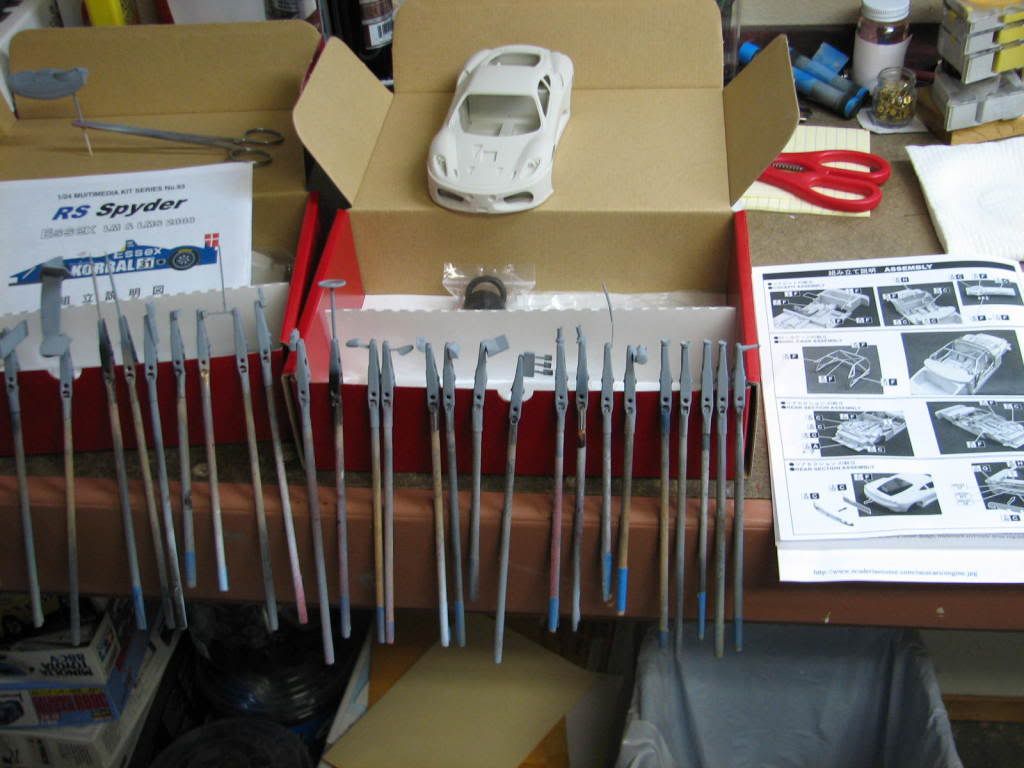

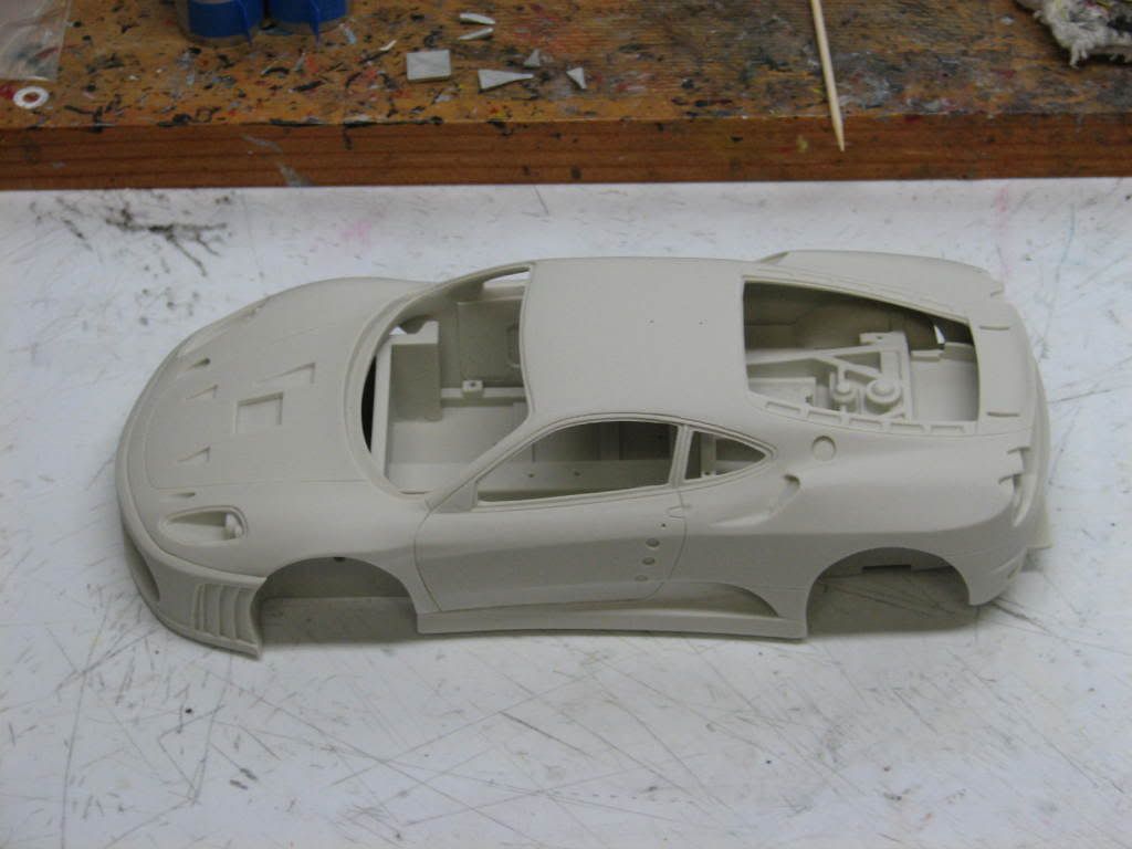

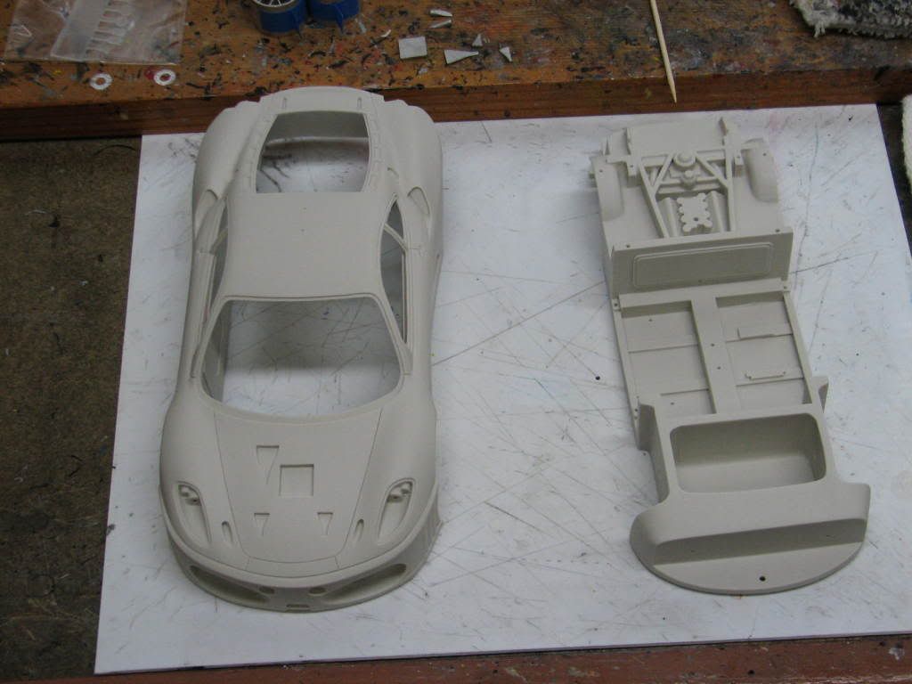

First impressions...the kit is very nicely casted. Minimal flashing with some small pinholes on the bottom. There are only 3 resin pieces out of the entire kit. The rest is pewter. I've already spent several hours cleaning and prepping the body and pewter pieces. Here are some pictures of what I've done so far.

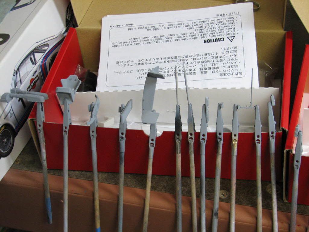

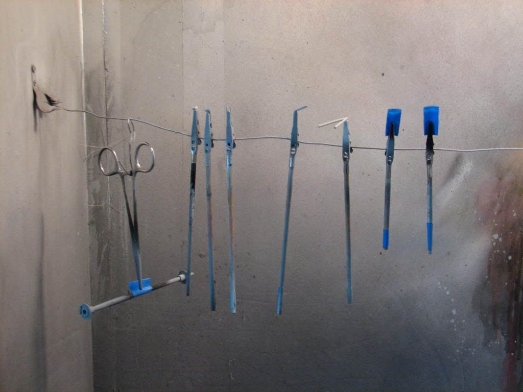

Here are some pictures of the pewter parts and primer.

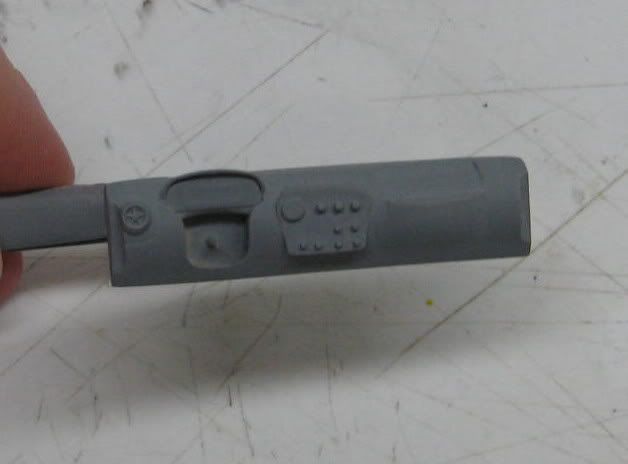

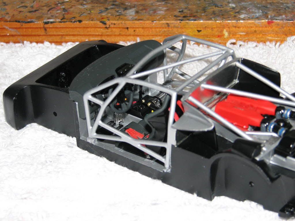

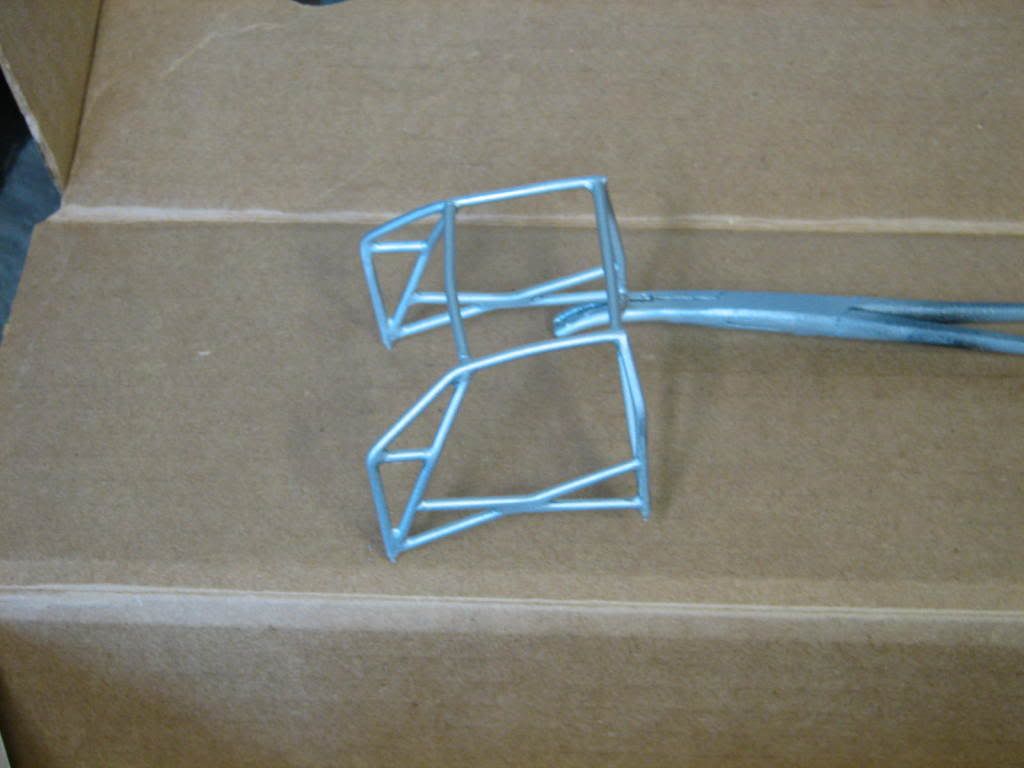

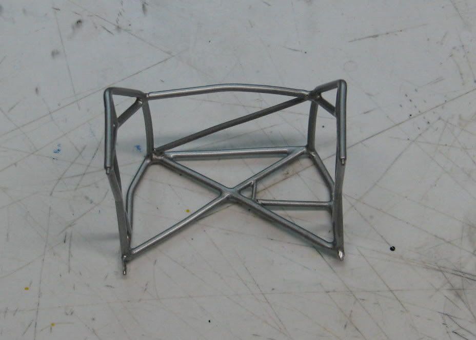

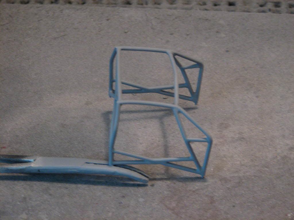

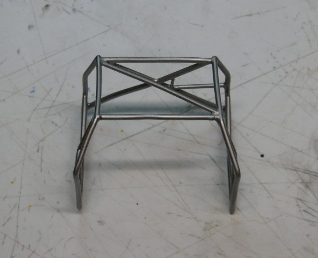

Here's a picture of the roll cage put together from four pieces. Some tweaking has to be done to make it fit the body and the chassis correctly. Also a picture of the dashboard which is a little disappointing since there is not a lot of detail. I hope to add detail later.

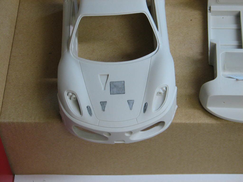

Right now the only thing I really don't like about the kit is that I have to fill in five huge holes on the front of the car. They give you plugs for the holes but the plugs don't fit that well. I know the reason why they did it. It maximizes the use out of the body. But the cars that ran with those openings are from 2008.

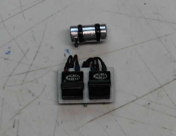

Thanks for the photos. Now do you have any of the two electronic boxes on the rear fire wall on the passenger side? These instructions are terrible for giving what color things are supposed to be. I have found only one picture of the engine bay and that was from the Team's Web Site. And it didn't show much.
Spent the last 3 hours airbrushing. Everything on this car is some shade of aluminum. Will get pictures up hopefully by tomorrow. I haven't even touched the body yet.

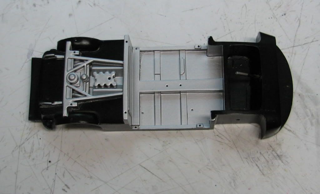

This is what I've done this weekend. From the reference pictures people have sent me, the interior of this car is completely wrong. I'm not going to do too much to it. Most of the modifications that I'm going to do are to the roll cage and to the pedal arrangements. But a lot of the stuff you're not going to be able to see so I don't plan to bother with it. The big hangup right now is the body. The plugs they give to fill in the holes do not fit very well. And in some cases are too shallow so I'll have to use a lot of filler.

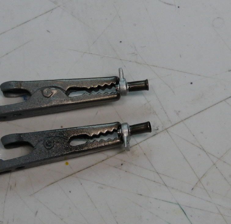

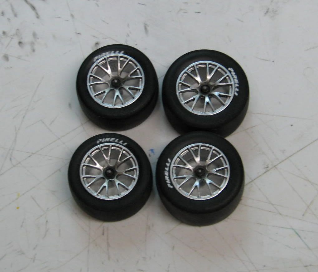

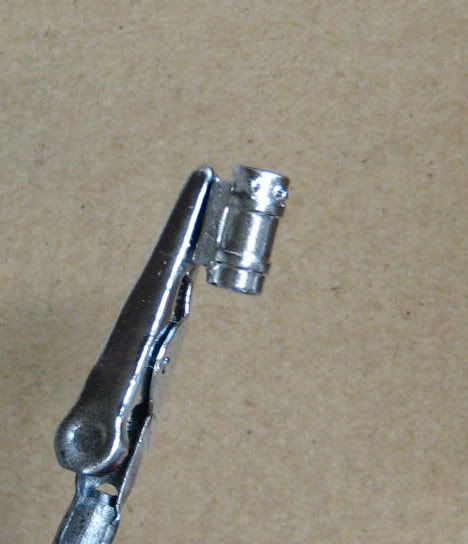

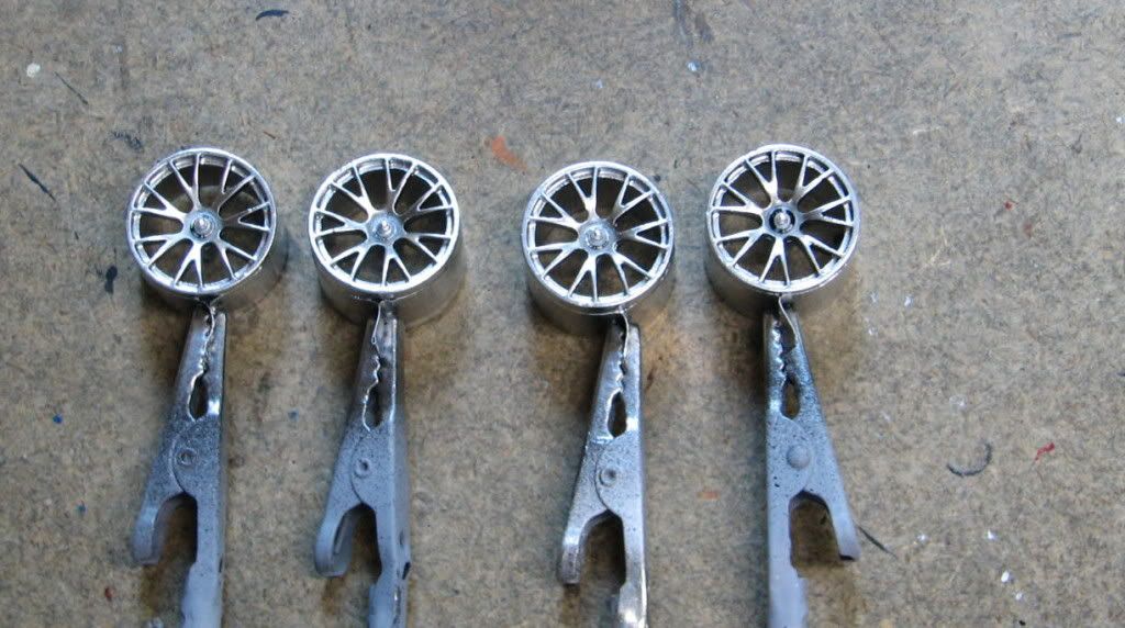

Rims are in Alclad Polished Aluminum and fire bottle in Alclad Chrome.

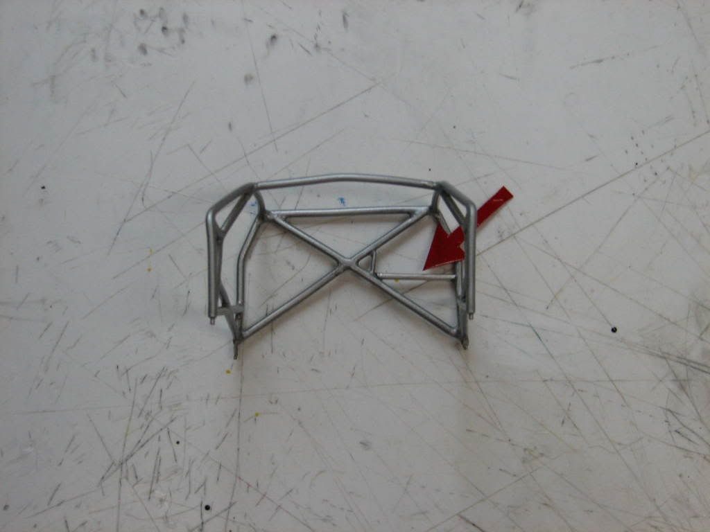

I finished painting the roll cage and noticed that I needed a bar for the seat belt attachments so I need to repaint the roll cage.

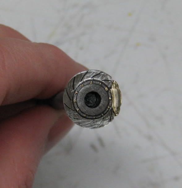

The disc brakes I modified with photoetch for the rotor surface that I had in my parts bin. They decided to not have a photoetch piece in the kit which makes no sense to me.
Here are a couple of pictures of the rest of the parts I had painted.

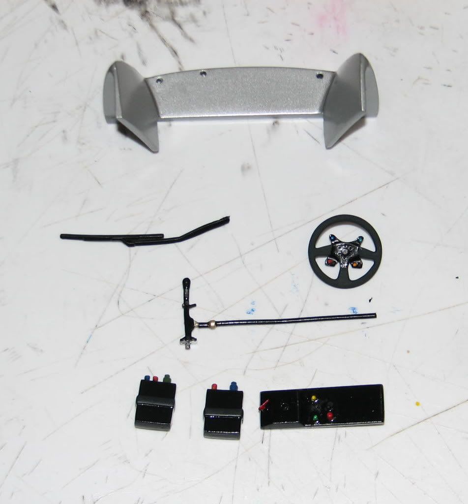

Got quite a bit more work done. Still haven't done much to the body, which is backwards for me since I usually start on the body first. Started to see some more small issues that usually pop up with the Studio 27 kits. Missing decals for the dashboard, completely incorrect engine bay compartment/layout, little things that people wouldn't notice unless they have reference pictures. Of course, I have pictures so it makes it stand out to me.

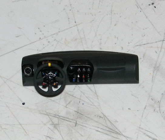

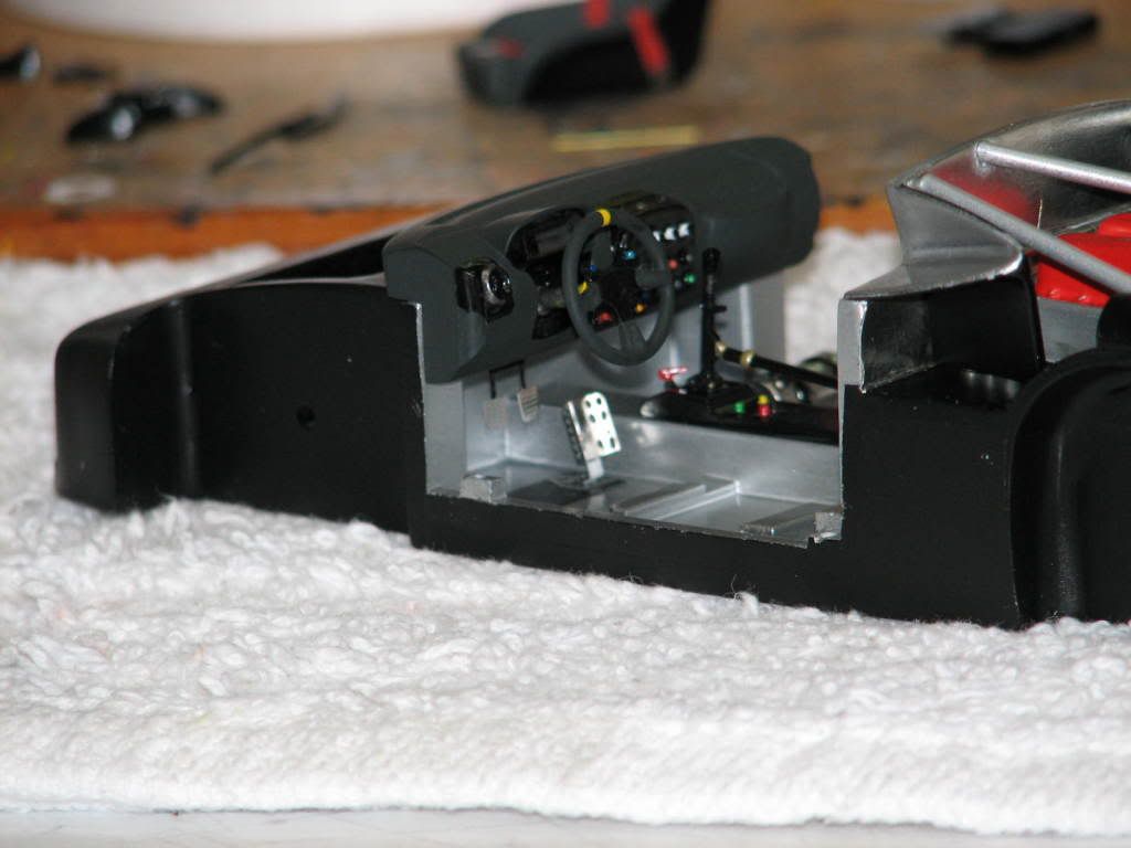

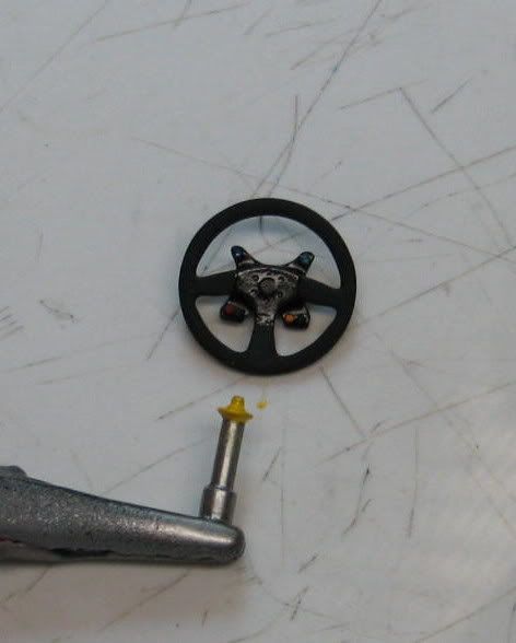

Here's dashboard and steering wheel column. I added some switches to the top of the dashboard and also to the main pamel of the dashboard to make it more correct. Also added wires to the electronic boxes. The decals on the electronic boxes are from my spare decal bin.
Fixed the roll cage. Added a bar across for the seat belts and a diagonal bar for the roof with some spare aluminum tubing that I had.

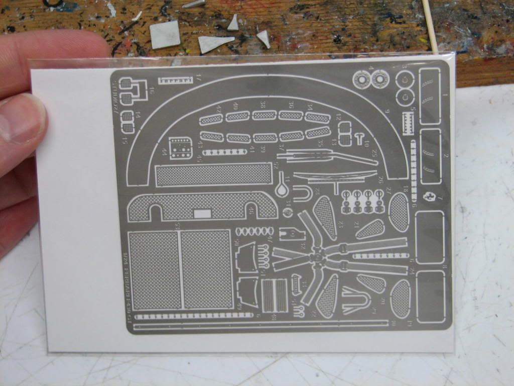

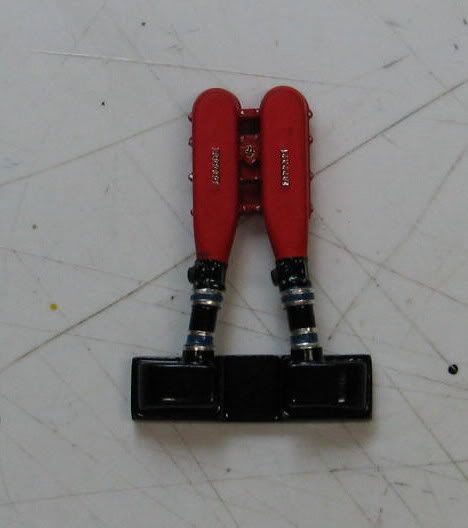

I did detailed photoetch to the air box from Crazy Modelers...their Ferrari Script Set. The Studio 27 photoetch left out the prancing horse and the scrip they give you is not the right size. Also added bare metal foil for the clamps.

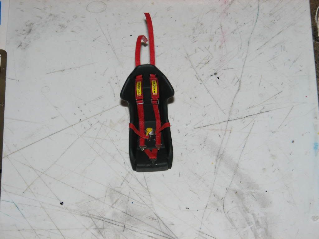

Detailed the exhaust with different shades of Alclad. Also drilled them out as well. Added homemade seatbelts to the seat. Another mistake that I caught in the kit is that they want you to put Michelin stickers onto the tires which the car clearly didn't run as there's a large sticker of a Pirelli on the side of the car. Luckily I had a Pirelli stencil that I used on the tires and yes, the stencil is supposed to be white and not yellow. Took me a while to find a good picture of the tires with the white on them.

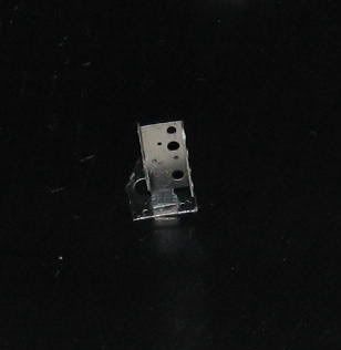

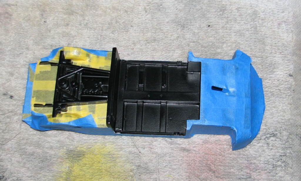

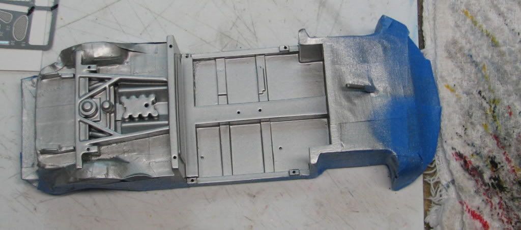

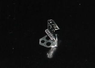

Got the chassis painted. Used Tamiya's TS-17 (aluminum) and TS-29 (semi-gloss black). Also ended up scratch building the accelerator pedal. They gave a piece in the photoetch but I lost it. Ended up taking some tin, drilling, then bending it to shape. Seems to look pretty close to the pictures I have of the actual car without the nuts and bolts. B)
Custom made pedal.

Looking good Brendan! I absolutely love your pedal though. I'm going to bet it's better than the P.E. supplied piece was!

You don't want to know how many times I screwed up on that. I figured I spent at least 6 hours trying to fiddle with it. I made it as a 3-piece unit. The bottom piece and the middle piece were easy but the actual pedal itself was not fun. I wish I hadn't lost the photoetch piece that was in the kit. It definitely would have looked better. With my luck, I'll find it after I've glued the body to the chassis.

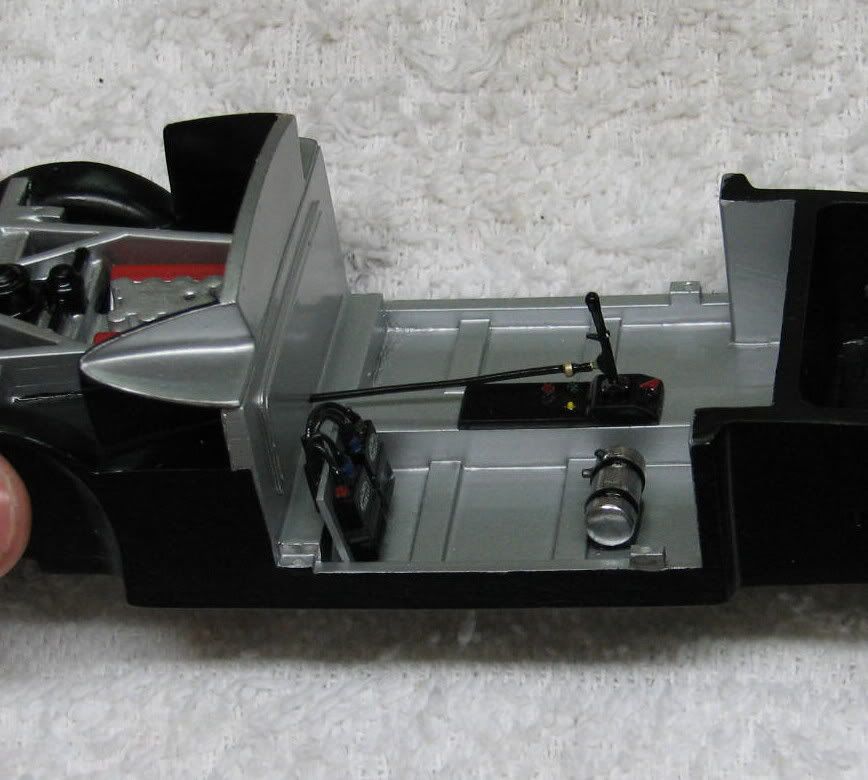

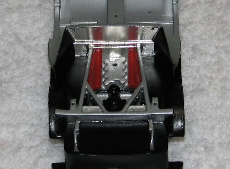

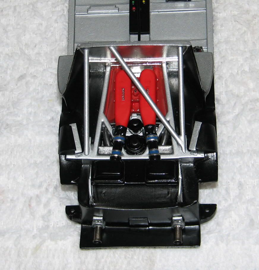

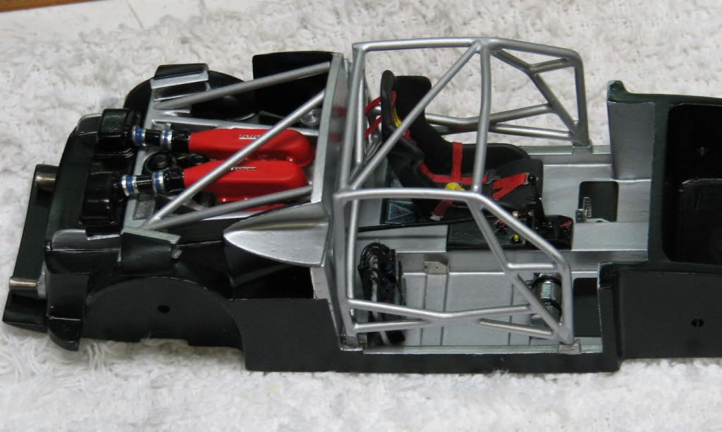

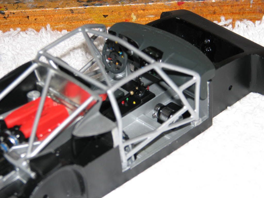

Got the chassis all put together. Kind of upset with myself...spent so much time on the pedal and where it's going to sit, you don't even see it. Didn't have any fit issues with anything. Just some small tweaking on the roll cage and the roll cage in the engine bay. That was mainly due to the parts being pewter.

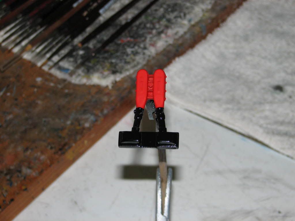

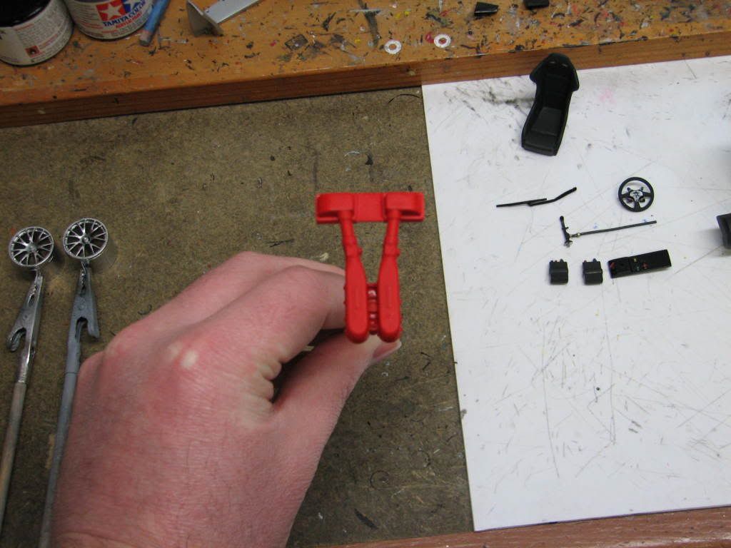

Painted the valve covers flat red and detailed with different shades of black. Put bare metal foil on firewall to represent heat shielding.

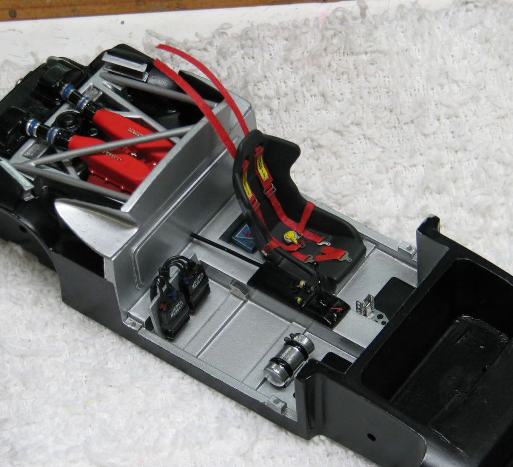

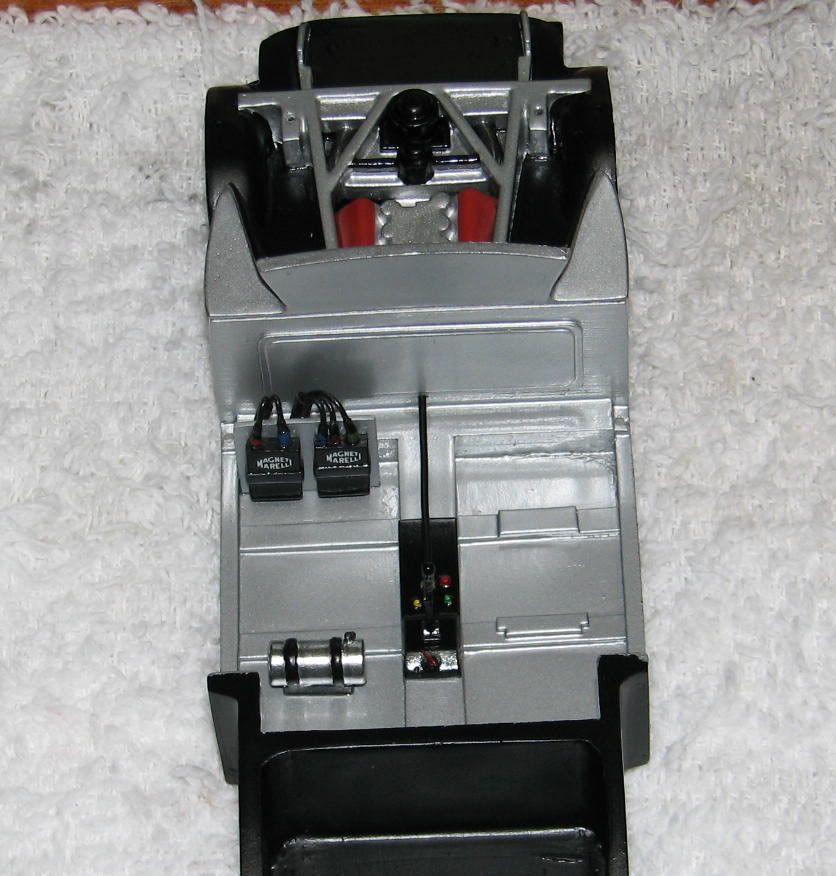

All the internal componants put into place.
Test fitting to see where pedal is going to sit in comparison to the dashboard.
Placing seat and roll cage into place and attaching seat belts to the roll cage. There's a tight fit between the roll cage and the dashboard but it will fit. Also added a metallic blue electronics box behind the seat.
