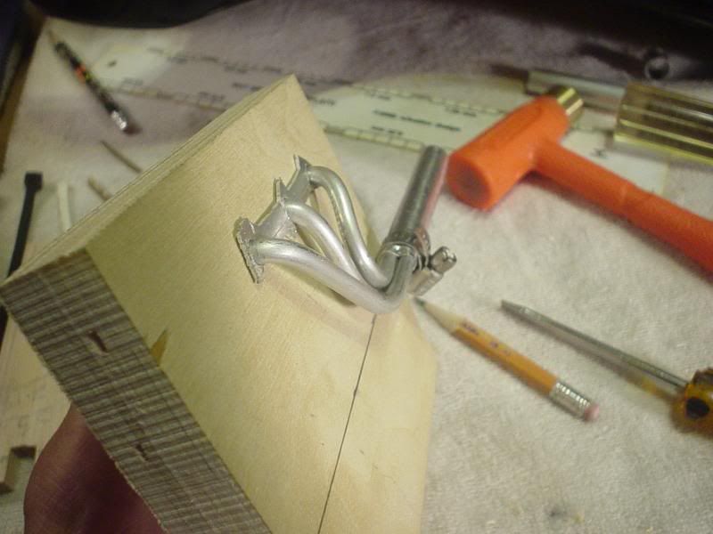

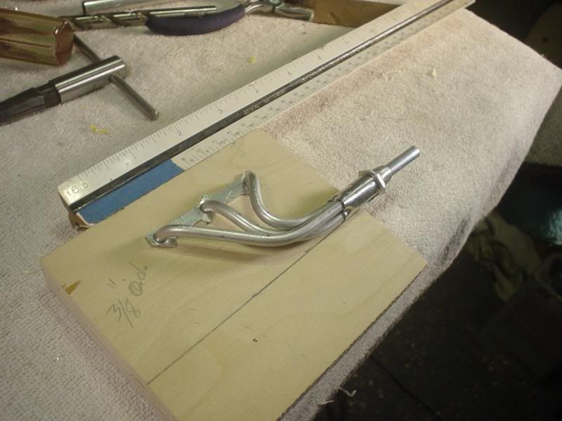

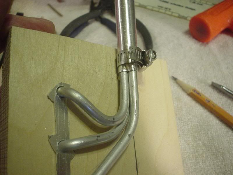

Ognib Posted August 3, 2013 Author Share Posted August 3, 2013 (edited) I like the throaty, subdued sound of big tube exhaust, but I don't want to go too big & unbalance the overall flow dynamics of the engine. Using 1/4" for exhaust & tail pipes, which scales up to 2"...about right for the small displacement of the flathead. My head scratch for today & maby tomorrow, as well...how to cleanly draw the end of the collector can down to hold the 1/4 exhaust tube...without destroying the nice crimp work around the header tubes. Edited August 3, 2013 by Ognib Quote Link to comment Share on other sites More sharing options...
Ognib Posted August 4, 2013 Author Share Posted August 4, 2013 A piece of 3/8 tubing slipped snugly inside the collector can. I'm hiding the slight .016 step between the two with the bolt rings that allow the exhaust pipe to be moved to the side for open header times. Chucked the 3/8 tube in my hand drill & rotated it on the running belt sander to be able to cut a clean cone taper down to the 1/4 exhaust pipe. This is all just roughed in at this point...will probably shorten the can and the cone for a more compact look in this area. The bolt ring needs to be shaped down, along with the block plate. Couple of days of detail work here...still have to bend & build everything for the other side as well. Quote Link to comment Share on other sites More sharing options...

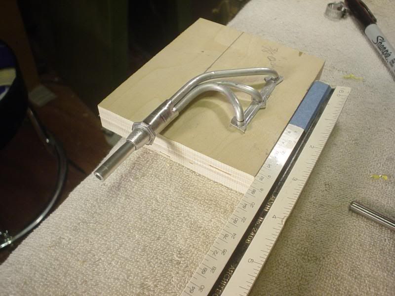

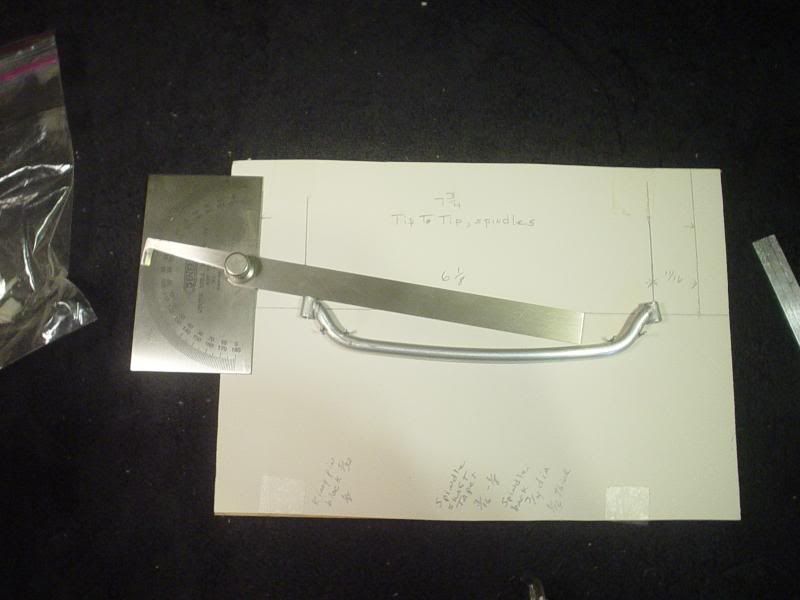

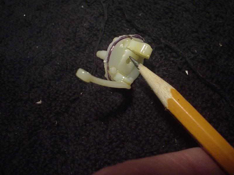

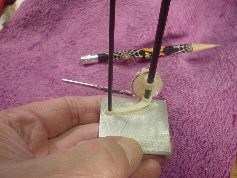

Ognib Posted August 14, 2013 Author Share Posted August 14, 2013 Using an angle finder off of a vertical line on the spindle jig, I've determined that the top of the axle king pin boss is 9 deg down from the horizontal line. The other side matches within 1/2 deg, so that'll simplify this process. The top & bottom of this block on the spindle plate must carry this angle so the spindle king pin bosses will fit the angle on the top & bottom of the axle boss, when assembled. Also the face of the block must be cut to match the end of the axle boss. When assembled, the spindle shaft needs to be on the horizontal line. See if I can pull this off... Quote Link to comment Share on other sites More sharing options...

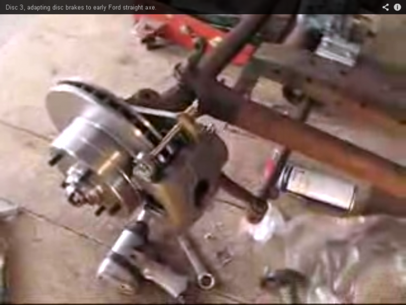

Ognib Posted August 15, 2013 Author Share Posted August 15, 2013 (edited) On-going project research. Couple of vids about disc brakes on early ford axle. He's an entertaining, chatty dude & his camera work is very good & clearly shows what everything looks like, perfect illustrations for what I'm building. https://www.youtube.com/watch?v=Z3HWc1mYVzQ https://www.youtube.com/watch?v=iiDO_DI6XIE Edited August 15, 2013 by Ognib Quote Link to comment Share on other sites More sharing options...

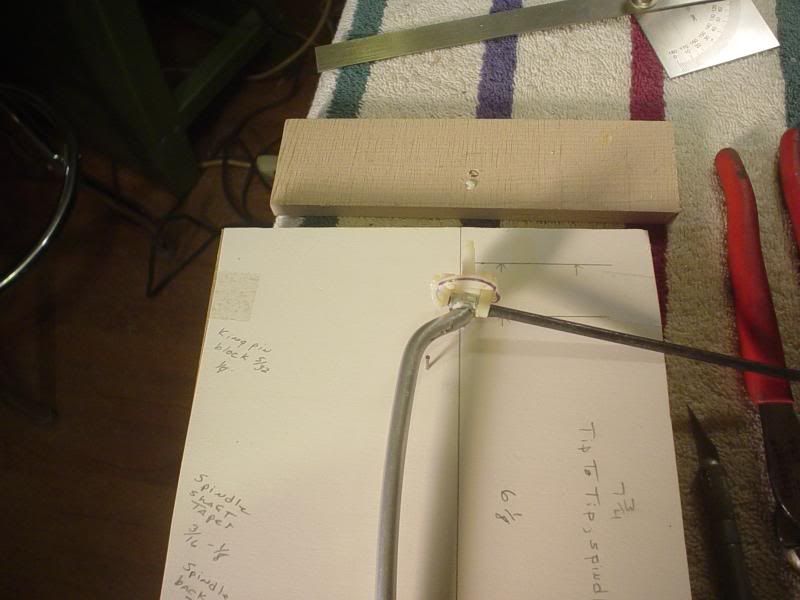

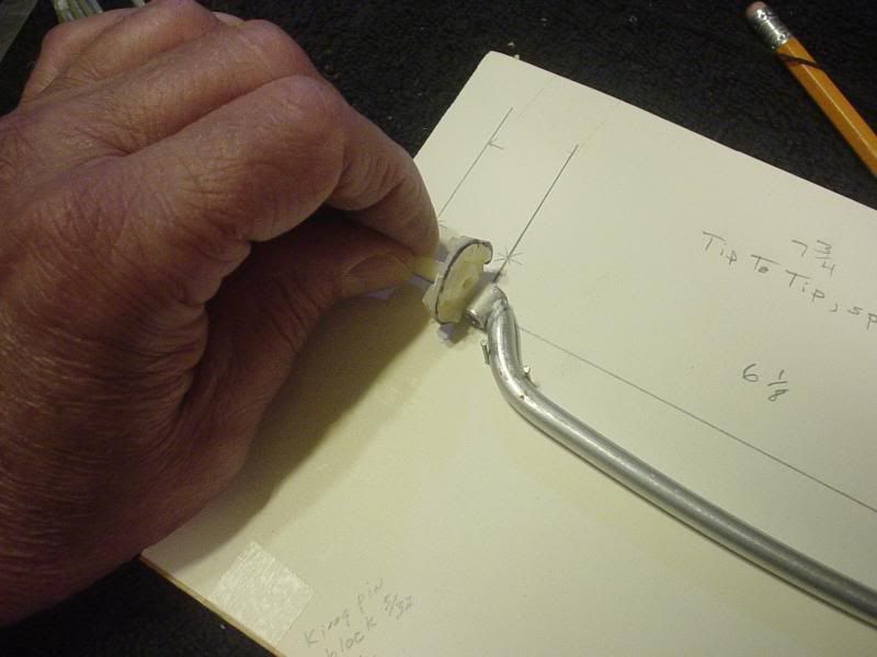

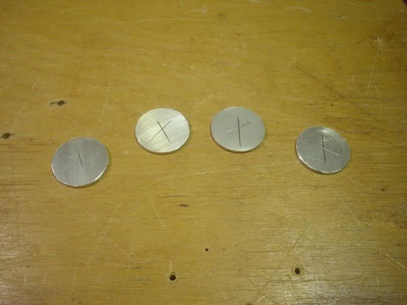

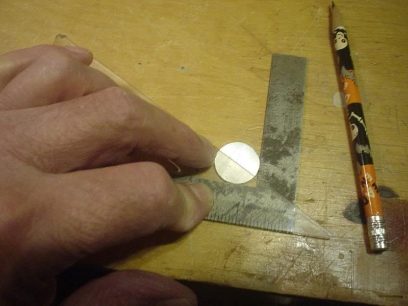

Ognib Posted August 16, 2013 Author Share Posted August 16, 2013 Laying out centers for drilling the spindle plates. Quote Link to comment Share on other sites More sharing options...

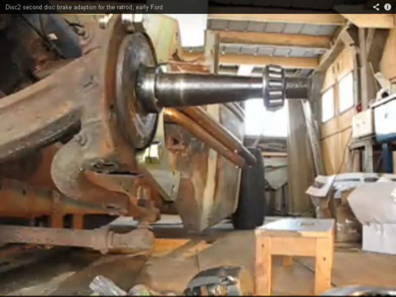

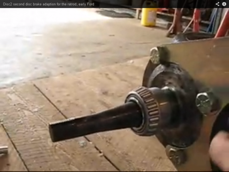

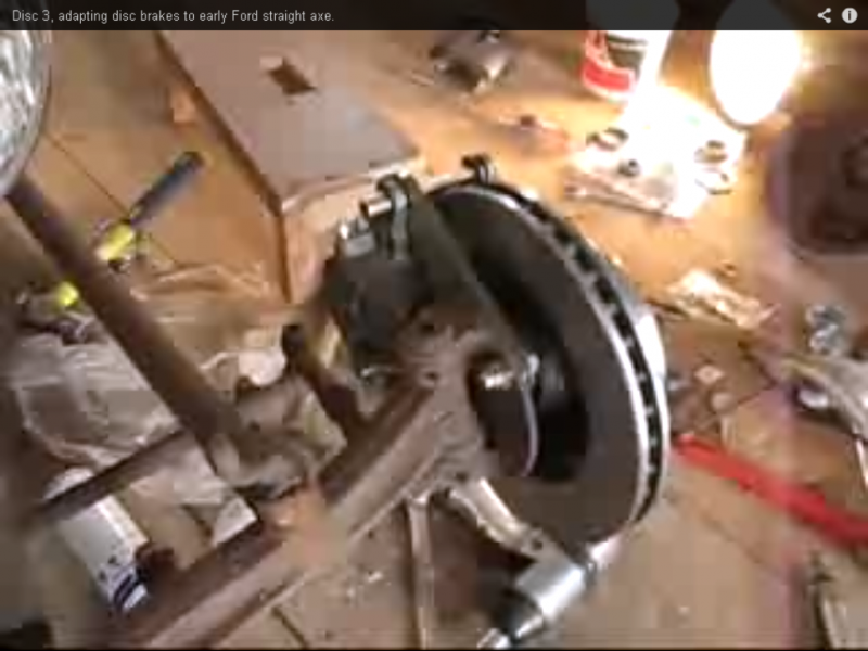

Ognib Posted August 17, 2013 Author Share Posted August 17, 2013 Couple of screen shots from the vids. This is what I'm going for...disc brake conversion on early ford spindles. Adaptor plate holds GM style caliper & GM style hub/rotor assembly used. Quote Link to comment Share on other sites More sharing options...
Ognib Posted August 28, 2013 Author Share Posted August 28, 2013 A couple more screen shots from the vids. Just about ready to move on these pieces & get them put together. Quote Link to comment Share on other sites More sharing options...

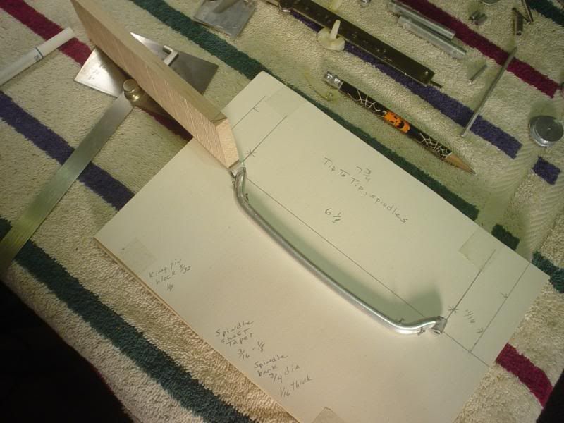

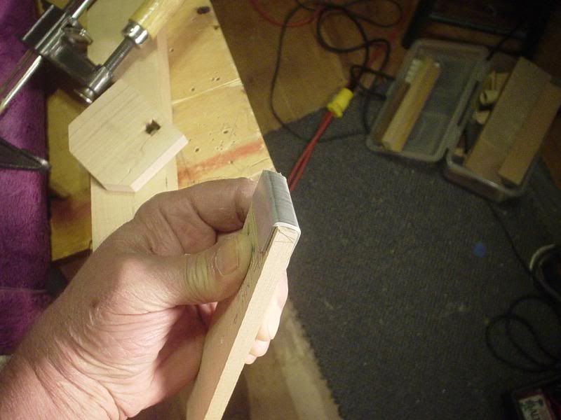

Ognib Posted September 9, 2013 Author Share Posted September 9, 2013 Putting a couple of hours on it this a.m. Piece of hard maple that dimensionally matches the axle boss...this is my bending fixture for the spindle bosses. Tapered across the end of it to match the angle of the axle boss, 9deg down from horizontal, as posted above. The plastic pieces are the templates I'm building off of so want to verify that they fit the axle properly before proceeding. Factoring in the taper of the spindle, nice match-up of the spindle to the horizontal line on the layout. I think I can proceed. Quote Link to comment Share on other sites More sharing options...

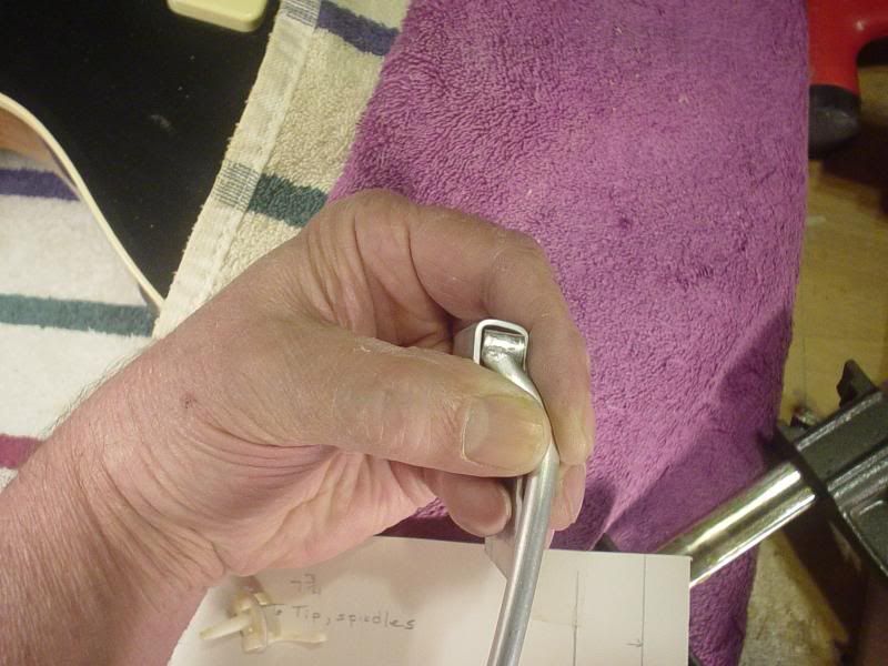

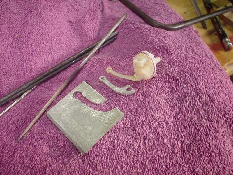

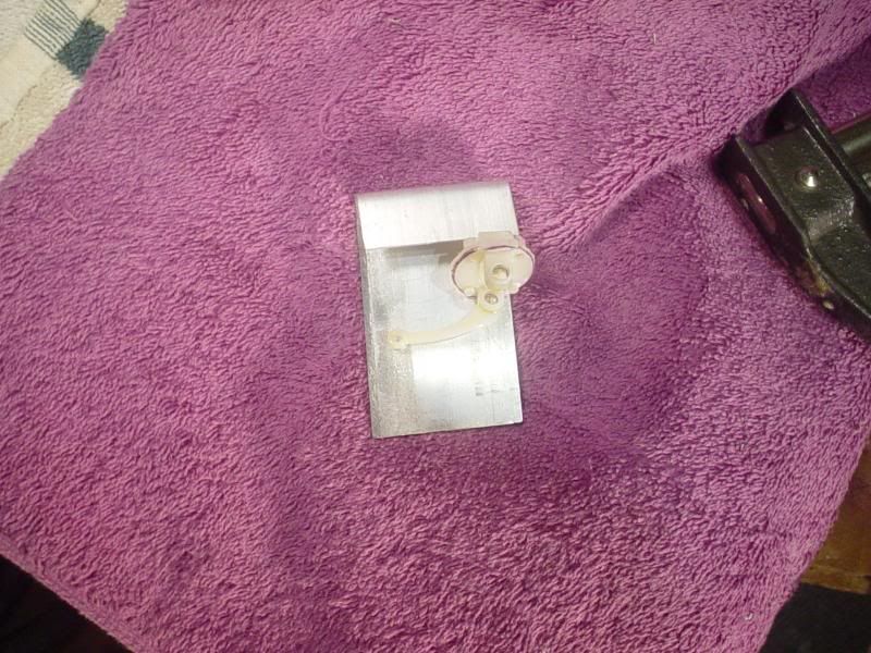

Ognib Posted September 11, 2013 Author Share Posted September 11, 2013 (edited) Thanks, Ken, really appreciate the comments. It's very rewarding when I get something to the point where I'm happy with it. The process of getting a part to that point is full of, "argh, how'm I gonna do this?" This is a piece of 1/16 wrapped around the maple bending caul. It was cut from a piece of extruded aluminum. It doesn't want to bend in a compliant manner & I'm noticing what appear to be stress lines along the radius of both bends. Need to find a softer alloy to work with. Dimensionally, it's correct for fitting the axle boss & the 9deg angle on the face seems about right. Edited September 12, 2013 by Ognib Quote Link to comment Share on other sites More sharing options...

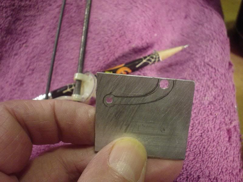

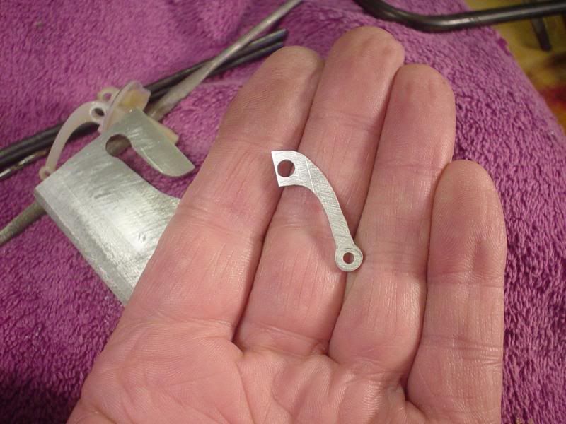

Ognib Posted September 11, 2013 Author Share Posted September 11, 2013 Drilled & pinned the tie rod arm & traced a line around it. This will be my build template. Quote Link to comment Share on other sites More sharing options...

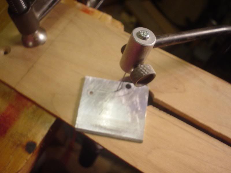

Ognib Posted September 11, 2013 Author Share Posted September 11, 2013 250 stroke per minute, hand powered jewlers saw. 30 min & one broken saw blade later. true up the lines a bit with a file & good to go. Quote Link to comment Share on other sites More sharing options...
futurattraction Posted September 11, 2013 Share Posted September 11, 2013 Amazing work, Ray. Did you have your jeweler's saw from guitar building or was/is it a modeling-inspired acquisition? Quote Link to comment Share on other sites More sharing options...
