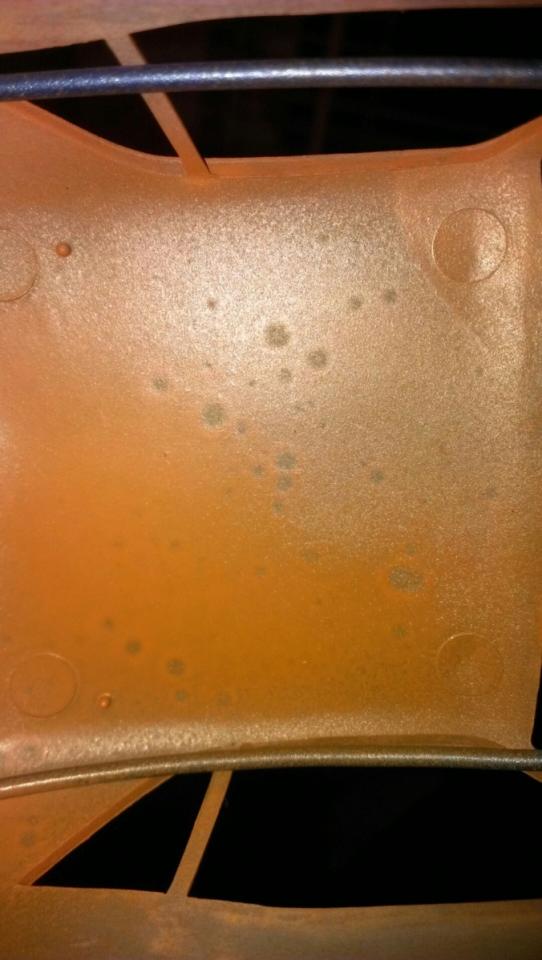

chicagojoe Posted March 23, 2014 Share Posted March 23, 2014 (edited) Just recently came upon this thread and the videos. I tried this method but im having a problem with it. When I spray, I get these small circles where the paint wont stick. Im using a badger 350 and about 20 psi. Any ideas what can be causing this? Edited March 23, 2014 by chicagojoe Quote Link to comment Share on other sites More sharing options...
cchapman195 Posted March 23, 2014 Author Share Posted March 23, 2014 Just recently came upon this thread and the videos. I tried this method but im having a problem with it. When I spray, I get these small circles where the paint wont stick. Im using a badger 350 and about 20 psi. Any ideas what can be causing this?IMAG1039.jpg Only thing I can think of is one, not mixed well enough. Two, something on the headliner that is not clean. Try rinsing the whole thing in the sink and wash with warm soapy water. That is an area the sometimes does not get cleaned well because we all focus more on the outside of the body. Then mix very well. I use a badger mixer but putting it in a bottle and stirring it well then put a lid on and shake the bageebies out of it. Any more problems let me know and I will see what I can find about it. Quote Link to comment Share on other sites More sharing options...
chicagojoe Posted March 23, 2014 Share Posted March 23, 2014 Ok maybe im not mixing it well enough. I sprayed it on something else and was having the same problem Quote Link to comment Share on other sites More sharing options...

blunc Posted April 10, 2014 Share Posted April 10, 2014 Ok maybe im not mixing it well enough. I sprayed it on something else and was having the same problem the spots where paint won't cover/stick are usually called "fish-eyes" by regular car painters, they are usually caused by oil or silicon based contaminants either in the paint or on the item you are painting. try adding a filter and/or moisture trap to your compressor and make sure the items to be painted have been properly cleaned and dried. Quote Link to comment Share on other sites More sharing options...
