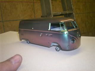

Longbox55 Posted May 12, 2013 Share Posted May 12, 2013 The top of this one is Dorado Dreams, and the bottom is Caribbean Surf. The base was the Kustom Kolor Basecoat Black, which is a gloss black. I don't have a pic of it, but I did do a test of Aquarius Shift on a surfboard from a Surfite kit over black, it has a very striking dark blue/dark green color shift. Quote Link to comment Share on other sites More sharing options...
