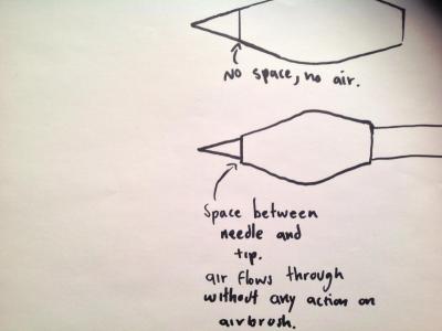

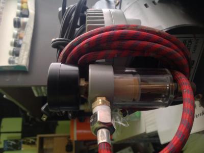

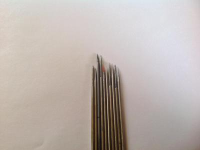

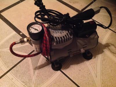

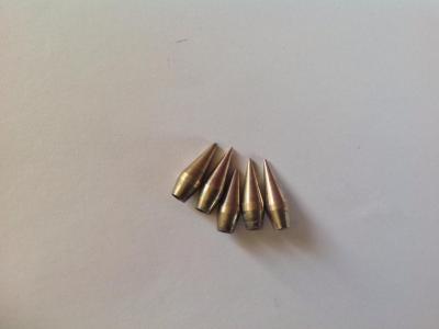

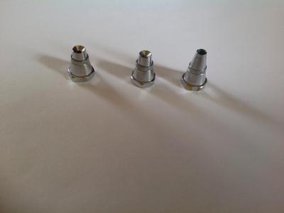

Ok, here are some pictures, the needles I have and the tips and heads, also on the drawn diagram, I was wondering if there is suppose to be absolutely no gap between the tip and needle? Or just a tiny bit? And the last one is the regulator, piece I was talking about! Thanks!
It's the air flowing that draws the paint out with it.
And this thing appears to be nothing more than a water trap and a pressure gauge. post-14627-0-93202900-1415563100_thumb.j
A regulator will have some kind of adjustment knob on it as well.

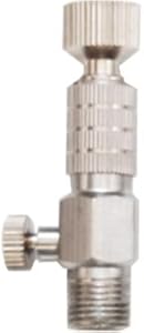

There are also several types of small regulators that attach at the airbrush itself... 21dvvxiJgXL._SY300_.jpg ...but without a gauge, it's hard to get consistent results.
Did it come with any instructions? If not, you probably ought to get some.

thanks for the help guys, really helping me out here! about the needles and tips I actually dont know which go together, I pretty much matched the number "3" head with the needle that had 3 grooves on it, but I don't know what tip goes with the combination, as to the needles being dirty, can I use some sort of wet sanding with thinner? I used water as a test, but than again the same thing happened, with no gap between the needle and tip, water barely comes out, with a gap between the two the water will come out, but air is constantly going through? by the way where can I get that preasure regulator?

My guess is the dirty needles are a large part of your problem. Wet sanding is a last resort. Try cleaning them with lacquer thinner or acetone. Judging by the needles, the nozzles are also probably filthy. Soak them in acetone or lacquer thinner and swab with cotton on a whittled down toothpick. Hold them up to a light and look in the large end. You should see nothing but shiny metal. Match the nozzle to the head by comparing the size of the openings. Number 1 is the smallest and 5 the largest. Check the needles for burrs on the end and the nozzles for tiny cracks.
Don't let solvent get in the air valve. If you are getting air all the time, the air valve may be stuck open or the tiny o-ring inside damaged. If you take it apart, be careful not to lose the tiny components.
Don

Ok, so I ran lots of fluids through the airbrush and this is what happened, with the size 1 needle tip and head, I can shoot water no problem, but I think the compressor doesnt make enough preasure because, A- there is no regulator , and B- the O ring that seals the air in the airbrush is missing, gonna buy both today, lets see how this goes!

There is only one o-ring in the VL, and that's in the air valve. If it's the old style, it's part number A52. The new style air valve gets part number A53. Have a look at this diagram. There is a packing nut, but that's not likely to be your problem.
If you can spray OK with the #1 nozzle, but not the larger sizes, I think your compressor is tired. The seals do wear out.
A little air leak at airbrush joints is normal. It can usually be stopped with a little bees wax or Chapstick on the threads.
