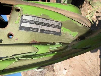

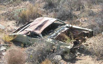

Scott Colmer Posted October 16, 2014 Share Posted October 16, 2014 This is is an abandoned Challenger that is resting in a ravine behind a friend's housing tract. You can see it from his backyard, but you can't see it from the road at the top of the ravine. We hiked down and shot some pics. To my surprise I still had a vin tag on the door. I found out that it is a 73 Challenger that was built in LA. It came with a 383. 4BBL. How it got in the ravine, I would love to know. Any sleuths out there? Quote Link to comment Share on other sites More sharing options...
1930fordpickup Posted October 16, 2014 Share Posted October 16, 2014 No engine or trans? Fell off a trailer going down the road? Quote Link to comment Share on other sites More sharing options...
chunkypeanutbutter Posted October 16, 2014 Share Posted October 16, 2014 Stolen, joy ridden, and dumped, most likely. Parts hunters come and take the engine, front clip.... Kids shoot out the windshield... That's what I suppose. Quote Link to comment Share on other sites More sharing options...
Casey Posted October 16, 2014 Share Posted October 16, 2014 That's a fairly early 1970 model, the 2388th vehicle produced at that plant in September 1969. Have you posted this previously on the moparts.com forum? I swear I've seen it before... Quote Link to comment Share on other sites More sharing options...
keyser Posted October 16, 2014 Share Posted October 16, 2014 It'll be a "barn find" that's minty in 15 months. LOL Quote Link to comment Share on other sites More sharing options...
Maindrian Pace Posted October 16, 2014 Share Posted October 16, 2014 Tell the Graveyard Carz guys. They'll fix'er right up. Quote Link to comment Share on other sites More sharing options...
Scott Colmer Posted October 16, 2014 Author Share Posted October 16, 2014 (edited) This is the first place I've ever posted it. I did send a pic to Hot Rod for their Scene by Readers section. No response. I wonder if there is someone out there who never found out where their Challenger ended up. Edited October 16, 2014 by Scott Colmer Quote Link to comment Share on other sites More sharing options...
unclescott58 Posted October 16, 2014 Share Posted October 16, 2014 (edited) If it was a '73 Challenger it would not have come with a 383. I'm trusty in Casey's reading of the vin tag on this one. Scott Edited October 16, 2014 by unclescott58 Quote Link to comment Share on other sites More sharing options...

ChrisPflug Posted October 17, 2014 Share Posted October 17, 2014 (edited) The VIN is for a 1970 R/T with the base 383 Magnum If the dash VIN and fender tag are missing the car probably "lives on" on a previous 318 equipped base model Edited October 17, 2014 by ChrisPflug Quote Link to comment Share on other sites More sharing options...
Scott Colmer Posted October 17, 2014 Author Share Posted October 17, 2014 It might have been a 318. I was going from memory. I tried to find an owner, but the internet wold not give that info up to me. Quote Link to comment Share on other sites More sharing options...
ChrisPflug Posted October 17, 2014 Share Posted October 17, 2014 Was saying that it may have been used as a parts car then abandoned and the VIN switched to a cleaner but more common base model Challenger Some of the Mopar boards keep track of VINs from known wrecks beyond repair and the occasional VIN plate/fender tag/and title that shows up for sale- on more than one occasion a nicely "restored" car later comes up for sale with that VIN The VIN in the photo is for a Challenger R/T originally equipped with a high performance 383- the standard engine for the R/T model "JS" designates R/T, "JH" would be a base model, "23" a hardtop ("29" would be an SE), "N" for 1970 the 383 4 barrel, "0" the model year, 1970, and "E" the assembly plant The VIN number and scheduled build date were assigned to each vehicle in advance but the door sticker was applied at the end of the assembly line and accurate in determining when a particular vehicle was built. Normal model year changeover was usually around early July with the plant shutting down for a couple weeks for the switch before actual regular production so a September built Challenger would be a fairly early example Quote Link to comment Share on other sites More sharing options...
1972coronet Posted October 18, 2014 Share Posted October 18, 2014 The thing which I find *odd* about this car : FJ6 green on a pre-Spring 1970 build , especially from the relatively-obscure Los Angeles (City of Commerce) Plant ! Its sequence number is low ; I wonder what its actual build date was ; where it was sold new ... Quote Link to comment Share on other sites More sharing options...
ChrisPflug Posted October 18, 2014 Share Posted October 18, 2014 Looks like FF4 Light Green Metallic originally with the brighter green being a later repaint and almost completely peeled off An original door sticker is the most accurate way to tell the actual build date- the label was printed and attached as the car was being completed in the factory- the scheduled build date as found on the fender tag can often be off quite a bit depending on vehicle and the VIN/ sequence number was assigned before the car was actually started to be built- the cars coming off the line wouldn't necessarily be built in the same order as the numbers assigned Quote Link to comment Share on other sites More sharing options...
MyBradKeselowski Posted October 18, 2014 Share Posted October 18, 2014 What I would like to know is how this can be a 73 Challenger when the tag has a production date of 9-1969.. :blink: Quote Link to comment Share on other sites More sharing options...
Ace-Garageguy Posted October 18, 2014 Share Posted October 18, 2014 Looks like FF4 Light Green Metallic originally with the brighter green being a later repaint and almost completely peeled off A poorly done color-change is often a sign a car has been "misplaced" somewhere along the line. Quote Link to comment Share on other sites More sharing options...
ChrisBcritter Posted October 18, 2014 Share Posted October 18, 2014 Might be a good start for the first-ever LeMons Challenger? Bet it's not even that rusty underneath. Quote Link to comment Share on other sites More sharing options...
1972coronet Posted October 18, 2014 Share Posted October 18, 2014 Looks like FF4 Light Green Metallic originally with the brighter green being a later repaint and almost completely peeled off Good eye ! Until I looked at the pics in their larger size , I thought that the colour behind the J6 was just oxidised metal . Quote Link to comment Share on other sites More sharing options...

ChrisBcritter Posted October 23, 2014 Share Posted October 23, 2014 Just ran the VIN JS23N0E102388 through the NICB database and it's not coming up stolen; if you had the license number and last five digits of the VIN you could run it through the CA DMV database, that would give a lot more info re salvage/junk, last registered, etc. (I just found that the low-mileage garage find '78 Subaru 4x4 wagon my boss just got has $619 in back fees... ) Quote Link to comment Share on other sites More sharing options...
