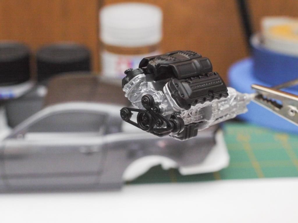

While my paint is curing I started to paint and assemble the engine, and other miscellaneous suspension parts. I decided to go ahead and use the boss motor even though mine is only a V6 because I've already spent way more than I had intended, and finding a kit with a modern looking V6 is nearly impossible it seems. I'm using Tamiya TS-6 Flat Black for the sprue with the air box, intake manifold, valve covers, etc., and also the radiator. Everything else was done with Tamiya TS-29 Semi Gloss black. There's not as much of a difference between these two as I thought there would be. I'm not 100% sure they were worth the money compared to what I could've got at Walmart, or Autozone.
Here I've cut off, sanded smooth, and touched up the parts that I currently need to put the basics of my engine together.
You can't see the oil filler cap very well in the picture, but I've already glued that in place. I needed to do that so I wouldn't lose it as it is tiny! Also, the engine block, heads, and transmission are all brush painted Flat Aluminum with Tamiya XF-16. I love this paint! It looks like a near perfect match to Fords all aluminum engines.
And here is the basic completed engine. There's still a couple small parts that I need to get painted and added like the oil filter, starter, AC compressor, and headers, but here is how it looks so far. I'm very happy with how it's turning out!
