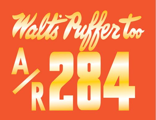

Brad, The car is a tomato soup red. The lettering appears, to me anyway, to have been masked off then sprayed. Look at how blocky the characters are - not fluid. The "bands" that go across the letters look like they were kind of faded on with a touch up gun. The lighter color is a pure white and the darker tone is a medium yellow. Here are the kit decals to show you how far off they are. (Plus the number needs to be A/R -not A/A 284 - not 285.

Brad that looks really good. I was resigned to making a mask and painting.....yuck.
Three questions: What color is the background? Will that print like that? What program do you use for the graphics?

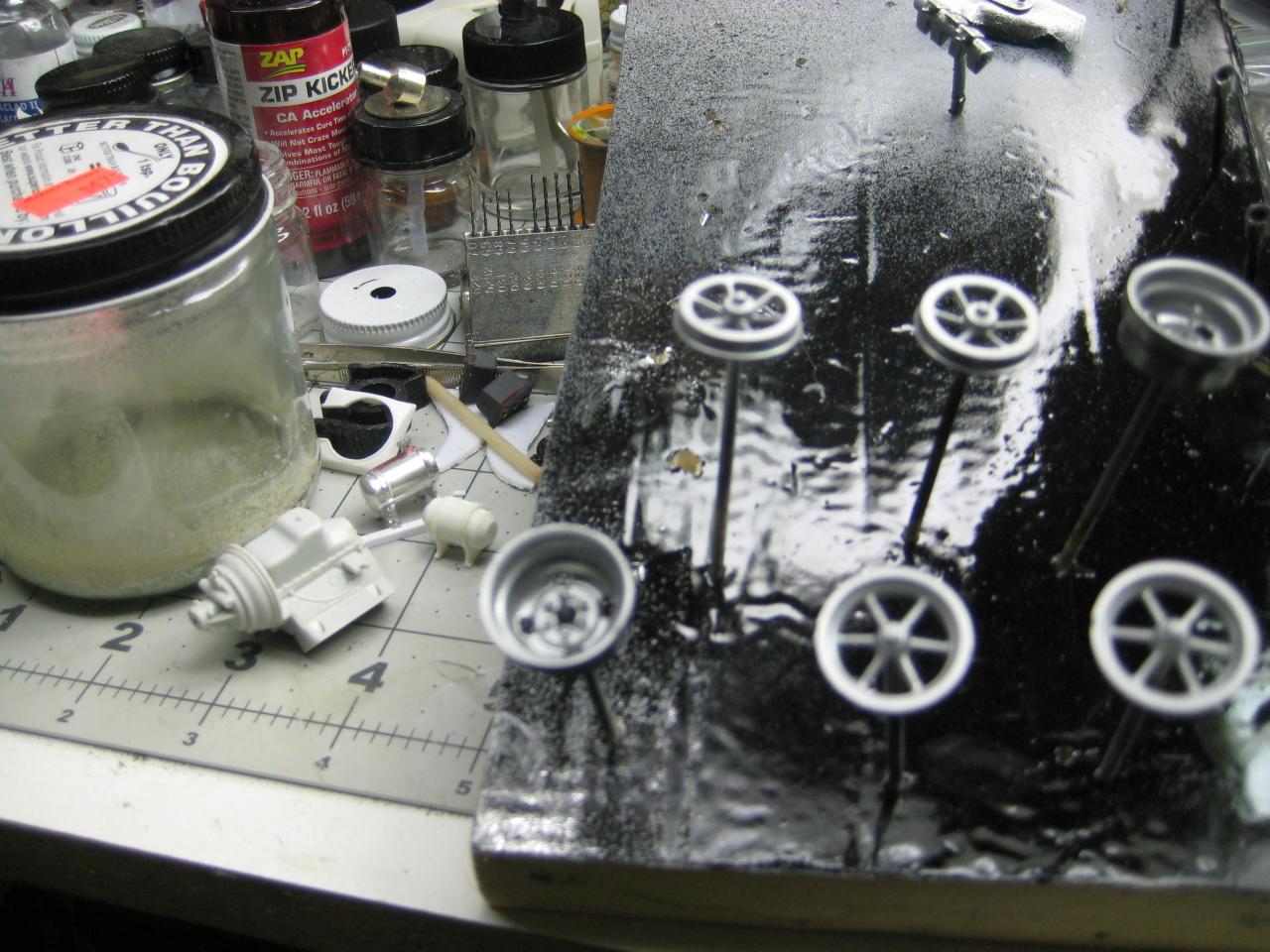

I have been painting, dunking bad painting, painting more, Alcladding (Is that a real verb????), prepping more stuff for paint, dehydrating (body in primer right now), stripping chrome (also now) and picking out the odd pieces for the build. I will (start to) get something put together tomorrow....and I'll put up some pics so you don't think I'm sandbagging.
Thanks for looking in.

Pat - the program i use is Adobe Illustrator and in this case, using a photo as a template. The background color is just for viewing only. It will be white, yellow with a bit of magenta mixed in with the yellow just as shown without the reddish color in the background.

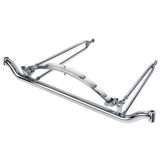

Could you explain how you built the front axle and spring?
I didn't see a front axle and spring in either of the progress photos posted so I'd be interested in that too. In fact, I didn't see any pictures on the innerweb that showed what this had for a front axle and suspension.

Here comes a D/A question; The wishbones on the sides, do those things actually move, or are they for adjustment purposes only. I've never seen any on a real car, much less on a car thats moving.

yes wish bones move, they locate the axle front to rear an travel in an arch, as a rule of thumb the steering rod or drag link should be as long as the wishbone so they travel in the same plane with minimal bump steer. the hiem joints/rod end's at the axle end allow you to adjust caster. The axle is located side to side by a panhard rod, wishbone, or in some cases the leaf spring its self, Traditionally a wishbone front was sprung by a transverse leaf or a torsion bar in the high end cars but it isnt uncommon to see coil overs or even air bags these days.
I hope this was still moc up stage
