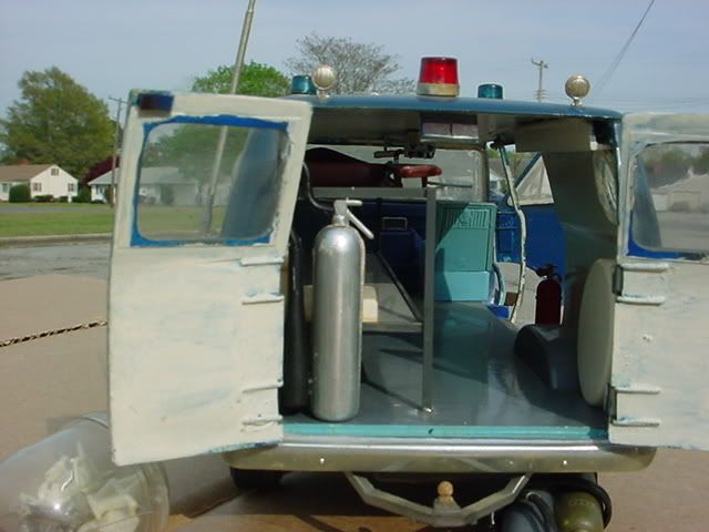

I did it on a Jo-Han Ambulance.
Got to Find it to take pic's though!!
I used Auto World hinges on the second doors.
(The ones that almost match the 48 Woody pic.)
These on the rear doors of my AMT Chevy van Blue Rescue
Hinge is 2 piece. Wire and Sheet brass.
Wire section is a Squared off 'U' with the two sides bent into "L's"
Brass sheet is folded over to wrap around the Center of the wire, and also "L'd"
One piece is epoxied/super glued to the door, the other to the body/pillar.
I straightened the part mounted to the pillar on the Ambulance due to the narrow width of the B Pillar.
It extends into the cabinet/driver divider instead.
