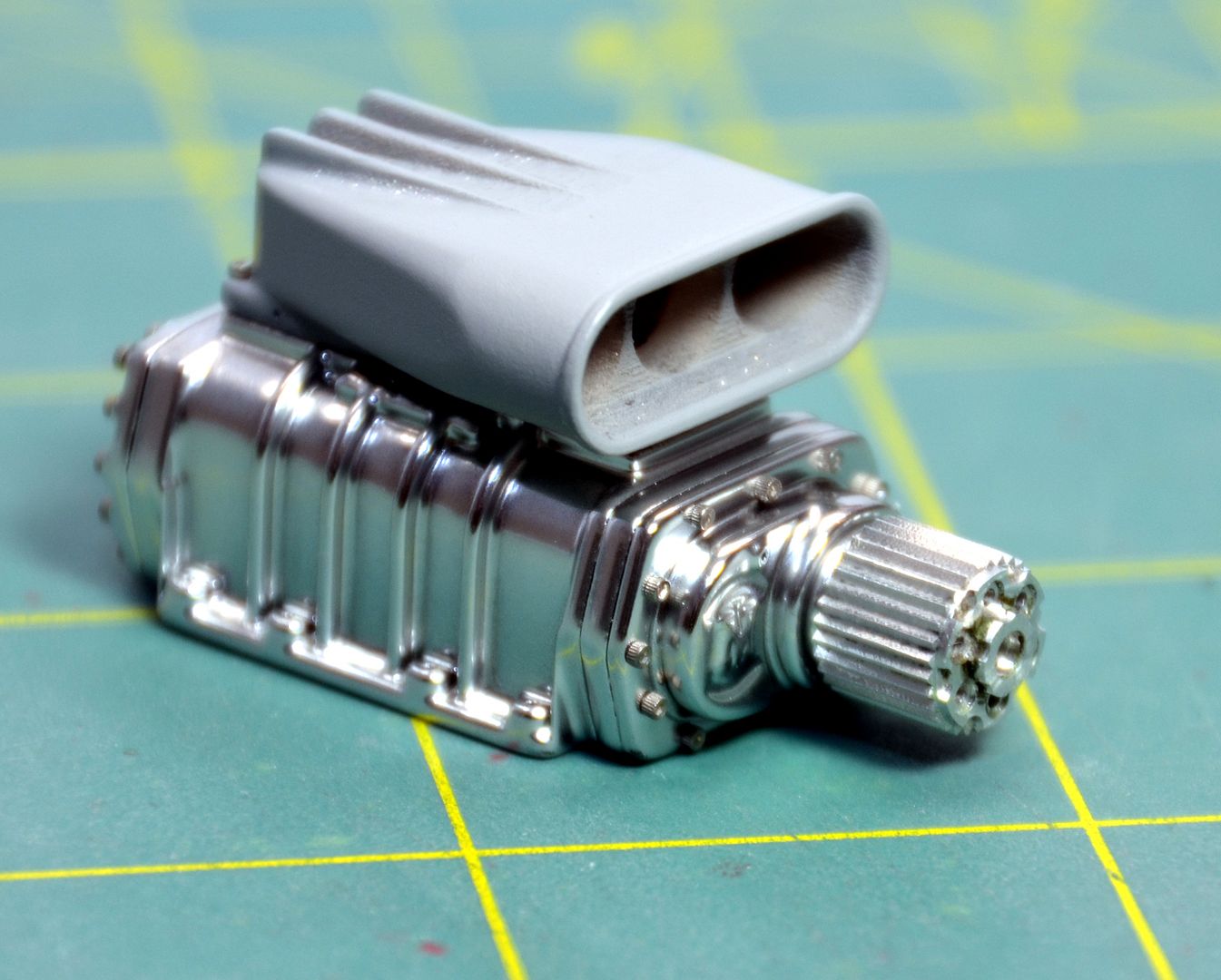

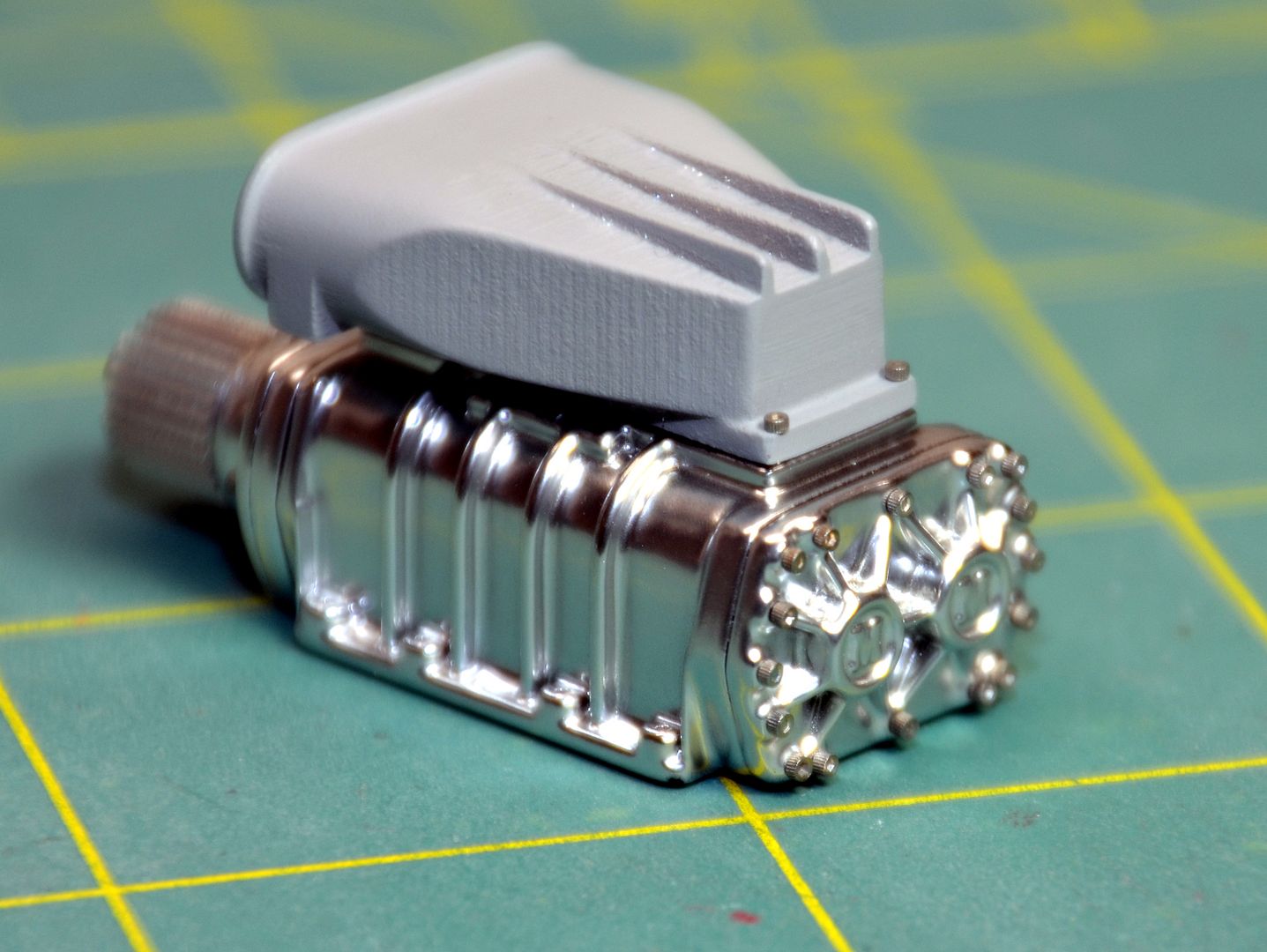

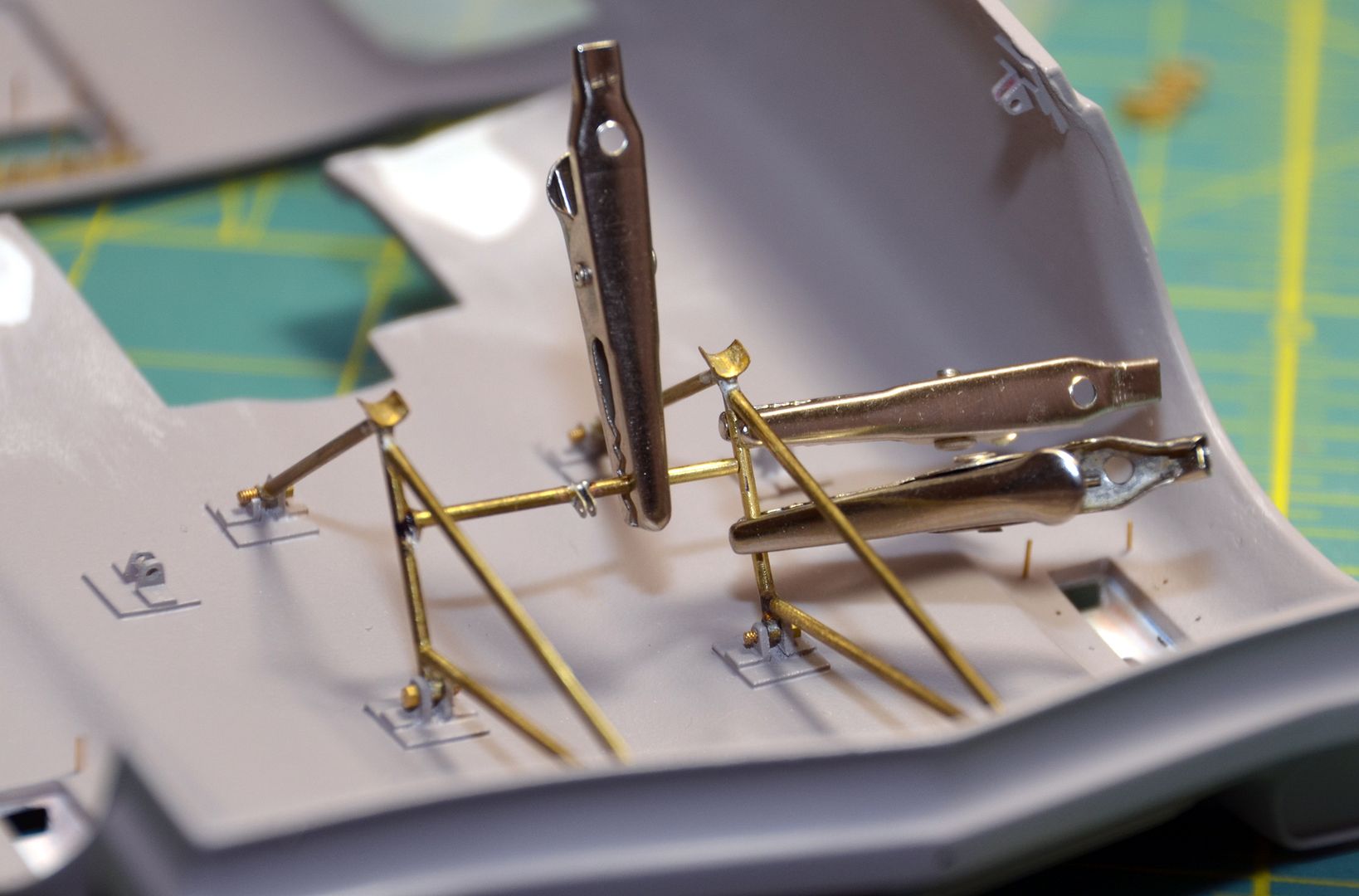

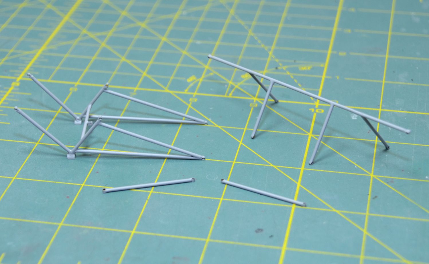

Mooneyzs Posted June 9, 2015 Author Share Posted June 9, 2015 Ok Fellas as I mentioned I was going to get a couple of pics up to show some progress so here goes.... Well this one is actually a rework picture...lol.... SO originally the cross bar on this front body support structure was glued with super glue and while I was sanding it for primer.... well I broke it. So I thought let me solder it back together and try to use some alligator clips as heat sinks so I wouldn't undo all of the other joints that were soldered. IT worked like a charm. I forgot to take pics of it when it was done before I sprayed primer on it: Here are all of the body support structures in primer. I need to do some minor body work on them to fill some pin holes and stuff like that. so I will get them fixed and some more primer on them so I can get them in paint: I have to apologize for the next two pictures because they didn't turn out worth a darn. I couldn't get the camera to focus on what I wanted. But here is the blower with the bolts on the front and rear plates: Quote Link to comment Share on other sites More sharing options...

RAT-T Posted June 9, 2015 Share Posted June 9, 2015 CHRIS, IS THIS BLOWER CHROMED, OR IS IT ALCLAD? Quote Link to comment Share on other sites More sharing options...

Davewilly Posted June 9, 2015 Share Posted June 9, 2015 Blower looks great Chris! John....man that is some funny s&^% right there! I dont care who you are...thats funny! Quote Link to comment Share on other sites More sharing options...
Codi Posted June 9, 2015 Share Posted June 9, 2015 And if anything will show a flaw, it's Alclad. Shows how good your prep really was Chris. Cheers, Tim Quote Link to comment Share on other sites More sharing options...
Ognib Posted June 10, 2015 Share Posted June 10, 2015 Blower looks good, Chris. Quote Link to comment Share on other sites More sharing options...
Mooneyzs Posted June 10, 2015 Author Share Posted June 10, 2015 (edited) Tom... the Blower is painted with alclads polished aluminum and then I cleared it their Aqua Gloss which looks like a milky clear. I also used House of Kolor black base and cleared it with urethane clear for the base. I found that using the HOK black base and urethane clears I get a better finish than using alclads black base. But that is just my experience Joe... thank you. Hey any news on the house front for you?? Dave... thank you. I am still cracking up at that pic. Tim... thank you very much. I can't tell you how important the prep work is. The better its prepped the better the results. You are best off to primer and block it out with 1000 grit or finer paper. The smoother the base the better the finish. Ray... thank you very much Edited June 10, 2015 by Mooneyzs Quote Link to comment Share on other sites More sharing options...

RAT-T Posted June 11, 2015 Share Posted June 11, 2015 Tom... the Blower is painted with alclads polished aluminum and then I cleared it their Aqua Gloss which looks like a milky clear. I also used House of Kolor black base and cleared it with urethane clear for the base. I found that using the HOK black base and urethane clears I get a better finish than using alclads black base. But that is just my experience THANKS CHRIS, I WENT BACK TO PAGE 200-201 & CHECKED IT OUT. DO YOU SAND OR RUB OUT THE CLEAR BEFORE THE ALCLAD? Quote Link to comment Share on other sites More sharing options...
