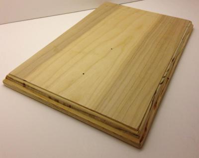

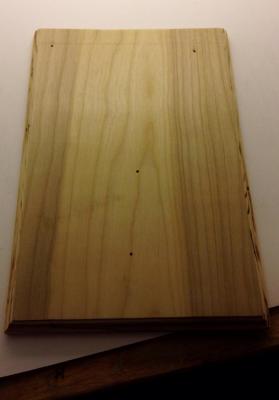

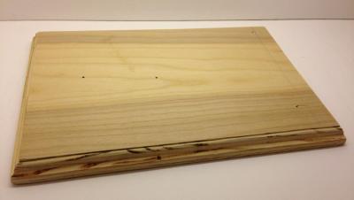

Step 1
The base here is 20cm by 30cm.
Start out by cutting to your desired size. If you have a square handy, it's always a good idea to double check and make sure everything is nice an squared. I agreed with this size because I can easily put it on a shelf if I choose or if you do model car shows, it's a decent but affective size to display your model car. Or if you have something that's not a car you can make it to size for that as well. But this how to is for cars specifically 1/24 & 1/25th scale.
Step 2

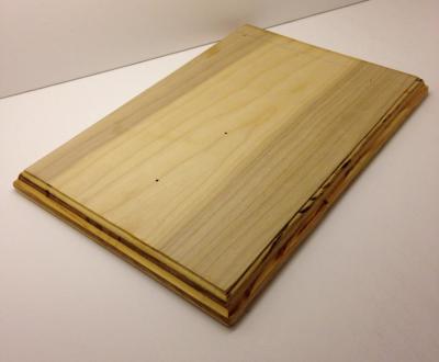

Once you get your board to the desired size, go ahead and rough sand it with 100 grit sandpaper. Along the cut marks, so there's no sharp points or splinter pieces.
Using doubled sided tape or nails (which is what I used). Secure the board to a work bench or another piece of wood. Using the double sided tape or nails, secure it down. So it won't move around while your routing.
One thing to note if use nails and you plan to have this base as a plain wood base. You may want to use only double sided tape, so the fill marks can't be seen through the paint or stain, that you'll be applying later.
Once that's done, grab your router and rout the edges using the desired bevel that you prefer, and make sure it's a bearing bit. And run it along the sides of the board until your happy with the rout/ shape. After that's done sand everything down with100 grit, followed up with 220 grit sand paper. I corned the edges off on mine.
This is what you should have by now.

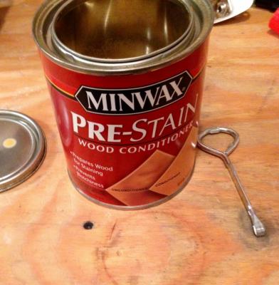

Step 3
Now it's time to determine if you want to spray paint, or stain the trim or the entire base. If you prefer to just have a wood base by itself. If you want to add a diorama into the base then only paint or stain the trim.
I chose to stain mine. So I cleaned the base with some naphtha to remove any oil, dust or dirt. (You could use a lightly damped rag for this as well)
Then proceed to apply your pre condition stain, to help aid in blotchiness of the stain.
Follow the directions on the can of stain.
post-10664-0-12305900-1408139848_thumb.j
Here's where we are now.
post-10664-0-72127100-1408139860_thumb.j

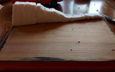

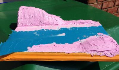

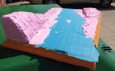

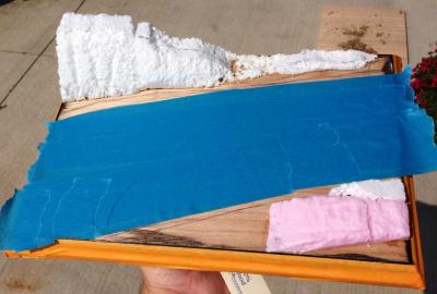

Step 4
Draw a basic layout of your design based on your imagination and the size of your work piece.
Step 5
Starting the diorama using foam or styrofoam or any plaster style molding things for different kinds of elevation.
Plaster everything including the flat surfaces unless doing a flat road or parking lot of sorts.
After that dries paint to your desired effect, add a black wash to add some depth for rock terrains.

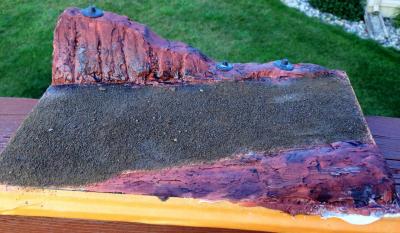

Using scenic cement or watered down craft glue. I bruished on where I wanted the dirt. Applied real dirt that was baked to get the moisture out and to kill any organisms. Also the dirt was sifted through a mesh.
To the desired scale.
After you have it layed spray scenics cement over the surface to hold it in place.
I used woodland scenics glue. Real dirt. And various acrylic colors of varies brands mixed at a 1-1 ratio with water. And the black was mixed at roughly a 15-1 ratio (paint/water)
Allow the paint to fully dry before the black wash as the water can remove the other paint.
I used foam brushes.
Btw I used a dry wall filler/ putty that goes on pink and dries white. I wouldn't recommend this because it easily cracks and doesn't dry rock hard through out.
I would recommend a craft style plaster.
Stay tuned

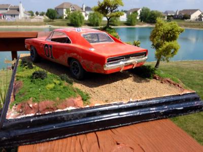

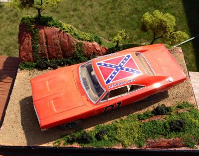

Alright I will say this is my first time doing a diorama to this extent.
But the how to was mainly for and idea for a base.

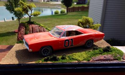

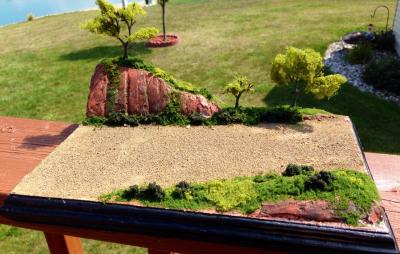

Step 6
Add your grass and trees, bushes etc.
Give it one last coat of scenic cement.
Step 7
Remove the tape surrounding the colored base and using contact cement apply some form of carpet to the bottom.
I used black automotive speaker carpet.
So now if it's on your table or at a show, the bottom won't scratch anything.
Step 8 weather your car or project (optional)
And also optional you can glue it to the diorama .
Thanks for watching and hope this helps.

Nice base & nice General. I like the red Georgia clay look of your groundwork.
Thanks man, and thanks for the compliment on my diorama!
Diorama looks great Byron! You do outstanding work on everything!
Why thank you so much for the kind comment!!!
