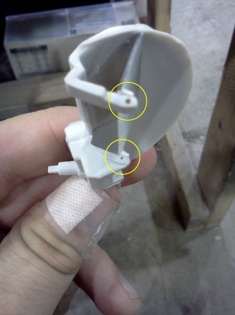

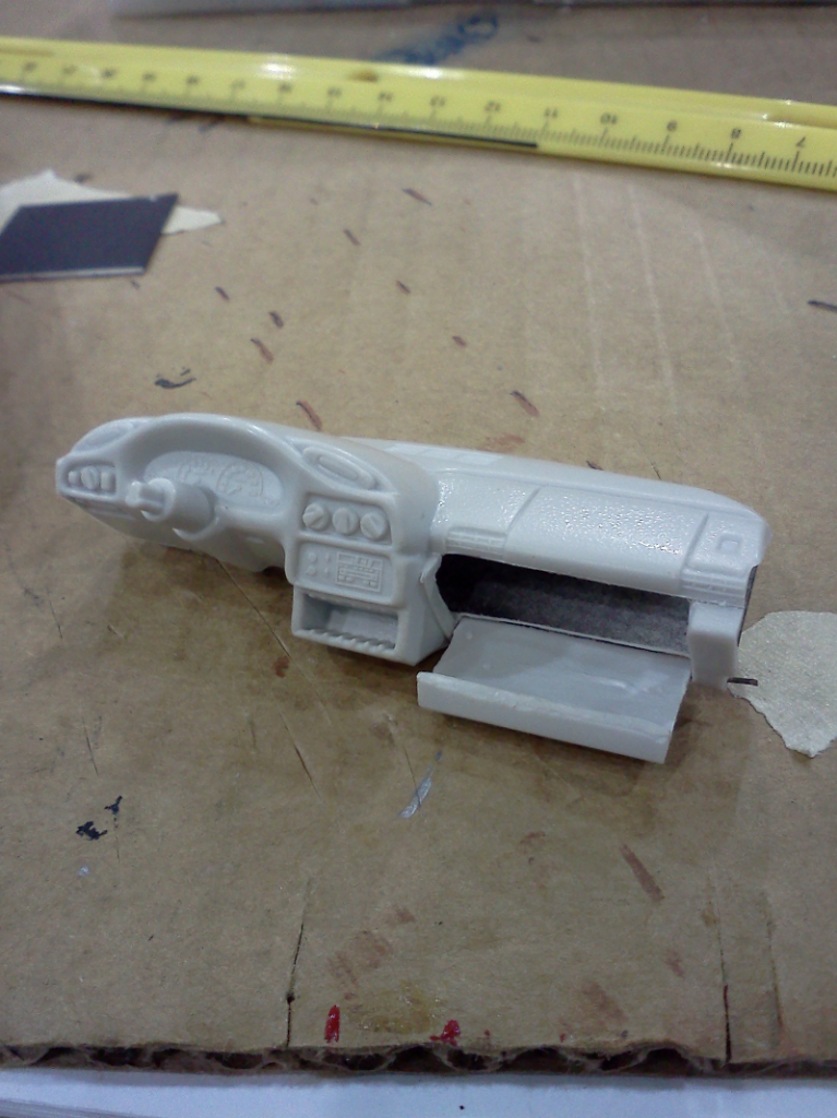

  • Carefully cut away the Glove Box lid on your dashboard. Make sure not to cut any fingers like I did.

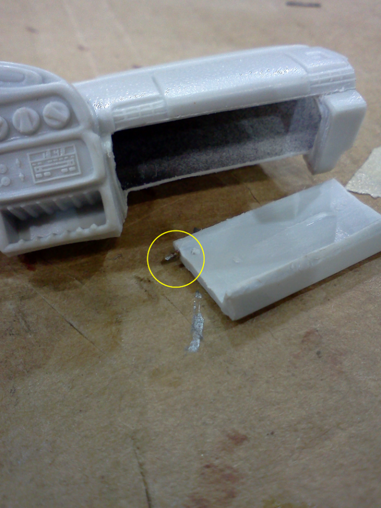

  • Using the smallest bit you have for your pin vise, drill out two holes as pictured. For the hole near the center (instrument cluster, thermostats, etc.), You don't have to drill in very far. For the edge closest to the door panels, I was able to drill all the way through. This makes the next step easier.

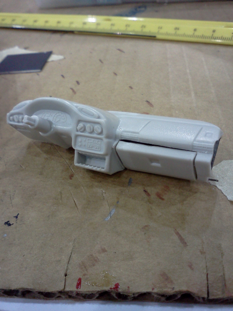

  • Next your drill 2 corresponding holes in the glove box lid. As you can see in picture 4, I glued a small piece of wire where the yellow circle is at. Now check for clearance and fitment. Make adjustments now if needed.
  • Once your glove box lid fits how you would like, put the pin to the corresponding hole. Now you simply cut another small piece of wire and push through the hole closest to the door panel into the corresponding hole on the glove box lid. DO NOT GLUE!!!! Glueing here would prevent the glove box from being operational.

I contemplated gluing the door open but went on ahead and put myself up for a challenge. I was talking to another modeler and he mentioned that you could use super small Rare Earth Magnets for a "latch". Might be working on that next.
Link to comment
You can get little photo etched keys if you want to try your hand at making a lock! :D
No worries, you did good. Modeling is all about challenging yourself and winning. You did that well!

nice quick-guide/tutorial.
I did this to a 240Z kit back in the mid-70's, I got the glovebox hinge made and working but after cutting the car doors open I found that my skills needed to improve a bit before that model could be finished...it's still sitting in a box waiting it's turn "Back on the Bench".
Link to comment
This is really cool. You did a great job.
Being a previous owner of a 94, lemme suggest not putting a cd changer in there. Some people didn't have the problem but, those cars were notorious for the glovebox popping open at rr crossings and potholes. It would be about as realisticly sound as a straight axle through the engine block on a 1:1 :lol: . I had to put my changer under the passenger seat. The owner's manual or something would be cool in there just for the full visual affect.
