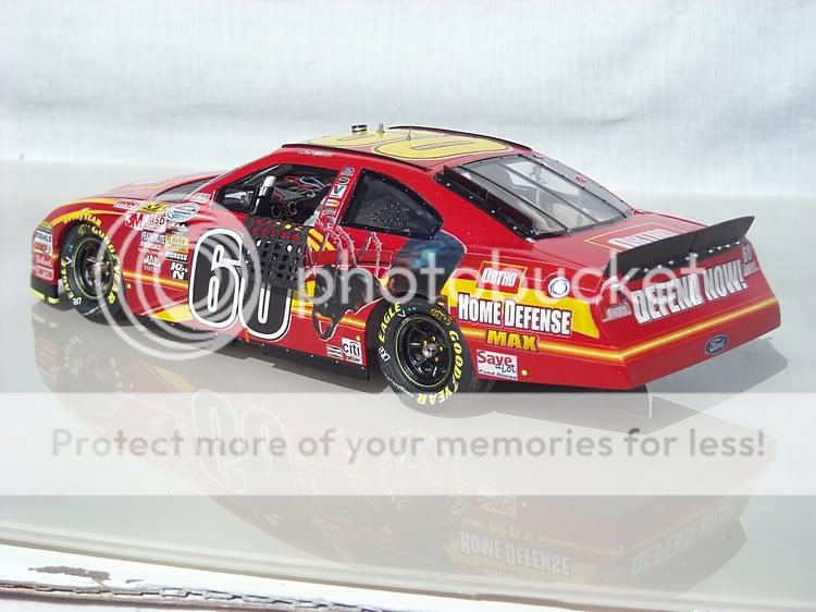

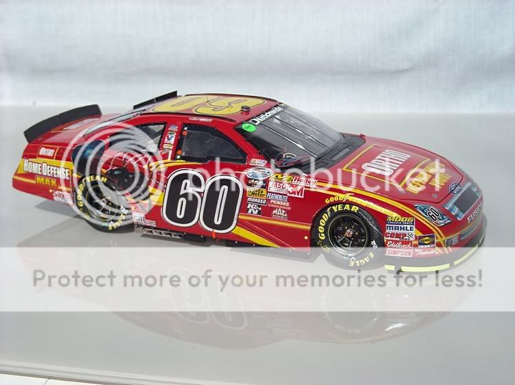

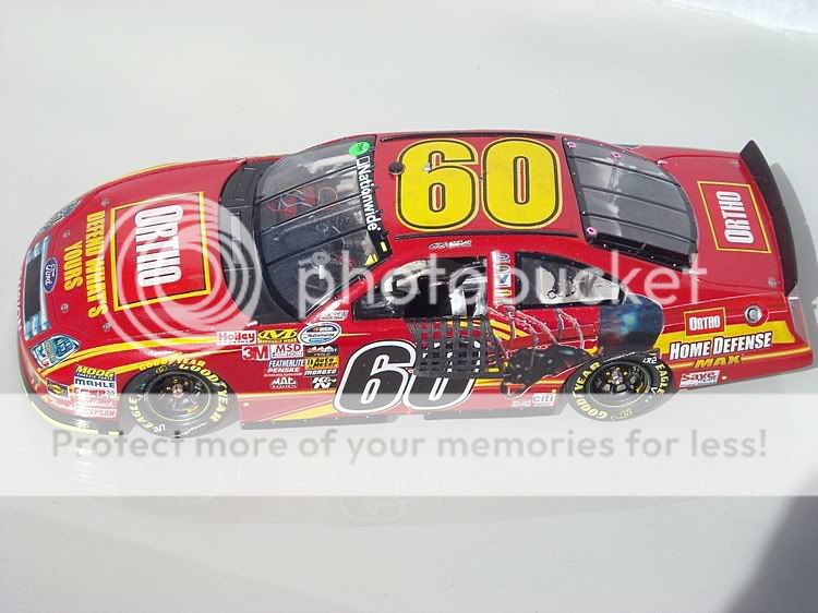

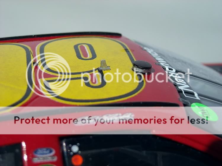

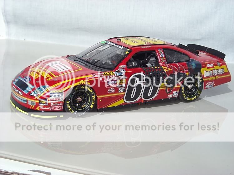

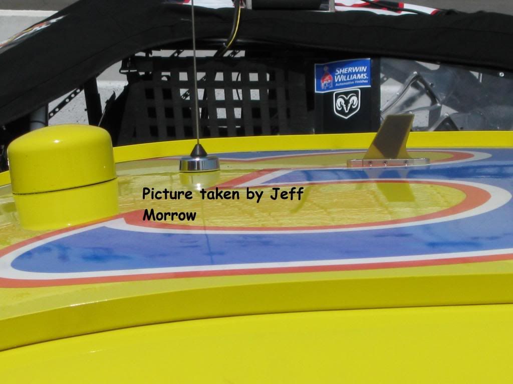

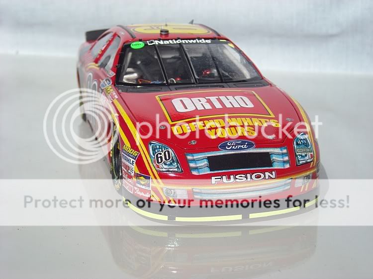

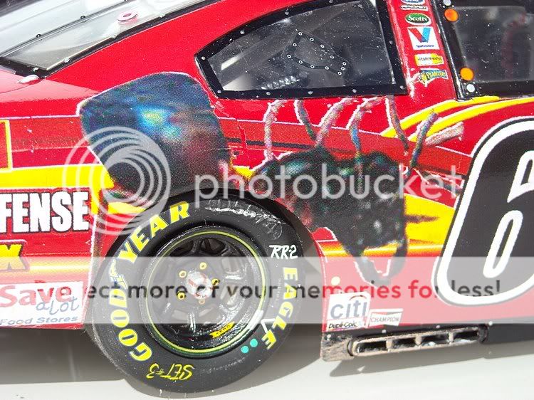

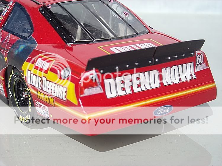

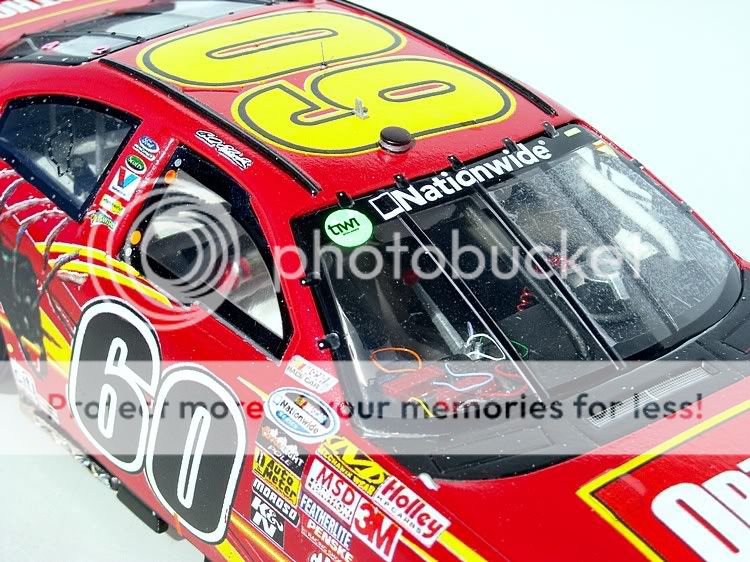

Mach2 Posted July 24, 2009 Share Posted July 24, 2009 (edited) Well, you can almost see the darker red on the sides between the stripes. It's there. I also gave a new detail a shot. BrAkEs20oo9 has a thread with the new for 09 GPS blade antenna, which looks alot like a blade antenna from a supersonic military aircraft. Rust-Oleum automotive gray primer, krylon matte aluminmum for a base for the krylon fusion red pepper, then using a template per the WIP thread applied krylon interior/exterior cherry red on the sides. I also trimmed the 05 Taurus A pillar to the straighter/thinner 09 Fusion A pillar as well as trimmed the one piece glass in this area. Rear quarter windows are made from clear plastic, the black is sharpie from the back side, drilled into the black area with a .020" drill bit to simulate the attach bolts. Winscals decals. Edited July 24, 2009 by Mach2 Quote Link to comment Share on other sites More sharing options...
