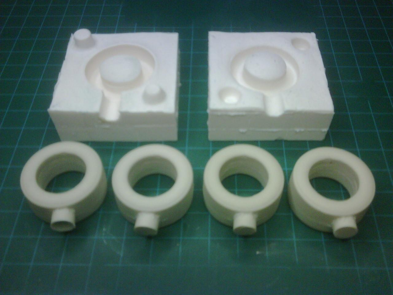

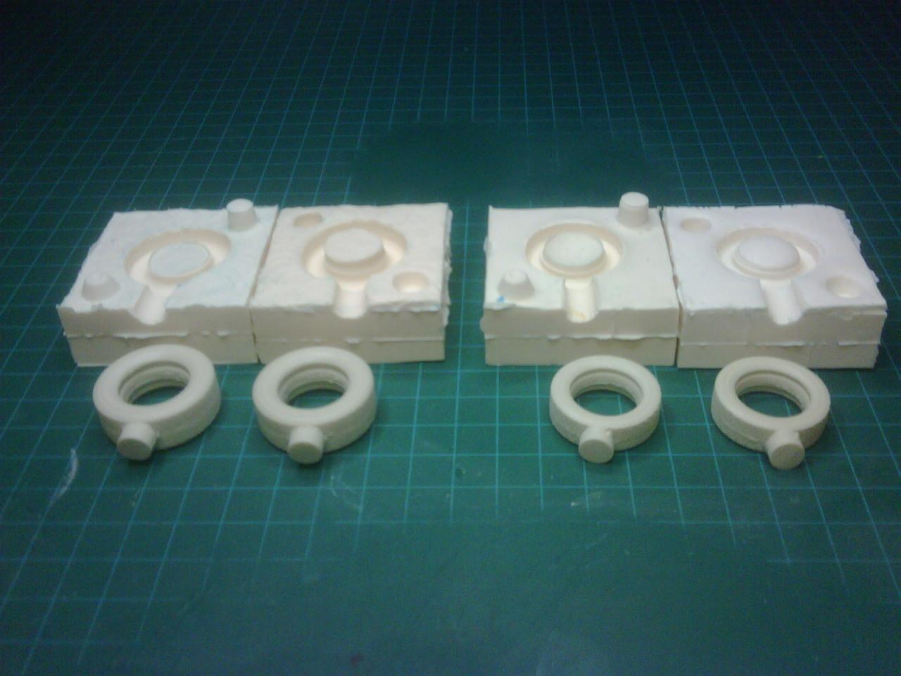

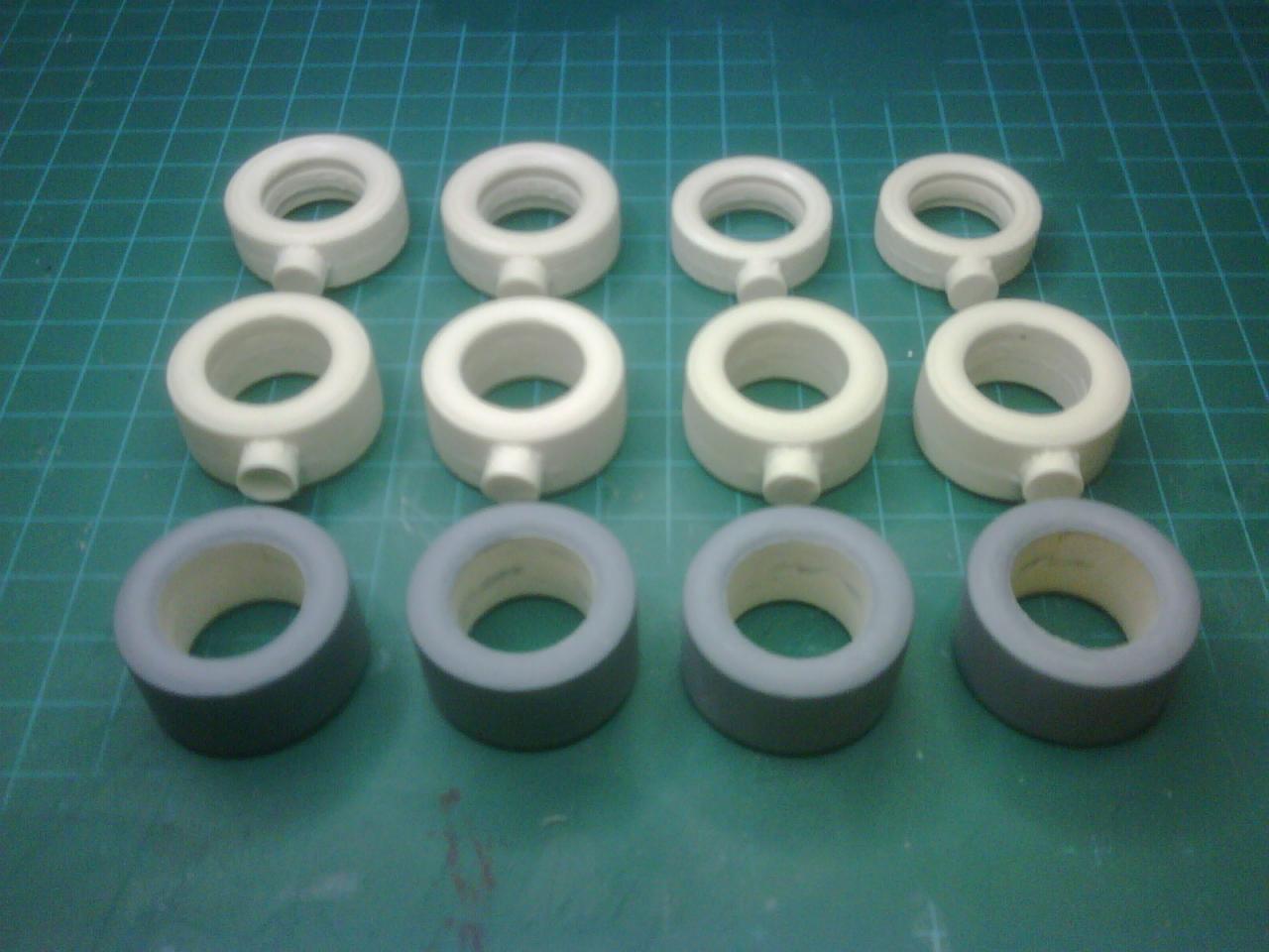

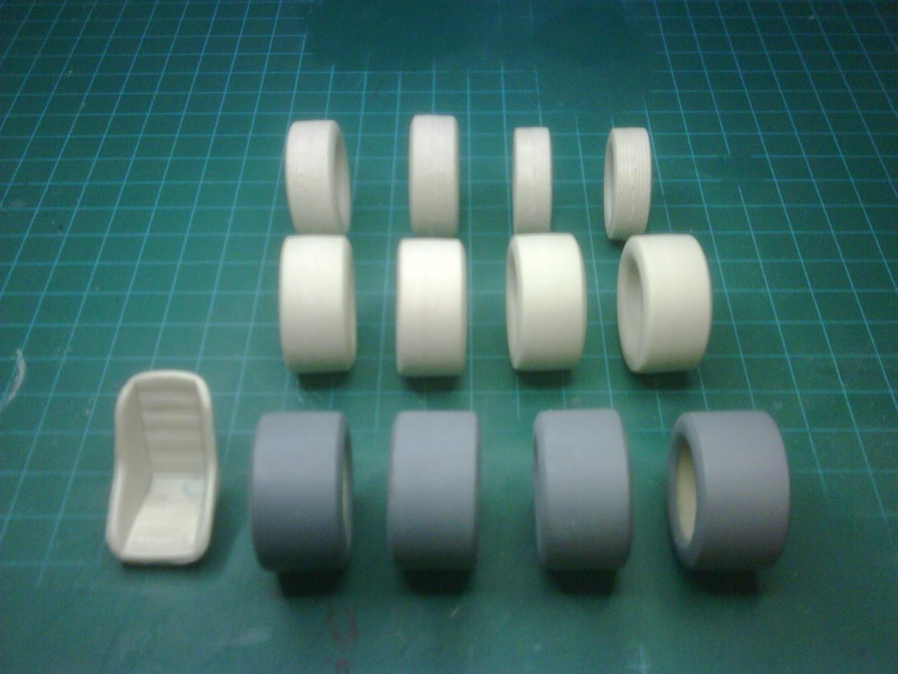

kitbash1 Posted March 26, 2014 Share Posted March 26, 2014 (edited) I picked-up a resin starter kit, and have been playing around with casting some tire sets. The first try is a set of big and little tires from the Revell Rebel Racer kit. I need a couple of sets for a 1969 Trans-Am Mustang build, and instead of stealing the tires I just cast a set. Not bad. The second set I cast, is a set of NASCAR slicks that have been widened a bit ( 60/40 split ) because I've always thought that the kit tires looked not wide enough. These will work on kits from the late 80's to the early 2000's. The third set I did ( in gray primer ) are NASCAR tires done a bit wider then the first set ( 70/30 split ) incase I didn't like how the 1st set looked. I also copied a GT racing seat from the Rebel kit. I think all in all they turned out not to bad for a serious 1st try at casting. Edited March 26, 2014 by kitbash1 Quote Link to comment Share on other sites More sharing options...

kitbash1 Posted March 26, 2014 Author Share Posted March 26, 2014 (edited) Very nice start!!! I have been thinking about trying my hand at it for my wife.She is a gardener and there are some things she has that are not made anymore. Where did you find your set and how much? A link if online? Thanks a bunch, George All parts were cast with an Alumilite starter kit. Heres the link www.alumilite.com Thanks for the comments. I just followed the directions supplied with the kit. I also watched a few YouTube tutorials as well. One thing that I did when casting the parts, was to warm the moulds in a microwave oven on high setting for 1 and a half minutes and poured the resin slowly into warm mould. I also tapped the moulds on the bench top until I saw the resin start to change colour ( the resin goes from caramel colour to tan as it sets ) at the pour hole. There was no pinholes and zero flash. Edited March 26, 2014 by kitbash1 Quote Link to comment Share on other sites More sharing options...
