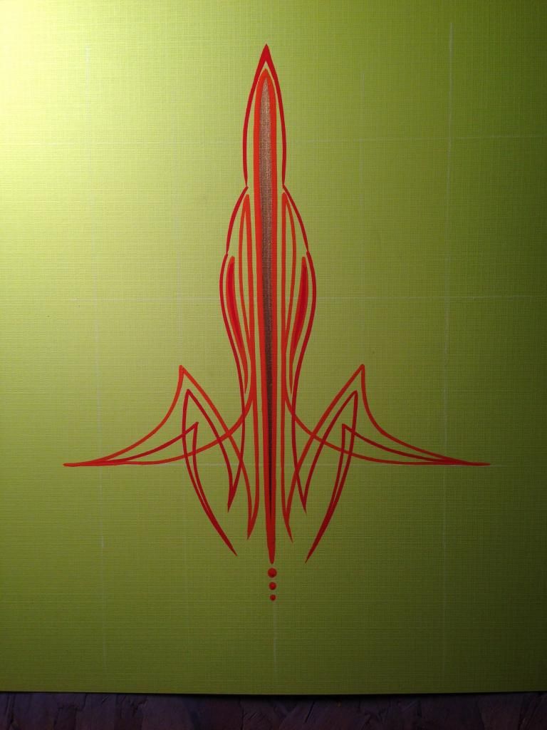

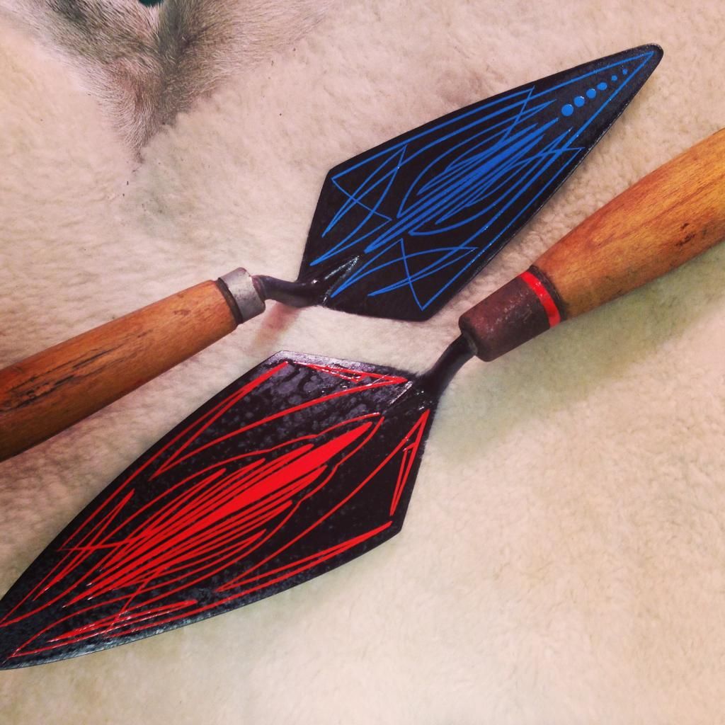

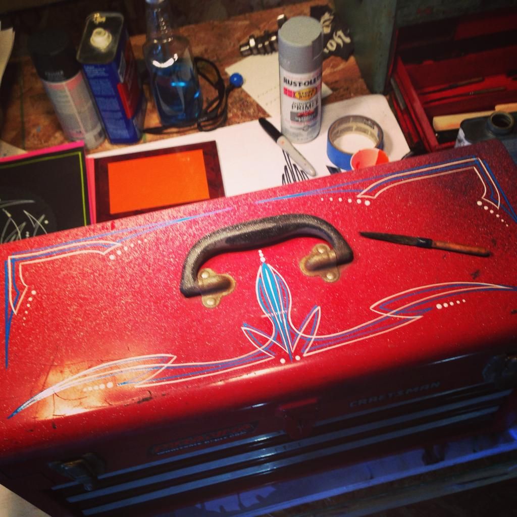

James2 Posted December 10, 2014 Share Posted December 10, 2014 Pinstripes Garage https://www.facebook.com/groups/112044882202139/ A few I have done. There is a lot of info out there, but the basic's are pelleting the brush and practice, practice, practice! This is as good as it gets right here, Ed Roth interviewing Von Dutch. It's six parts, and well worth the time. https://www.youtube.com/watch?v=5Gtb6991Hxc Quote Link to comment Share on other sites More sharing options...

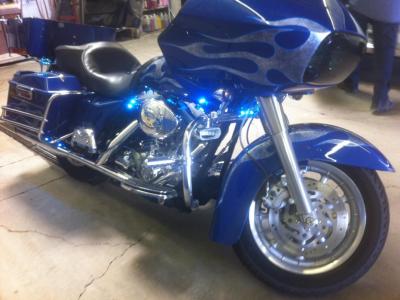

Brudda Posted December 10, 2014 Share Posted December 10, 2014 Yes, I custom paint and pinstripe. I just got into modeling a few years ago because of a stroke and the doctor said modeling would be good for rehab. The answer is flow. Get the paint off the brush and onto the subject. One shot enamel , I use a grumbacher brush and mineral spirits. My mentor Mike Kline said if you go thru one gallon of this stuff then you are ready. Took 1 year and every night for about 2 hours a night. Glass is great to practice on. You stripe then wipe it off and start again. You will need a phone book to wipe your brush on or a old mag. dixie cups work great to mix colors. It is going to take alot of time but it is worth it. I make a great living at it. I have a very nice house and many real 1:1 fun cars to play with. You can make 300 dollars an hour and it is a blast to do. Here is my latest job and the guy loves it! Hope you stick to this as most people give up. that is why we can charge alot for our craft. Good luck and if you need any info send me a PM and I will try to help. Quote Link to comment Share on other sites More sharing options...
