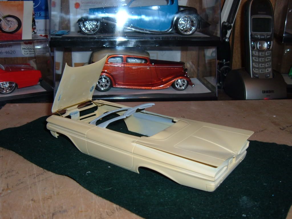

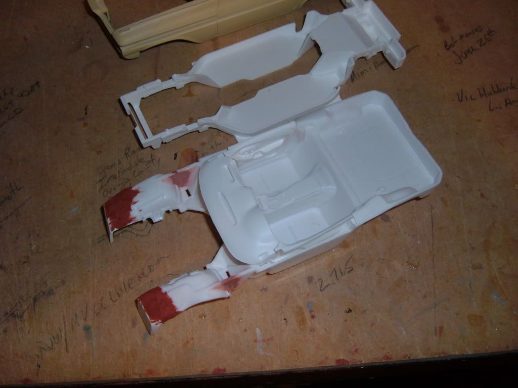

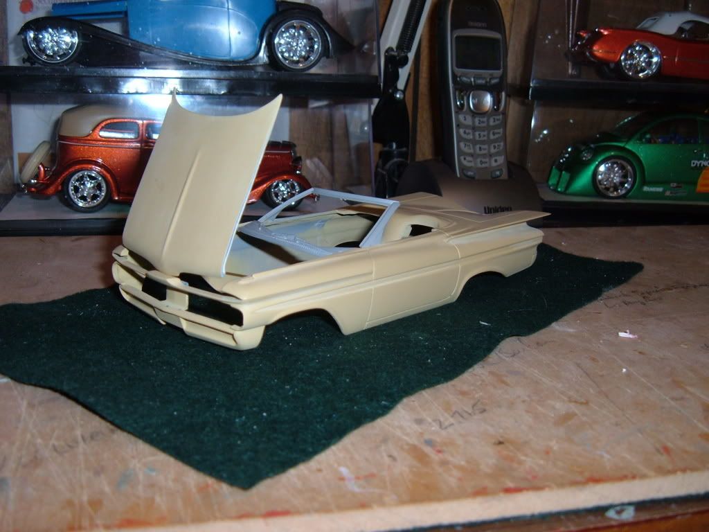

I started this fun build a coupla month's ago and was interupted by the need for a hernia operation called "Project Stupidity" :) , because I shouldn't have been doin' what I did to cause this :) .
Anyhow, I love challanging, complicated projects, which this has turned out to be, and it's been fun.
Designing everything to fit and make it look factory was the goal, and I'm happy so far with the progress.
The shell of the car is shortened, and the doors are lengthened, and have a bit of the Corvette curve at the rear bottom, but otherwise pretty stock '59 chev, with everything else being '98 'Vette roadster.
The body is finished with two coat's of two stage urethane primer, and will receive two coats of single stage white and then two coats of single stage bright scarlet red, followed by several coats of two stage clear coat.
The hood will be hinged next, but because it will open forward, Corvette style, I had to finish the inner front fender wells by lengthening them, as you'll see in the pics, so that the hinges will pivot into them properly and clear everything.

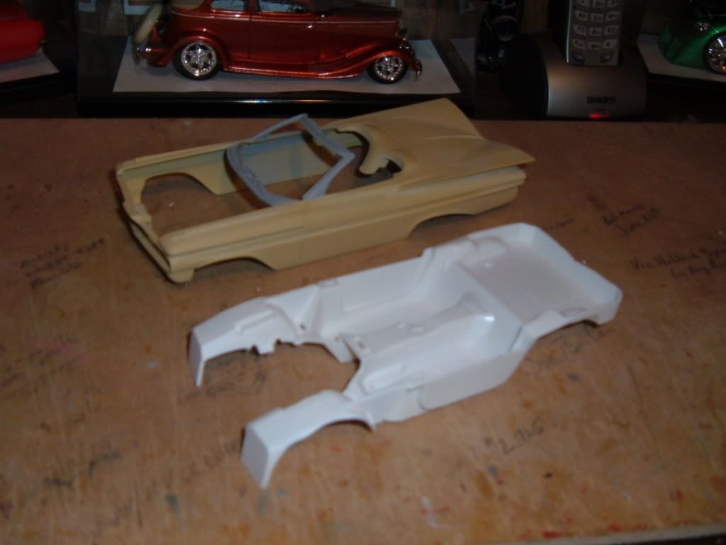

I also had to match the chassis with the interior tub with some mods, so everything matched properly to the body.
The engine/driveline will be pretty stock Corvette, dressed up a bit with some carbon fiber and stock type decal under hood badging and other detailing.
So far so good.
Any comments appreciated.

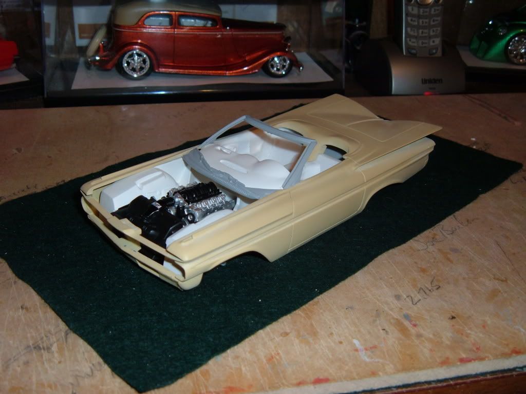

Very cool project. The shortened body and lengthened doors give it a really sporty look, kinda like an early Thunderbird. To my eye, the modern windshield looks a little akward but it's hard to tell without the hood on. Have you considered chopping down the height of the windshield? It seems like a 1/4" would make the whole car look sleeker, especially if you try and imagine a top on it. It would also pull the ends of the windshield posts away from the passengers and (if it were a real car) ease entry and exit.
I also think some chrome C5 ZO6 wheels would look cool. If your gonna do the steel wheel and stock caps consider some wider wheels and wide, low profile Z-rated tires for a nice retro look. It would be a shame to put all that great handling modern suspension under the car then have it handle like garbage because of some tall, narrow, bias-ply tires. (If it were a real car.)

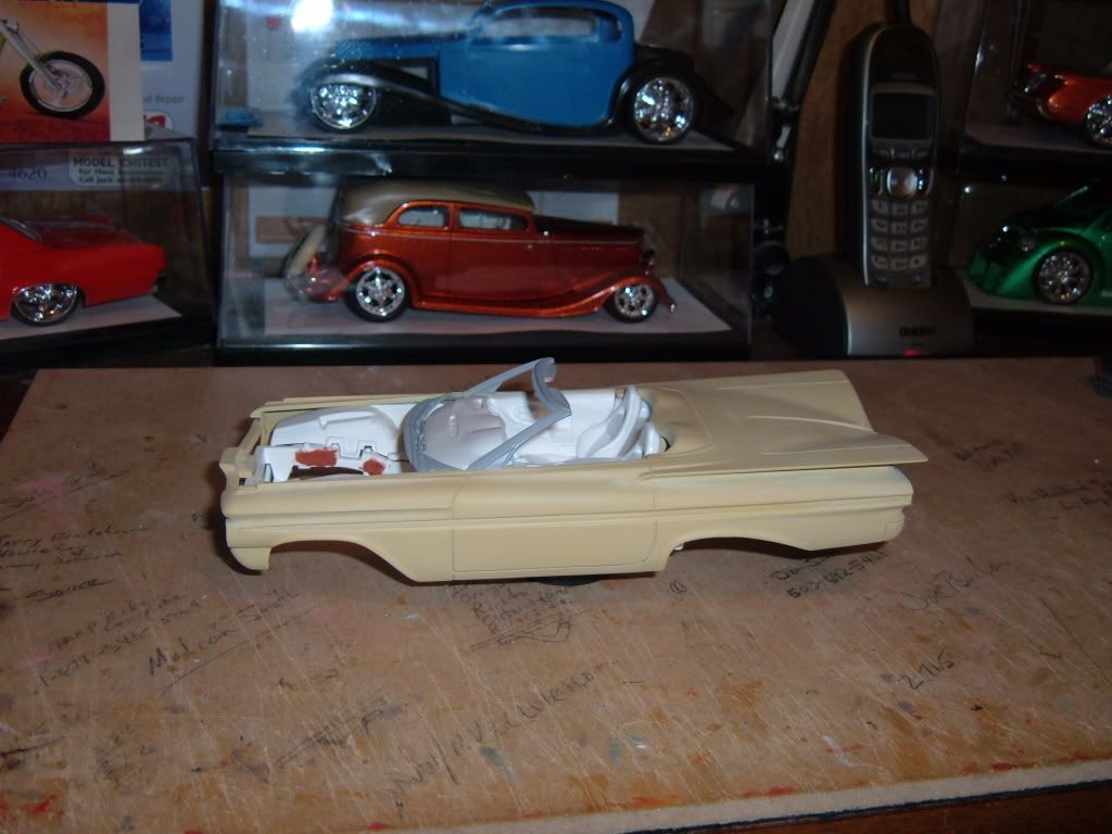

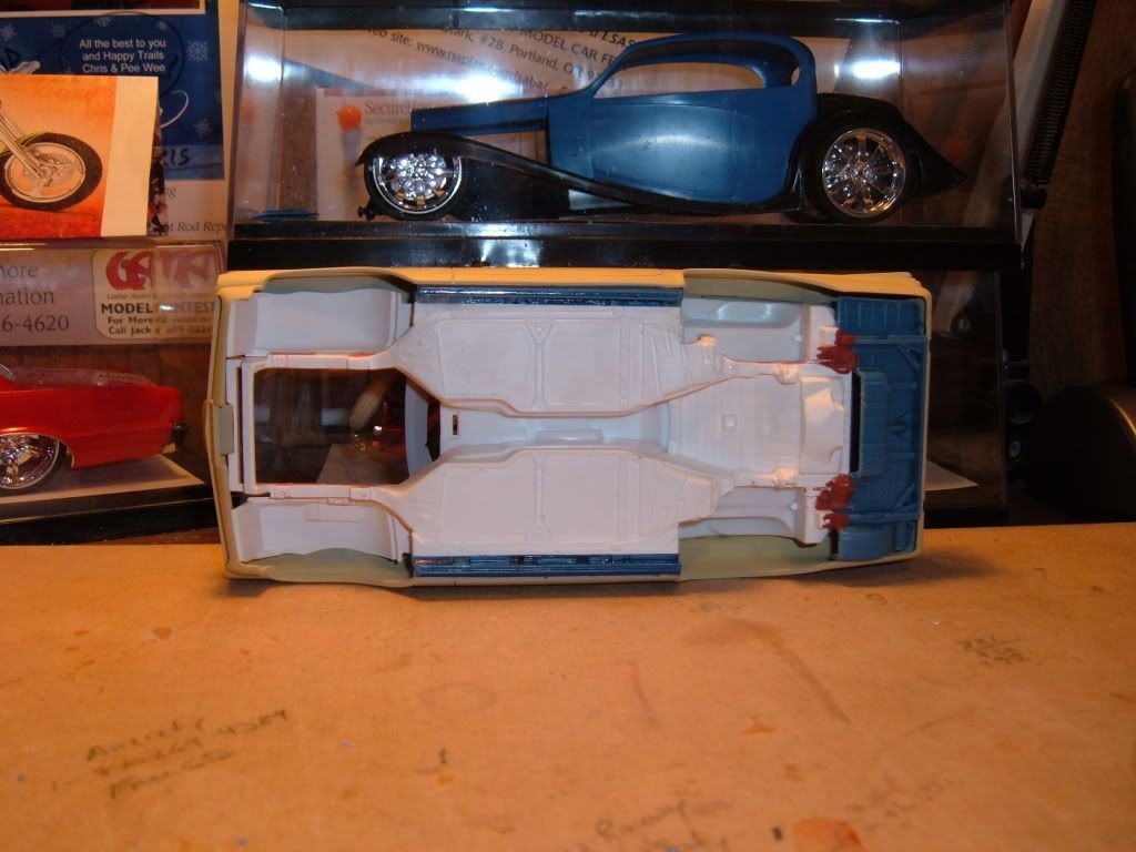

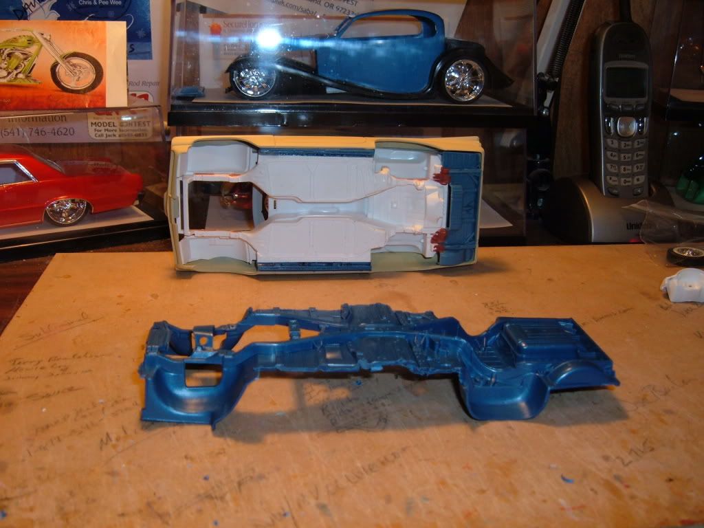

Gotta little bit done this morning on the undercarriage. Added some of the '59 chassis to the rear and sides of the 'Vette chassis. Snugs everthing up a bit and make the undercarriage self locating in the body shell.
Gonna use the stock 4 outlet exhaust, so I'll have to lengthen all 4 of them once the chassis is done.
The chassis'll be sprayed flat black, with most everything else like suspension and drive line aluminum.

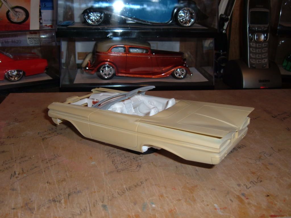

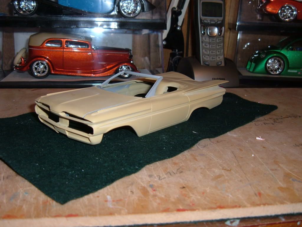

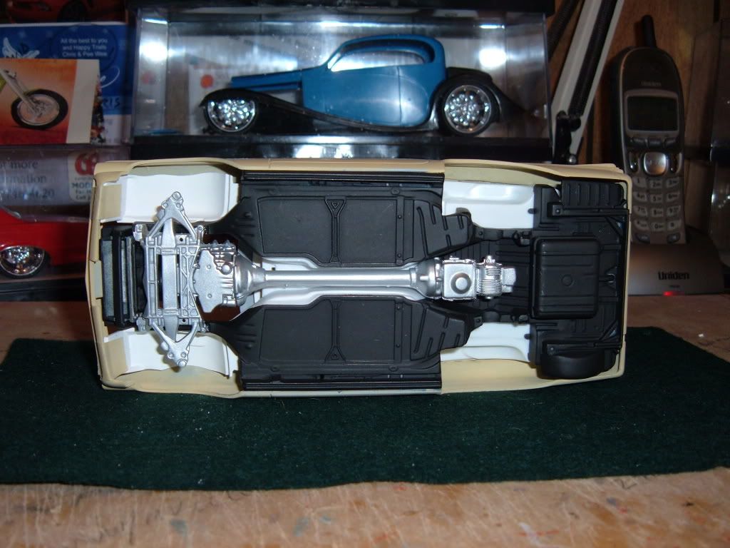

WOW !!! EVERYTHING FITS so far :( . This has been such a complicated conversion, making nearly 100 parts come together with some major massaging and making it look factory stock.
It never ceases to amaze how " THE CREATOR" helps us builders and creators to get it right :( .
Probably at least two weeks of work left to go, but having a blast with this one :unsure: .
Going to do the hood hinge next, now that the major chassis mods are mostly complete.

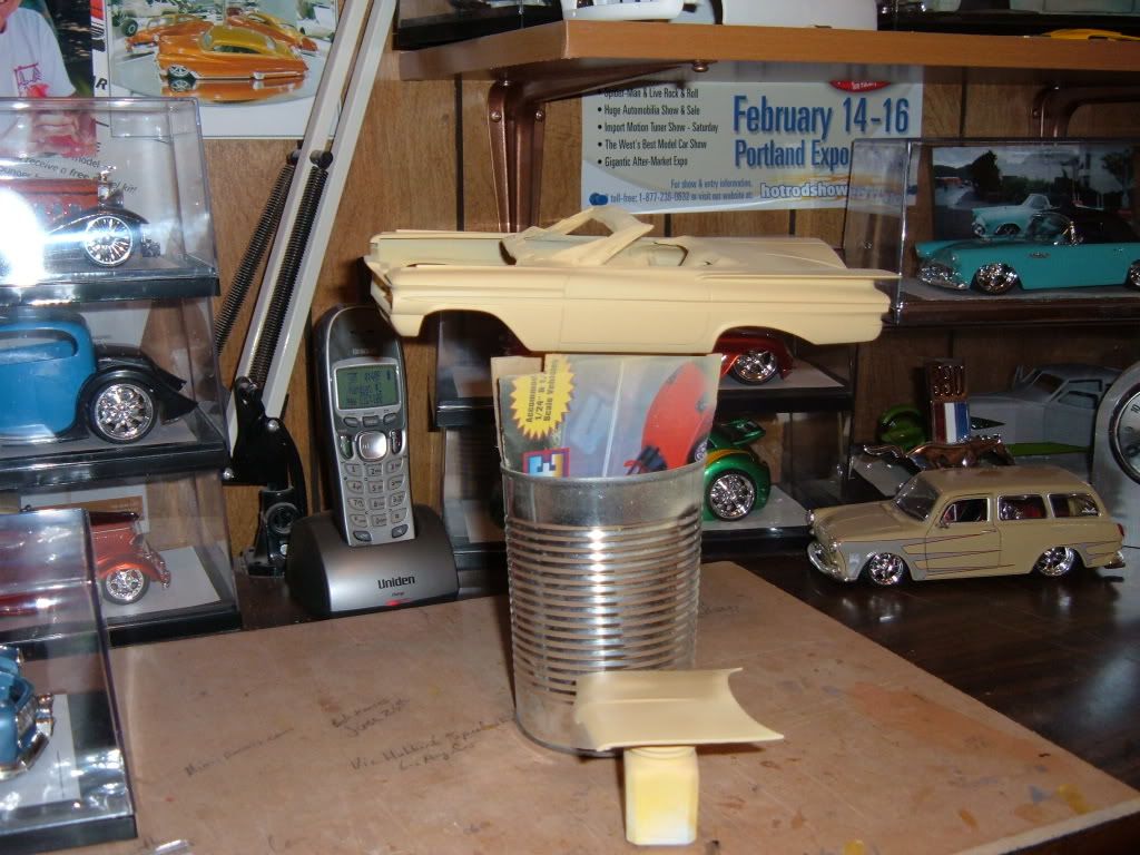

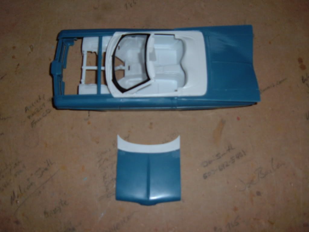

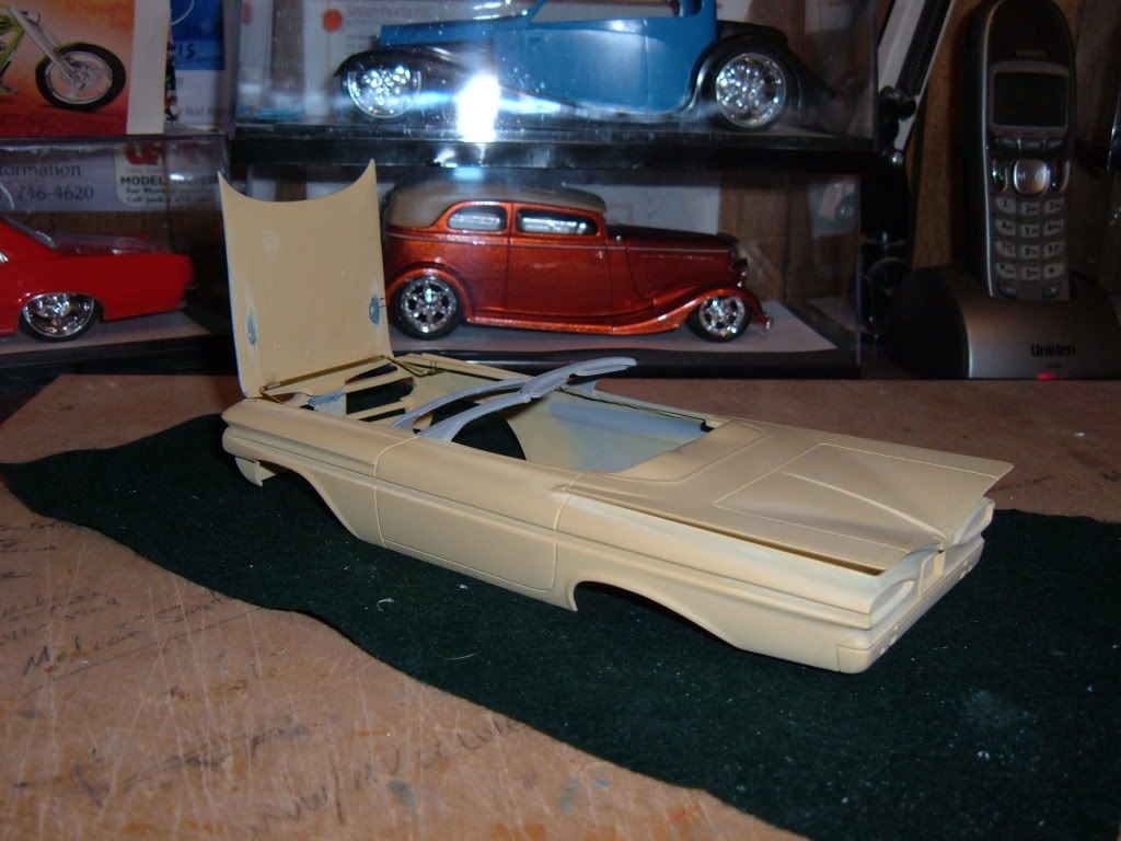

Well, got the hinge to work better than I had planned :D:lol: . Funny how that work's when you have help from above.
The hood has a hinge point at the front of the hood - the long bar, and then the second hinge point is under the fenders where the hinge disappears.
The hood is now poseable in most any position I place it, and can be removed easily. And it clears everything under the hood.
So some minor filling and sanding, and a little primer and I'll be ready to paint - I THINK :lol::lol:

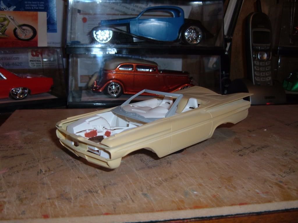

I think everything is done and ready for paint, so maybe I'll lay it down tomorrow :D.
I sure do love to paint, and urethanes are almost goof proof - ALMOST ;):P
