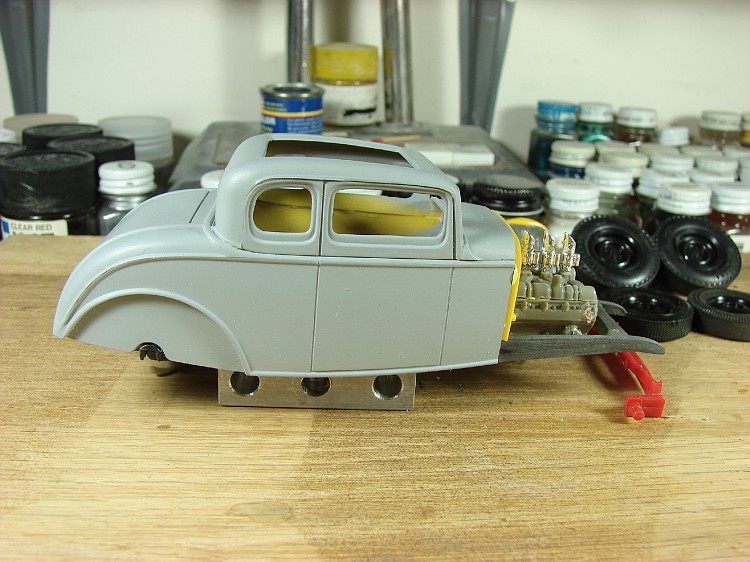

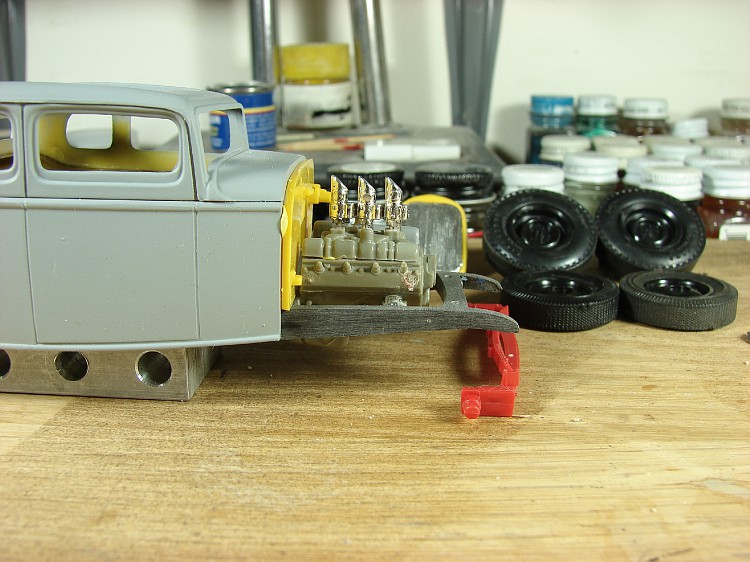

FordRodnKustom Posted June 14, 2015 Share Posted June 14, 2015 Here is one in primer that I've been working on. I think it still makes a decent looking hot rod. Quote Link to comment Share on other sites More sharing options...
mike 51 Posted June 14, 2015 Share Posted June 14, 2015 (edited) That separate roof would be a deal breaker for me.....in addition to the windows looking all wrong too. Of course if someone doesn't know what a 32 really looks like,they probably wouldn't notice or care.... Edited June 14, 2015 by mike 51 Quote Link to comment Share on other sites More sharing options...
Snake45 Posted June 14, 2015 Share Posted June 14, 2015 Yeah, that separate roof is definitely a PITA to get looking right. Been playing with a couple of them off and on for a couple years now. Quote Link to comment Share on other sites More sharing options...
1930fordpickup Posted June 14, 2015 Share Posted June 14, 2015 It may not be correct for stock, but If it is ok to chop it makes no difference if it is also sectioned. Quote Link to comment Share on other sites More sharing options...

fseva Posted June 14, 2015 Author Share Posted June 14, 2015 Here is one in primer that I've been working on. I think it still makes a decent looking hot rod. And this is the Coddington? Looks like the doors go all the way to the bottom, which is not the case with the other 32 fords mentioned here. I say it looks right on! Quote Link to comment Share on other sites More sharing options...
mike 51 Posted June 15, 2015 Share Posted June 15, 2015 (edited) No the Revell and MPC doors all "end" at the sill (not the frame)...Bill's not finished fixing the AMT Vicky body, that's why the door "ends" too early. You might want to Google some pics of real 32's so you know what they are supposed to look like... Edited June 15, 2015 by mike 51 Quote Link to comment Share on other sites More sharing options...
