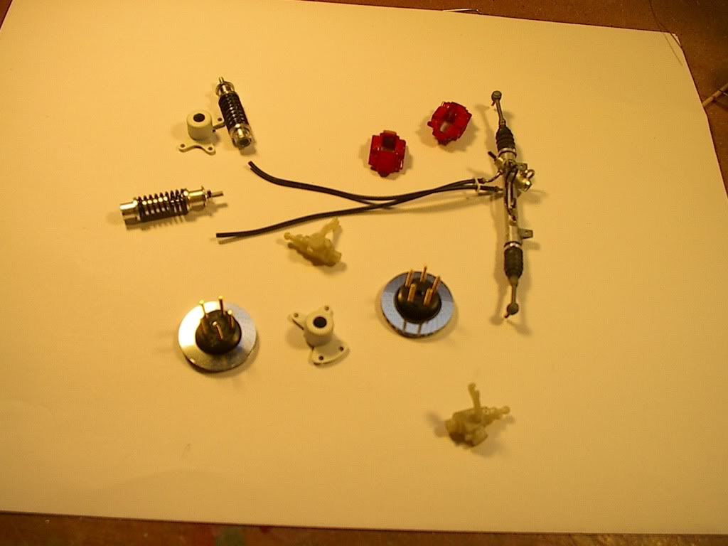

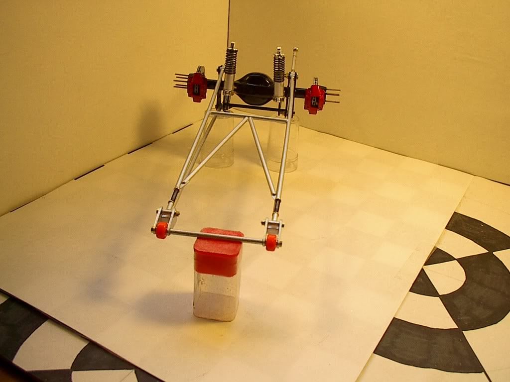

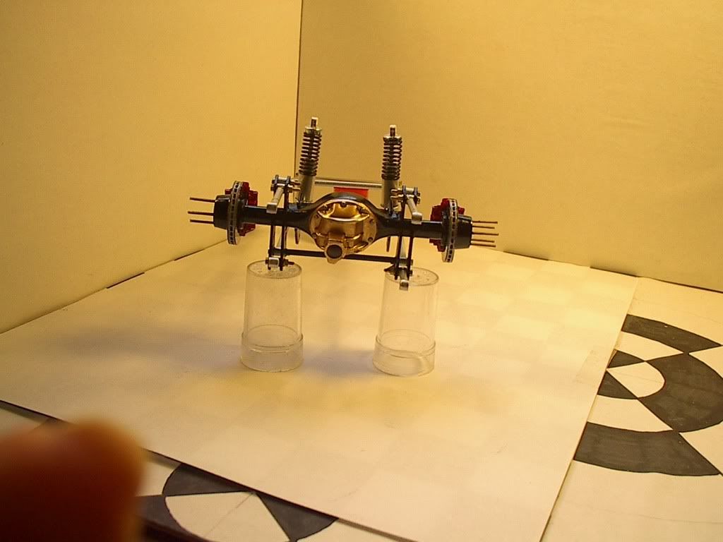

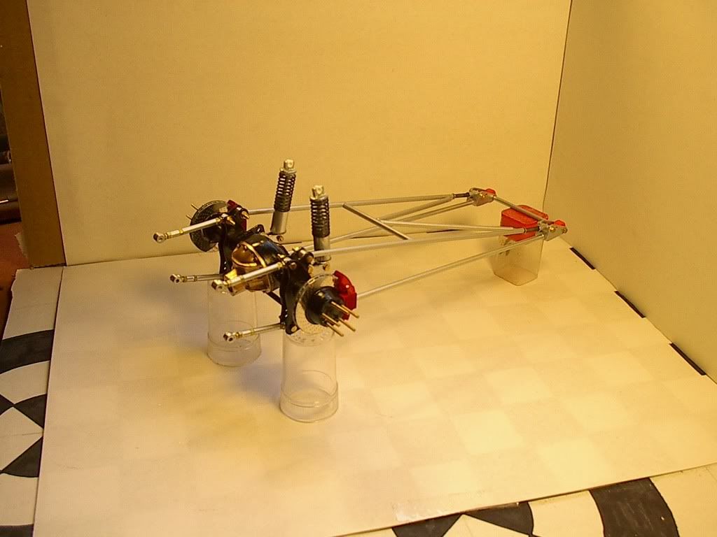

mwfuss Posted September 8, 2009 Share Posted September 8, 2009 This is simply an amazing build! What were the materials you used to make the rear coil overs? Quote Link to comment Share on other sites More sharing options...
baddgass Posted September 8, 2009 Author Share Posted September 8, 2009 ALUM. TUBE & THANX Quote Link to comment Share on other sites More sharing options...

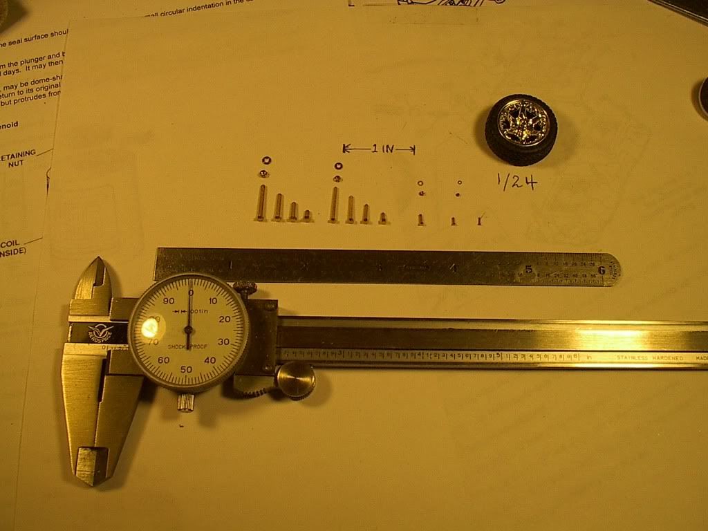

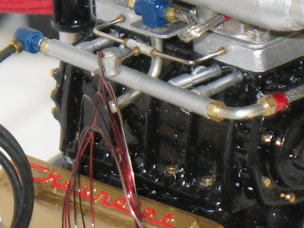

John E. Bowers Jr. Posted September 8, 2009 Share Posted September 8, 2009 This is simply an amazing build! What were the materials you used to make the rear coil overs? I am very impressed with your skillful work, man. I've built both the Z/28 and the Corvette from this series, but niether have this much detail or scratchbuilding. Two more questions... Where do you get the tiny machined hardware (please don't tell me you make it yourself!), and what sizes do you use? Thanks J.B. Quote Link to comment Share on other sites More sharing options...

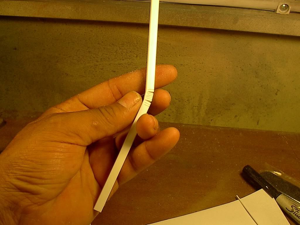

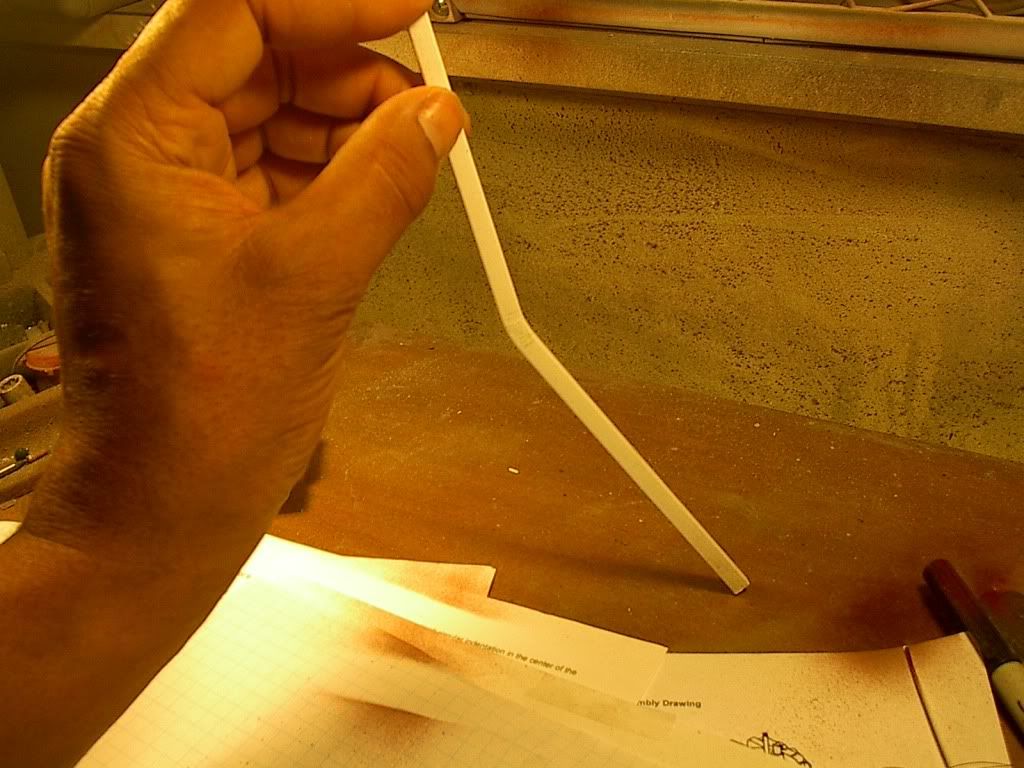

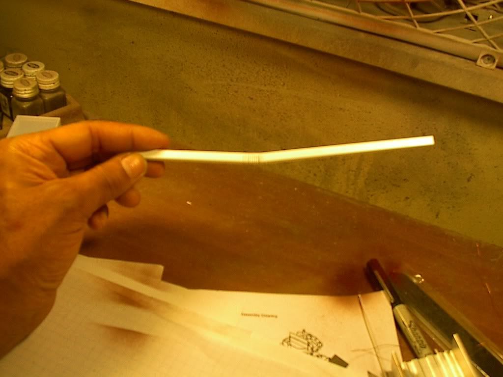

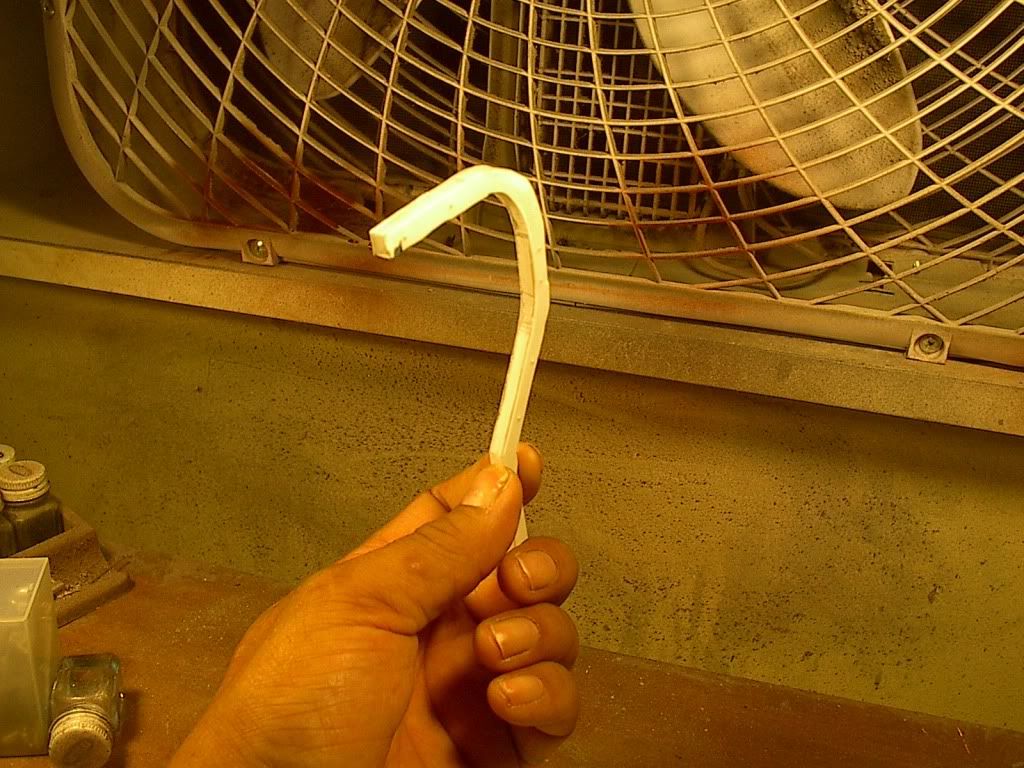

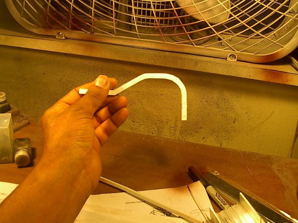

arick Posted September 9, 2009 Share Posted September 9, 2009 What an amazing build!! Thanks for shareing it with us. Question.......how did you bend the rectangle tube used for the chassis? Quote Link to comment Share on other sites More sharing options...
baddgass Posted September 9, 2009 Author Share Posted September 9, 2009 No i don't nave a CNC or a MILL my work is by hand. The nuts & bolts are from www. scale hardware.com Good people ship in 1 day (FAST). And the sizes ( have a look ) Arick : to ben the tube , i do like the carpenter ben wood. I make a template of the ben i like then i saw down the tube but not all the way,make a lot of cut next to 2 ,1 another when u have the ben u like glue , sand and i uae a sheet of .10 styrene on the sides for stregthen. hope this help. derrick Quote Link to comment Share on other sites More sharing options...

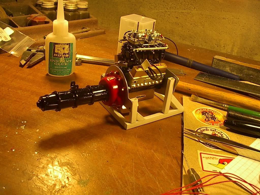

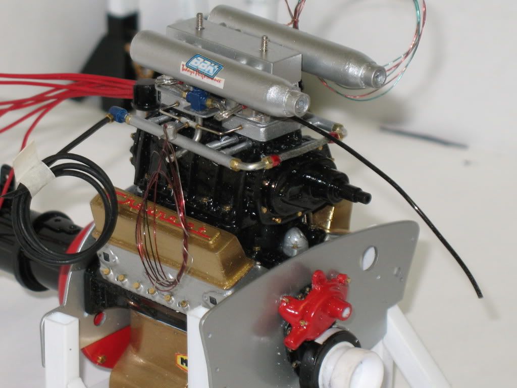

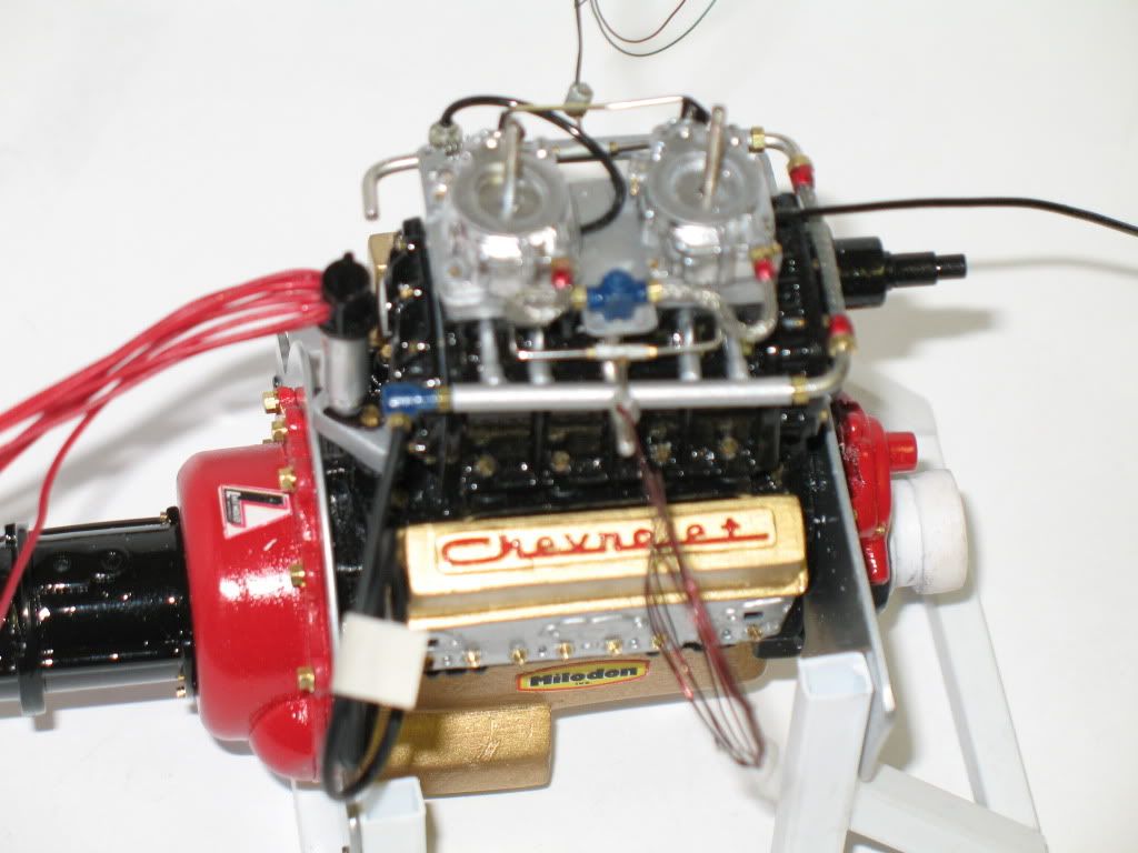

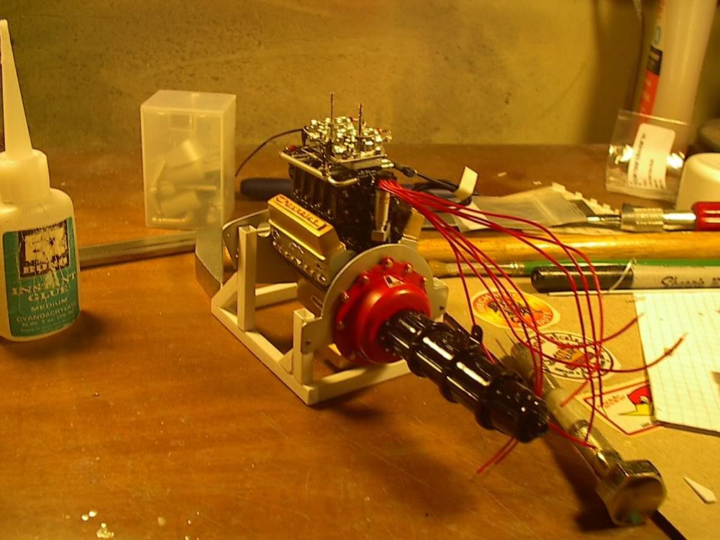

Rider Posted September 11, 2009 Share Posted September 11, 2009 This has been very fun to watch, great bit of work going on here. Are you not going with the dual turbo set up any longer? I thought you did a fantastic job with the plumbing. Quote Link to comment Share on other sites More sharing options...
baddgass Posted September 11, 2009 Author Share Posted September 11, 2009 This has been very fun to watch, great bit of work going on here. Are you not going with the dual turbo set up any longer? I thought you did a fantastic job with the plumbing. O yes the turbo is in the build working my way up, have a look. The last pic befor the TOLEDO show Quote Link to comment Share on other sites More sharing options...
baddgass Posted September 11, 2009 Author Share Posted September 11, 2009 Quote Link to comment Share on other sites More sharing options...
Rider Posted September 11, 2009 Share Posted September 11, 2009 Glad to see the turbo is still going ahead, great progress. Quote Link to comment Share on other sites More sharing options...
jbwelda Posted September 12, 2009 Share Posted September 12, 2009 thanks for that tutorial on bending plastic tube, im going to try that soon! lookin super! Quote Link to comment Share on other sites More sharing options...

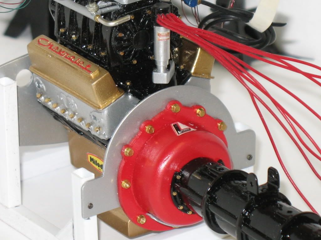

stump Posted September 26, 2009 Share Posted September 26, 2009 Thanks GEORGE For the kind words, i have a lot of time on my hands. So i have to do some thing so i gave this a try. Yeah, obviously waaaaay tooooo much time................... (typical, break the ice with humour.. ) Seriously Derrick, this is some mind blowing work you got happening in here.... Absolutely LOVE all what you've got covered so far, and you don't look like slowing any time soon.....GREAT ! Particularly like the Lenco and the way you showed how to bend that square stock...I've done that with large round tube, never thought of trying square.. I'll put that to good use for sure.. Gotta thank my good buddy George for gettin me back here too...he shot me some mail tellin' of this awesome build, cheers George, I owe ya some mail... Quote Link to comment Share on other sites More sharing options...
