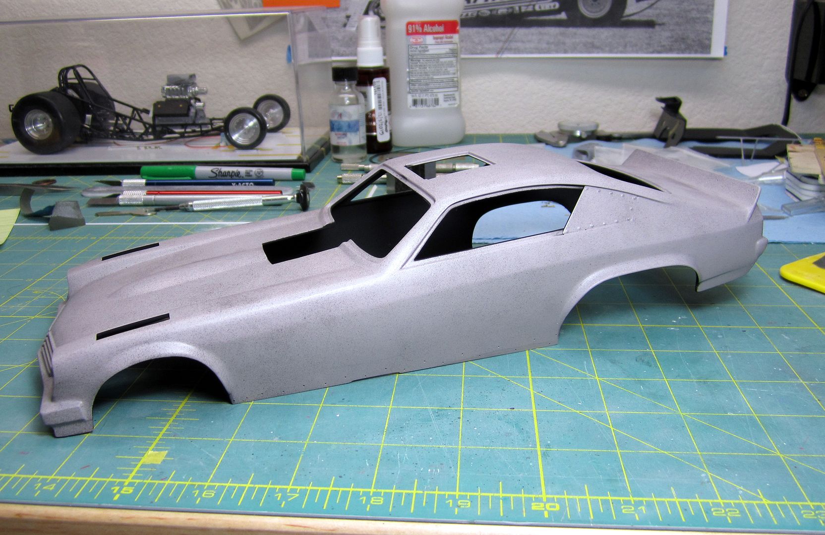

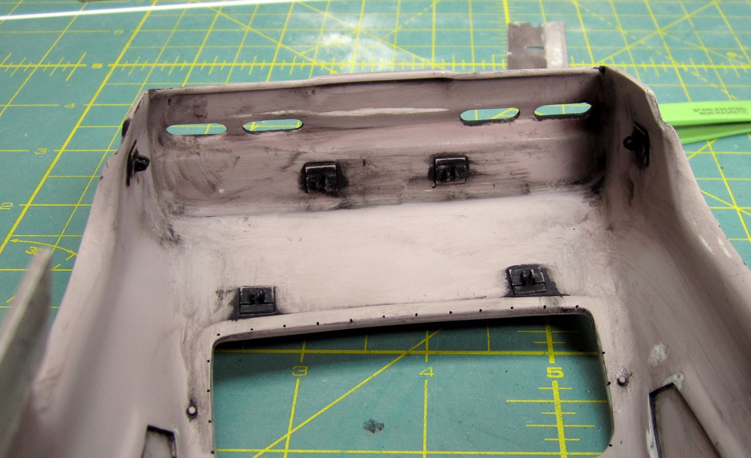

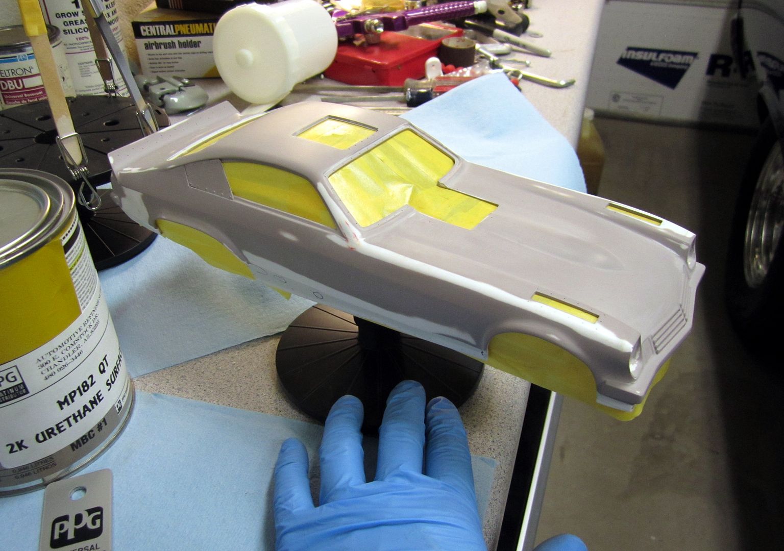

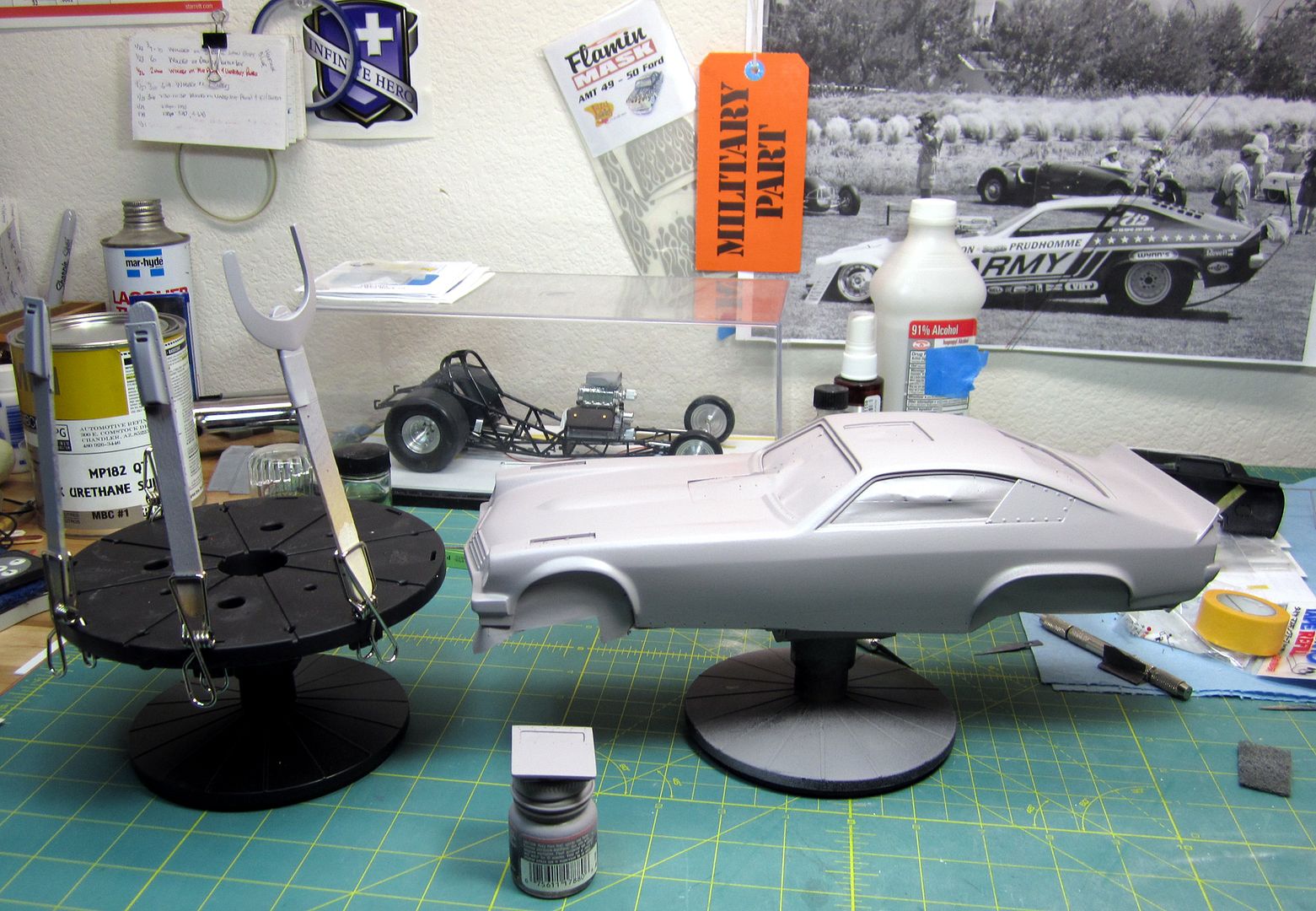

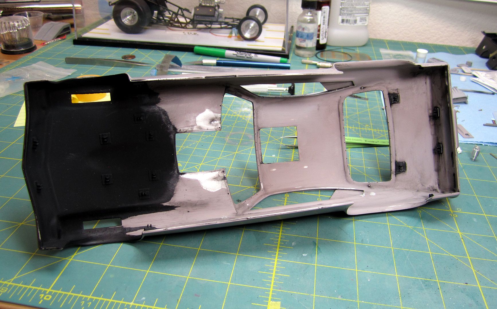

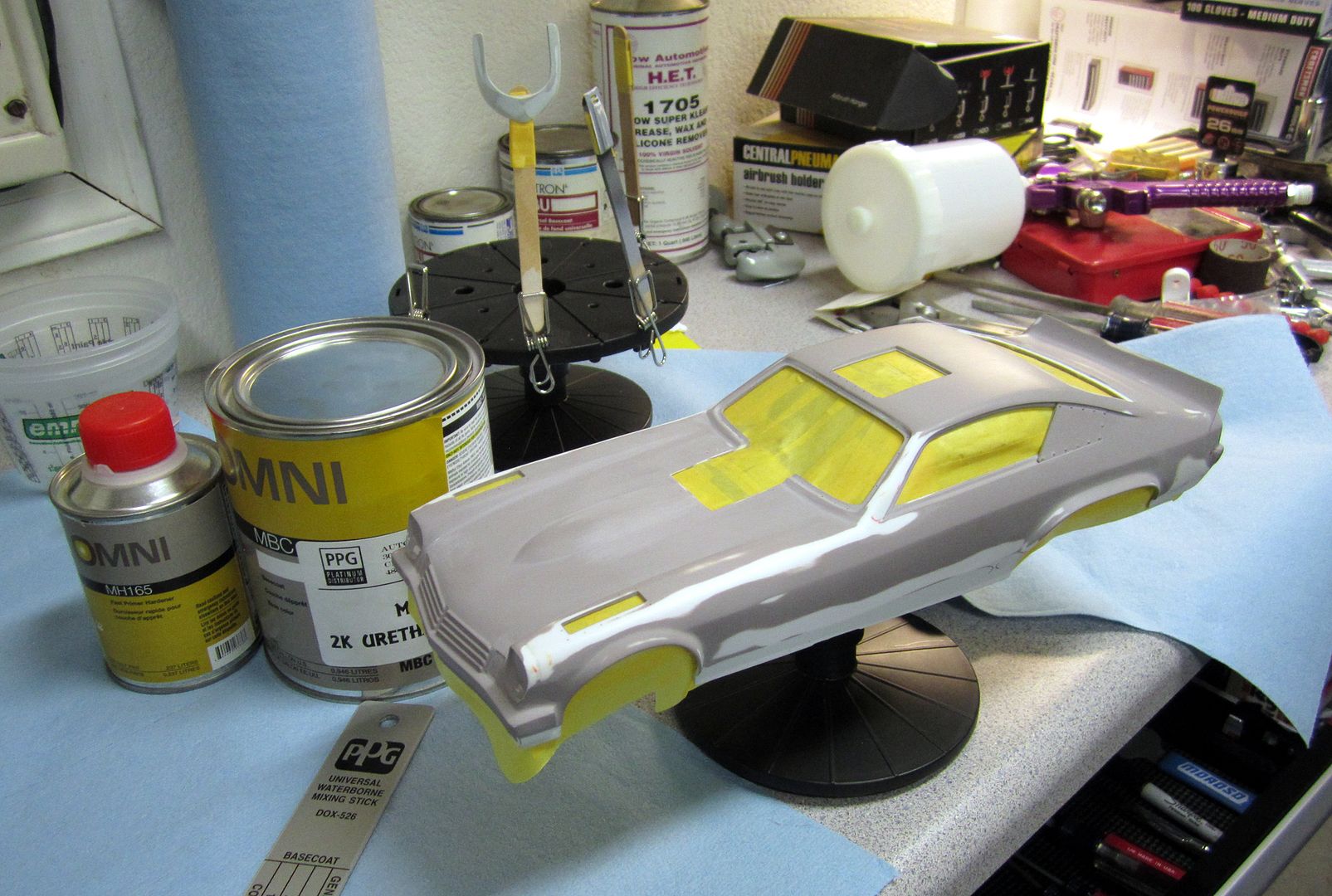

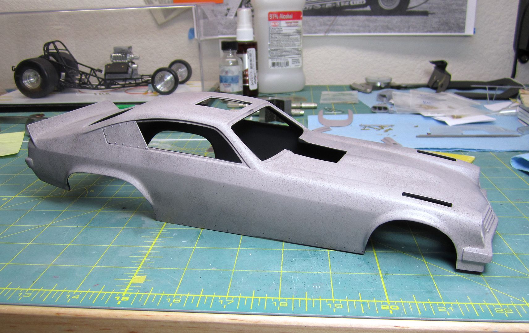

Mooneyzs Posted March 11, 2016 Author Share Posted March 11, 2016 Well it's that time for another update. Made some more progress but with the progress I made some steps backwards. Seems like lately when I make 2 steps forward I end up taking 5 steps backwards. Anyway last weekend I got the body all sanded down and ready for primer and was able to primer it Saturday night. Then the plan on Sunday was to get the underside of the body painted with the Hot Rod Flats Urethane Hot Rod Black. I will let the Pics tell the story from here.... Here is The Body, The Air Damns and Snorkel all ready for some primer: Here is the Body and parts after they had a few coats of primer sprayed on them: After the Primer was dry it got a coat of guide coat for when I block the body out: Quote Link to comment Share on other sites More sharing options...

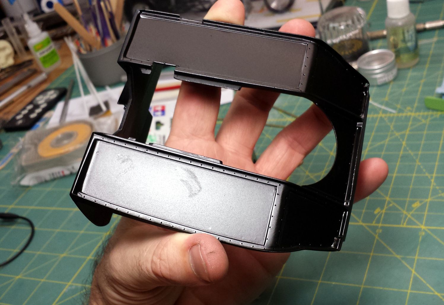

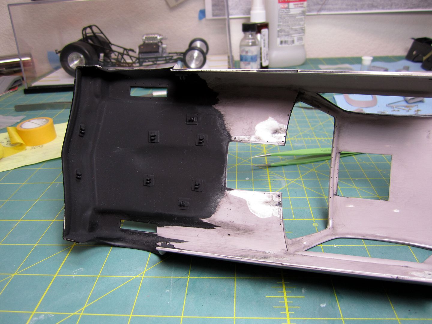

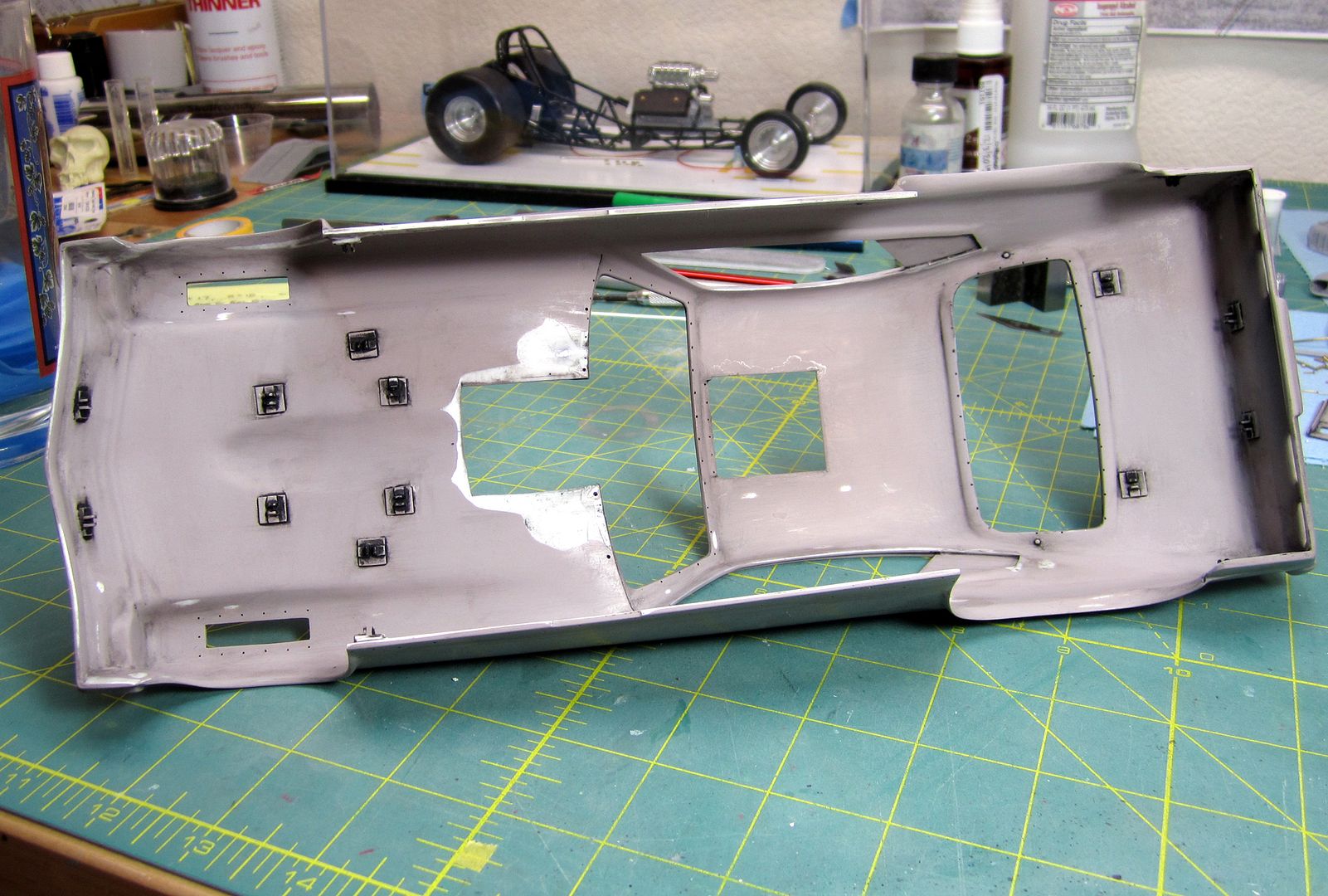

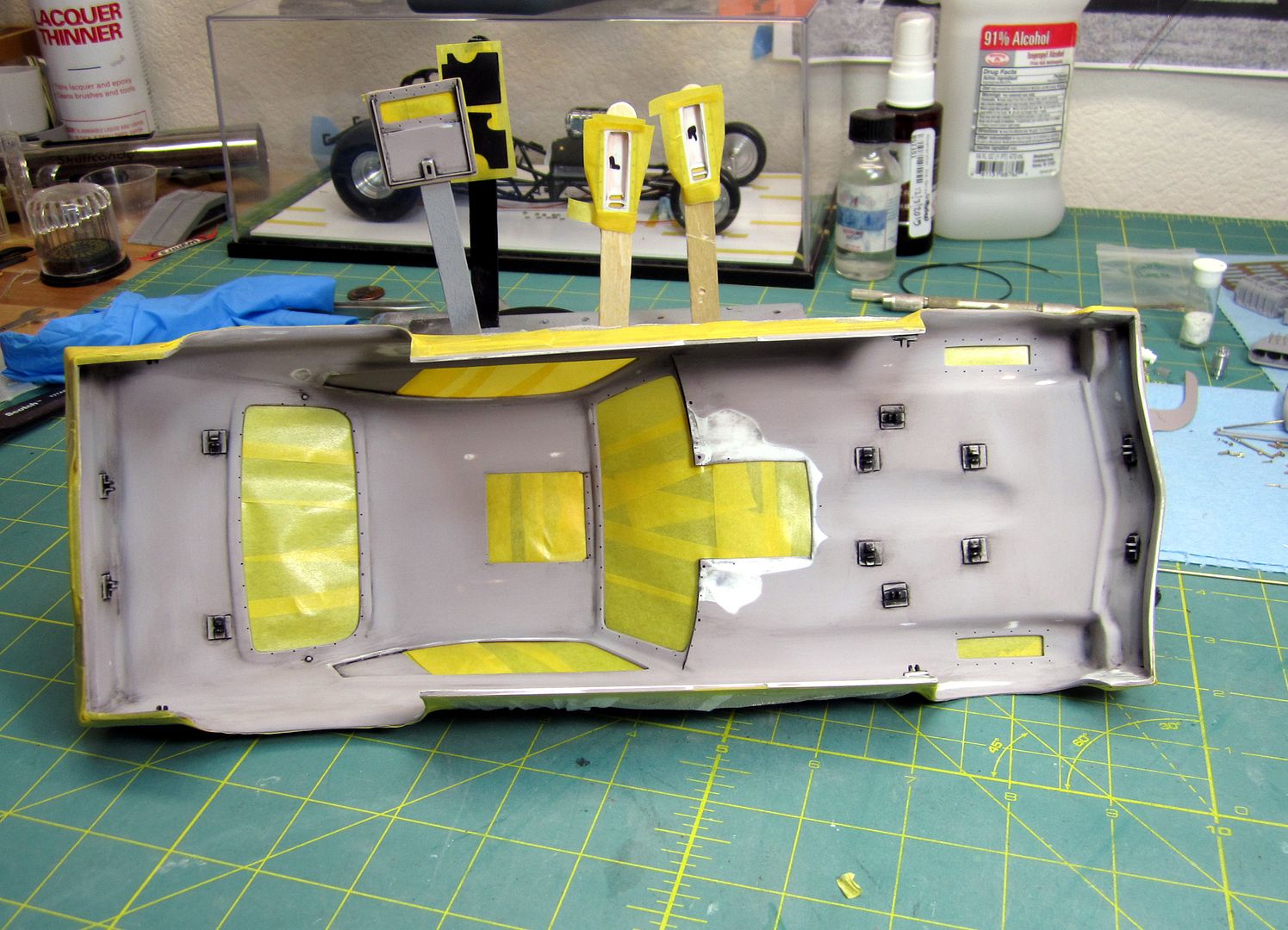

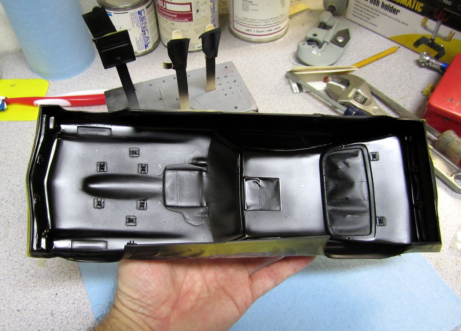

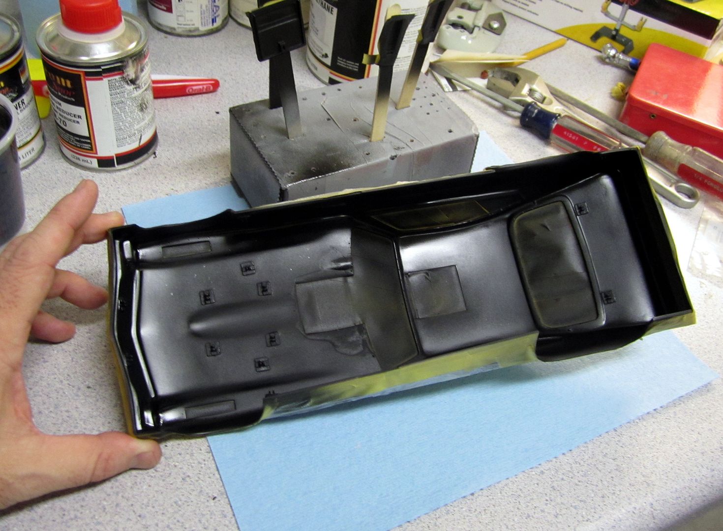

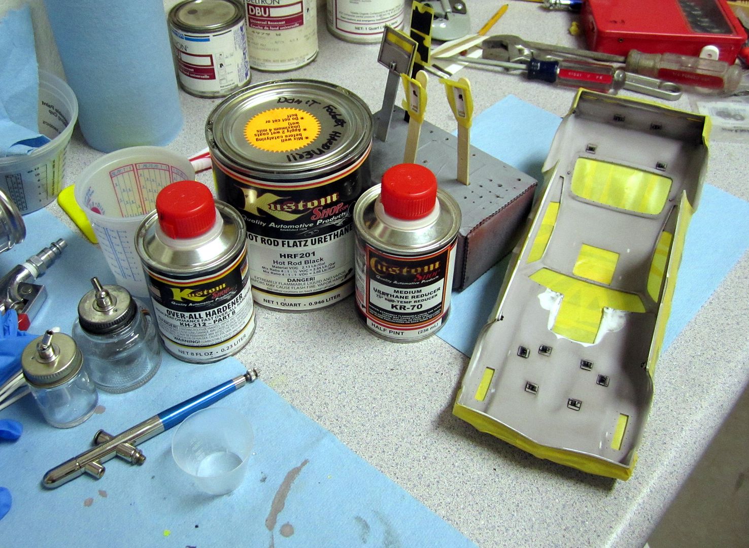

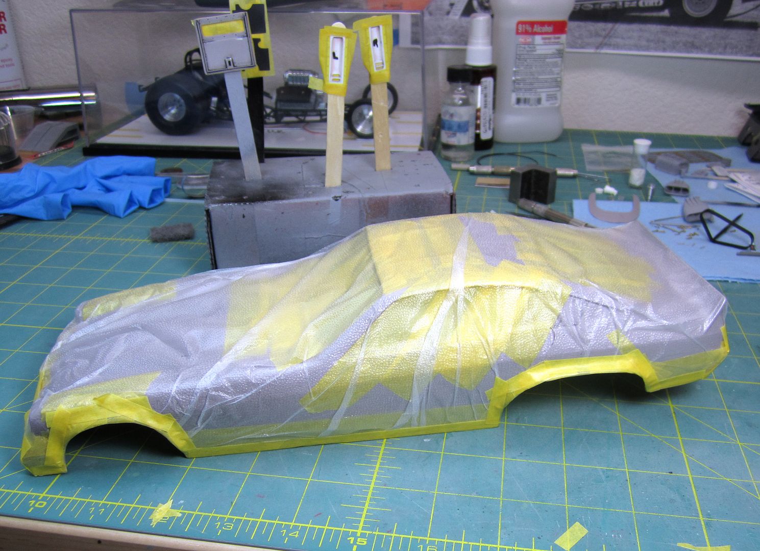

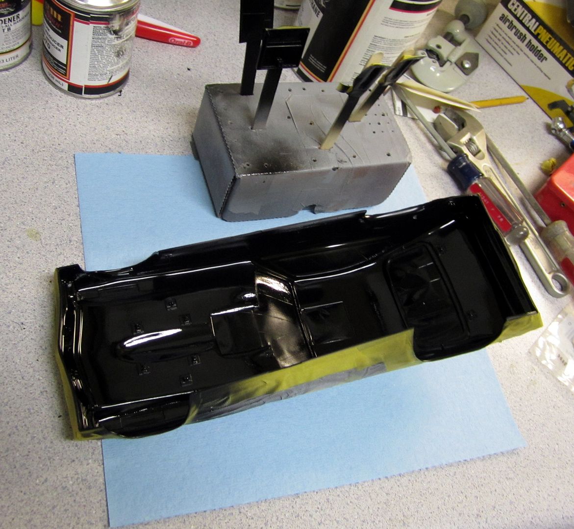

Mooneyzs Posted March 11, 2016 Author Share Posted March 11, 2016 Then on Sunday I got the body all taped up and ready to spray the inside of the body as I mentioned with the Hot Rod Flats Hot Rod Black Urethane. Was so happy to get to this point to be making progress on the body: Well this is the part of the story where I take what felt like 5 steps back. After I was done spraying the 2nd coat of black. I was looking at their tech sheet to see the drying times and on the tech sheet it was talking about using a certain part number hardener so I though to myself that can didn't look like what I used. Well right then and there it dawned on me that I totally forgot to pull the Hardener out of the refrigerator. It was that moment that my stomach just dropped and I though to myself that I messed up big time. The paint had seemed to be dry to the touch and well I decided to call a dear friend of the family who got me into painting with automotive paints since he is car painter and been doing it for a long time. So I told him my big screw up and he told me that he has heard of people doing worse...lol and told me to contact the manufacture to see what they say. SO on Monday I call TCP Global who is the owners of The Custom Shop which is the Hot Rod Flats and after talking to the Customer Service guy. He basically told me that the paint will dry but will never actually cure But he did say that I could use the reducer and it will wipe off with the reducer. He also said I could leave it but as he mentioned it would never cure and I was afraid that when I got to back tape it when I do the color could the tape pull the paint from any where. Needless to say after I got off the phone I was Totally bummed and wanted to put the car back on the shelf. I have been pushing and rushing myself to get things done trying to make the show next month. So Since Tuesday night I have been taking a few days to remove all of the black that I painted with the reducer as the customer service told me to. It was a paint in the A$$ because I had to be really careful not to break any of the tabs. Anyway the moral of this story is that if you are ever shooting Automotive paints don't forget your Hardener...lol. I don't want any of you to have to go thru what I did. Now most base coat/ clear coat paints you only use hardener in the clear and you only reduce the base coat. The base coats are reduced typically 1:1 or 2:1 depending on the brand and clears are typically 4:1:1. If you want it a little thinner to spray from an air brush you can safely add another 10% of the reducer which actually helps it flow out and lay down better from my experience. Anyway here is a pic after I started removing the black paint. I actually took some with my cell phone in the first few stages of removing the paint but unfortunately this morning my cell phone decided to take a BLAH_BLAH_BLAH_BLAH and break on me. the stupid on off button broke and I am waiting for Verizon to send me a new one...lol so this pic was when I had most of the paint removed: Now here is the body after I have removed all of the paint off: Quote Link to comment Share on other sites More sharing options...

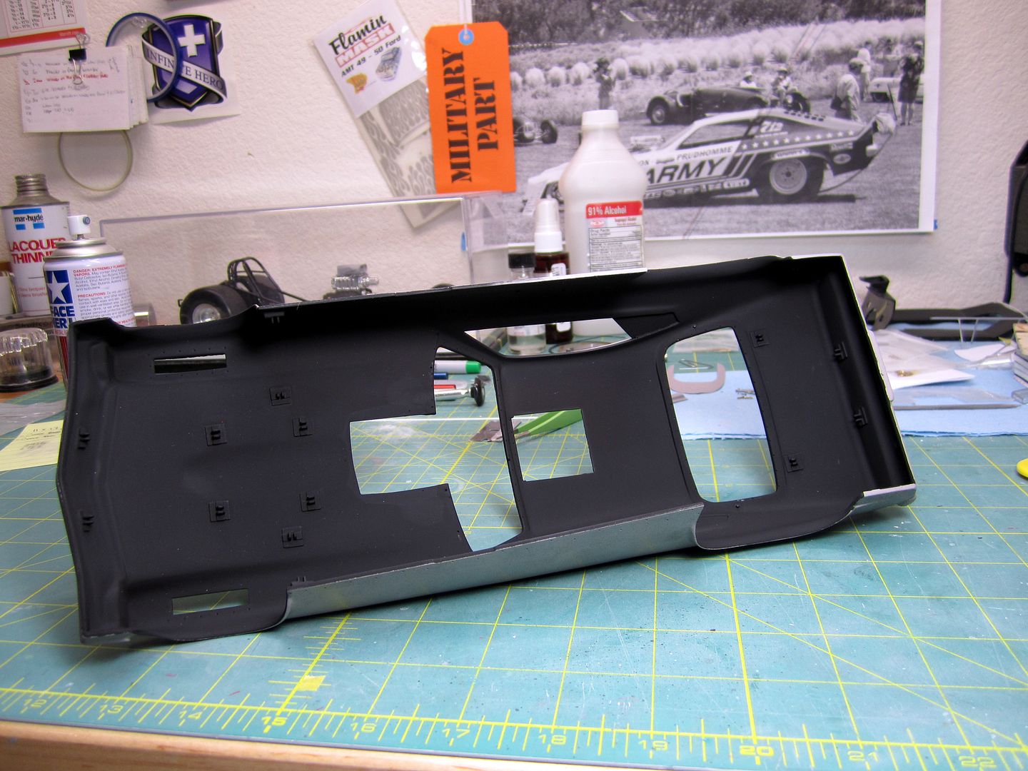

Mooneyzs Posted March 11, 2016 Author Share Posted March 11, 2016 So After removing all of the black with the reducer. I had to sand some areas of the underside of the body. I used some fine scotch brite and some 400 grit sand paper since a few of the areas the reducer too it back down to the plastic. which had to be careful with it on the bare plastic it looked like when you use weld on #3, Pro amproid...etc glues like that. After sanding it got a bath in some luke warm water with some dawn and then I let it air dry. Tonight I got it all taped up again to repaint: Then I used some glad press and seal material so I did not have to tape the whole body up: Here is all of my materials ready to spray again. And if you can see I wrote on the top of the can a reminder to myself not to forget the Hardener ever again ;D Here was after the first coat: This was immediately after the second coat. They recommend spraying wet coats: And here it is after maybe 15 mins of flash time: I have to tell you guys that I am so happy to be over this hurdle. Now I can get back the nexts I was originally going to start working on before I made my little boo boo. So Stay tuned and I will hopefully have another update tomorrow and some over the weekend. Quote Link to comment Share on other sites More sharing options...

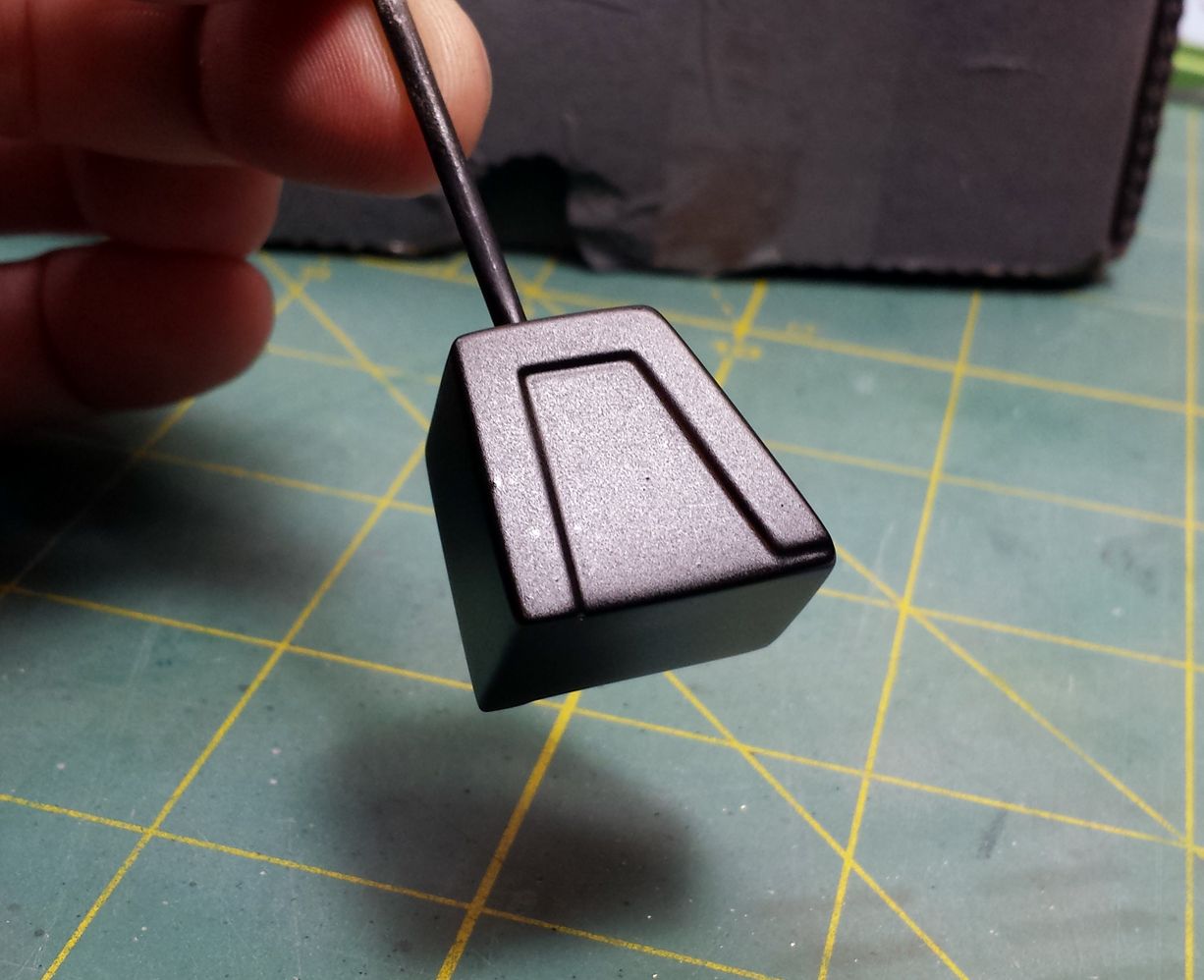

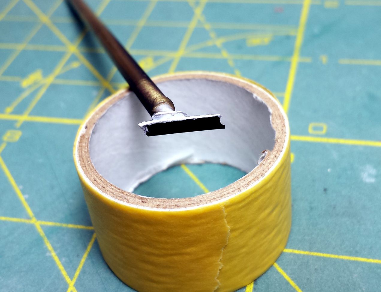

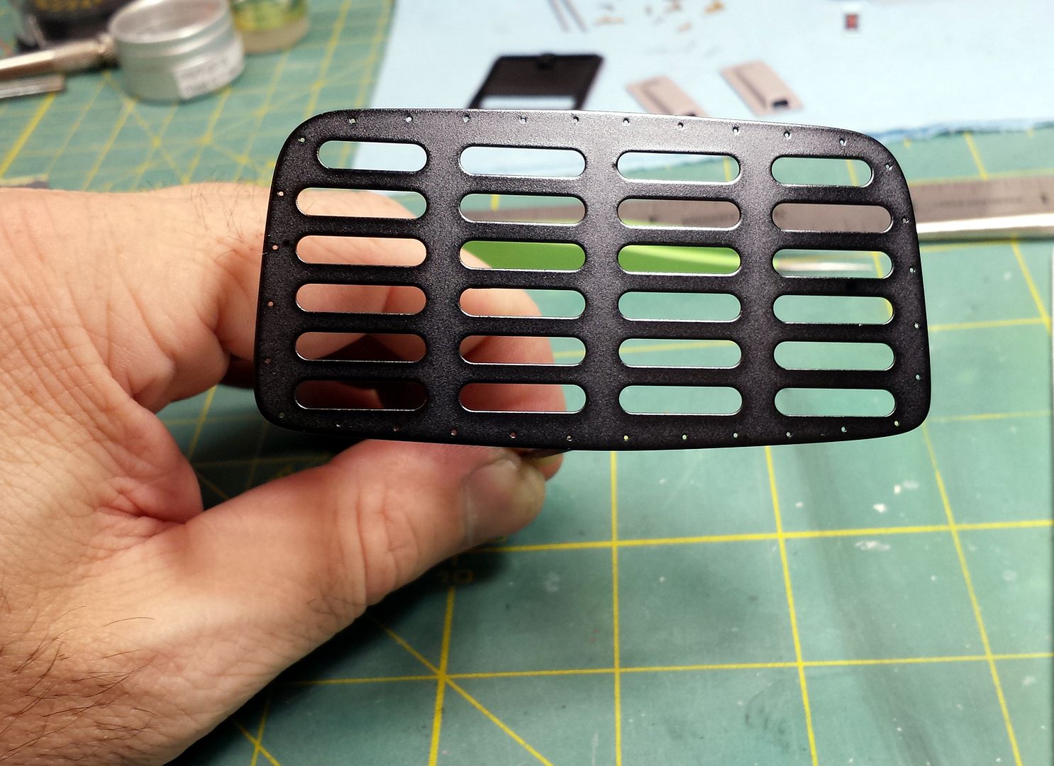

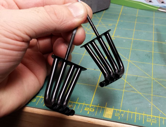

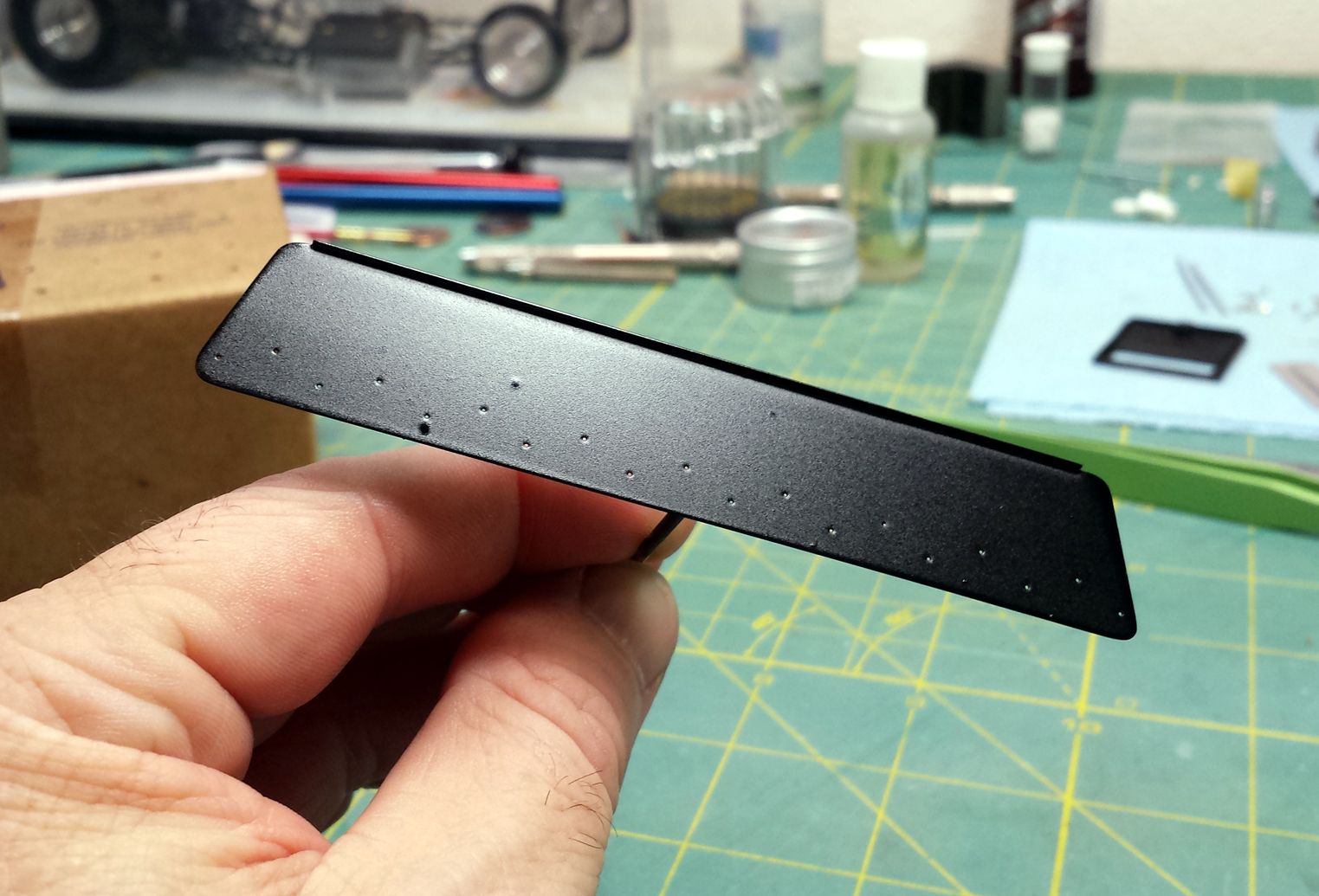

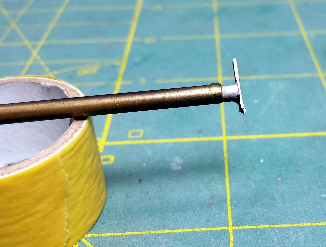

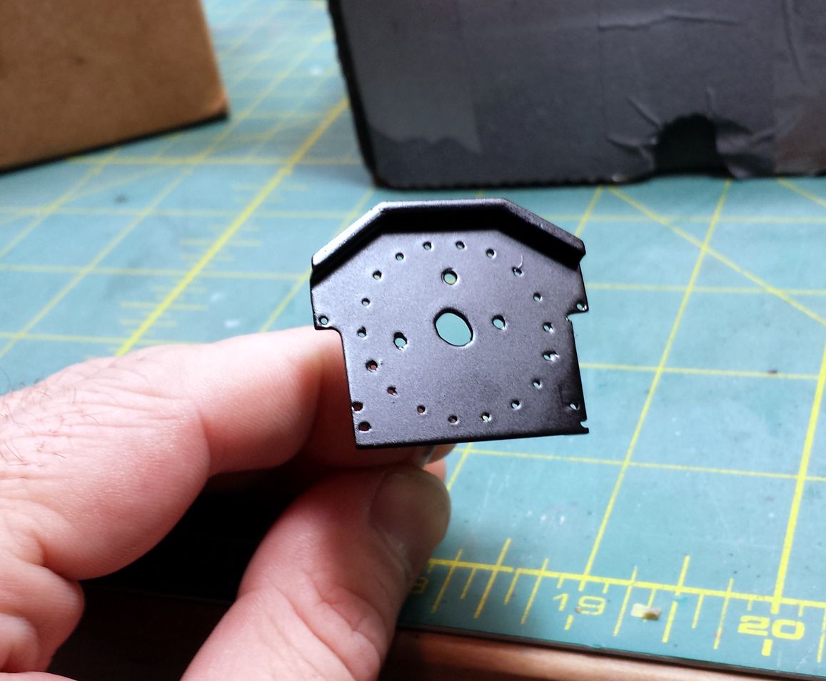

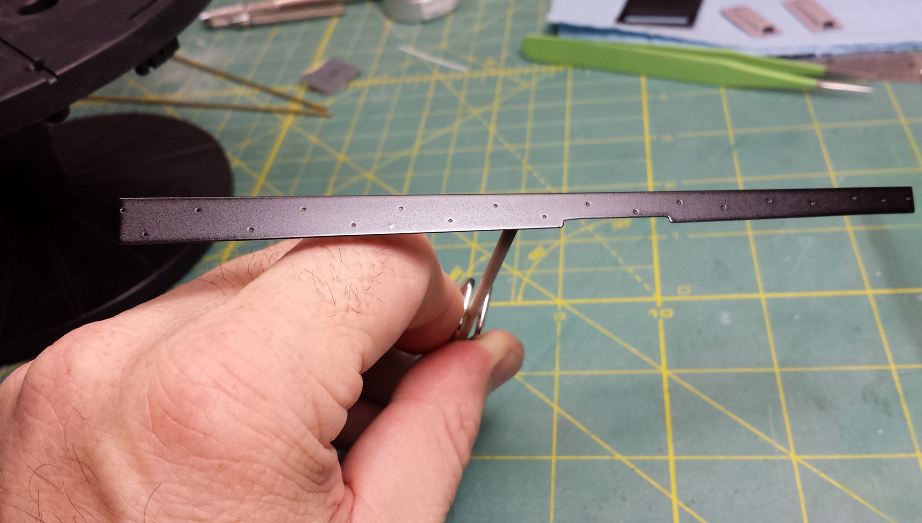

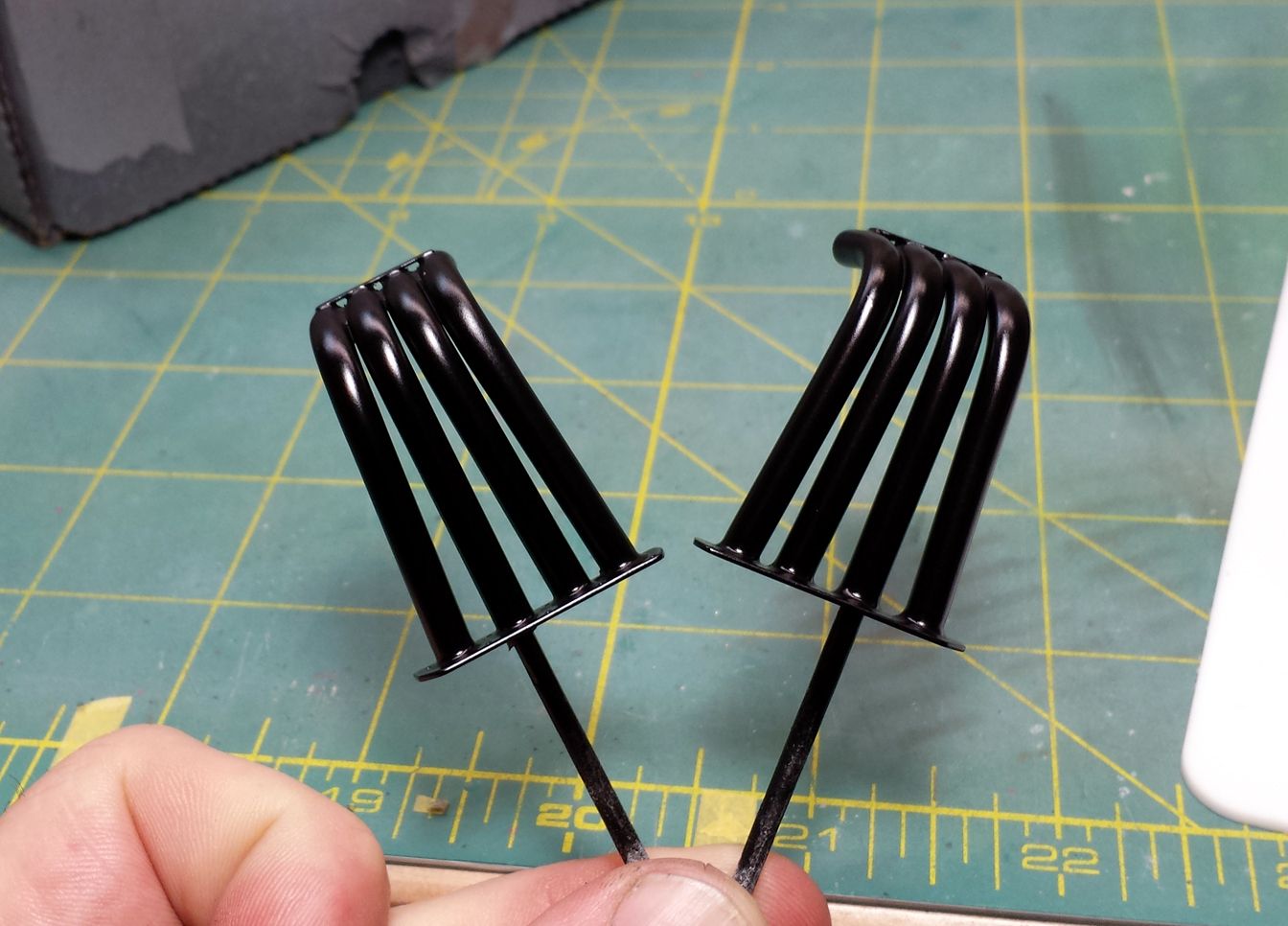

Mooneyzs Posted March 13, 2016 Author Share Posted March 13, 2016 Hello all... well it that time again for another quick update for you I made some more progress yesterday but just as this Journey has gone with with this build, every time I feel I am making good progress and make a couple of steps forward. I always ended up taking 3 to 4 backwards. I did get some time in with the Airbrush yesterday. I got a bunch of parts prepped and ready to paint a semi gloss mixture of the Hot Rod Flatz paint. I took their Hot Rod Black and Chassis black to create a sheen I was hoping to achieve and got a bunch of parts sprayed... Here is the progress....I started by getting some under seat panels painted:Then I got the Mid-Plate resprayed I may try to weather ever so slightly:Got the Headers repainted and I think I am going to weather these just a little as well:Backside of the Headers: Quote Link to comment Share on other sites More sharing options...
Mooneyzs Posted March 13, 2016 Author Share Posted March 13, 2016 I have to apologize for the pics. I was taking them with my cell phone and they didn't turn out so great I got the fuel tank resprayed but there ended up being a few pieces of dust that got into it and on the very top of the tank it seemed the paint pulled to the edges. sorta hard to see here since the pic wasn't in focus: Side shot of the tank. There ended up being a few spots that the airbrush splattered some paint, like it spit: Got the heat shields painted but I was not at all happy with them since it had a blemish in the paint that was noticeable to me and the fact that the paint pulled to the edge. Needless to say I will be redoing these: Got the wing sprayed. And if you can't notice there are a few blemishes that look horrible to me. This piece will get re painted as well: I was so stoked to get the back window painted and now if you look closely you can see on the outside edge and the edge of every louver that the paint looks different and that it pulled to the edges. I am wondering if it was because I thinned the paint a little more so that it would lay down a little smoother. This piece is on the Re-Paint list as well...lol: Quote Link to comment Share on other sites More sharing options...

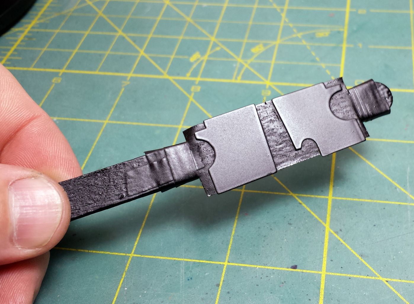

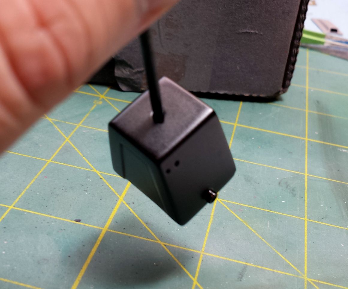

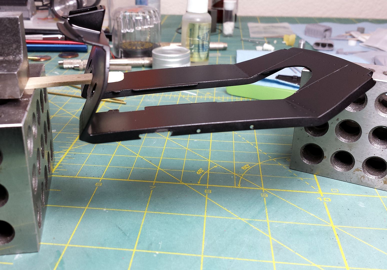

Mooneyzs Posted March 13, 2016 Author Share Posted March 13, 2016 Well with all of the good news here is where there is Bad News... LOL This seems to be the Theme of my post lately and I don't know why but it is. I was so happy to be able to get the Body tins repainted so that I could start installing all of the rivets into it. SO I decided to super glue a piece of plastic to the side that I could use as a handle to paint it. Well it seemed like a good idea but in reality ended up not being. You will see a few pics down. The top seemed to turn out ok: Here is the bottom and where it goes down hill from here. So in the middle of spraying my first coat on to the Body Tins. I started out by spraying the bottom side and then was going to move to the top side. All was going well until when I started to spray the top side and literally the handle broke and it was like slow motion that the tin started to fall. Now keep in mind that the super glue held perfectly but the plastic that I had super glued to broke in mid spray. I will say this I was lucky enough to have caught the tins from hitting the rocks on the ground in my back yard. Some how I was able to save it from hitting the ground. you can see in this pic where some of the paint had smeared from my fingers hitting those spots and I caught the tin in the rear of the hoop area on the right: I will be honest.... this is where you may not want to look... LOL. The pic turned out blurry but you can see the area where the plastic broke. It just dawned on me right now where I should of glued the handle now. Too Late now...haha.... SO this is the 3 or 4 steps backwards spot and sucks that I have to fix the tins yet once again: Here is a side view of the piece that broke off. You can see that I super glued a piece of plastic tube to the tins and then I place a piece of brass tube around the plastic tube to make the handle stronger because the tube seemed pretty flimsy: Here is a somewhat straight on shot of the piece. The only good news is that I believe that it should be pretty easy to put that piece back in place and Super Glue it in. SO hopefully the fix won't be that bad: Needless to say I have had a few more set backs with this but I am going to the bench now and I am going to be working on stuff on the engine and parts to take a break from all of this body stuff. Hope to show some progress later today. Quote Link to comment Share on other sites More sharing options...
