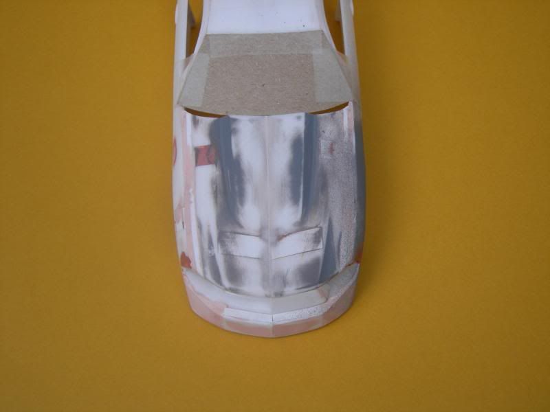

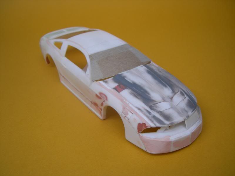

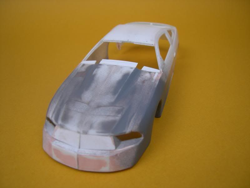

futurattraction Posted September 7, 2013 Author Share Posted September 7, 2013 Thanks guys. I've got a couple of "in progress" updates. Got the hood seam filled and sanded. As I've been poring over pics of the 1:1s, I realized that another mod I need to do is extend the trailing edge of the hood back into the base of the windshield. Before I can arrive at how much, I needed to establish a reasonably close idea of where the windshield needs to be, so I mocked up a cardboard rough template to get a decent idea. You can see in this overhead shot how the rear of the hood is going to need to be reshaped. This is a rough profile of what it will look like. When all is said and done, I'll draw the shape up in my CAD program so I can have a piece that is identical from side to side, but this will get me in the ballpark. Comments welcome... Quote Link to comment Share on other sites More sharing options...
comp1839 Posted September 7, 2013 Share Posted September 7, 2013 excellent catch, scott. those pesky "little" things can really make the difference. Quote Link to comment Share on other sites More sharing options...

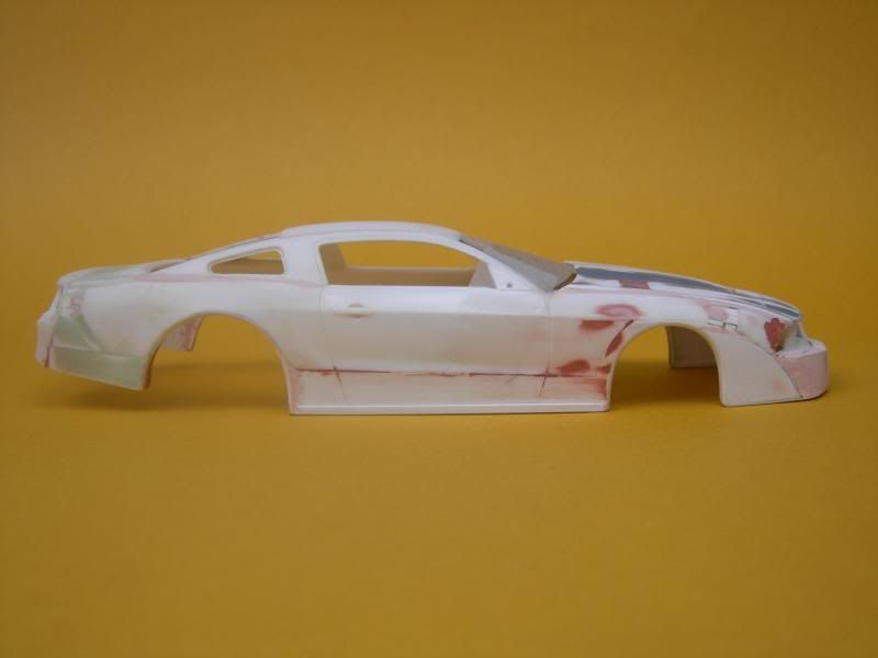

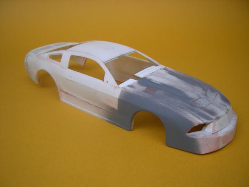

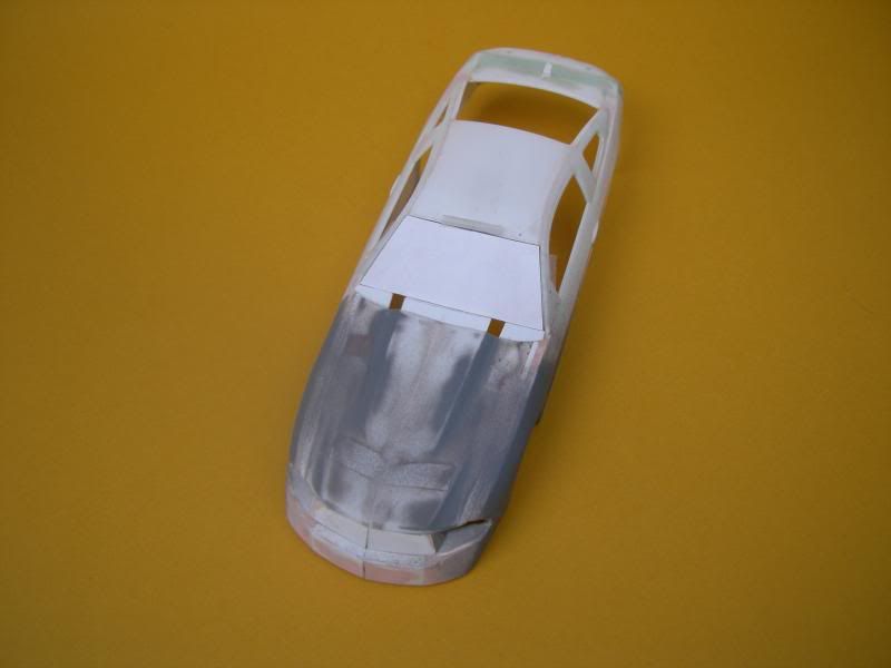

futurattraction Posted September 12, 2013 Author Share Posted September 12, 2013 After the last update and pics I realized I needed to extend the rear of the hood quite a bit more than I'd originally indicated, particularly after looking at pics of 1:1s. The base of the windshield runs much more parallel to the upper curvature than I'd realized, so I drew up a windshield template in CAD so I could make one that was mirrored, side to side. After a few trial fits I came up with something that is at least real close. This also allowed me to cut and fit a piece of .040" sheet in after fitting it to the fenders and hump in the hood. I also need to extend the inset and raised sections at the rear of the hood. After getting the outer 1/2" of each side of the extension glued in, I cut out the middle of the extension and fitted a new "raised" section . Small gap fillers will then be attached and tie the whole shebang together. After the extension has all been roughed into shape, I can then cut the excess off and reshape it to match the final windshield shape. Lastly, I got the grille blank glued in permanently and shot a bit of primer on the leading edges of the front fenders to check how much body work/blending I still have to do to smooth everything out as it transitions into the nose. I had some help from Emilee while I was taking pics... lol Comments welcome! Quote Link to comment Share on other sites More sharing options...

comp1839 Posted September 12, 2013 Share Posted September 12, 2013 scott, just incredible!! if you make this available to the public, all i can say is "what a lucky bunch of model builders". this is just awesome!!! Quote Link to comment Share on other sites More sharing options...

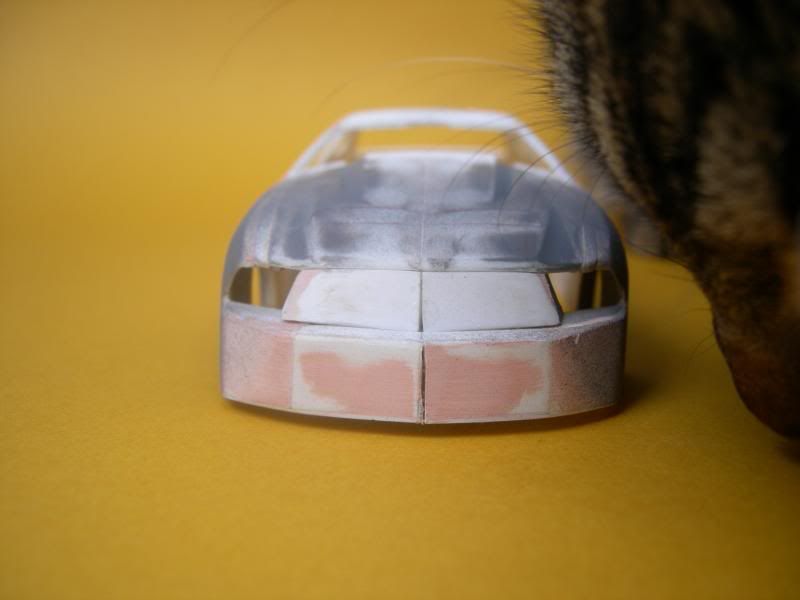

tubbs Posted September 13, 2013 Share Posted September 13, 2013 hey Scott, looking sweet. compiling the hours in that body, aren't cha.... I put my lightning away, just for that reason, thought I was going to get some other projects done....... HAHA, what filler are you using? what sheet thickness also? keep plugging along, we will be chatting soon, I think I am going to expand on some PE parts. Quote Link to comment Share on other sites More sharing options...
futurattraction Posted September 13, 2013 Author Share Posted September 13, 2013 (edited) Dale - I'm gonna have to trust the others to figure out who Morgan is racing... Thanks Larry. I got the gap filler pieces in last night after I got home from barbershop chorus. Lord willing, more updates will be coming. Hey Al. Nice hearing from you. I've been all over the board with filler. When I started this project over a year ago I had some Evercoat (green) that I was using, then the tube the activator was in developed a crack in it and the tub the filler was in was always a pain to use, so I ended up getting some 2-part Bondo filler (pink), which is what I've been using more recently. I have used a bit of Milliput on the inside of the body to strengthen a couple joints, but all the exterior filler has been the first two mentioned. I will go to using some glazing compound for doing fine work because it shapes easily and doesn't require a lot of pressure to remove material, which lessens the likelihood of messing up adjacent areas of the body. A prime location I know I'll use it is back where the C-pillars transition into the top of the quarters. There needs to be a more gradual radius. It will help to soften the body lines and add a bit more "roundness" to the shape. The material I've used to extend the hood was .040" sheet. I'm 99% sure that is the thickness I used to make the flat body sides and rear, lower quarter panel extensions behind the wheel well openings. The rear wheel well lips were two, layered .020x.125 strips fitted against the edge of the opening because I want to create a band over the top of the opening. The front lips were a single piece of .040x.100 strip. I should have probably done those as two layered strips, too, but didn't. The thicker material fought me the whole way. It is attached to the inside of the opening, not against the edge (like the rears were done). The valence panel is a hodgepodge of stuff I don't even recall now... lol Probably lots more info than you really wanted or needed to know... Edited September 13, 2013 by futurattraction Quote Link to comment Share on other sites More sharing options...
