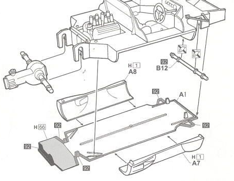

I was wondering if Alumilite would be good for casting based on a plastic part that I already have.
Basically I was missing those parts from this kit and bought another one just for them.
To make the most of my situation, I'd like to see if I can have 2 complete kits.
Attached is a pic, parts A7 and A8 are what I'd like to duplicate.
It's a 1/24 scale Fujimi Chaparral 2D.
If you'd be so kind as to letting me know your approach to this, I would be grateful.

If you would like to learn casting just for the fun of it (I personally think it is a lot of fun), then you could definitely cast those parts. It would be a bit tricky because there are some undercuts, and it would have to be a two part mold. Maybe not the best choice for your first attempt, but with some experience you could get there. I am no casting expert, I've just been fooling around with it, but I've used both Smooth On and Alumilite, and both have worked well for me. For starting out I would recommend Alumilite, just because they sell smaller quantities of the mold rubber, and mold rubber has a fairly short shelf life once you open it.
