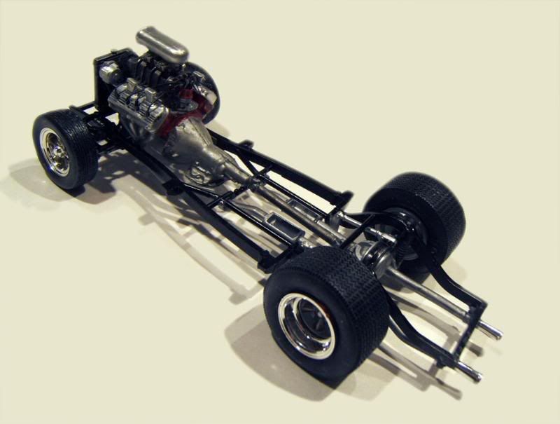

Bernard Kron Posted November 16, 2010 Share Posted November 16, 2010 (edited) ... the longer you wait to lightly buff it the less paint comes off. And for some reason some color coat will always want to come off so you have to be carful handling the part.... This about sums up my experience. Typically I wait a day before buffing and the Metalizer holds up extremely well. I use a soft cotton cloth or facial tissue for buffing. If you let the Metalizer dry thoroughly I have found that you can buff fairly agressively to get a very high shine. I generally apply my Metalizers over primer (usually various shades of Duplicolor) for 2 reasons: 1) It provides some tooth so that the Metalizer (once it's dried properly) holds up well; 2) I use the various shades to control subtle variations in the final shade of metalizer. Not mentioned so far is that I quite often will use Metalizers directly out of the jar with a brush (even though they say airbrush only) for small parts and detail work. It should be applied smoothly and sparingly to avoid buildup and brush marks. If you wait 5-10 minutes or so between coats you can build up a decent layer. Properly dried it is extremely effective. I use virtually every shade of Metalizer in both spray cans and jars for one purpose or another. Over time and with much handling they all will gradually rub off so once they're applied I tend to avoid handling whenever possible. I quite often will apply a second coat which helps with this issue. I never apply a clear coat of any kind if I want the Metalizer effect. I agree than many of the non-buffable colors buff up quite nicely. I swear by the stuff and Testors makes a lot off me every year with this particular line of paints. I especially like the air of realism it lends my projects. Here's are some pictures of the motor and chassis from the Revell Willys Street Rod which I completely stripped of chrome and detailed in Metalizers which shows what I like about these paints: Edited November 16, 2010 by gbk1 Quote Link to comment Share on other sites More sharing options...
