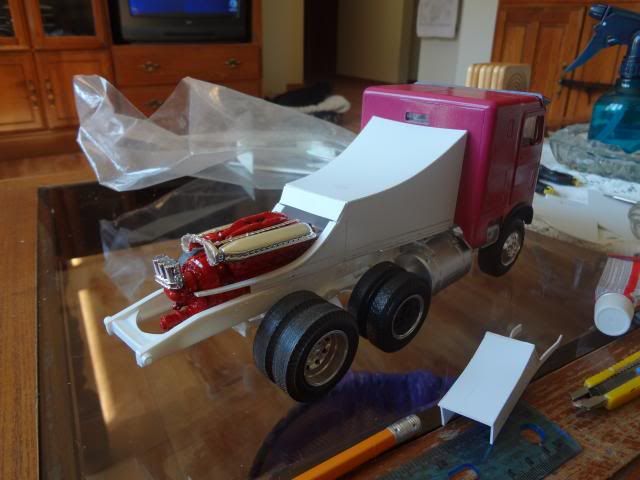

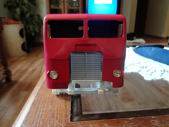

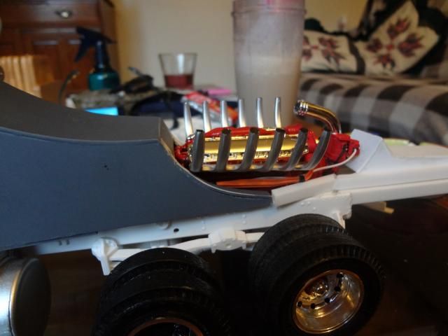

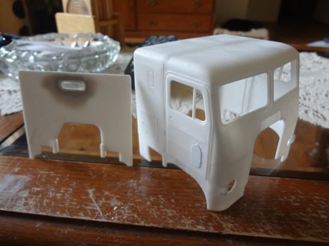

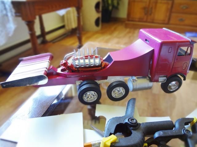

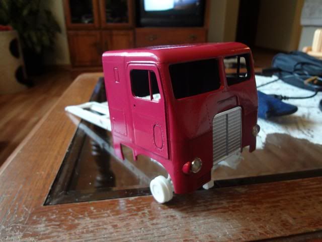

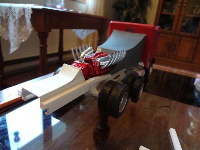

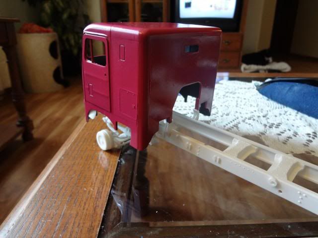

Here is a small update on the Defiance build. The cab has been shortened, I hope it's close I just went by pics. I also had to convert to a single headlight, put in a rear window and ajust the cab mounts. Lots of filling sanding priming and it got it's pink coat. More comming asa progress is made.

Alan did you shorten your front axle ? It is too wide for the stock tires let alone the T/M wider ones. Also the 1/1 looks like the front has been narrowed quite a bit.
Just building this truck stock needs about 1/32 or 3 mm taken from the center.
But since this is an older truck pitch the front brake hubs and thin down the inside of the wheel back if you need more clearance.

The only thing I have on my paint rack is Model Master Panther Pink and it looks close to your cab color. Do you have an airbrush ? You can always lighten with white to get closer to the pink you want. Years ago I used "nail polish" for custom colors , they sprayed pretty good after thinning.
That is some spectacular styrene work , and it starting to take on the shape of the real one.
