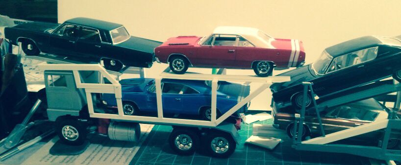

Mopar - D Posted January 1, 2015 Author Share Posted January 1, 2015 Tom you will not have any problem getting your 6 Cameros on the Revell transporter. Here's my Revell transporter with 6 Mopars on it. Thanks for the complement it was close on getting the last car on as it came to adding a extra ramp to make it work. Quote Link to comment Share on other sites More sharing options...

Mopar - D Posted January 2, 2015 Author Share Posted January 2, 2015 Here we are with all 6 Mopars loaded up on the trailer. I've also started on the front part of the trailer that will attach to the truck. As far as I can tell from the pictures of these trucks they have a mini 5th wheel for the trailer. I cut down the the 5th wheel from the Frightliner. I'm keeping my fingers crossed that I've added enought reinforcing here to carry the load. Quote Link to comment Share on other sites More sharing options...
kilrathy10 Posted January 2, 2015 Share Posted January 2, 2015 This is looking great, Man....Excellent kitbashing.......I would suggest you use a triangular piece or pieces in the middle of where you've mounted the fifth wheel....Half on the fifth wheel and half on the truck......Kind of like a speed bump.....If you know what I mean.....That way the cars will ride over the reinforcement without scraping the bottom......I'll try to post a drawing..... Quote Link to comment Share on other sites More sharing options...

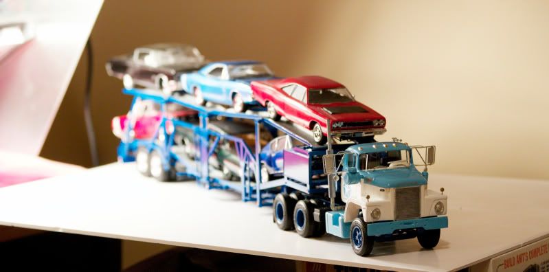

Mopar - D Posted January 2, 2015 Author Share Posted January 2, 2015 Here's the big picture 9 cars all 1968 Mopars. Still need to design build the truck hitch. I did a load test on the front of the trailer and all seems good. Quote Link to comment Share on other sites More sharing options...

Mopar - D Posted January 2, 2015 Author Share Posted January 2, 2015 Thanks JT I'm now working out the details on the truck hitch. I'm going to add a little steel reinforcing to make sure that there is enought strength with the way that this hitch has just a right angle. Jeff thanks for the complement and I would like to see the picture of your grandpas rig. Quote Link to comment Share on other sites More sharing options...

Mopar - D Posted January 4, 2015 Author Share Posted January 4, 2015 Build the hitch on the truck for the transporter trailer. I'm keeping my fingers double crossed that it will hold the trailer when it's loaded. Next will be to start adding more detail for the lifts and some ladders. Quote Link to comment Share on other sites More sharing options...

kilrathy10 Posted January 5, 2015 Share Posted January 5, 2015 (edited) It looks great, Man.....That fifth wheel setup is gonna work pretty good......You may have to add some angle to the bottom of the chassis to the lower portion of it for further strength, but It ought to hold....Or just cheat and add some legs under the trailer where they can't be seen....No need to worry about weather it will support the weight, then..... All your engineering efforts have paid off on this one, Man....Beautiful.... Edited January 5, 2015 by kilrathy10 Quote Link to comment Share on other sites More sharing options...
Mopar - D Posted January 5, 2015 Author Share Posted January 5, 2015 Tom it's about 30" over all. I will put a tape on it the next time I get on the bench. JT I've added some stiff wire in my design to make it hold up and was able to hide it so you can't see it. Quote Link to comment Share on other sites More sharing options...

Mopar - D Posted January 6, 2015 Author Share Posted January 6, 2015 Well Joe I was little short it comes to 35" bumper to bumper. Quote Link to comment Share on other sites More sharing options...
