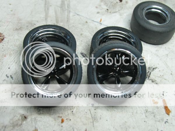

Belugawrx Posted June 13, 2014 Share Posted June 13, 2014 (edited) Got this tip from Freakshow (Fred McKee) and it worked great White glue and water brushed onto the outer rims you want to keep chrome,... Couple coats wait over night between coats,... Spray away!! Used Duplicolour Gloss black over the chrome spokes... I'm Likin' Cheers Edited June 14, 2014 by Belugawrx Quote Link to comment Share on other sites More sharing options...
Speedfreak Posted June 13, 2014 Share Posted June 13, 2014 Bruce, Do you just leave the water/glue solution on, without removing it? Nah, you gotta take it off right? Quote Link to comment Share on other sites More sharing options...
Belugawrx Posted June 14, 2014 Share Posted June 14, 2014 Bruce, Do you just leave the water/glue solution on, without removing it? Nah, you gotta take it off right? Hey Gene Ya Forgot the final step... Doh! Wash off the glue off after paint has completely dried with hot water to finish Quote Link to comment Share on other sites More sharing options...
Speedfreak Posted June 14, 2014 Share Posted June 14, 2014 (edited) Wait a minute? You put the glue on, paint over it, ('cause if your spraying it's gonna get paint on it) and 'then' wash it off? Edited June 14, 2014 by Speedfreak Quote Link to comment Share on other sites More sharing options...
Belugawrx Posted June 14, 2014 Share Posted June 14, 2014 (edited) Yep The hot water will get under the water based glue and with no persuasion with a soft toothbrush,. It dissolves,... basically,.. leaving virgin chrome try it you like it Edited June 15, 2014 by Belugawrx Quote Link to comment Share on other sites More sharing options...
