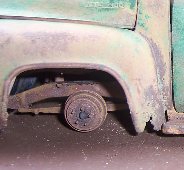

RyanSilva Posted November 10, 2008 Author Share Posted November 10, 2008 Superb work Rob and James Im so glad you guys tried it, its...addicting The same thing happened to me James, the alcohol works a little too well sometimes, but thats where practice comes in.. Weathering is all about feeling, in the sense that In order to gauge how much, you just gotta try it and get a feel for what everything will do or react in combo to the other paints and chemicals your using. I usually lay a old towel on my lap, dip my brush into some alcohol whether its a black and Alc, or just pure Alc, and dab it all over the areas i want to weather, dap on top of the now pooled up alcohol, and either let it evaporate and sponge it up lightly. I usually go over a model a few times with alcohol mixtures, just to make sure all areas are even. Hosted on Fotki This cab was done almost like the tutorial, but the key difference was i did not coat the cab with full layers, i just dabbed a small amount of paint in areas i wanted, and let the alcohol pick up most of it off. The base coat was enamel green followed by almond, then green again (all layers cured before each layer of paint) I buffed through the green down to the white, then back to the green, then i used acrylics. Hosted on Fotki This was used with all acrylics, just like the tutorial, except the top layers were done with smal lamounts of paint dabbed around. Quote Link to comment Share on other sites More sharing options...

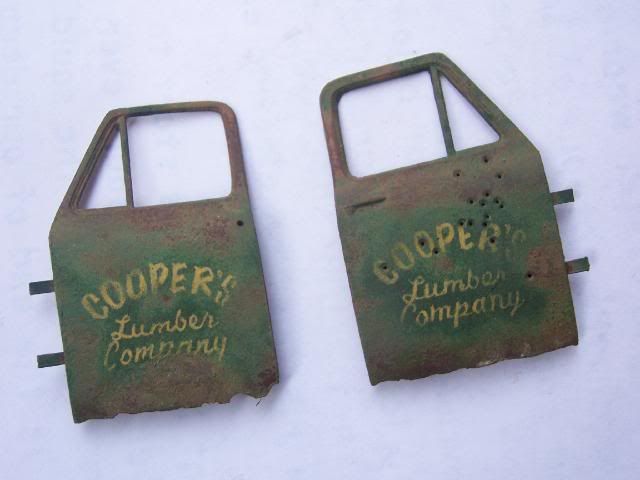

coopdad Posted November 11, 2008 Share Posted November 11, 2008 I thought I would share my experiences with my attempt at this tutorial. I had tested many, many variations of this process on spare fenders and most of my problems were paint lifting off the primer layer. 1. I found that the rougher the primer the less of a chance that the bottom layer of acrylic paint would pull off. In other words, don't use a gloss bottom layer or sand too much on the primer. 2. it seems to work best with many layers of paint. In my tests, I found that only one or two layers pulled away from the primer much easier than the four or five layer tests. 2a. removal of THIN paint was much harder to control than a normal layer of paint (don't want to say thick paint). Example: the left door had very thin paint toward the bottom (I thought I would be getting rid of it anyway so why waste paint). The paint instantly lifted off leaving only primer, requiring touch up: 3. In my arsenal of tools I found that a very stiff bristled fan brush (any shape should work but the smaller, stiffer the better) was very handy. It was good at very focused paint removal. I found it good on edges, such as door edge that had paint scuffed off. If the acrylic paint is not too soft, then you can use it to "sand" away the paint. Example: around the fender edge and where fender meets the body: Of course, I have not yet done Step 5 (rust streaks and black washes) but I have full confidence that after I do, the final project will be very realistic. John Quote Link to comment Share on other sites More sharing options...
RyanSilva Posted November 11, 2008 Author Share Posted November 11, 2008 Great work guys! Fantastic...that looks great, thanks for posting your progress! Paint lifting, I have the same issue in the past, i beat it by using artist quality acrylics for rust layers over the primer. The lifting , are the layers fully cured? sometimes when it isnt fully dry it will lift..in my case, it happens from time to time. Quote Link to comment Share on other sites More sharing options...
