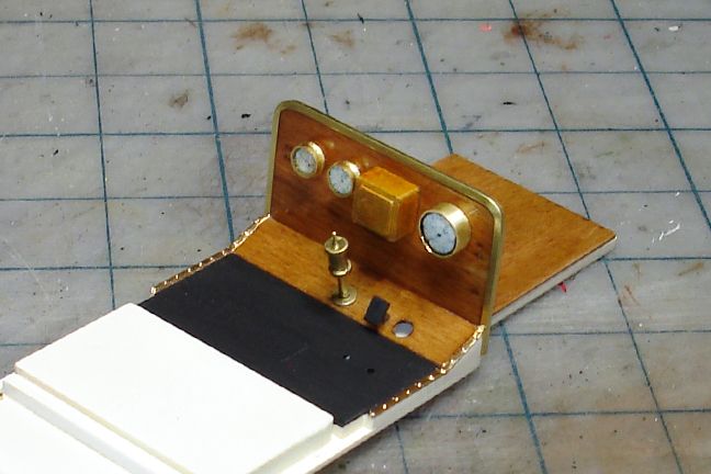

Harry P. Posted October 7, 2014 Author Share Posted October 7, 2014 More progress... The firewall and toe board are made of basswood, stained with the same stain I used on the wheels, then sprayed with several coats of Rustoleum 2x Gloss Clear. I made the brass edge trim on the firewall/dash out of 1/16" square K&S brass rod. I surprised myself by bending it to shape perfectly on the first try! I flowed a tiny bit of CA between the edges of the firewall and the brass trim, then sprayed the unit with more Rustoleum 2x Clear Gloss to help "lock" the brass trim in place. The kit has no decals for the instrument faces, so I found gauge faces online and printed them to size and glued them to the kit gauges. I added bezels that are rings cut from K&S brass tubing, and the "glass" on the gauges is clear 5-minute epoxy. The "brass" sill plates on the sides of the floorboard are gold BMF. Quote Link to comment Share on other sites More sharing options...

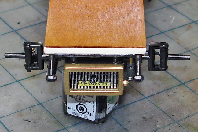

Harry P. Posted October 8, 2014 Author Share Posted October 8, 2014 The radiator was assembled from the four kit pieces. I sprayed the part with the cooling fins silver and then blackwashed it to define the fins. Luckily this was a separate part; that made detail painting it easy. The "brass" shell was sprayed Rustoleum Metallic Brass and then Testors Transparent Window Tint. I added the brass line on the side (brass rod, "nut" cut from styrene hex-shaped rod and drilled out, and real rubber "hose" (hollow rubber tubing found in the jewelry making aisle at HL), and BMF "hose clamps." The De Dion Bouton logo was found online, printed to scale, cut out, and attached to the radiator with Future. As a reference, the radiator is about an inch wide. Quote Link to comment Share on other sites More sharing options...

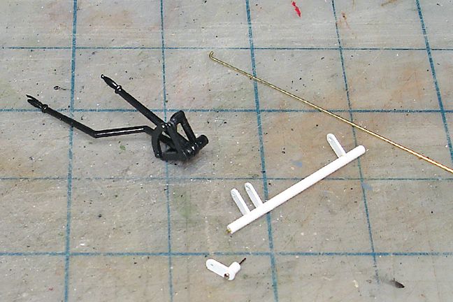

Harry P. Posted October 9, 2014 Author Share Posted October 9, 2014 The kit has rear brake drums, but no linkages, so here are a few scratchbuilt components for the brake and shift linkages (the black painted parts are kit parts). The brake rods will be made of brass rod once I have the linkages painted and installed... and I can measure for the rod lengths: Quote Link to comment Share on other sites More sharing options...

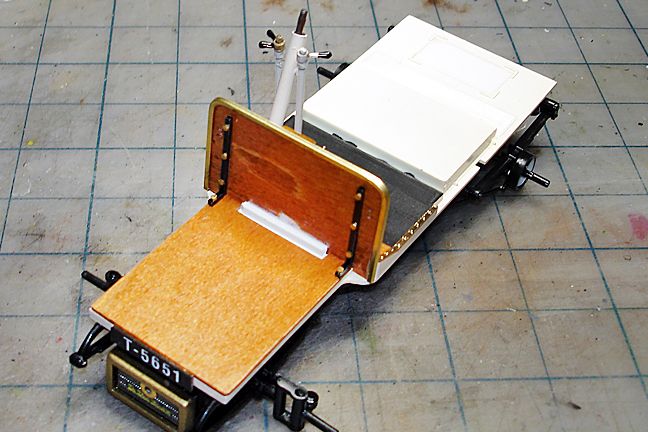

Harry P. Posted October 10, 2014 Author Share Posted October 10, 2014 The license plate was made in Adobe Illustrator, printed out, and attached with Future. I also added the firewall support brackets (styrene strip with slices of hex-shaped styrene rod as bolt heads) and the steering column hand controls. Quote Link to comment Share on other sites More sharing options...
