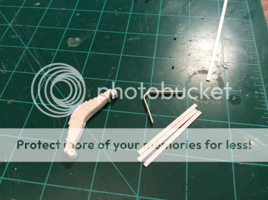

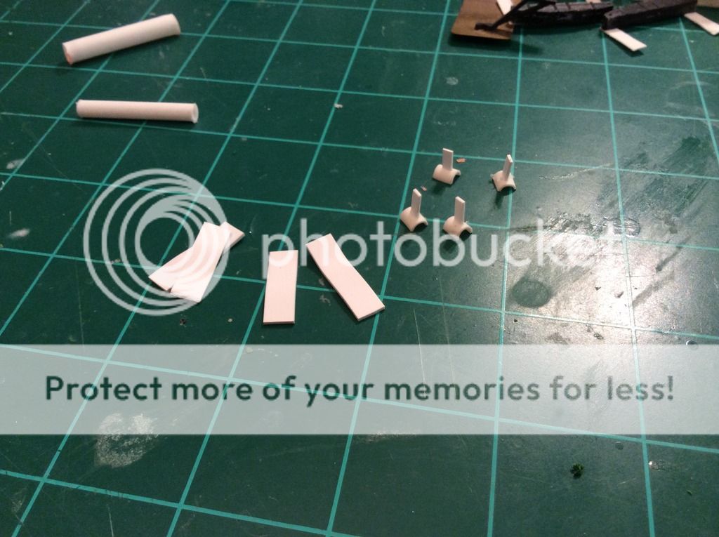

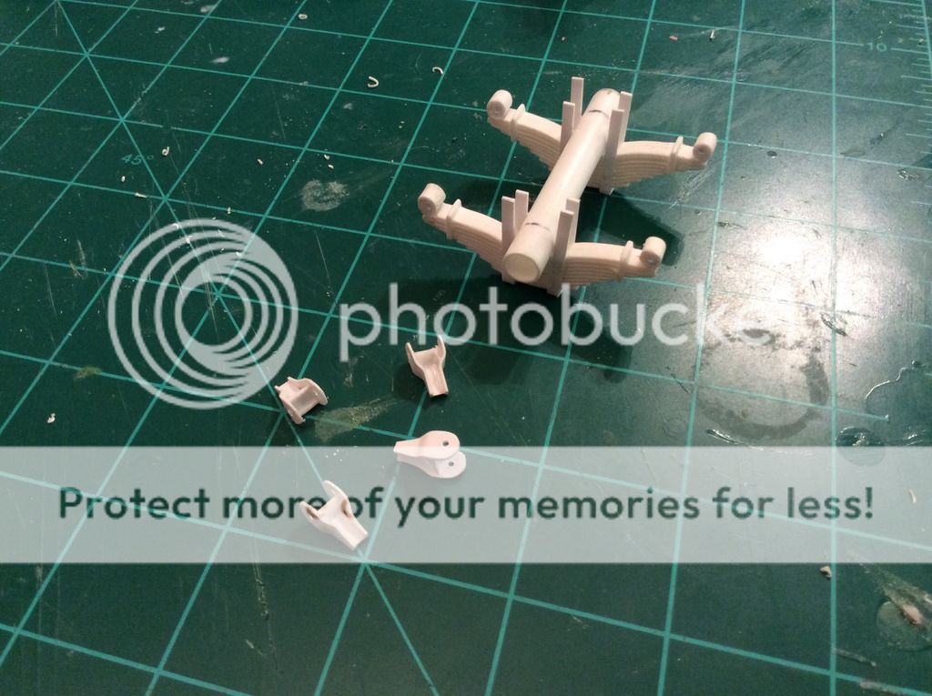

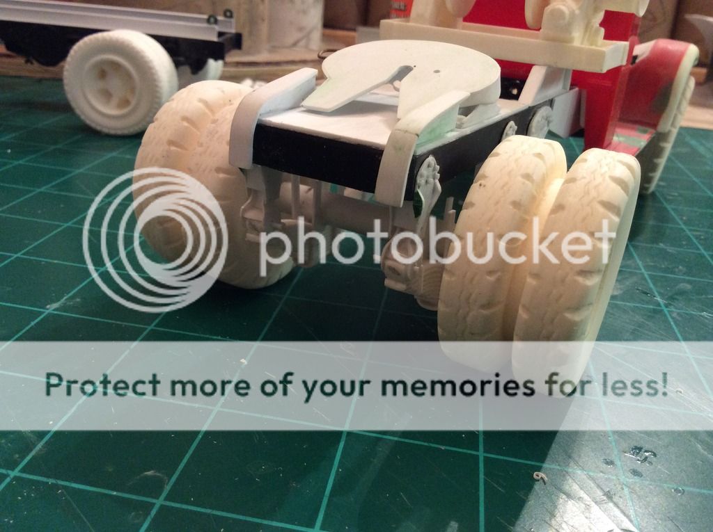

Superpeterbilt Posted July 11, 2015 Author Share Posted July 11, 2015 I've been slowly working on the rear suspension. There is still much to be done, but I can at least mock it up now. I started roughing out the shackles for the lower leaf springs. I will add a few more layers of thin styrene and putty to get them completed. After that, I will start on the upper leafs. Quote Link to comment Share on other sites More sharing options...

Bennyg Posted July 11, 2015 Share Posted July 11, 2015 How do you cut shapes out so cleanly? Ben Quote Link to comment Share on other sites More sharing options...
Superpeterbilt Posted July 12, 2015 Author Share Posted July 12, 2015 How do you cut shapes out so cleanly? Ben Don't let the finished work fool you, there's a lot of filing and sanding involved. At times when I have to make multiple parts the same shape, I cut them out bigger, glue them all together with just a tiny drop of super glue to keep them together, then file and sand them all to size, then slice them back apart with my exactly knife. That's how I made the rear spring hangers, and multiple other parts on this build. Quote Link to comment Share on other sites More sharing options...
