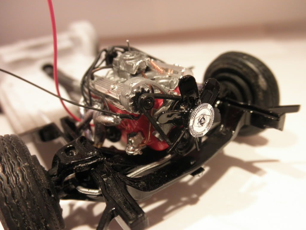

W-409 Posted January 25, 2012 Author Share Posted January 25, 2012 Got something done for the Nova. Engine is pretty much done, still some little things to do, and maybe few details to add. Alternator is installed, so is that belt and fan too. Fan Clutch got some black washing with The Detailer, I think it looks much better now. I'm going to wetsand paint this again tomorrow, hopefully I have enough time to build another Driveshaft Loop too. Quote Link to comment Share on other sites More sharing options...

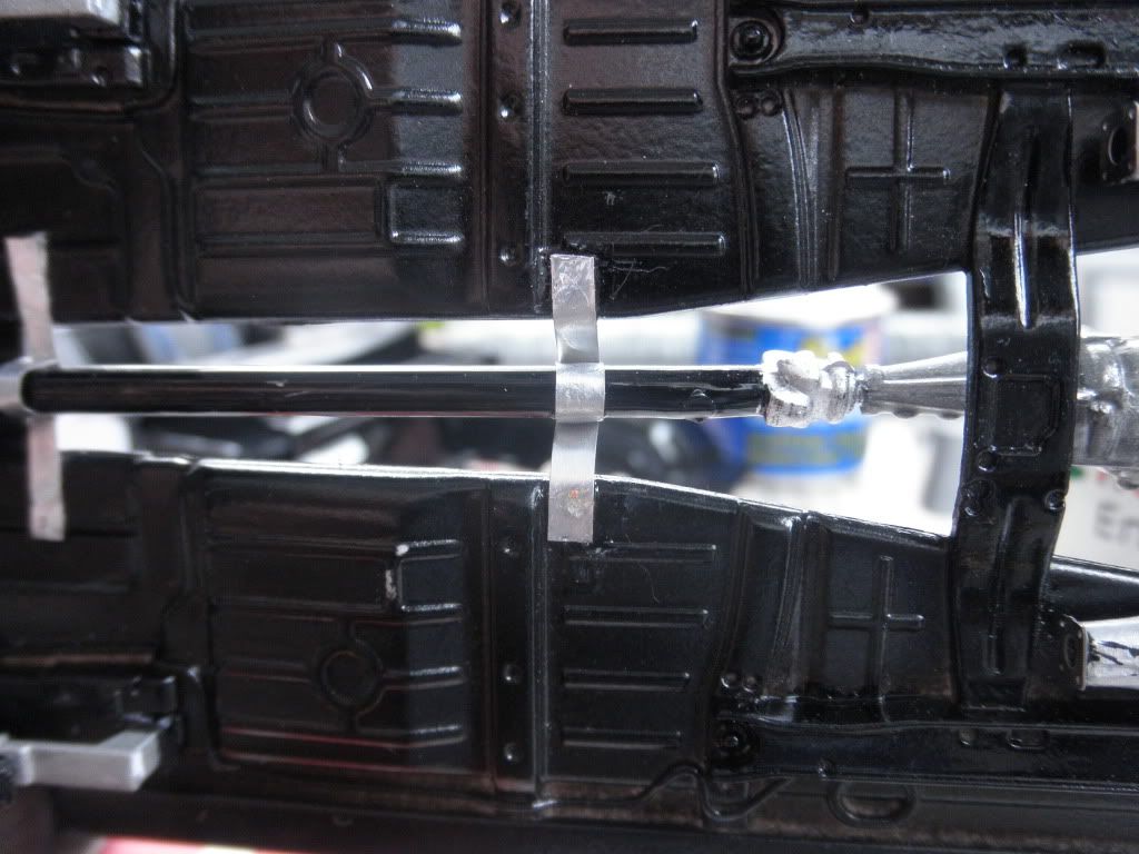

W-409 Posted January 26, 2012 Author Share Posted January 26, 2012 (edited) Thanks, Andy! Looks Like you have super nice Avatar! I built another driveshaft loop. It's from aluminium also. You think, it's better now? I wetsanded the body too, and I guess it'll be time to paint some more red to it very soon. I put the heater on in Garage, so it's possible to paint. Äh, that picture is too sharp. It does look better in person... Edited January 26, 2012 by W-409 Quote Link to comment Share on other sites More sharing options...

rssschris Posted January 26, 2012 Share Posted January 26, 2012 In the pics of the 2 cars doing wheelies , what looks like rear driveshaft loops are really fromt mounts for the ladder bars /traction bars. Take it from me, the loop should be in front ,alittle behind the u-joint. I have brocken a rear u-joint at a full thottle launch & the drive shaft just falls out on the ground, no problem as long as you have a rev limiter to stop your engine from overreving at the sudden loss of the load. We have also lost the front u joint under a full thottle launch, with front tires in the air, did not pole vault the car but the driveshaft came right through the floorboard of the car , could have killed the driver, but it missed him. It caused ALOT of damage , all the inside Aluminum tin work had to be replaced, along with most of the front tube chassis /suspension. I really belive that under full thottle, with the weight of the car off the nose, cosidering todays strong drivshfts, it would be very possible to pole vault a car if the front u-joint were th break. I now have a loop at the front & rear , plus my ladder bar mounts,running uner the drivshafts on both of my Camaros. Chris Quote Link to comment Share on other sites More sharing options...
W-409 Posted January 26, 2012 Author Share Posted January 26, 2012 Thanks Guys! Chris: That's suprising, how much damage one driveshaft can make. Good to have Driveshaft loop on the front and on rear. I guess they are good enough now on this Nova. I managed to fail the paintjob again. Needs to get more MR.Muscle. Quote Link to comment Share on other sites More sharing options...

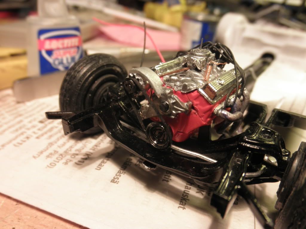

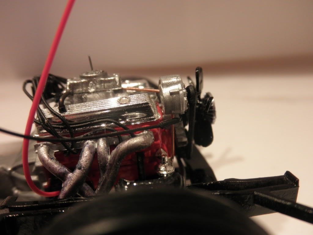

W-409 Posted February 2, 2012 Author Share Posted February 2, 2012 (edited) Today I was able to rework that belt and pulley area... I don't understand why, but I installed that fan and didn't convert that water pump to present Electric one. Now I built new belt from black paper, and pullies are from the kit. I converted that water pump to present electric pump, and I guess it's Ok. Not 100% correct, but good enough, it can't be seen very well anymore, when I put everything together. Edited February 2, 2012 by W-409 Quote Link to comment Share on other sites More sharing options...
SuperStockAndy Posted February 2, 2012 Share Posted February 2, 2012 That looks awesome! If you don't mind me offering some advice, the pump motor looks a bit small, but it's nothing major. Still looks good. Quote Link to comment Share on other sites More sharing options...

W-409 Posted February 2, 2012 Author Share Posted February 2, 2012 Andy: Thanks! The motor is bit small, yeah, but next time I'll build better one. Can't take that water pump off from the engine anymore. Bart: I managed to fail painting that red. After first coat, it wasn't shiny at all, but that wasn't big problem. Bigger problem was, that there were some mistakes on the bodywork, and trunk lid wasn't smooth. I didn't have Polishing set that time. Now I painted another coat of Red, to make everything look alright. BUT some strange things happened, and paint came away from the corners, and did little reaction with that older paint coat, so now I can see white plastic from some spots. Other than that, paintjob is pretty good, but those can't be fixed nicely, so I guess it's easier to remove that paint and throw about 20 year old Spray Can away. Without that problem, I would be happy and body would be clearcoated allready and waiting for polishing. Quote Link to comment Share on other sites More sharing options...
