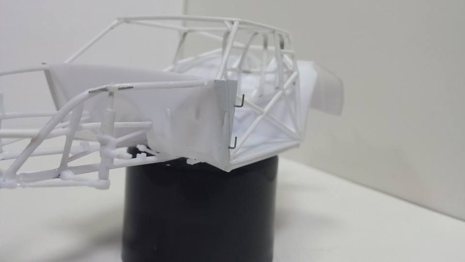

Well it's been a rainy weekend here so I took advantage of some free time and got to the bench... I always mounted my doors a particular way, and it has always worked fine... I make my hinges from staples.. I take a piece of .062 rod and drill a hole down the center of it just big enough for my staple to fit inside and the rod be able to turn...I then trim the rod down do the size needed and I would mount it by gluing the rod to the inner door skin....I was looking at some photos online the other night of how they are mounted and they are mounted with the hinge attaching to the outer part of the door skin/shell.. so this is what I sought after with these doors.. I'm happy with the way they turned out.. way easier... here's a few pics and I'll try to explain as I go.......

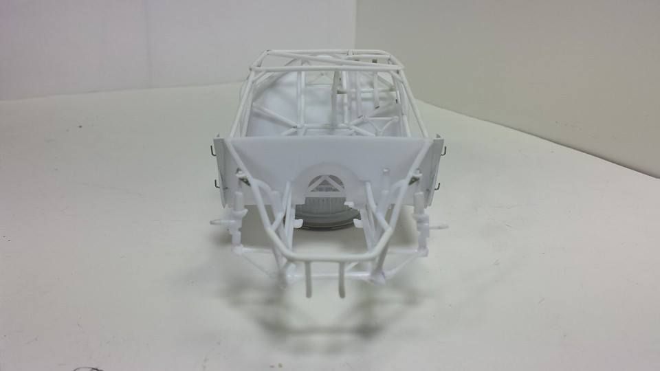

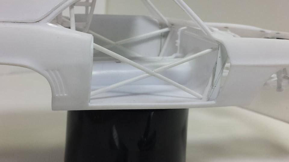

as you can see on this pic there is a gap at the bottom of the firewall where it comes back at an angle.. the area where the gaps is, is right where I need to mount my lower door hinge/staple...
10577067_4480193459869_33775030106650986

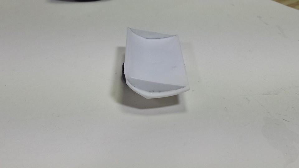

to fix this I cut some pieces of .020 styrene sheet and first added them to the sides of firewall,,, they were cut at an angle so that the firewall would be straight up and down and not angled..
10478945_4480192659849_50013783060116483
983734_4480192899855_318122526621406729_
Once this was done I then cut some more pieces of .020 styrene and added them to the top and also down at the bottom in front of the firewall to mount my hinges?staples...
here's a pic of one side with holes drilled and ready for the hinges...
10556311_4484946498692_55868484718632344

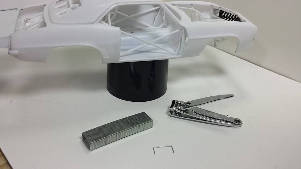

here's my tools I use for my hinges... Once I cut my staples to the size I need I insert them in the holes and apply some super glue to hold them in place..
10543637_4484946218685_74217318387790985

next I got to work on my door skins, but first I stuck the doors on and secured them with a little tape. Next I marked the inside of the doors with a pencil up against the sides that I've added so I'll have that to go by when making the door skins... the inner door skin will have to be as close to flush as possible to the pieces I've added so that the rod will attach to it ...
16015_4484946898702_1666472689418495546_
10452306_4484947858726_67225149204811202

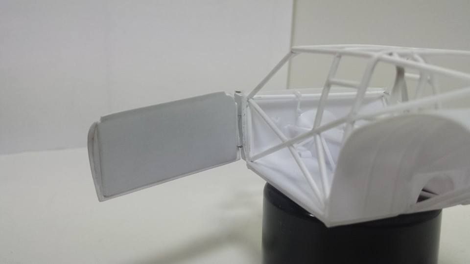

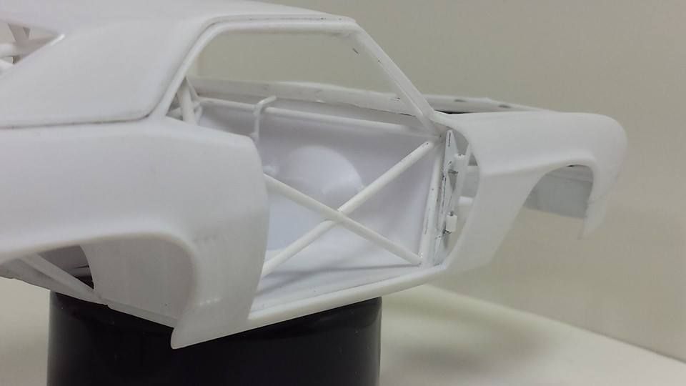

I take a small piece of .062 rod and drill a hole down the center of it just big enough to fit over the staple and turn... If the hole is too big the doors will sag when open.. I then trim them down to size and sit them on the hinges....
10483238_4484946018680_63020182740771549

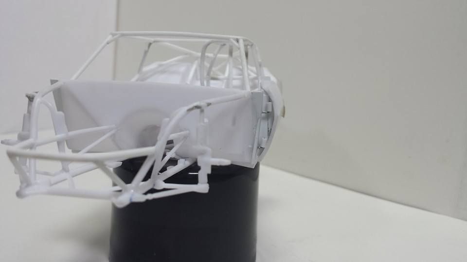

next I add a little glue to the rod where the door will mount and install the doors, and tape them down until the glue sets... after that I take them off and add some more stronger glue.. to hold them in place permanently...
here's a pic with the body off and just the door attached to give you and idea...
10446668_4484948058731_23161703186872164

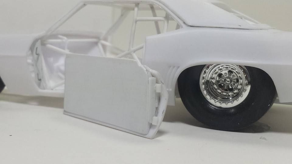

and that's really all there is to it... lol... the reason I stress the importance of the inner skin coming as close and snug up against them is because I kinda goofed on the first door and had to add some thin strips of styrene to shim it out so everything fit......
10468374_4484949338763_21039841539217750

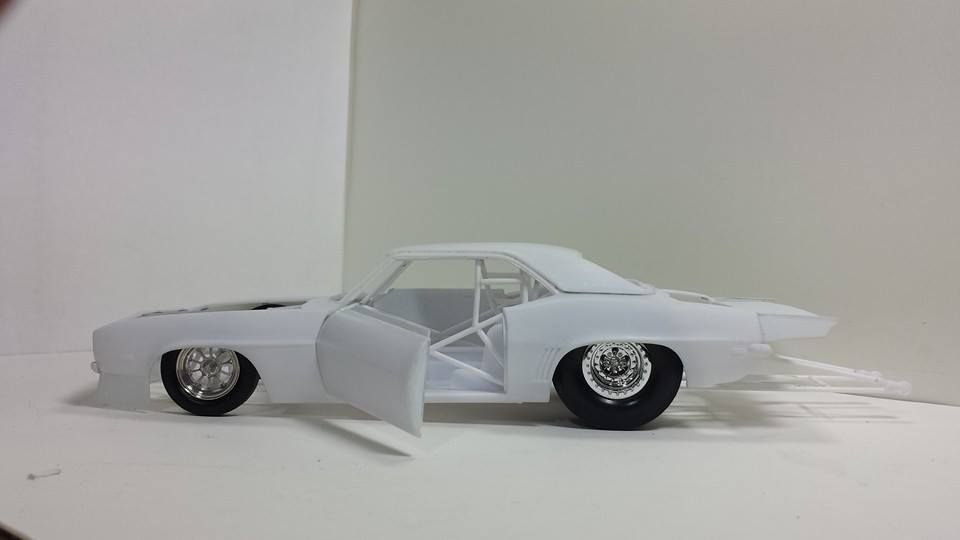

I'm pretty happy with how they turned out... I'll be using this technique from now on because it allows the door to open all the way up, and they are easier to put on and take off... thanks for looking and comments welcome...

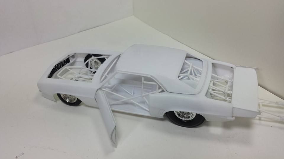

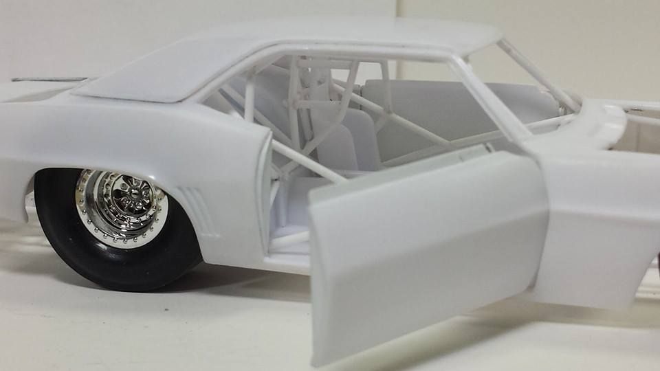

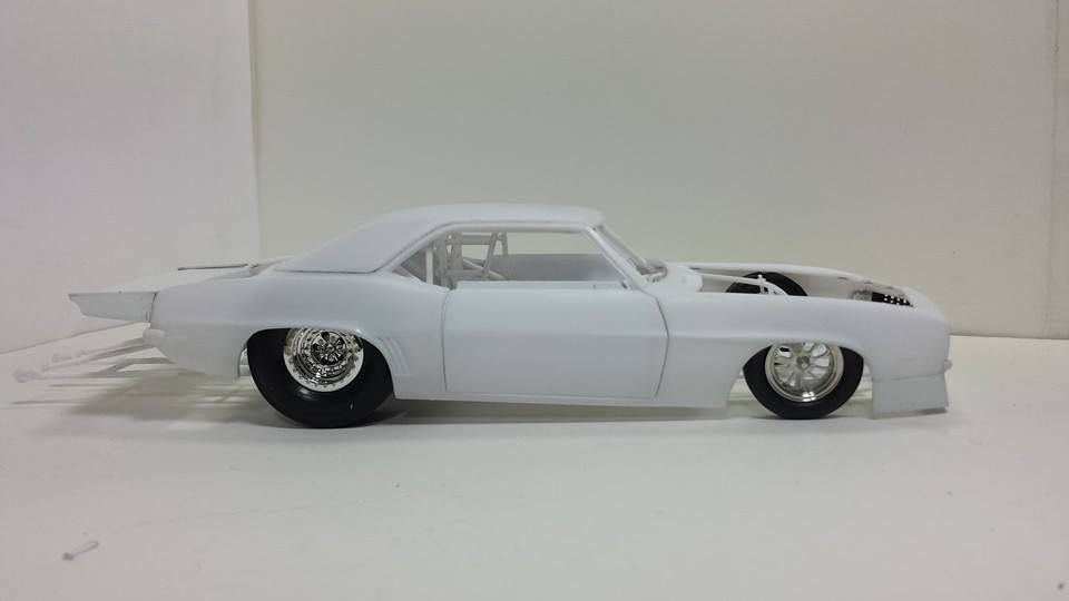

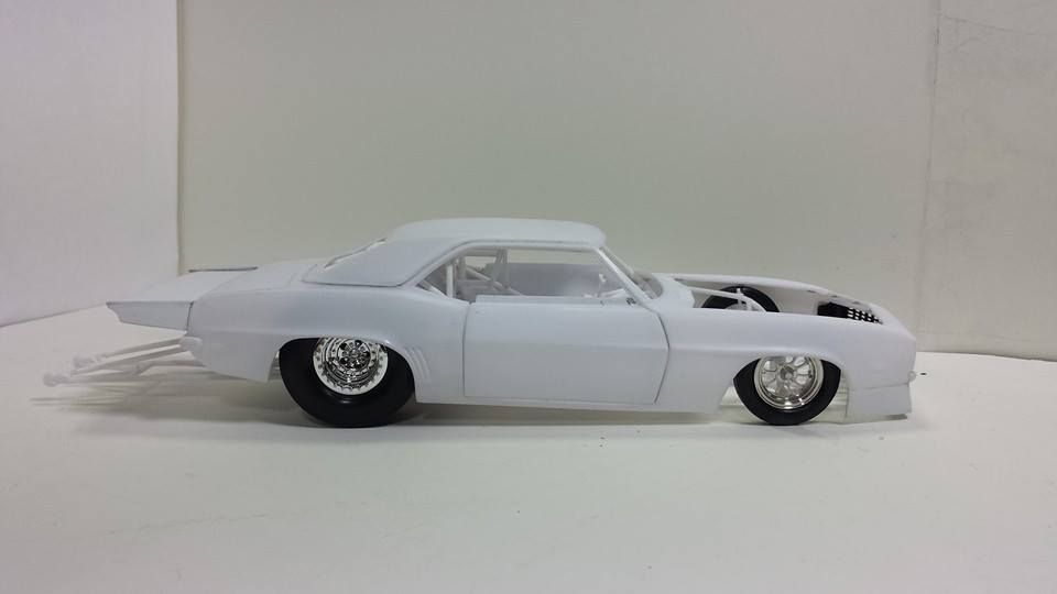

here's a few mock ups of them all finished...
10469728_4484945818675_66008104207749289
10382147_4484945578669_11498181004249432
10514665_4484945338663_12732842506786700
10568849_4484945178659_56603378464714419
10525883_4484945058656_36647200214948067

OK this is awesome. But I have a couple of questions.
I notice that the staples are angled; Not perfectly straight up and down. Any reason for that?
Also, how do you know how far the staples need stick out of the chassis?
I usually angle the top hinge back just a bit, on builds I do where the front end is not removable.... It makes it easier to take the doors off and pt them back on.... If the front end was removable they would be straight up like the bottom... as far as how far they need to stick out, that's trial and error test fit, trim, test fit again,, etc, etc... it's important that the holes you drill are just big enough for the staple to slide in with a little resistance.. that way they will stay in place while checking all this... It takes a little practice... but it's not that hard...

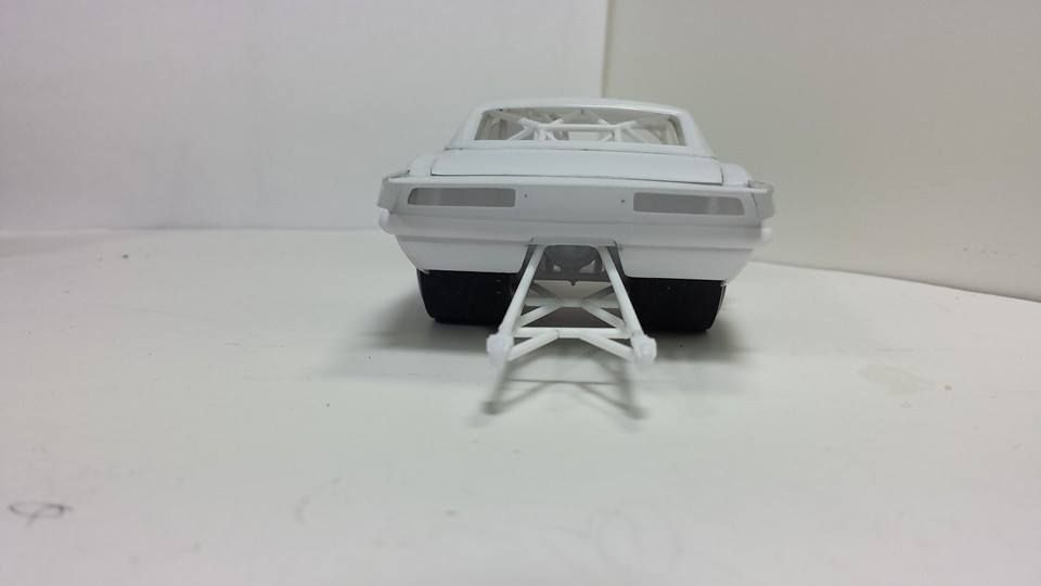

Well the chassis is all done and ready for paint... I got the trunk floor finished up, I added dzus brackets for my electronics board, I made a mount on steering column for racepak, and I finished up bracing for fuel cell mount... thanks for looking ad comments welcome....
