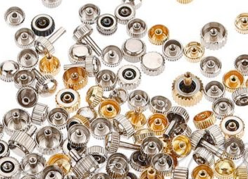

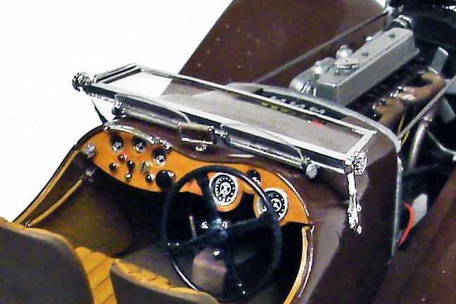

Speaking of dashboards, not too long ago I got a mixed bag of old watch crowns in different styles and sizes from eBay. Knobs, buttons, switches, caps, etc, for vintage cars in larger scales.

Dash is superb, Harry

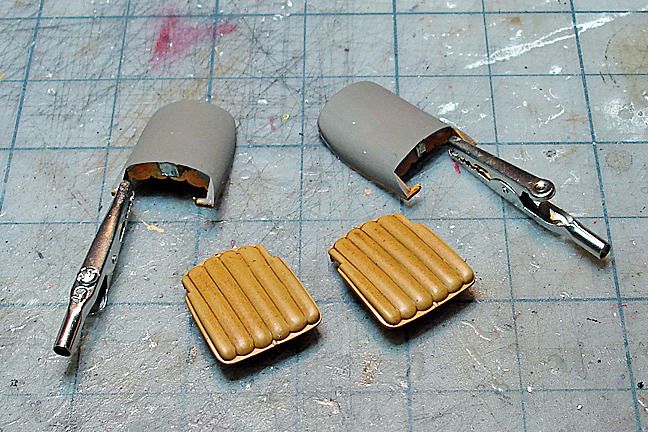

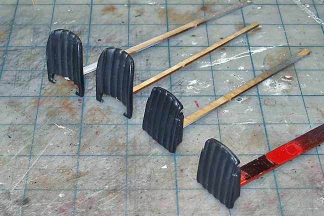

First step of the seats is cleaning up the parts... there was some flash on both the bottom cushions and seatbacks, and on the pivot pins (the seatbacks fold forward). Once I had the seat parts cleaned up, I scrubbed them with fine steel wool to break the surface gloss of the plastic and give the acrylic paint I will be using something to grab onto. Then I used a drop of CA in spots where it won't be visible on the finished seats and glued the pieces to some pieces of scrap wood "handles."
The seats were then painted with acrylic craft paint (color: Ocher), and when dry I dipped the painted parts into wood stain. The stain actually gets absorbed by the porous acrylic paint and gives me a nice "leather" look. I painted the back sides of the seatbacks the same color as what I used for the interior "carpet." The final step was a coat of matte acrylic spray to knock down the shine a notch. The seats were then installed:

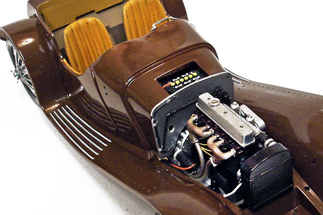

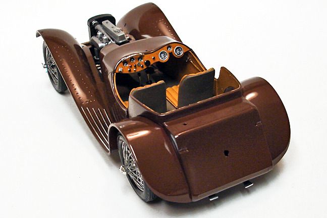

Ok, here is the point where any Jaguar purists out there may want to cover your eyes. Or at least sit down... :lol: ... because I am about to reveal the fact that I'm painting this Jaguar brown.
Yep. Brown.
I know, I know... a brown Jaguar? Blasphemy!!!

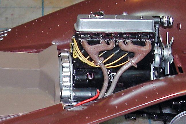

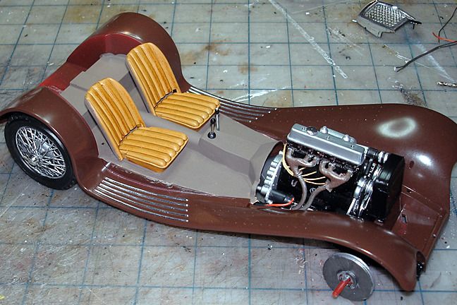

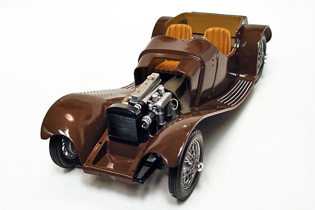

But I wanted to try something different, not the expected BRG or red. So I got a can of Krylon "Short Cuts"... the color is "Expresso," which is a nice, rich chocolatey brown. In the next photo you can see the seats installed, and the engine finished and installed. At this point, there is no clear coat on the body color yet:
Link to comment

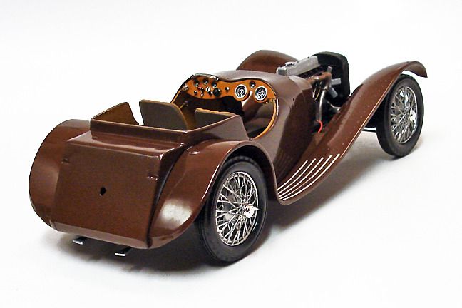

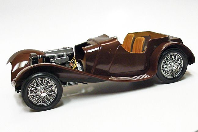

And here is where it stands as of right now. The body is installed, and there is one coat of Future on the bodywork so far. I'll probably add a second coat. The ribs on the running boards are BMF. On the real car, there are smaller, thiner strips of rubber inset into each chrome strip, but at this scale there's no feasible way to create that detail. I thought about slicing some very narrow strips of electrical tape and trying to do them that way. Maybe I'll still give that a try and see how it looks. Once I got some clear on that brown body, I was a lot happier with the look. It's definitely not a "normal" Jaguar color! :lol:
Link to comment
Very sharp looking, I like it a lot!
The leather of the seats, the wood on the dash and the brown body all go together very well
I like the spokes on the wheels as well, you handled that nicely
What are you thinking about steering wheels wise???
Edited by Twokidsnosleep
Link to comment
Maybe a "wooden" rim, maybe the factory black wheel. Not sure yet.
Link to comment

For those who know me and think I'm having a heart attack over Harry's non-standard choices, I'll just say the following... The factory offered the ability for buyers to specify any color scheme they wanted outside of the catalog. This included body, interior, and canvas, as well as any color piping for upholstery and canvas. Brown was a popular color for high-end cars of the period, including Rolls and Mercedes SSK fenders.
Personally, I like the very Spartan approach of the SS100 factory cars. This means I'm not too thrilled by the wood dash (metal with body color) and the shiny wire wheels (usually silver, body color, black or red), but you'll find these aftermarket touches on restored cars, along with (yuk) engine-turned dash boards. But only one or two cars with black replacement gauge faces to augment the standard white gauges.
This is still a typically jaw-dropping Harry build.

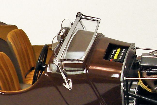

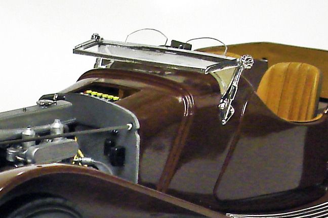

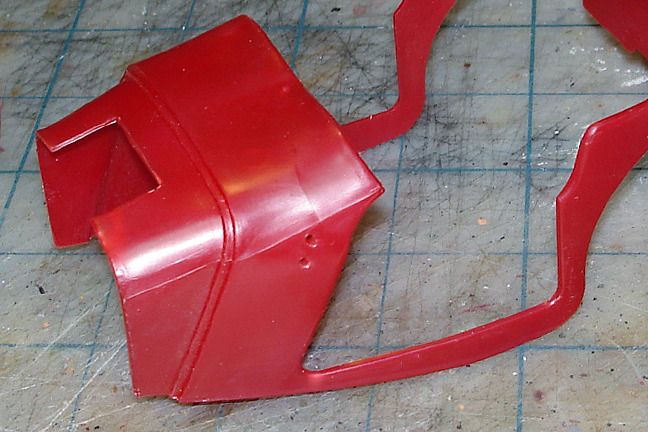

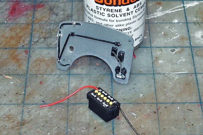

The real car has a folding windshield, and small secondary "wind wings" behind the main windshield. My guess is that when the windshield was folded down, the top speed was increased due to reduced wind resistance. :D
Here is the kit piece, the top part that folds down molded as one piece with the lower piece that attaches to the cowl. Notice the lame "windshield wipers"... :rolleyes:
I want to build this car with the main windshield in the folded down position, so step one is to carefully cut the upper and lower windshield parts apart with a razor saw:

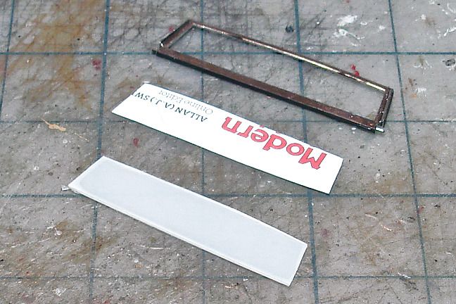

All of the clear parts were missing from this kit (a small detail the ebay seller conveniently "forgot" to mention... :rolleyes: )... so I had to make a windshield. I used an old business card to cut out a paper template, then transferred that to a sheet of Lexan to create my new windshield:
More to come...

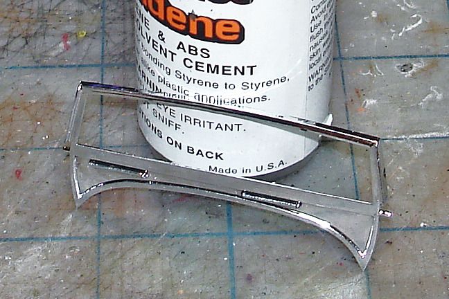

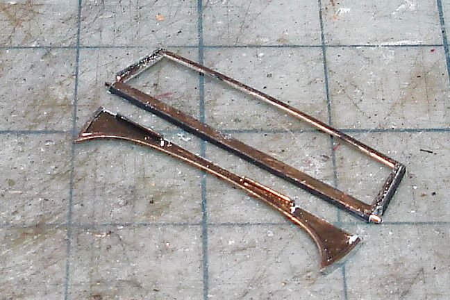

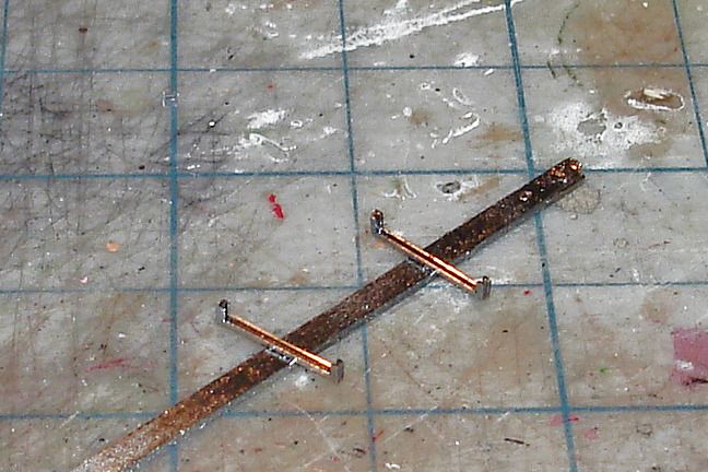

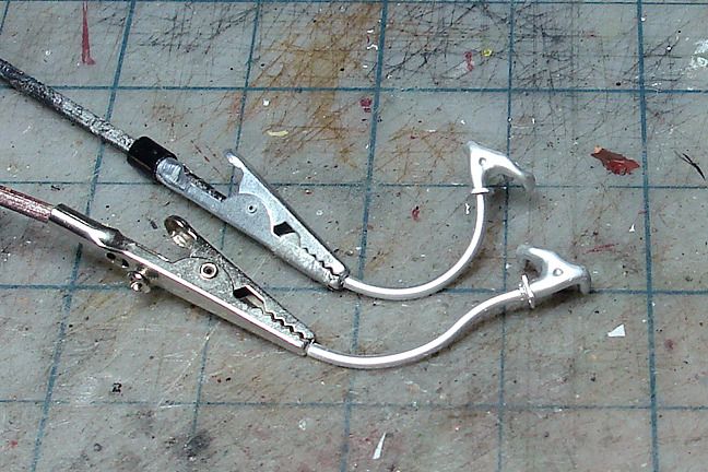

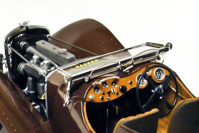

The small auxiliary windscreens mount to the lower part of the windshield (the part that attaches to the cowl and doesn't fold down). The exact configuration of the way the small screens are mounted to the windshield base varied... I looked at my photo references and created a "generic" arrangement. First thing I had to do was create the frames that the "glass" would sit in, I used Plastruct U channel, "chromed" with Spaz Stix:
