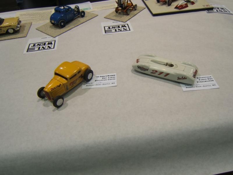

Thanks so much to all of you for all the very kind comments. I think I'll set this project aside for a bit while I ponder how to make the inner bulkheads and body supports. This will be my first full envelope body where I've had to create the internal structure from scratch. It's a whole different deal than building a chassis for an open-wheeled hot rod!
In the meantime, here's proof she actually made it to Santa Clara:
