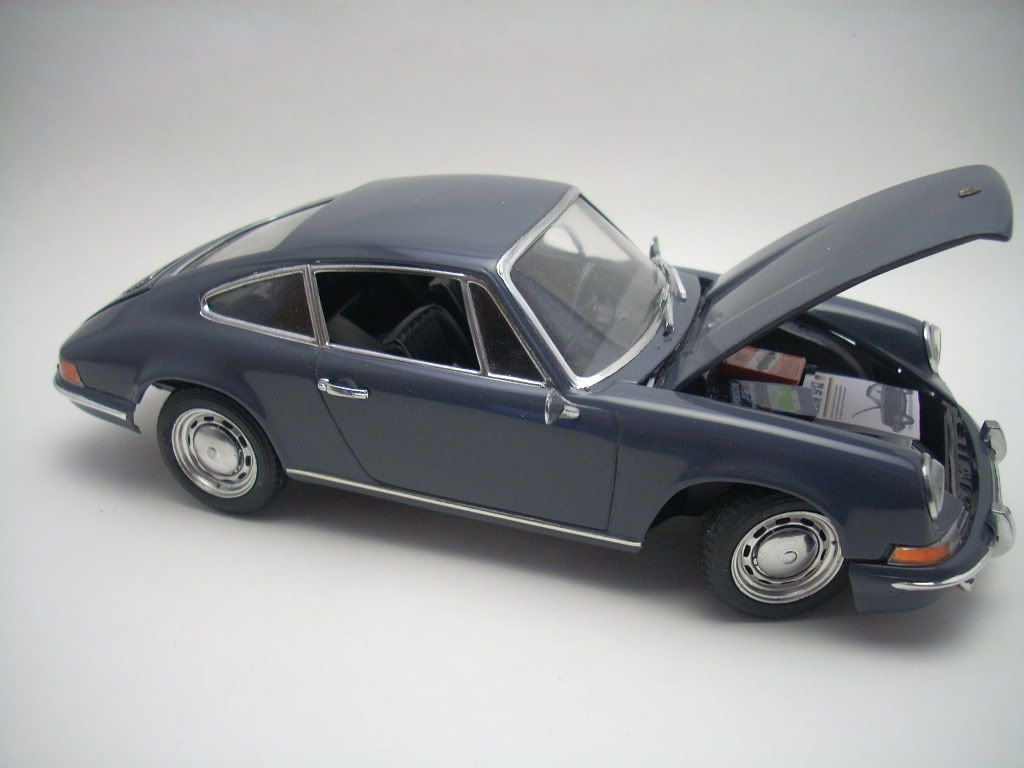

Chillyb1 Posted August 20, 2014 Share Posted August 20, 2014 Roger makes good points but overstates the pitfalls of using Alclad in this particular application. But the biggest problem in either case is masking and trimming: If you can't do these things well, then you will arrive at unsatisfactory results. These are done with Alclad: Quote Link to comment Share on other sites More sharing options...
unclescott58 Posted August 21, 2014 Share Posted August 21, 2014 Curtis, where is the Porsche 911 kit above from. Who makes it? And what scale? There are very few Porsche 911 model kit with the pre 1974 small bumper set up. Scott Quote Link to comment Share on other sites More sharing options...
Chillyb1 Posted August 22, 2014 Share Posted August 22, 2014 Curtis, where is the Porsche 911 kit above from. Who makes it? And what scale? There are very few Porsche 911 model kit with the pre 1974 small bumper set up. Scott Scott, that Porsche is the Fujimi Enthusiast kit in 1/24 scale. I think it is supposed to be a 1967. Quote Link to comment Share on other sites More sharing options...
