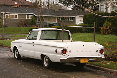

southpier Posted August 22, 2014 Share Posted August 22, 2014 I understand there's no stake pockets most likely owing to that the vehicle wasn't designed to carry any appreciable weight, but in our perfect model world how could a rack be mounted to the bed? (google di'n't help) if it would be 1960 era construction, all the better Quote Link to comment Share on other sites More sharing options...
Ace-Garageguy Posted August 22, 2014 Share Posted August 22, 2014 (edited) Whatcha wantin' to haul? Ladders? Pipe? A rack like this, but with longer legs inside the bed-sides, with flat, 4-bolt flanges welded to the bottoms, through-bolted to the bed-floor with matching 4-bolt doubler-plates underneath ought to do it. Same way bolt-in roll-bars are mounted in race-cars. Probably the way this one was done, but most likely with brackets through-bolted to the bed-sides as well, to keep it upright. Then you could just use a conventional roof-rack over the cab. Edited August 22, 2014 by Ace-Garageguy Quote Link to comment Share on other sites More sharing options...
southpier Posted August 23, 2014 Author Share Posted August 23, 2014 I like the middle picture. i'll cobble up something; thanks. Quote Link to comment Share on other sites More sharing options...
oldnslow Posted August 23, 2014 Share Posted August 23, 2014 How about some stake pockets bolted to the insides of the bed, then you could use wood side rails. Quote Link to comment Share on other sites More sharing options...
southpier Posted August 23, 2014 Author Share Posted August 23, 2014 that's what one of the HAMBers suggested. I've just never seen it done (well) and whatever the end result I don't want it to look out of its era, or a caricature. one of the cars with which I learned to drive, although not a pickup. nor a V8, but I'm overlooking little details .... Quote Link to comment Share on other sites More sharing options...
