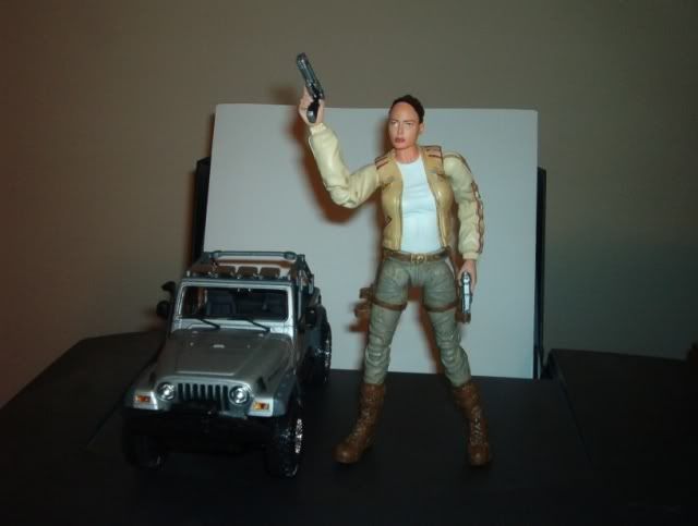

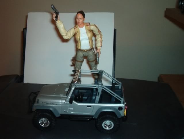

Here's my Tomb Raider Rubicon by Revell. Yeah, the body's a diecast but that didn't really matter to me.
I love Wranglers although I don't normally build off-road vehicles. This was my first attempt at any serious weathering on a model.
