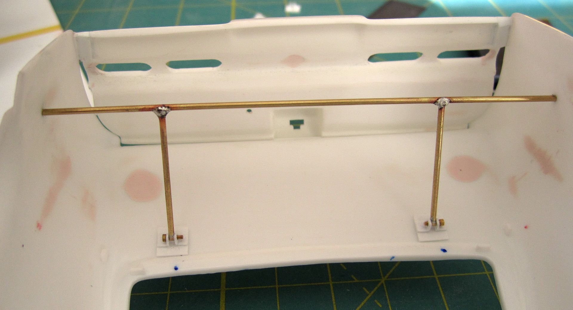

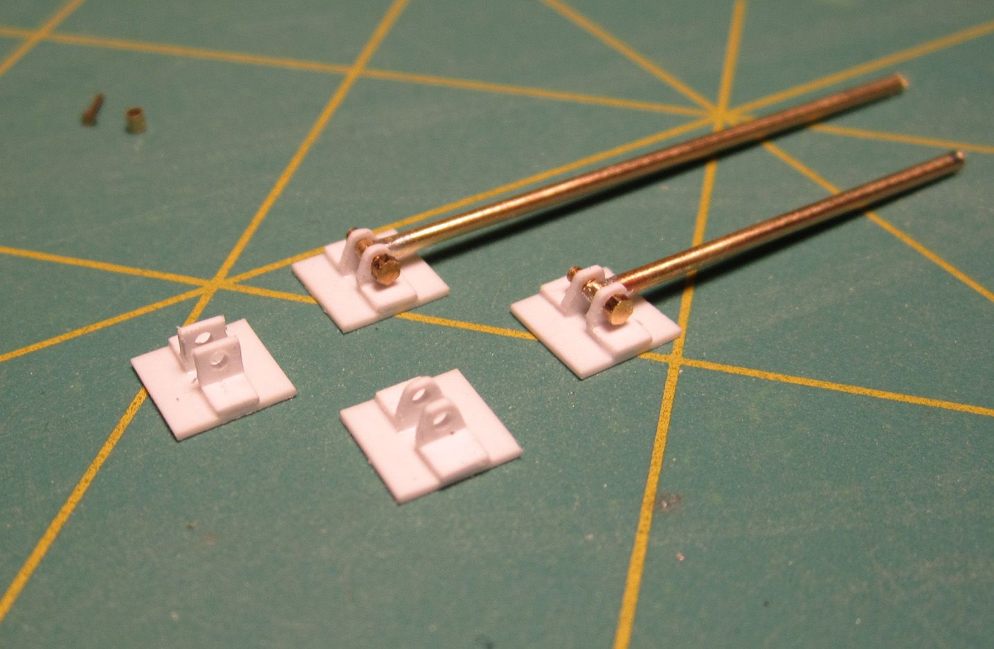

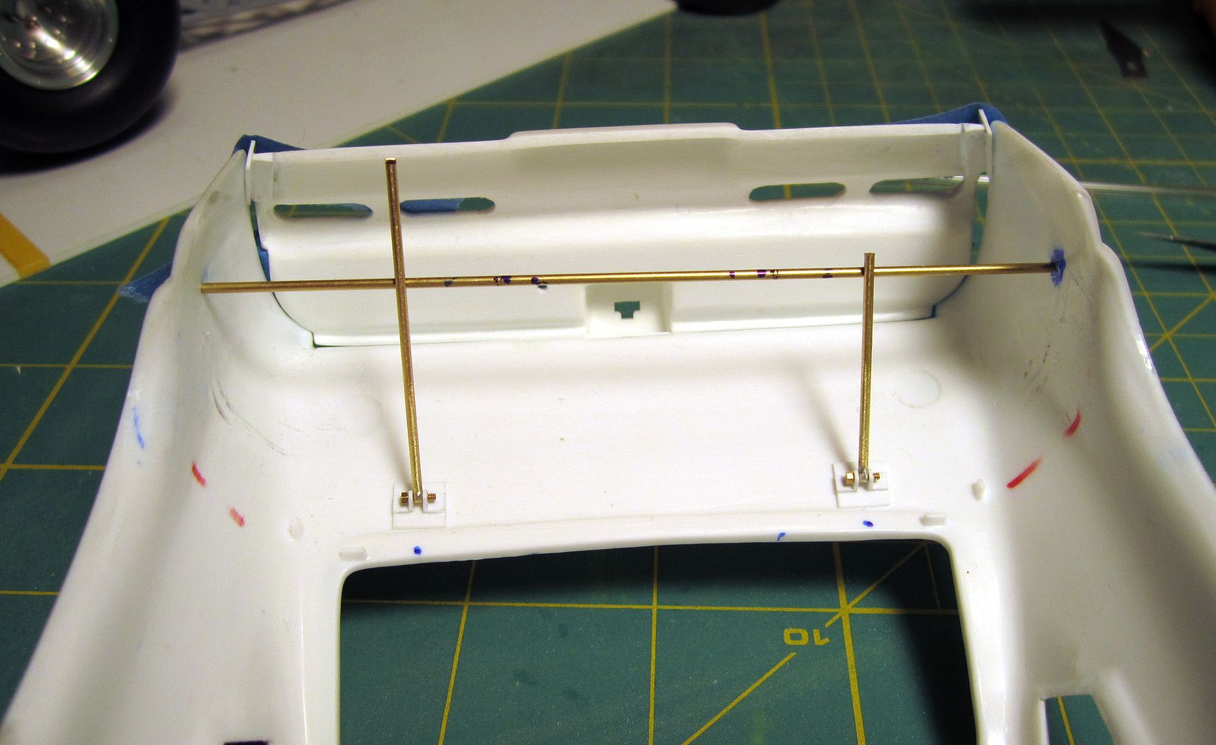

Mooneyzs Posted March 11, 2013 Author Share Posted March 11, 2013 Arron.... Thanks bud. I have been thinking about how I was gonna do this for a little while and what I have come up with I think will work pretty good. I didn't get it all done tonight but on my way there. Alyn... Thank you for the kind words and glad you are enjoying the build up of this. Greg.... How's my favorite Aussie Mate doing?? Its great to see you back here. Thank you for the kind words. I still have a ways to go but I am making some good progress that I have been happy about. Ok Fellas.... Little more work done today. I was really hoping to have finished the body support for the rear but I didn't quite get there. I wanted to share a couple of pics to show a little of what was done. Here is the Body Mount Pads and the start of some of the support Tube/Rod, I still have to shape one of them as well as make two more of these for the main rod that you see in the pic bellow: Here I was trying to locate some of the supports. I still have two more that will mount to the rear of the body: Quote Link to comment Share on other sites More sharing options...

Mooneyzs Posted March 25, 2013 Author Share Posted March 25, 2013 Dave... i think it would be a pain to do in 1/24th but it could be done. Its a little easier in 1/16th . Little more room to work with lol. The body just pivots on the brackets on the chassis with the tubing. Alyn...thank you. I am hoping to possibly work some more on these tonight and this week. I will have to take some better pics of the rod since i soldered a piece of tube on the end for the bolt to go thru. I am currently tryng to figure out how i will be able to solder the rods at the correct angle i need them to be in the installed position.. but i have an idea i hope works Quote Link to comment Share on other sites More sharing options...

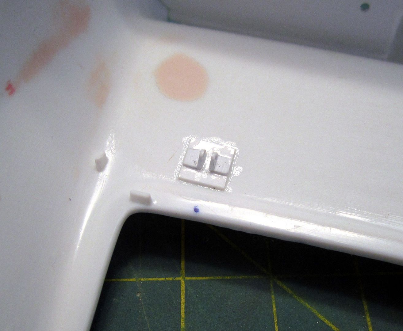

Mooneyzs Posted March 30, 2013 Author Share Posted March 30, 2013 Hey Fellas.... I know this update has been way over due. I haven't been able to get to the bench much in that past few weeks. And I sure have missed working on this project and I actually was able to get a little time yesterday to work on this. I have got a little more work done on the rear body bracing. I was able to get a few of the pieces soldered together as well as getting the mounting point glued in. I now need to work on getting the rear body panel glued in so that I can finish the other two mounts that will go to the back body panel. I am hoping to get it done today or tomorrow. Anyway here are a few pics, they aren't the best pics but just a couple to show the progress. I still need to sand and file the solder joints down. Thanks for looking Here is what I have done on it so far. Got the two support mounts soldered to the main brace. I still need to make the two that mount to the back body panel and then I need to make the mounting pads for the sides: Here is an up close shot of one of the braces. Solder joint is a little bulky but will get sanded and filed down: Here is a close up of the body mount pad glued in place. yesterday when I was working on this I said what the heck and just glued it in lol. Now I need to do that to the back panel...lol Quote Link to comment Share on other sites More sharing options...
