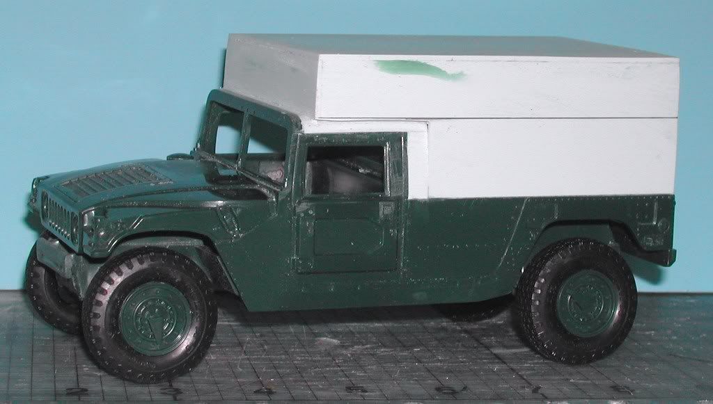

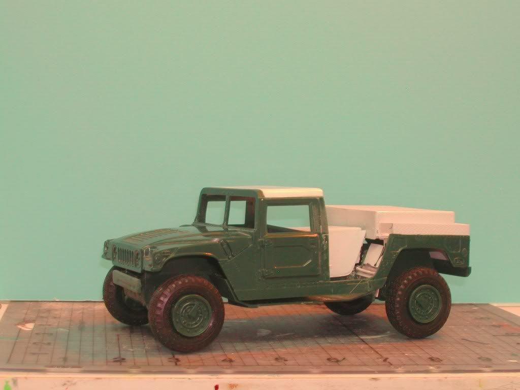

I began with the Revellogram Jurassic Park Hummer Snagger Snap kit.
The kit itself is very basic, but does build into a nice kit if you're willing to add some extra detail. The dark green plastic is the base kit, while all the white is Evergreen sheet and strip. These are two different examples of other body styles built with this kit

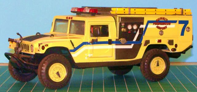

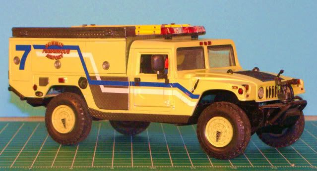

Back to the drawing board... This is what I finally came up with and was pretty pleased.

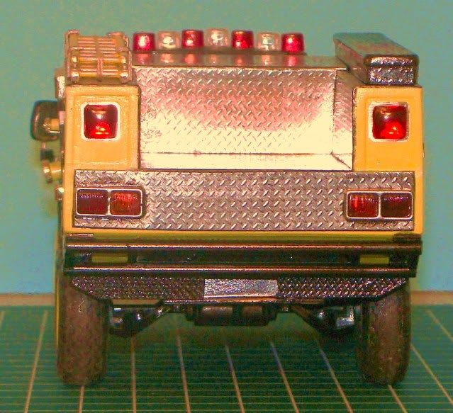

Again, I had no idea what the rear of the truck looked like, again, "artistic license" was taken.

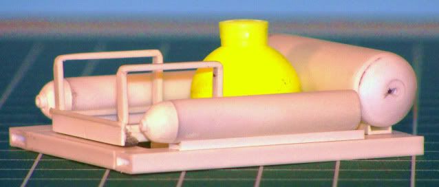

The apparatus was proudly displayed for several years. After working with a gentleman from Crash Rescue Services Incorporated (CRSI) on another project, I found a dual agent system that they manufactured for this type of application.
Basic construction began, but was stalled by a major move and lack of a detailed hose reel. Just prior to the move, the rig received a new paint job.

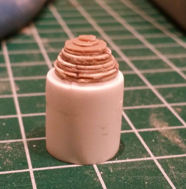

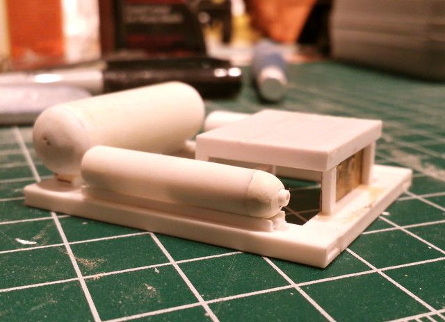

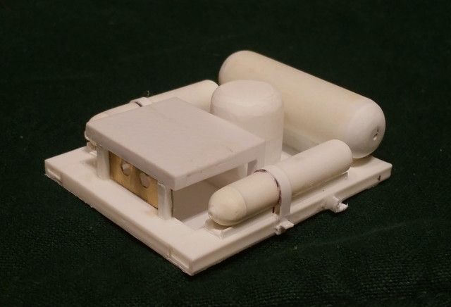

I committed to gluing items in place and fabricated a vertical tank for behind the hose reel pedestal.
Repeated puttying and shaping resulted in the configuration shown.

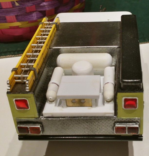

Here is a view of it placed in the rear of the truck.
