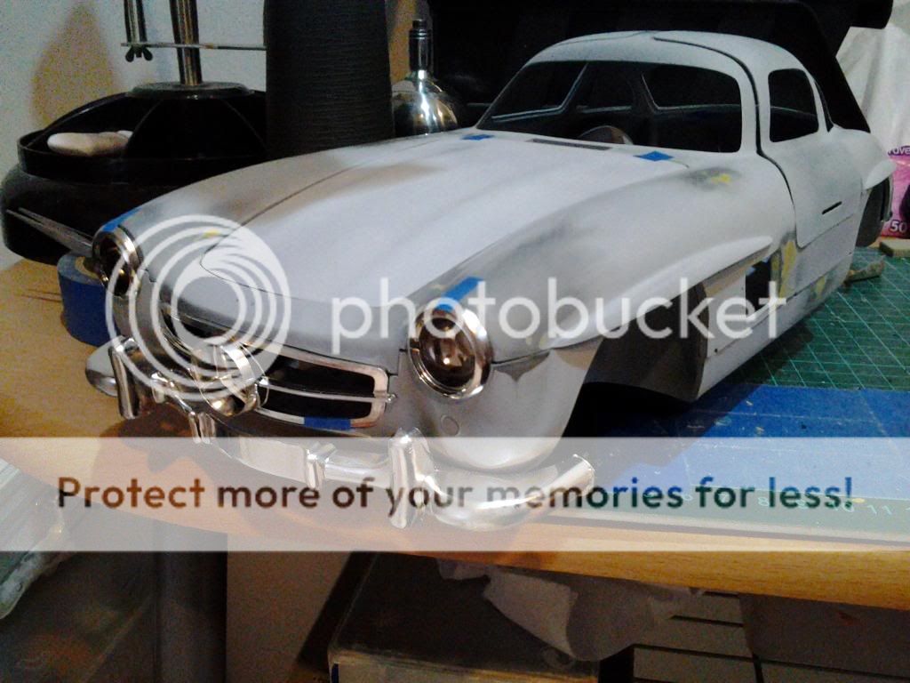

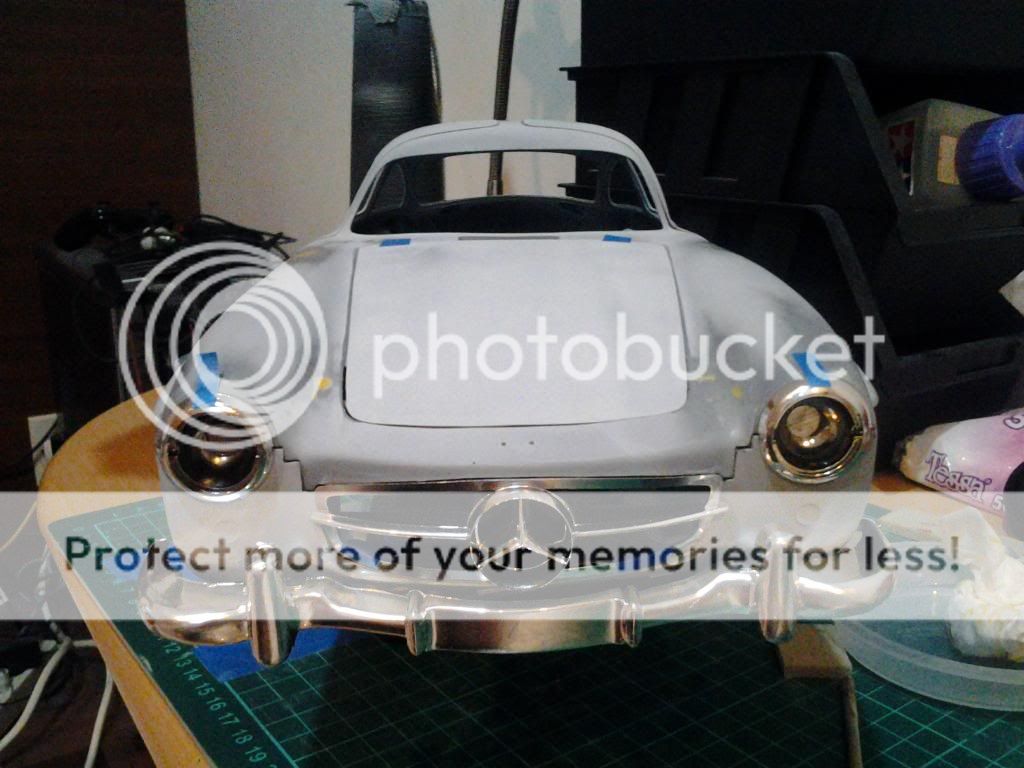

Cien1986 Posted May 15, 2014 Author Share Posted May 15, 2014 I try to dry fit the bumper to make sure that nothing goes wrong and fit well... Quote Link to comment Share on other sites More sharing options...

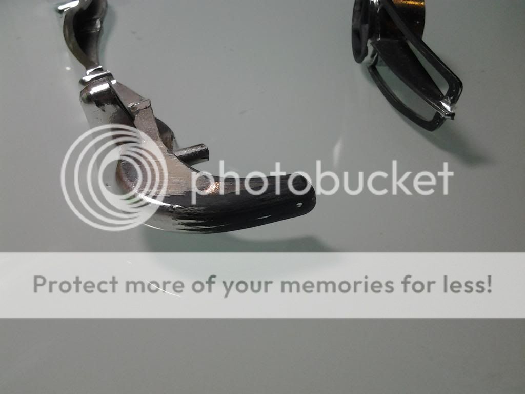

sjordan2 Posted May 15, 2014 Share Posted May 15, 2014 (edited) 1. The main thing wrong with the grille is that the nose star (grille barrel) sticks out way too far. You can try to cut out the barrel and move it backward. 2. As to the way the windshield and all chrome fits for the glass (mounted from the inside of the body), remember that the real car has very prominent black seals around all the window chrome, so you could just put a piece of black wire around the outer edges, which would fill it in and be accurate. By the way, the shape of the cut-out on the door window is good, but the window chrome part is not –– like the windshield and back glass, it is too small for the car and makes it look bad. It would be good if you could find a way to keep the door window openings the way they are, and create chrome that fits on the outside of the door windows, instead of the kit's chrome that is fitted from the inside. You could cut out the proper trim shape from a styrene sheet, paint it with Alclad, and place it on top of the door. Edited May 15, 2014 by sjordan2 Quote Link to comment Share on other sites More sharing options...
Cien1986 Posted May 16, 2014 Author Share Posted May 16, 2014 Since you mentioned maybe going with a two-tone paint job (or maybe some other custom touches?), here are a couple of ideas for you to consider. Many thanks for the references... Quote Link to comment Share on other sites More sharing options...
Cien1986 Posted May 16, 2014 Author Share Posted May 16, 2014 1. The main thing wrong with the grille is that the nose star (grille barrel) sticks out way too far. You can try to cut out the barrel and move it backward. 2. As to the way the windshield and all chrome fits for the glass (mounted from the inside of the body), remember that the real car has very prominent black seals around all the window chrome, so you could just put a piece of black wire around the outer edges, which would fill it in and be accurate. By the way, the shape of the cut-out on the door window is good, but the window chrome part is not –– like the windshield and back glass, it is too small for the car and makes it look bad. It would be good if you could find a way to keep the door window openings the way they are, and create chrome that fits on the outside of the door windows, instead of the kit's chrome that is fitted from the inside. You could cut out the proper trim shape from a styrene sheet, paint it with Alclad, and place it on top of the door. 1. totally agree with that... no wonder it looks strange.... i will definitely fix that.... just afraid of destroying the star... 2. yeah the chrome part is so lame... remaking it totally make sense... cutting styrene to form the window and windshield grill will be really challenging task... what do you think if bending the brass line to form the shape then a bit soldering work to eliminate the connecting part then paint it with alclad? will it work? instead of cutting the styrene.... Quote Link to comment Share on other sites More sharing options...
Cien1986 Posted May 16, 2014 Author Share Posted May 16, 2014 Legendary car and kit ! Definitely following your progress. Good luck with this beauty Very nice.. good bodywork!! thanks for viewing and comments... Quote Link to comment Share on other sites More sharing options...
blunc Posted May 16, 2014 Share Posted May 16, 2014 the edges of the grille seem too thick also, and the cross bar is not shaped like 1:1. you could try to get another grille and possibly make a proper looking grille from parts of two. Quote Link to comment Share on other sites More sharing options...
Danno Posted May 16, 2014 Share Posted May 16, 2014 Great observations. Modifying the grille and the window frames will go a long way toward making the model look better! Thanks for the tips. Quote Link to comment Share on other sites More sharing options...
sjordan2 Posted May 16, 2014 Share Posted May 16, 2014 (edited) I assume you're still going to fill in the gaps of the body seams. I think the grille would be helped by sanding the inside of the outer frame to 1/2 or 1/3 its existing width. Unfortunately, there is no inner lip around the inside of the frame to help with proper mounting of diagonal grille mesh behind it. Perhaps something can be done with L-shaped channel. Note the following: If you create new window trim, using body openings for a template, you will also have to create new window glass from clear styrene, since the kit glass has recesses for the chrome to fit into and will be visible. In other words, everything involving the windows - chrome and glass - will have to fit on top of the body plastic. Edited May 16, 2014 by sjordan2 Quote Link to comment Share on other sites More sharing options...
sjordan2 Posted May 16, 2014 Share Posted May 16, 2014 Another solution for the small door windows is this: The door windows on the 1:1 pop out and can be stored in a vinyl sleeve; The vent windows will remain. So, just cut off the trim and glass from the kit part and leave the vent windows. Quote Link to comment Share on other sites More sharing options...
Cien1986 Posted May 17, 2014 Author Share Posted May 17, 2014 I assume you're still going to fill in the gaps of the body seams. I think the grille would be helped by sanding the inside of the outer frame to 1/2 or 1/3 its existing width. Unfortunately, there is no inner lip around the inside of the frame to help with proper mounting of diagonal grille mesh behind it. Perhaps something can be done with L-shaped channel. Note the following: If you create new window trim, using body openings for a template, you will also have to create new window glass from clear styrene, since the kit glass has recesses for the chrome to fit into and will be visible. In other words, everything involving the windows - chrome and glass - will have to fit on top of the body plastic. Now you said it... i just realize i must create new clear windshield..., i think i will stay on stok... i found the chrome part on my kits on the rear windshield and the door window formed quite well.. so i will stick to the stock part... Quote Link to comment Share on other sites More sharing options...

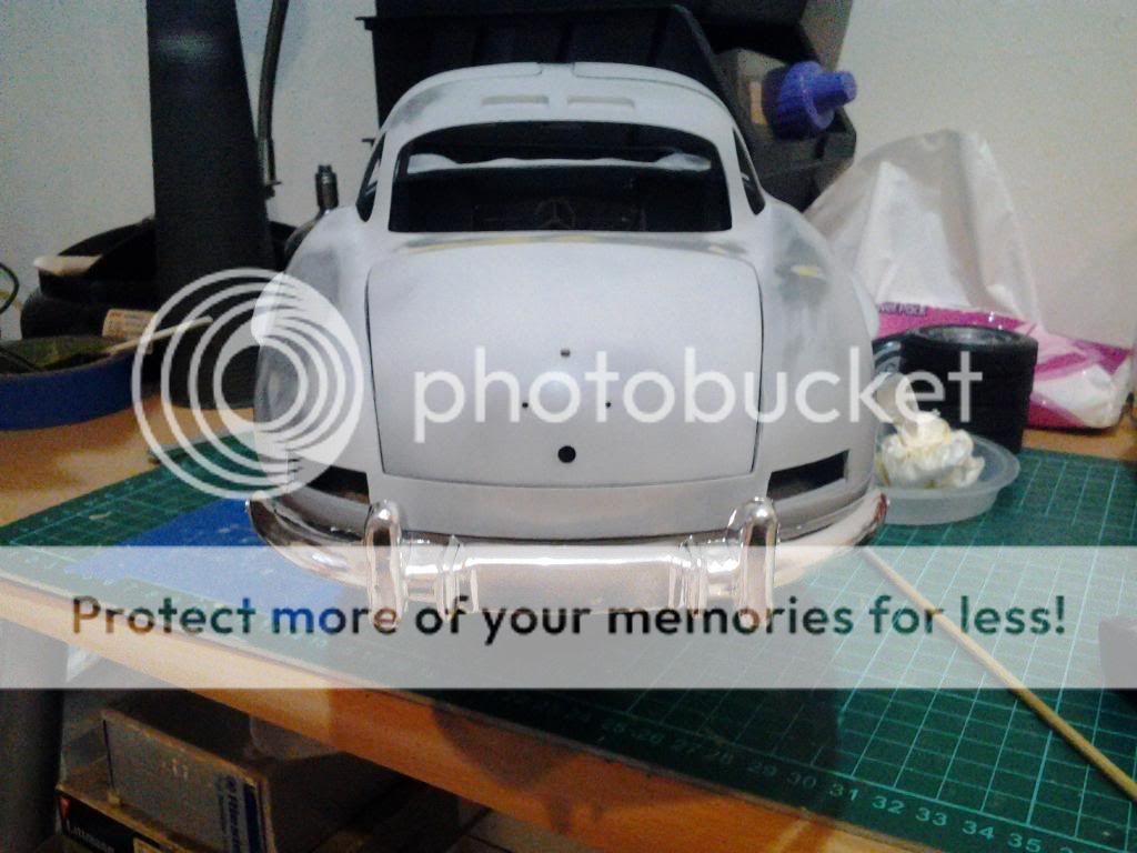

Cien1986 Posted May 25, 2014 Author Share Posted May 25, 2014 (edited) How is it going Henry, any good progress made ? Yeah still going for sure... its a bit delay because my wife just giving birth to my first baby... god bless us.... all things goes smoothly.... today i make some progress on sanding the front bumper and trimming the front grill i make some sanding on the bumper... to remove excess plastic Edited May 25, 2014 by Cien1986 Quote Link to comment Share on other sites More sharing options...

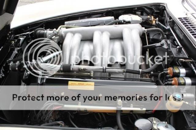

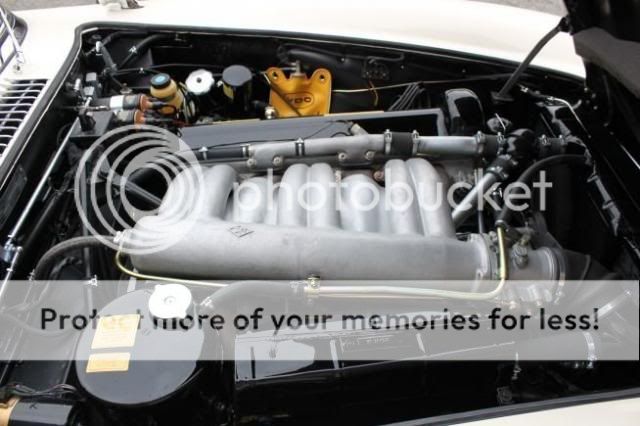

Cien1986 Posted May 25, 2014 Author Share Posted May 25, 2014 Skip many thanks for your information and explanation earlier i really appreciate it... here is some engine detail for references who need it.... this is what Skip said earlier the water tank reservoir position is just behind the air box the pic below shows what is missing on the kit..... the air filter..... Quote Link to comment Share on other sites More sharing options...
sjordan2 Posted May 25, 2014 Share Posted May 25, 2014 While there are minor differences, your pictures are from the 300 SL Roadster and not the Gullwing. The difference can be seen in the two coils at the right side of the firewall -- not part of the Gullwing, which only had one coil on the firewall, pointing outward. 1. You will note in your first picture that there is a line going from the water tank, connected by a metal tube, going directly into the radiator. 2. Toward the top of the picture, there is a water hose coming from the firewall that connects to the radiator, and is joined by a hose from under the intake manifold. Quote Link to comment Share on other sites More sharing options...

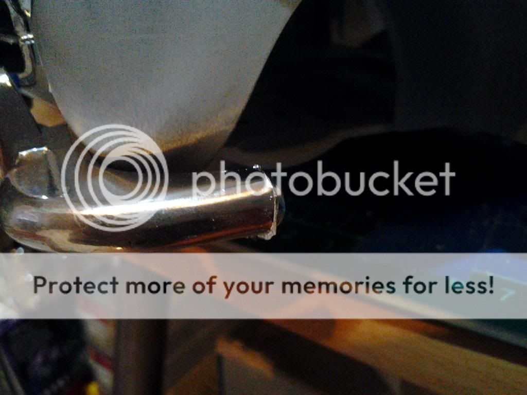

Cien1986 Posted May 26, 2014 Author Share Posted May 26, 2014 For the water tank i think its impossible to move it... it will not fit unless i modify the intake position... the intake pipe is just to long... so it will need to be cut down and the intake body need to be tilt abit. To provide room for water tank.... Quote Link to comment Share on other sites More sharing options...
Cien1986 Posted May 26, 2014 Author Share Posted May 26, 2014 To cover the seam line is big problem... It will be easy build if i dont cover the panel line and the gap between the front light... but the result will be rough... Quote Link to comment Share on other sites More sharing options...

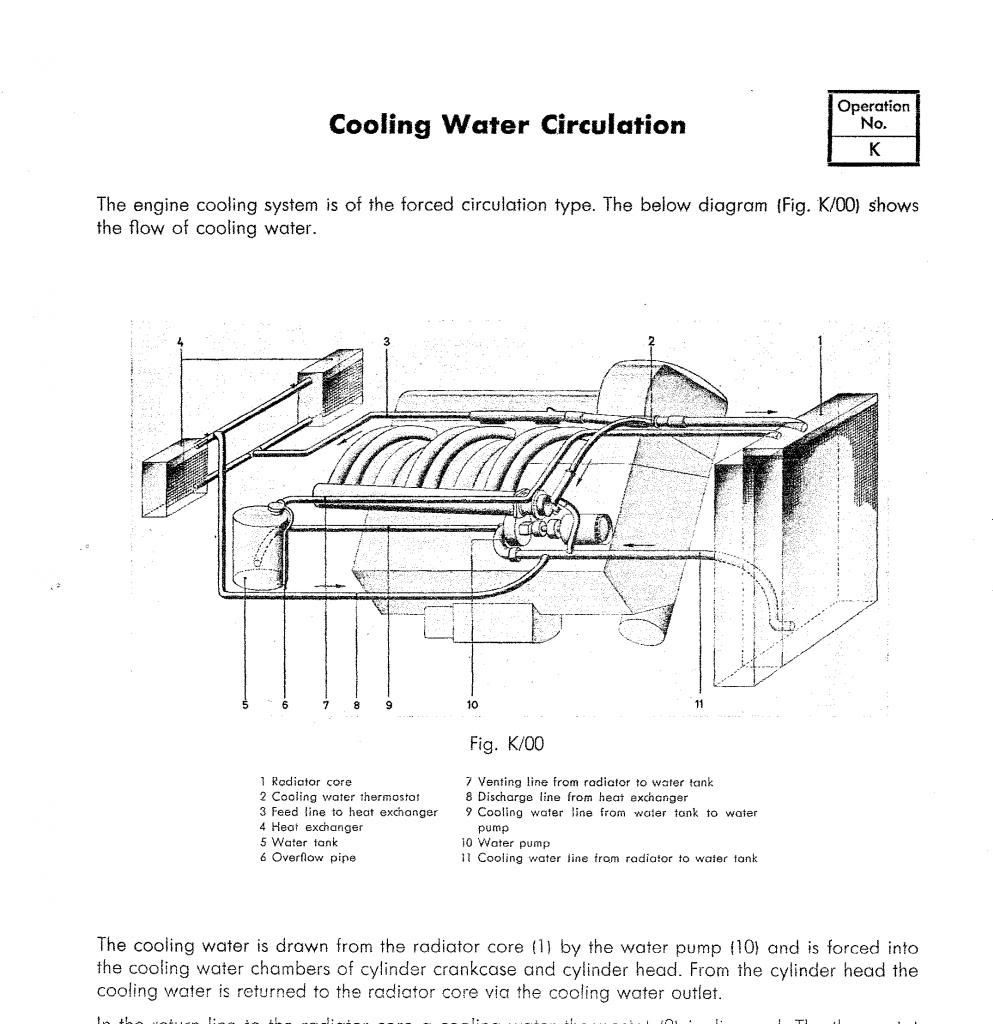

sjordan2 Posted May 27, 2014 Share Posted May 27, 2014 (edited) Apparently, there are a number of reasons why you can't fit the water tank in the proper position -- the kit's upper firewall comes way too far forward at an angle; it should be vertical and further back, and the same goes for the interior floorboard/bulkhead beneath it. If you can't make a smaller water tank that will fit, it would be better to leave it out completely instead of mounting it the way the kit shows it. Or you might be able to adjust the position or length of the intake silencer. I think they must have mounted the tank on the oil cooler section of the radiator structure because part of its function is to cool the oil, but I've never seen such a thing on a 1:1. As mentioned, the tank should feed the cooler with a tube running from the proper position. If you look at your engine pictures above, one of the easier things you can build is the radiator hose, which isn't in the kit. It goes directly from the radiator to inside the firewall, where it connects to a heat exchanger that can't be seen. Edited May 27, 2014 by sjordan2 Quote Link to comment Share on other sites More sharing options...
Cien1986 Posted May 28, 2014 Author Share Posted May 28, 2014 Wow this diagram explain it all... very detail... thanks for the help Quote Link to comment Share on other sites More sharing options...
