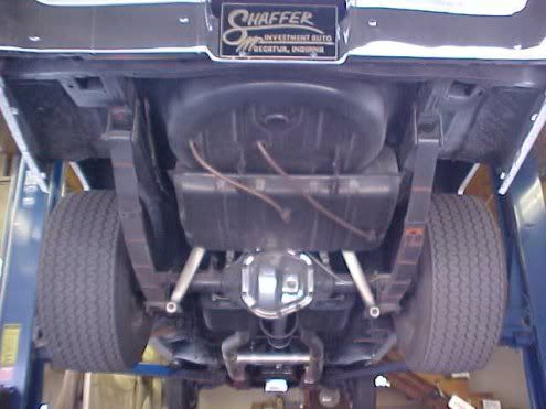

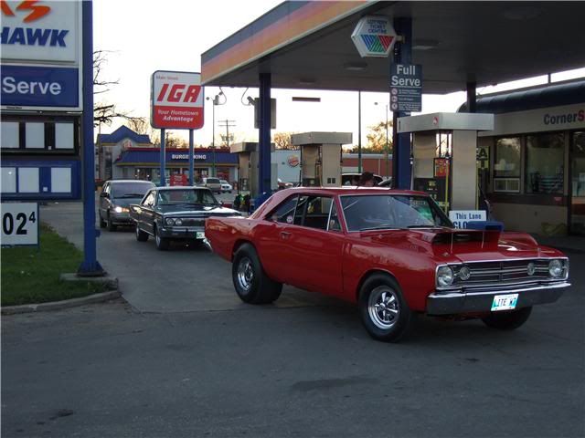

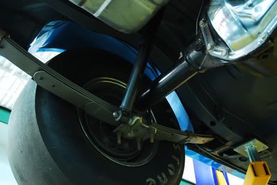

dencon Posted September 21, 2010 Share Posted September 21, 2010 The thing about the Super Stock springs in the kit. They are not so much of artistic licensing by Revell. I fact that was a normal Mod by the drag racers and a suggestion in the NHRA rule book for Super Stock race cars to make room for bigger slicks. I think that they were doing that by 70 or even possibly 69. Here is the springs in the stock location of the restored Arlen Vanke SS/B (Stick) Cuda as it was in 68. Here is the in boarded springs under a ceria early 70s SS/A Dart. I believe that this became common practice by 69 when NHRA reclassified the cars to SS/A You will find this set up in just about every real restored to "Original" LO23s. Just makes for a better looking car with big tires. I have been talking to the owner of this car. This is the car that was Charlie Castaldo's SS/B race car. Charlie is the guy that took all of those famous photos of the ready for delivery LO23s and BO29s sitting out back at Hurst in 68. This car has the inboard spring set up with mini tubs. On an interesting note. The owner of that car has ordered the model kit and is going to compare the kit to his real car. I will let you all know what his findings are. So it will not be too "Off" if you use the in board springs. Hope this helps Quote Link to comment Share on other sites More sharing options...
