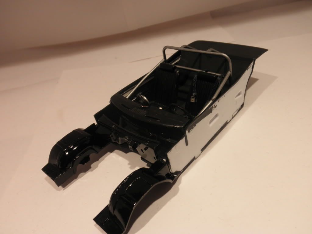

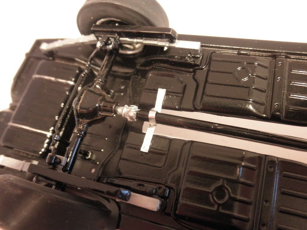

I built that driveshaft loop today. It's made from aluminium, and actually I'm not 100% sure if it is in right place, or not, but I've seen them on that place too... I've installed also the firewall, but I'll post more pictures when I can get the interior finished, it doesn't need much parts anymore.
Oh, pictures are too sharp-it looks much better in person.

Niko, the loop should be at the front, i think the NHRA rule is something like no more than 6" behind the u-joint or front yoke. you could just add another one at the front and have both. you want the one by the front so that if the u-joint breaks the loop contains the driveshaft and keeps it from falling down and pole vaulting the car.
All the loops I've seen are at the back.
And Mythbusters proved that you can't pole vault a car if that happens ;):P

I was just saying that on all the cars I've seen the loop was on the back. I wasn't trying to be rude there either. But, I'll look up the rules.
And I was just joking about the last part, you know.
What cars are you looking under? :rolleyes: Certainly not cars that have to pass a NHRA technical inspection.
As far as the pole vaulting thing goes, back in 1964 at L.I.'s Westhampton dragstrip a Max Wedge car called The Mad Russian broke the front u-joint at speed. The car literally "pole vaulted" into the woods that lined the track. The car was a total wreck and everything was retrieved except the torque converter.

Wow, thanks guys for the information. I'll build another driveshaft loop, I guess there can be two of them?

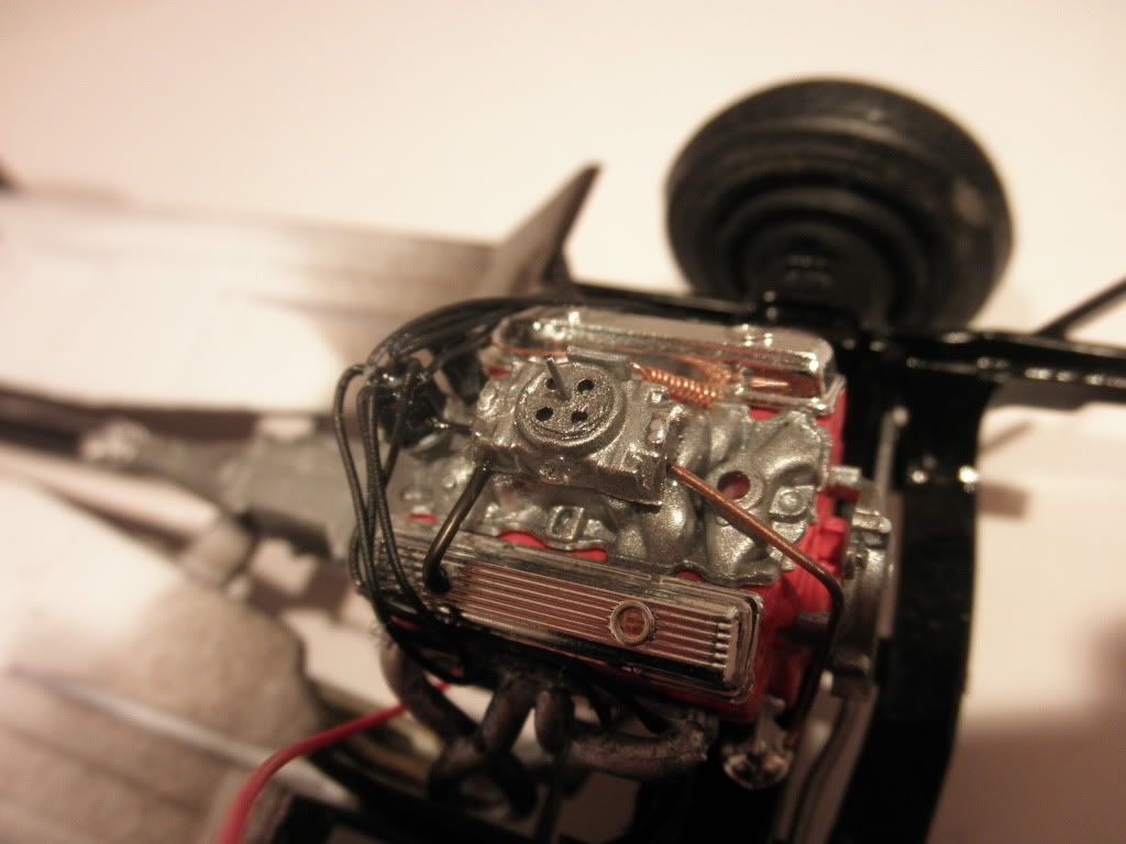

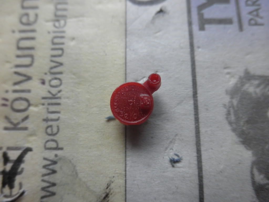

Little update too. Interior is finished, tachometer is from Revell Jukebox Ford, and that needed just a little styrene before painting. Painted it to match Autometer's Pro Comp cauges. Wires are from Detail Master, they are Detail wire, painted with different colors, just like in 1:1. Carburetor got some detailing too.
