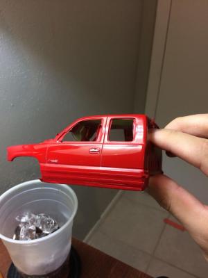

addicted2modeling Posted September 22, 2014 Share Posted September 22, 2014 I just performed a multi-step polishing with fine sanding discs to repair the orange peel pain from my truck. So far, it looks very nice but there is some small "rough spots" which are hard to take care due to their size. They noticeable on molding lines like the fender. Anyway, since I have me such a nice finish, is clear coat needed or not? Since I will paint the lower half in a metallic color to give it that two tone finish, should I reconsider using a clearcoat? Here is my cab so far. Quote Link to comment Share on other sites More sharing options...
