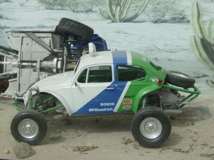

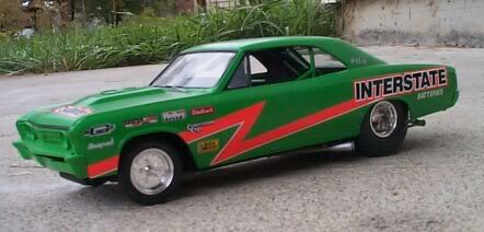

mhadman Posted May 3, 2007 Share Posted May 3, 2007 Here is a lacquer based PACTRA R/C painted build with testors primer... They do need to be polished up quite a bit as they are shot under lexan,the paint doesn't need to shine. same paint on this one.. Quote Link to comment Share on other sites More sharing options...
