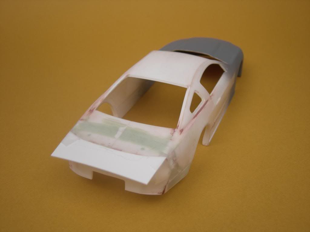

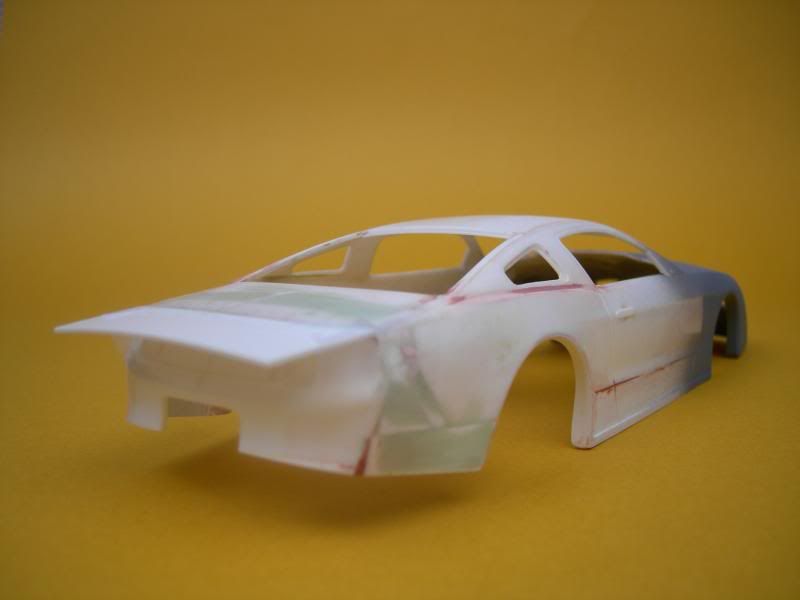

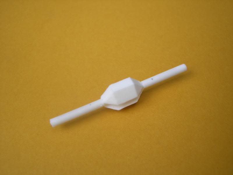

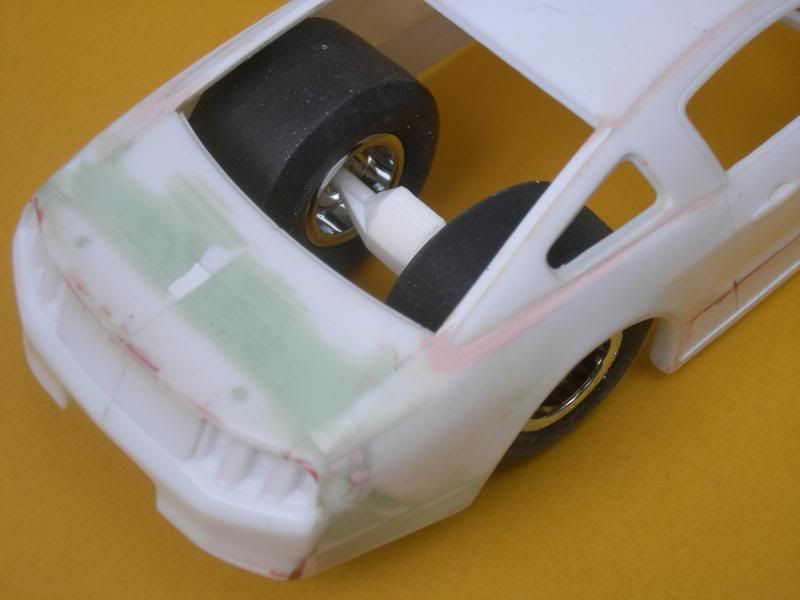

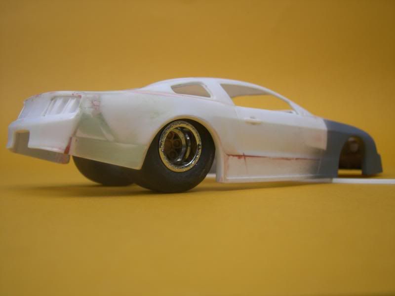

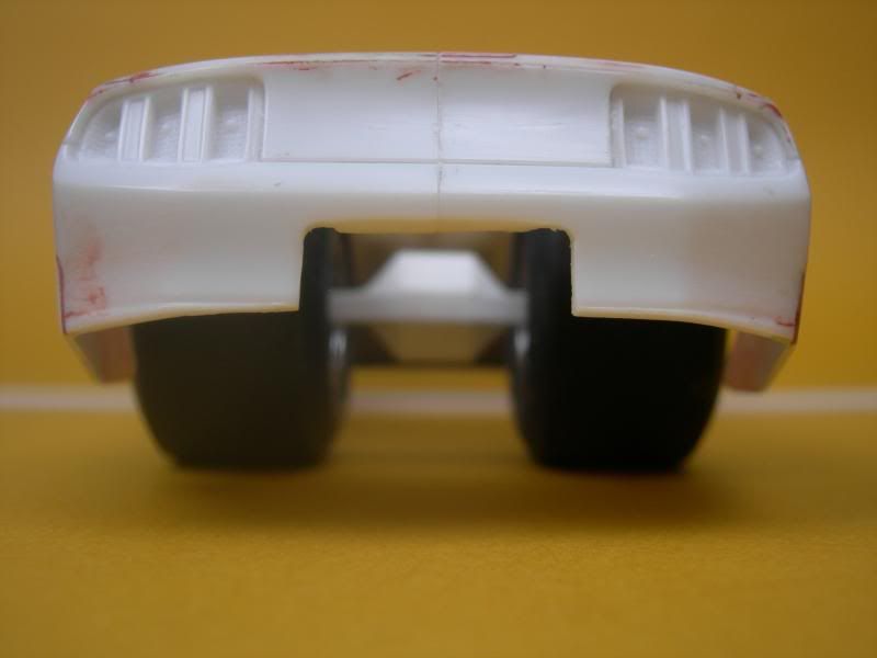

futurattraction Posted September 16, 2013 Author Share Posted September 16, 2013 Thanks Darryl. I'm excited to see you getting back to your build... I got the little filler pieces plugged into the rear of the hood extension. I don't have pics yet, but I did get the rear of the hood trimmed to where its very close to its final configuration. I'll post a pic of that, probably next time I get pics taken. In the meantime, I started another project I've had in the works for awhile. I have been intending to offer a fabricated 9-inch rear. I had one 3D printed quite some time back and finally got around to molding and casting it late last week. I devised my own poor-man's mill by using a Dremel .125" cutter in my drill press. I have a small X-Y machining table I can clamp to the drill press and pretty accurately run stuff underneath the cutter, progressively moving the cutter down into the work, effectively machining a slot in the work. This is the machined resin housing: Unfortunately, I didn't get a pic of the brace insert before I actually glued it into the housing. Anyway, here is what it looks like mocked up under the car, from a couple different angles. ...and a general view with both rear tires mocked up. I got the spot glazing putty put on last night and will hopefully be able to start working that into shape tonight. Quote Link to comment Share on other sites More sharing options...
ScaleDale Posted September 16, 2013 Share Posted September 16, 2013 Let us know when that housing goes into production. I don't think there's anything like it on the aftermarket now. I'm tired of putting stock housings into high HP cars. Body is looking good. It's a far cry from the stock 'Stang you started out with. Dale Quote Link to comment Share on other sites More sharing options...
futurattraction Posted September 16, 2013 Author Share Posted September 16, 2013 Thanks Dale. Will do (re the fabbed housing). I totally understand the dilemma of putting a modified OEM housing under a P/M car... lol I'm also toying with the idea of developing a basic late-model 'slammer pan that could be used for builds such as this. Yeah - you're right, there's not much left of the stock body appearance at this point. Quote Link to comment Share on other sites More sharing options...

futurattraction Posted September 18, 2013 Author Share Posted September 18, 2013 Thanks Bill. I'm glad you like the looks of my fabbed rear end housing. I'll try to post some updates on it soon. Dave - thanks! I'm making progress, little by little. Thank you, Richard. I love fabrication and modifying things better than I do building (which explains why I never get anything built!). Thanks Edward. I'm going to add the filler bung on top of the housing and a drain plug on the bottom and am working on PE 4-link brackets that will fit it when all is said and done. I hope to get a couple pics posted tonight. Quote Link to comment Share on other sites More sharing options...

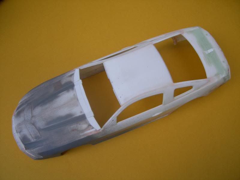

futurattraction Posted September 25, 2013 Author Share Posted September 25, 2013 Thanks Ray. Shooting some primer on it certainly makes all the work that remains stand out more! LOL It also helps add some three-dimensionality that might otherwise get lost when it's white plastic. I appreciate your comment, Bill. It's sort of slow going sometimes, but I'm making some progress... Quote Link to comment Share on other sites More sharing options...
