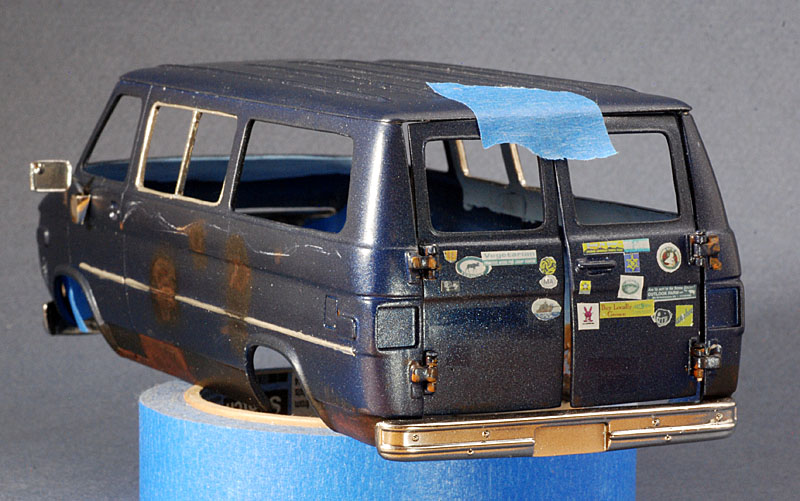

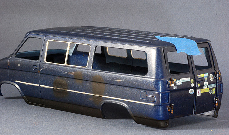

Foxer Posted June 28, 2012 Author Share Posted June 28, 2012 (edited) This is moving down the historic path .. two steps forward and one back. I masked the body to spray some flat black where some old bodywork was done and just primered over. That went beautifully as I wanted the edges faded and leaving the masks loose at the edges accomplished that perfectly. Trouble was, the tape on the rear doors lifted some of the decals off. I made extra decals so that's not a big problem, but I don't need the extra work. You can compare this new shot to the one just above to see what got lifted off the rear doors. Also adding a photo of the 1:1 to see the black patched areas on the left side. The door hinge is repaired and just needs some touch up paint. Also cut out the patterns for the windows. I have some purple tinted clear plastic from report folders but it's not the best shade. Going to have to visit Michel's again to see if they have some better purple shades. I'm ready to Alclad the bumpers, but still nervous as this will be my first chrome Alclad job. Edited August 9, 2017 by Foxer Quote Link to comment Share on other sites More sharing options...

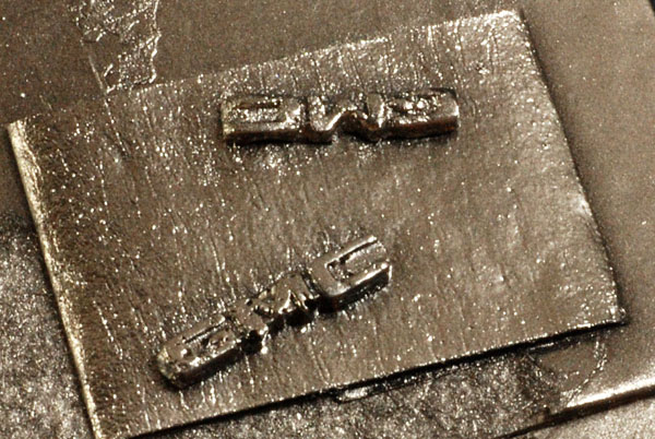

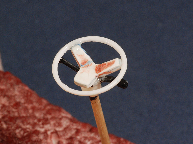

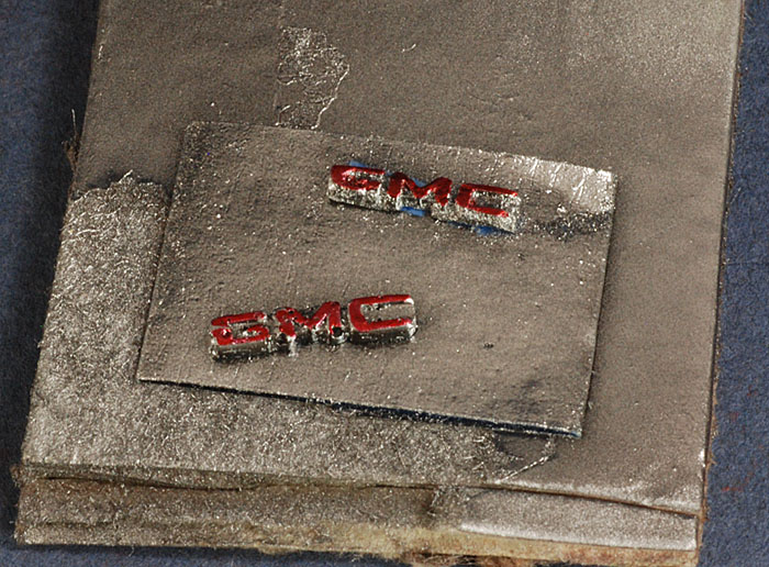

Foxer Posted July 26, 2012 Author Share Posted July 26, 2012 (edited) It's been little pieces that have been keeping me busy .. a milk crate and the steering wheel mostly. The crate was made from styrene shapes and brass mesh. It's far from perfect but will do deep inside the van. The steering wheel I found I had to make from scratch to get the right shape. I just used the outer rim from another wheel. I needed a GMC logo for the back doors and made a cast of the grill logo to use. My resin is way too old and it came out pretty bad. I made a number of casts using sprue melted in Ambroid cement and the two shown in Alclad are the best ones. It's stopping here after I use a red sharpie on them. Here's why I left off half the engine accessories .. especially on top. The radiator goes tight against this making it even less visible. Edited August 9, 2017 by Foxer Quote Link to comment Share on other sites More sharing options...

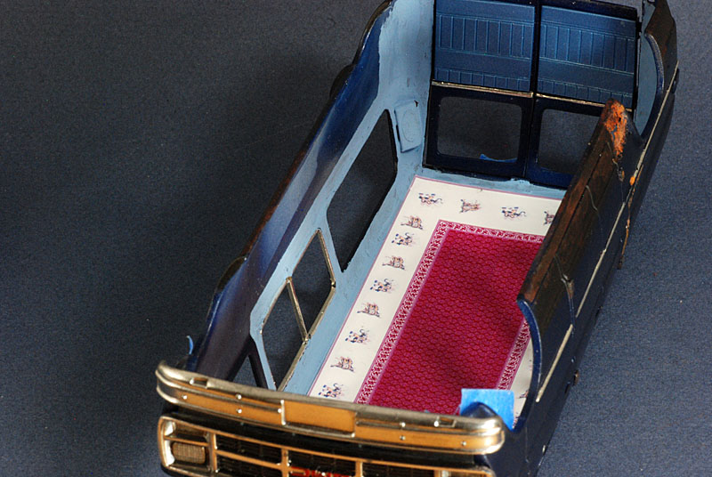

Foxer Posted August 3, 2012 Author Share Posted August 3, 2012 (edited) Moving right along ... front grill/bumper is done. I made a ceiling that is similar to the "tapestry" my daughter had hanging in the van ... just printed on some white paper and glued in. The rear logos look ok painted .. one will work. All the decals are printed and drying and should get applied this weekend. I made some CD cases from clear sheet and decals that will get distributed in the front ...maybe some photos later in the weekend. All are Grateful Dead ... she IS my daughter! Edited August 9, 2017 by Foxer Quote Link to comment Share on other sites More sharing options...

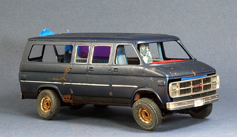

Foxer Posted August 11, 2012 Author Share Posted August 11, 2012 (edited) This is in FINAL ASSEMBLY! One side of the interior is epoxied in and did a mockup to check fit and see how purple window color works. The purple passes and fit is good. The only problem ... THE TOP HINGE ON LEFT DOOR CAME UNGLUED!!! gRRRRR Don't mind the wheels as they were just stuck on and somewhat wobbly with no glue. At any rate, I'm happy with it all. Just a few little things .. waiting for some radio faces to see if Detail Master's are better than ones i have. The rear axle came unglued during the mockup so it got epoxied in place for good. The matching plastic glur face was pretty small so the epoxy should hold it. I can almost SMELL the final display case!!! Edited August 9, 2017 by Foxer Quote Link to comment Share on other sites More sharing options...
