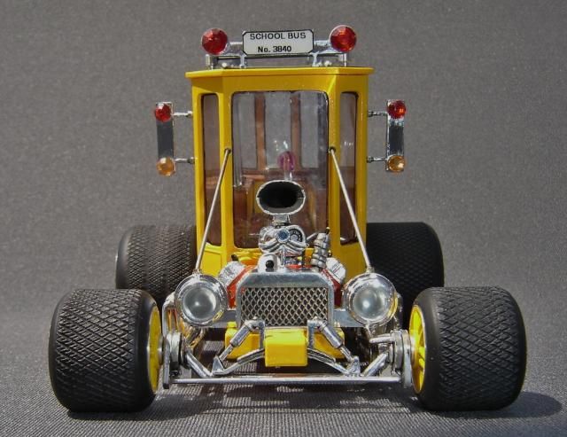

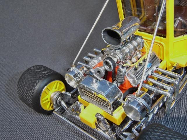

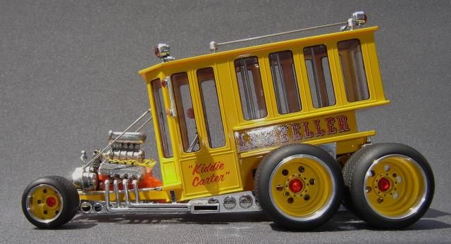

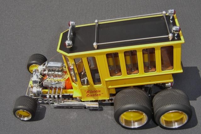

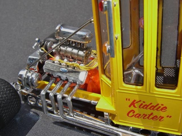

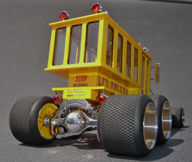

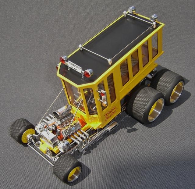

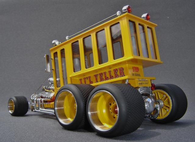

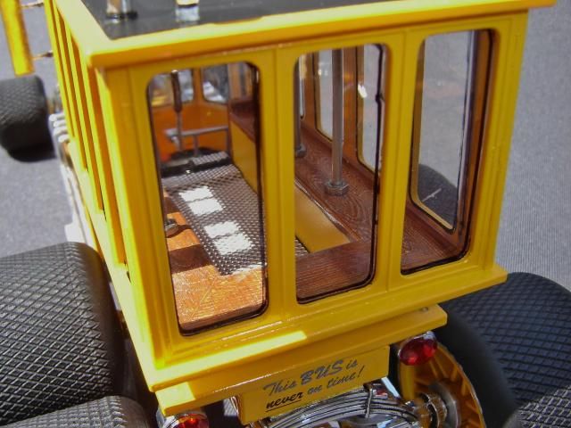

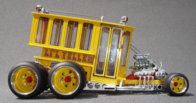

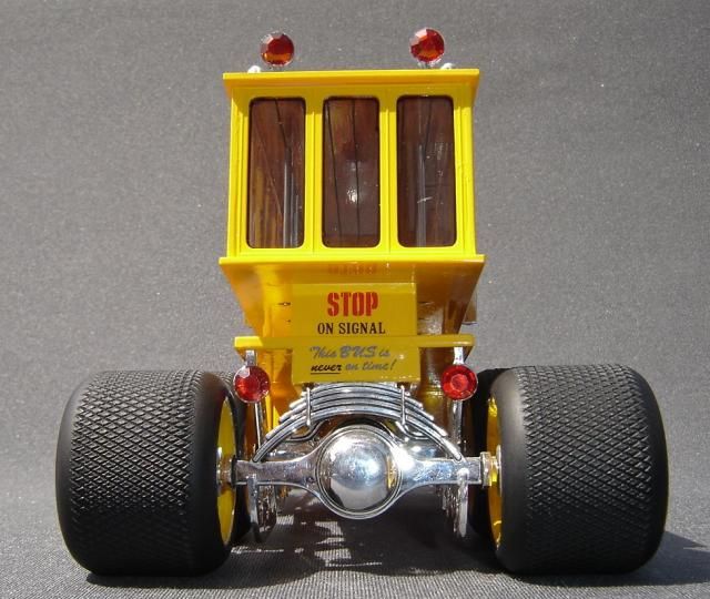

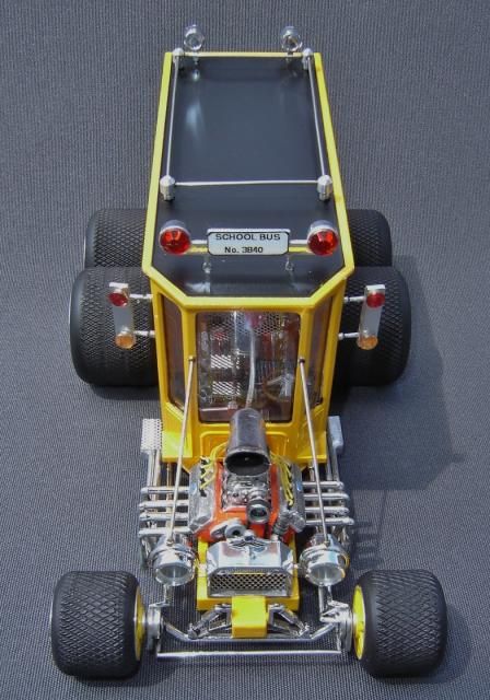

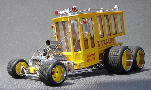

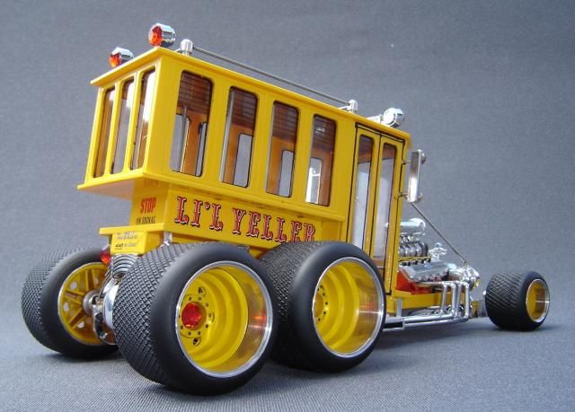

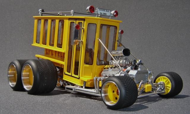

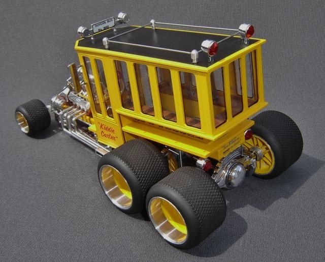

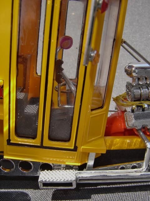

hobbybobby Posted September 25, 2014 Share Posted September 25, 2014 Li'l Yeller School Bus Plus! •Original year: 1970 •Company: AMT •Scale: 1/25 •Designer: John Bogosian Here's the Li'l Yeller, the scholar hauler with a soul! AMT's solution to heir pollution is crammed full of educational goodies! Bored of education? Our Teeny-Bobber Teacher's Pest goes to the head of its class with elementary items as "Think Tank" body design, "Brain Drain" Radiator, "Grad-U-Eight" mill with "Cum Louder" stereo exhaust, "Midnight Oil" pan, "Lunge Box" shifter--sheepskin upholstery--mind-bending vinyl tires (quad slicks out back and ground-grabbin' wide-tread weenies up front). It all adds up to the kit most likely to succeed, so don't drop out-- close the generation gaps with Li'l Yeller! Ride on! This is my version. While starting and after a few difficulties with the bodyparts, which fit together very poorly, it spent a few years in the box, also because missing parts blocked the assembly. The mods: Front lowered, aluminum mesh in the cooler and in the interior floor, wired motor, windshield bracing made from 1mm chrome steel wire, a new shifter knob, the roof railing is homemade: four new aluminum holders and inox wire, modified rims from LEGO and some new selfmade Tires... Hope, you like it. Quote Link to comment Share on other sites More sharing options...

Greg Pugh Posted September 25, 2014 Share Posted September 25, 2014 I've never seen this kit before. It's wild! Very cleanly built and an excellent job here! Quote Link to comment Share on other sites More sharing options...
crazyjim Posted September 25, 2014 Share Posted September 25, 2014 Very cool. Clue me in - "self made tires". What's with that? I love them. Quote Link to comment Share on other sites More sharing options...

cobraman Posted September 26, 2014 Share Posted September 26, 2014 Nice ! I love those wild tires ! Quote Link to comment Share on other sites More sharing options...
Mr mopar Posted September 26, 2014 Share Posted September 26, 2014 Awesome build .....where did the tires come from? Quote Link to comment Share on other sites More sharing options...

Dave Van Posted September 26, 2014 Share Posted September 26, 2014 Great work........I repro'd this kit before it was re-issued. I designed a laser cut body to fit the Gasser kit which the RC2 version had the chrome tree from Yeller!!! How about a little info on those tires....they really look great! Quote Link to comment Share on other sites More sharing options...
unclescott58 Posted September 26, 2014 Share Posted September 26, 2014 Very, very kool! Wow! I only have one question. Is the lettering used on the truck, decals that came with the kit? They really help with the look of the vehicle. Scott Quote Link to comment Share on other sites More sharing options...

hobbybobby Posted September 30, 2014 Author Share Posted September 30, 2014 Very cool. Clue me in - "self made tires". What's with that? I love them. Well, I turn all my wheels on the lathe. In this build here are the rims of LEGO, colored in yellow, encased in machined and polished aluminum tubes. The tires are turned out of PVC, after that cross-knurled and finally black colored... Quote Link to comment Share on other sites More sharing options...

hobbybobby Posted September 30, 2014 Author Share Posted September 30, 2014 Very, very kool! Wow! I only have one question. Is the lettering used on the truck, decals that came with the kit? They really help with the look of the vehicle. Scott Yes, there are different variants to choose from in the kit and in great quality... Quote Link to comment Share on other sites More sharing options...
