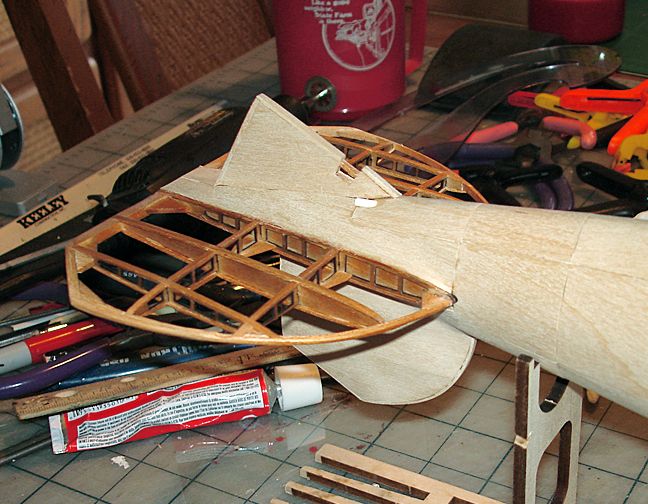

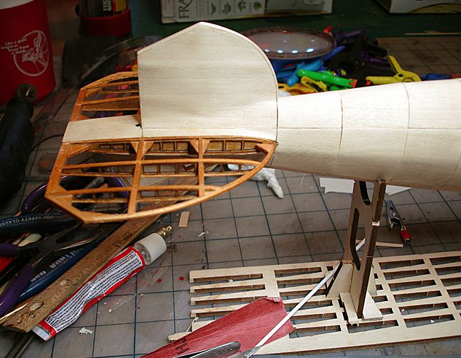

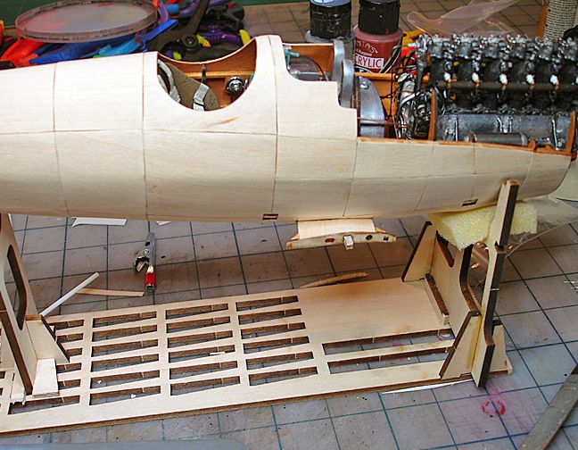

cobraman Posted April 20, 2013 Share Posted April 20, 2013 Any problem with the panels cracking when trying to bend even when wet ? Do you soak the panels ? Do they want to straighten up when drying ? Quote Link to comment Share on other sites More sharing options...
Harry P. Posted April 20, 2013 Author Share Posted April 20, 2013 They're very thin. Don't even have to soak them, just wet them and they become very flexible. They straighten out a little as they dry, but by wetting them I get that initial bend... so even if they straighten out a bit as they dry, they still dry with a bend in them. Once that bend is in there, I can always bend them a bit more when dry to go around the curves. The hard part isn't wetting and bending them, it's getting each panel cut to the exact shape so it fits in without huge gaps on the joints. Quote Link to comment Share on other sites More sharing options...
cobraman Posted April 20, 2013 Share Posted April 20, 2013 Do you make each panel direct to trying to fit wood or do you make the pieces out of something like card stock first ? Seems like a almost impossible task as you get to the back part of the fusalage. No ? Quote Link to comment Share on other sites More sharing options...
Harry P. Posted April 20, 2013 Author Share Posted April 20, 2013 I used pieces of clear acetate, taped to the fuselage, then drew my cut lines with a fine-point sharpie, then laid my acetate template on the veneer and cut through both at once. Still, though, I had to finesse each veneer panel to some extent. And yes... the further back on the fuselage, the harder it got! Quote Link to comment Share on other sites More sharing options...
TooOld Posted April 20, 2013 Share Posted April 20, 2013 Another impressive build Harry ! Actually it looks like it would be kind of fun to try one , one of these days , maybe . Quote Link to comment Share on other sites More sharing options...

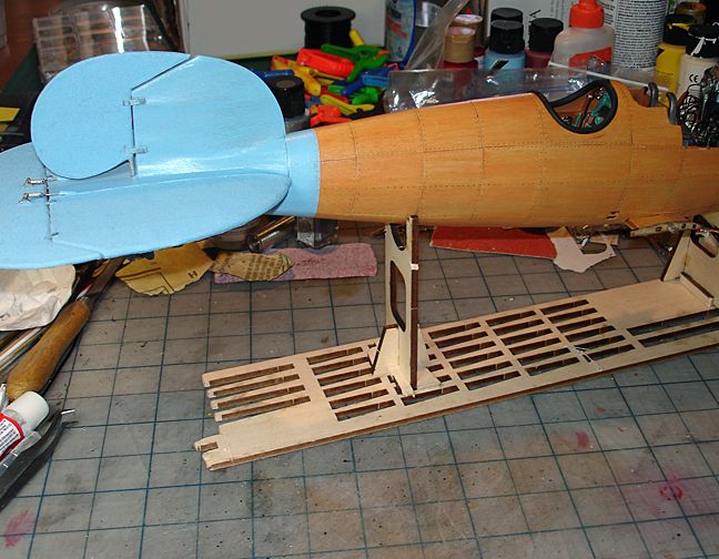

Harry P. Posted April 20, 2013 Author Share Posted April 20, 2013 Covering the fuselage with the birch veneer was a huge pain. It's like creating a jigsaw puzzle by cutting out each piece by hand and getting all the pieces to fit. I tried my best to keep the panel gaps as tight as I possibly could, but they are definitely not perfect... not even close! I'm hoping that once the fuselage is stained and all the markings are in place, you won't notice the seams so much. Here's the front part of the fuselage... the "easy" part. Those square holes in the fuselage are where the landing gear mounting brackets will go... The further back you go, the tighter the radiuses become, so I had to wet the panels to soften them, then form them around the fuselage. The hardest part, by far, was getting the compound curves on the pieces that cover the tail fin and around the rear stabilizer. That hole directly behind the tail fin is where the shaft of the rudder will go: And below, a shot of the fuselage upside-down, looking at the bottom side. That triangular piece is where the tail skid will attach to, and that little white tubular thing is where the stabilizer control lines will feed through. Getting the wooden panels to conform to the complex shapes here was a major headache... The part of the tail that's still open and not covered with veneer will be covered in fabric, like the real plane... along with the rudder and the wings. More to come... Quote Link to comment Share on other sites More sharing options...

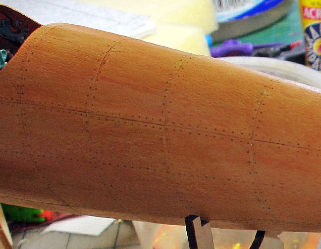

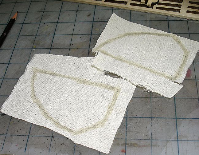

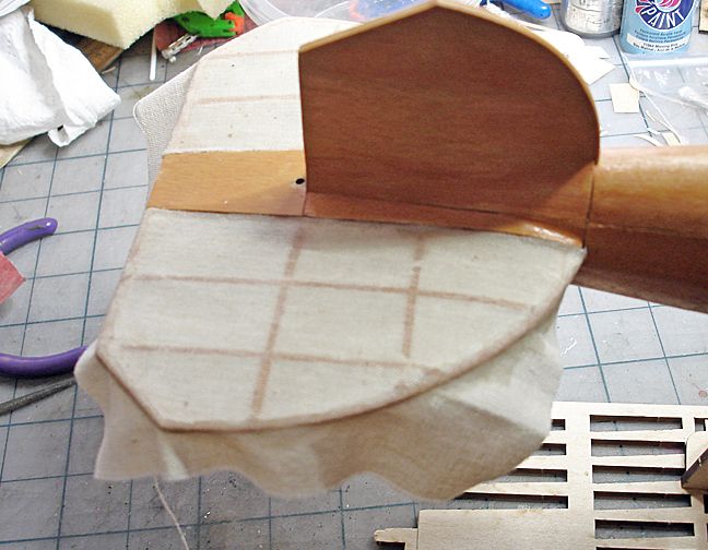

Harry P. Posted April 21, 2013 Author Share Posted April 21, 2013 I painted the fuselage to look close to what photo references show... a mixture of Future and some yellow, red and brown acrylic paint. A also added all the screw heads by drawing them on with the tip of a regular pencil. They're pretty faint and hard to see, but that's the way they look on the real plane, too. Then I started doing the fabric coverings. I have never done this before, so I know I'm probably doing it "wrong," but I'm doing it in a way that makes sense to me. First I cut out a piece of cloth and glued the straight edge that runs parallel to the tail fin. Then I stretched the fabric tight and super-glued it all down and around the edges...then painted the fabric with Future to seal it. Then I flipped the fuselage upside down and trimmed off the excess fabric. The bottom side gets fabric, too... but this time the fabric has to be cut to exact size first... I don't want the lower side fabric to extend up and past the edges of the stabilizer fins. I made a template out of clear acetate and cut that out. To keep edges of cut piece of fabric from unraveling while I work with it, I laid the acetate template on the fabric and traced around it with a pencil. Then I painted over the outline with Future so that the edges will be sealed when I cut out the fabric panel: More to come... Quote Link to comment Share on other sites More sharing options...

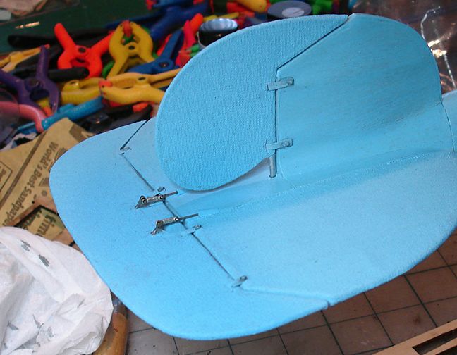

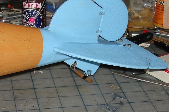

Harry P. Posted April 28, 2013 Author Share Posted April 28, 2013 These planes had all sorts of wild paint schemes... this was in the days before standardized military color schemes. Basically, every pilot could have his plane painted pretty much any way he wanted it. Here is an example of just a handful of the many different color schemes these planes were decorated in: I'm going to do my own custom scheme. Here's the finished tail section. Static tail parts are wood covered, movable flaps are cloth covered: I also added the rubber trim around the cockpit opening: Since there are no sources of readymade 1/16 scale WWI German fighter plane decals (at least none I could find), I created my own graphics and will use homemade decals. More to come... Quote Link to comment Share on other sites More sharing options...

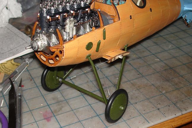

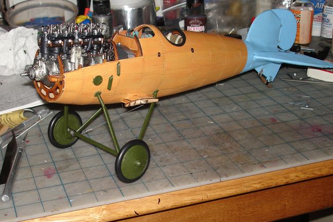

Harry P. Posted May 1, 2013 Author Share Posted May 1, 2013 It's not ready to fly... but it's ready to taxi! The landing gear struts, axle, wheels, hubcaps, etc. are all cast metal parts. The reinforcing cables are silver thread supplied with the kit, and the turnbuckles are also kit supplied (cast metal). I painted the landing gear with Model Master paint. Since this model is meant to be built as a "skeleton," with the structure exposed and no skin, all of the outer detail parts on the fuselage do not come in the kit. I used my reference photos to create the small fuselage surface details, like the small squarish plates near the cockpit, the round flaps near the nose (made of the "pupil" of "googly eyes!!! and a "hinge" of styrene rod) and the vents that I made of strips of thin aluminum, bent to shape, and glued onto "flanges" made of this sheet styrene: Also finished up the tail skid: Quote Link to comment Share on other sites More sharing options...

Cato Posted May 2, 2013 Share Posted May 2, 2013 Beautiful as always Harry. How are the vertical and horizontal stabs covered? Is that silkspan and dope? Quote Link to comment Share on other sites More sharing options...

Harry P. Posted May 2, 2013 Author Share Posted May 2, 2013 Beautiful as always Harry. How are the vertical and horizontal stabs covered? Is that silkspan and dope? Not exactly... It would have been if I was an actual model airplane builder and knew what I was doing! Actually cheap cotton cloth (leftover sail material from a ship kit!) and Future. Quote Link to comment Share on other sites More sharing options...
