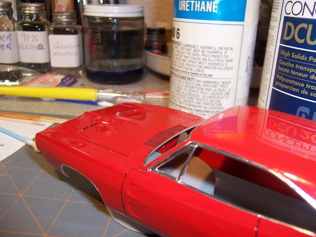

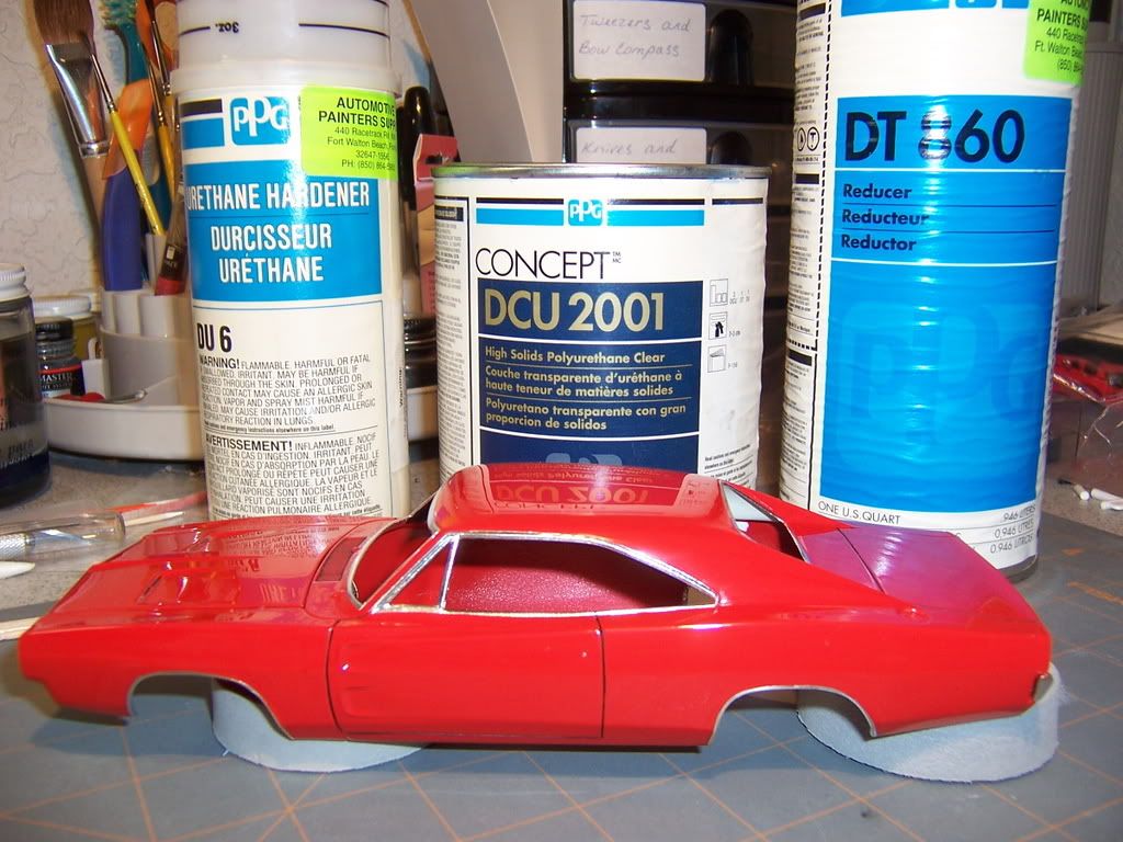

I use PPG Clear Urethane. It goes on thin and dries fast like lacquer but with a deeper shine. See Pics.

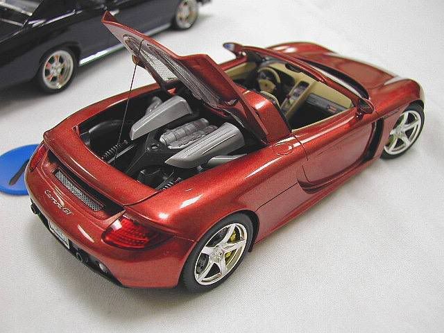

I use dupont premier chroma-clear, it aint cheap, but its da*m nice

The beauty of urethane is removing the need for tedious sanding and polishing. Using the polishing systems from Novus, etc. will actually make urethane duller. If you want good results from any clearcoat, skip the overpriced "systems" and buy a sheet of 1500 or 2000 wet/dry sandpaper and a bottle of fine rubbing compound.
Urethane is where it's at, but when you want something quick even cheap Testors clear gets good results. Just hit it with 1500 wet/dry and 3M rubbing compound after:

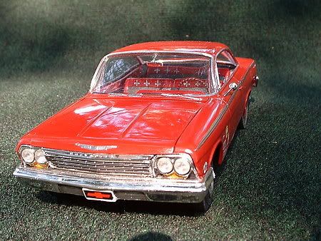

I use Odds and Ends Clear, $1.96 a can, what you really want to do is master your polishing technique, everything else will fall into place......

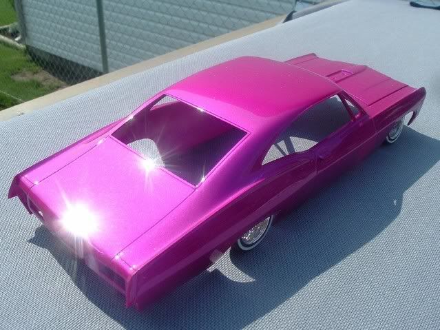

I use nothing other then Future floor wax and it will go over everything but the paint will have to be rubbed out
